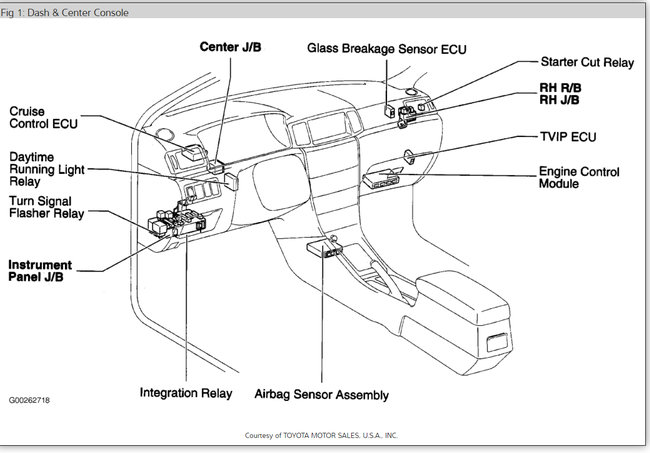

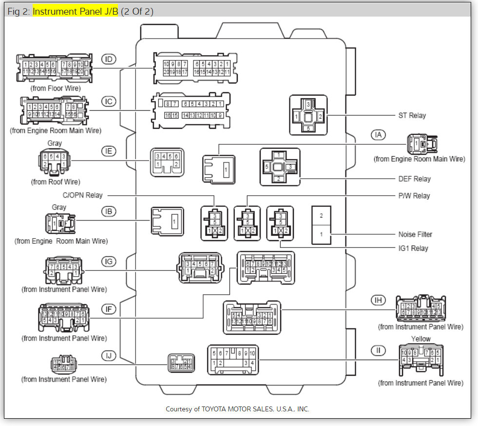

You have a fuse and a relay inside J/B1 (left kick panel) I have located a burned out fuse and replaced it. But, only the driver's side window started working the other 3 windows have not. I think it's the relay. Can you tell me exactly where it is located? Cannot locate J/B1 how does it look like? Thank you so much! Mac

J/B1 is a junction box. It is called a P/W relay You need to remove the driver side kick panel cover, then you will see the junction box. From the diagram, that same relay controls all operations. If the driver works, but the rest don't, I suspect the safety window lock switch on the driver door. The fuse panel and relay locations are in the diagrams below.
Check out the diagrams (Below). Please let us know what you find.
