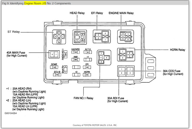

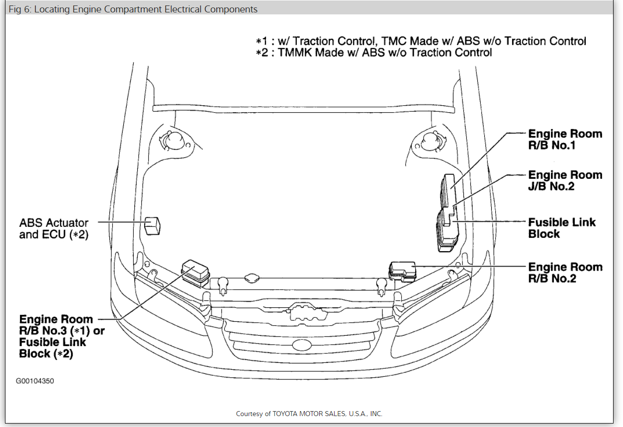

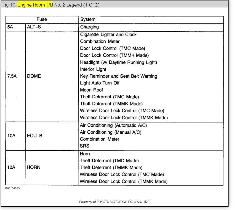

I have a 2000 v6 LE camry with 65K milegage on it. My car's dome light is not glowing and I checked the bulb and it is good. I was trying to check the fuse (one under the change holder and one under the hood) and could not find any fuse labeled by "dome". How could I find and replace it. All other interiors (Radio, dashboard) are working fine.

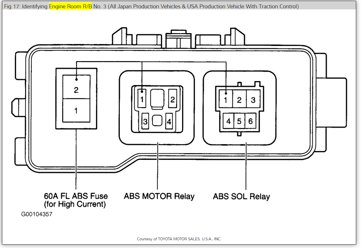

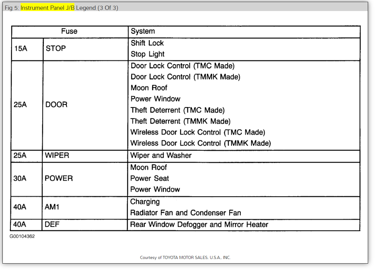

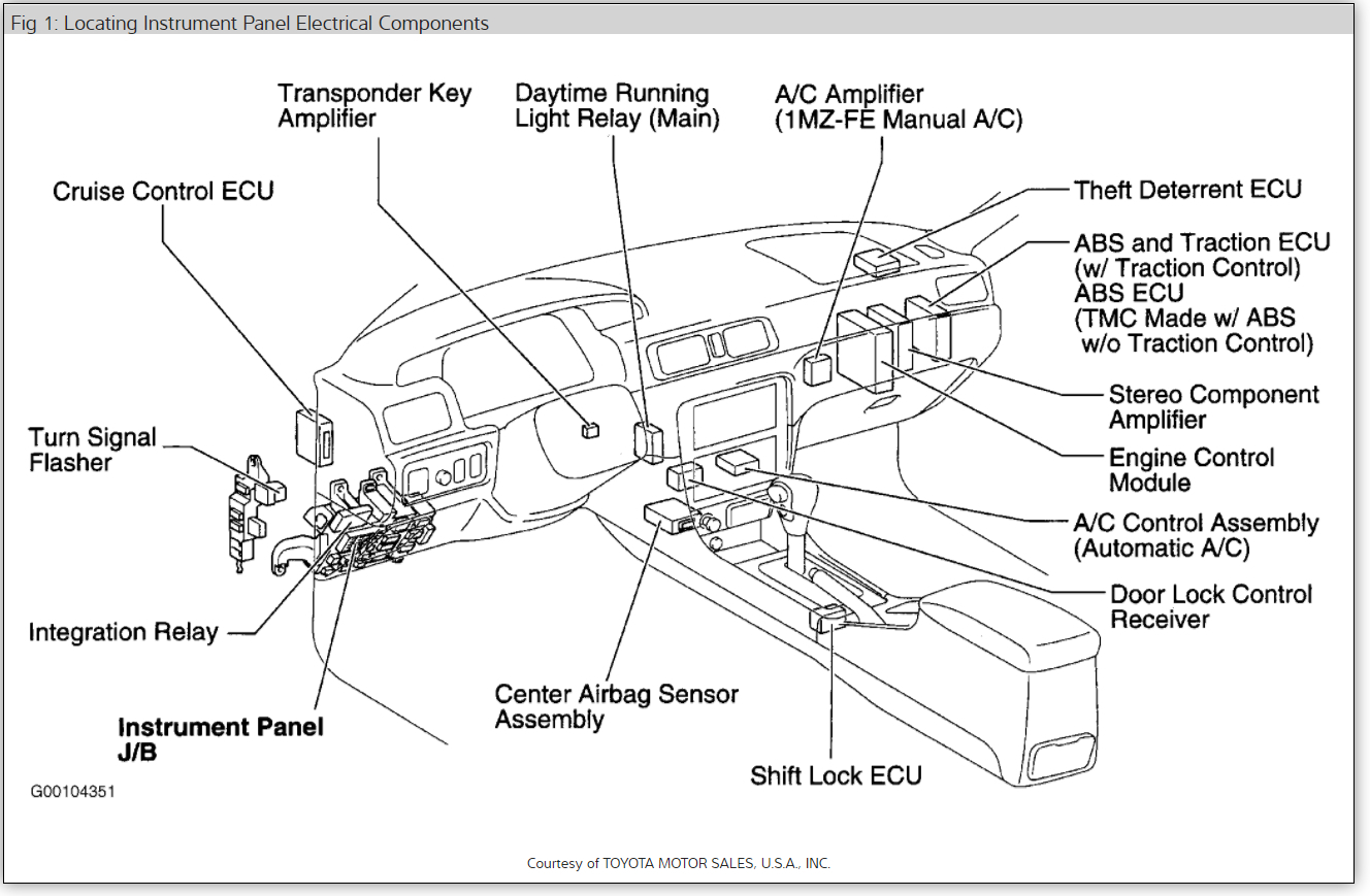

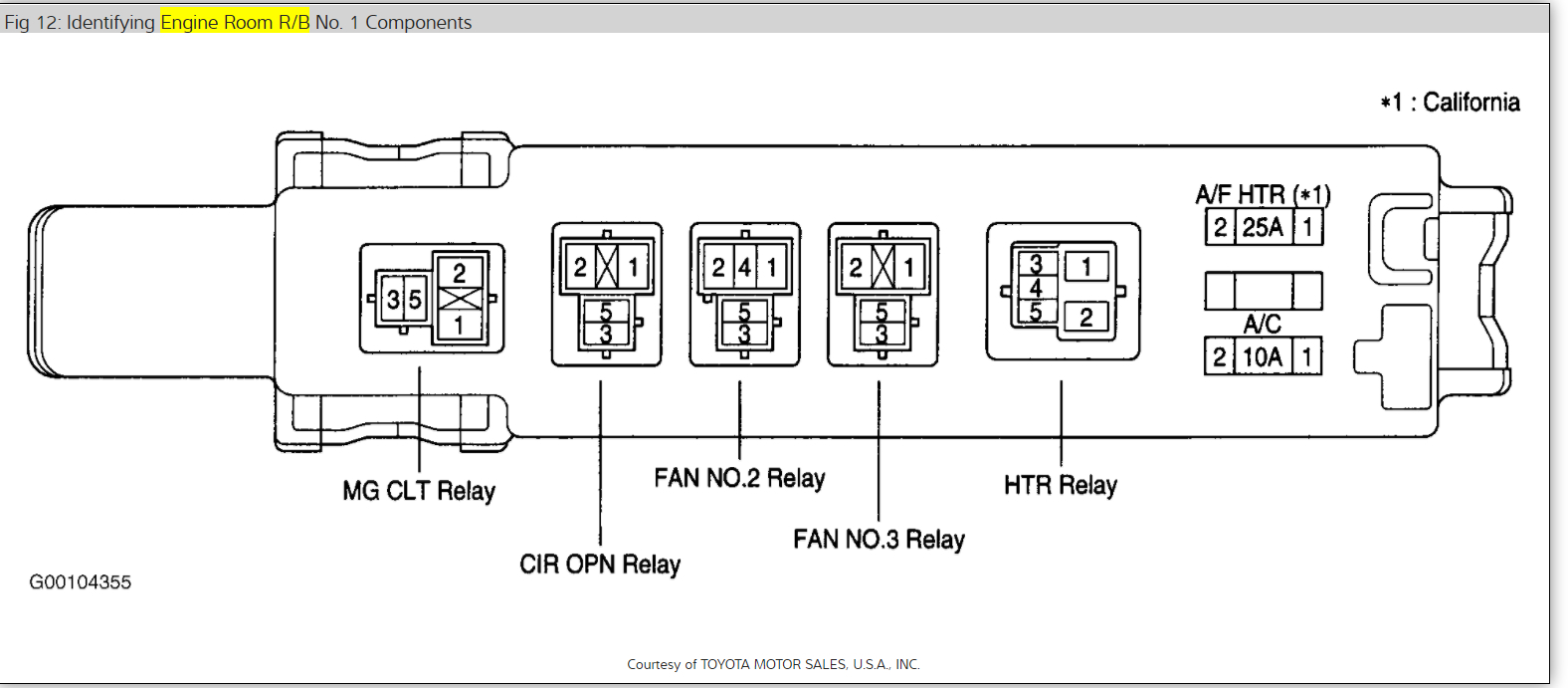

That fuse is in the under hood fuse box,fuse #14 = 7.5AMP here is a guide to help you test the fuse.
Here are the fuse panel locations and identification (below) you should keep this page in your favorites for future reference. It shows the relays as well

Suggested Repair
Check under-hood fuse #14 (7.5 amp) for the dome light and test or replace it if blown. Use the fuse panel diagram to confirm the location.
