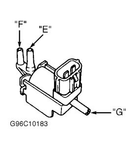

HI THIS CAR HAVE 4 DIFERENT CODE
1 P-0171
2 P-0401
3 P-0441
4 P-0446
I WILL LIKE TO KNOW THIS CODE
FOR REPAIR
THX

Hi
May have answer 401,441,446 all canbe caused by faulty Vacuum Control Valve. A TSB on it replaces with updated part # 25852-20010. The 171 can also be caused , lean fuel mix, by this valve . So maybe worth a shot replace then clear codes see what resets.
https://www.2carpros.com/forum/automotive_pictures/198357_Graphic_218.jpg
https://www.2carpros.com/forum/automotive_pictures/198357_Grafic_3_66.jpg
located by throttle body.
Hope this helps

HI CAN YOU PLEASE SEND ME WHERE LOCATED THIS PART, PLEASE
Tuesday, October 27th, 2009 AT 2:56 PM
DOCFIXIT
  • 18,828 POSTS
Next to throttle body
Tuesday, October 27th, 2009 AT 3:01 PM
