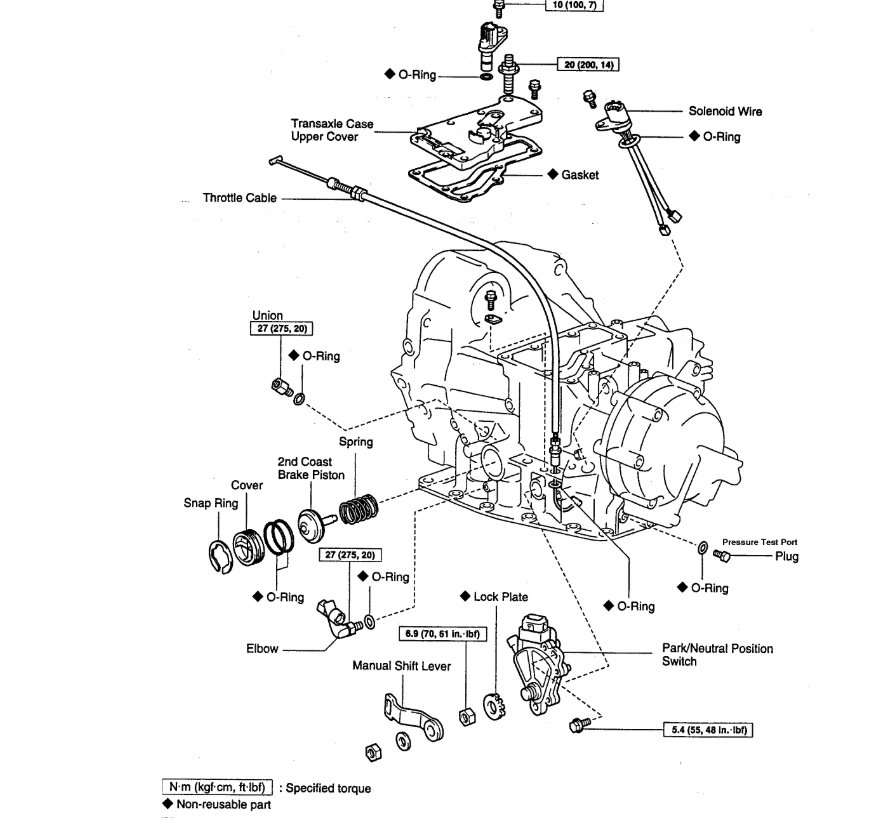

hello, when I place the reverse gear, the lights do not go on, i checked the lights and fuses are okay could there be a problem on the reverse stick shift?
Aug 9, 2010 at 5:07 AM
  • 75,992 POSTS
It sounds like the transmission park-neutral switch is out here is a diagram to help you see what location so you can change it out. Check out the diagrams (Below). Please let us know what happens.

Thanks for this post I got a new switch for $78.00 all fixed! I love this site.
