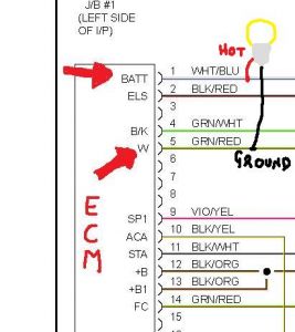

DAVE H
  • 13,384 POSTS
NO jumper's ... a bulb or tester setup like this diagram... when you start off the flash code sequence .. to get the CEL to flash ... your bulb or tester will flash instead !! NOTE .. setup the bulb/tester and turn on the ignition and the bulb/tester should light up and be on constantly if there are codes stored ... just like the CEL would ...If nothing happens, the damage may already be done and you will need to swap out the ECM again ... you could have already blown it with the jumper wire ... it's late ... so I expect to hear from you tommorrow
https://www.2carpros.com/forum/automotive_pictures/266999_cam_13.jpg
let me know
https://www.2carpros.com/forum/automotive_pictures/266999_AAA2_536.png

Mornin Dave: The jumper I used was the tester light. So no damage was done to the computer. I have 4 test lights and I used the heavy duty light to do the tests and I found out this morning that it wasn't giving me good readings so I changed to a different test light and with this light when I went from #5 pin to ground the CEL came on but I can't get the diagnostics to start.

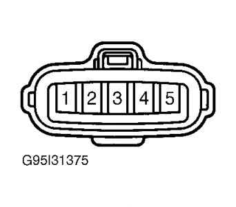

Disconnect igniter connector. Igniter is located behind air cleaner housing. Measure voltage between harness connector terminal No. 3 and ground. See Fig. 7 . Turn ignition switch to ON posit ion. Voltage should be 9-14 volts. Turn ignition switch to START position. Voltage should be 9-14 volts.

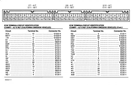

Fig. 6: Identifying ECM Connector Terminals (A/T & M/T Calif.)

Fig. 7: Identifying Igniter Harness Connector Terminals
https://www.2carpros.com/forum/automotive_pictures/266999_7_6.jpg

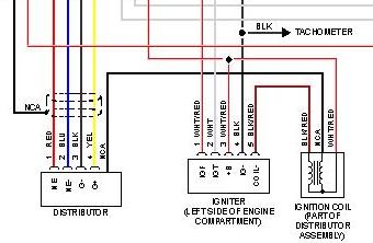

Sunday, April 26th, 2009 AT 6:01 AM
DAVE H
  • 13,384 POSTS
I'm putting this diagram in for you to see the wire colors !!
https://www.2carpros.com/forum/automotive_pictures/266999_cam2_8.jpg

Dave: Are the connectors in Fig.6 for my camry? The reason I ask is because in parenthesis above the picture it says for calif. Emission vehicles. If the connecters are for my car then it looks like the ECM isn't sending out any signals to the igniter because when I disconnect the igniter then turn the key on, I don't get any reading from the IGF wire (white/red) coming out of the ECM at terminal #3 on the E-7 connecter. Also I don't get any voltage from IGT wire while cranking the engine. I am getting 12 volts to the igniter connecter terminal #3 with ignition on and connecter disconnected.
