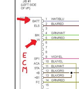

Morning Mike.
You need to check you are getting power to ECM very first pin #1 (white/blue wire)and check the ECM is grounding the CEL pin #5 (green/red wire) .. obviously check the #5 with ECM plugged in and someone turning on ignition for you because it will only ground it for a few seconds unless there are codes stored !!

  • 184 POSTS
Dave:The #1 pin has 12 volts going to it. The #5 pin also shows 12 volts when ignition is turned on.

Hey Mike.
Does the #5 go off (loose voltage) after a few sec's or stay @ 12 volt's ... also what is the car doing ie. TONF (turnig over not firing) or is it doing nothing at all ?

MBENCO
  • 184 POSTS
The voltage stays constant and the car is turning over and not firing.

DAVE H
  • 13,384 POSTS
Hey Mike.
If the voltage is constant you have a code stored !! and the ECM is lighting up the CEL so you must have break in the red/green wire to the CEL .. assuming the bulb is a good one ... can you flash for codes again for me ... I want to know the codes but also that the ECM is functioning correctly by giving us the codes ?

MBENCO
  • 184 POSTS
Dave: I can't figure out what's going on with the readings I get. When I hooked up a test light to the #5 pin it wouldn't light up and yet the meter (new one I just bought) shows 12volts. I swapped out ECM and same thing. The test light was purchased at autozone and I also tried it on the #1 pin and it worked. So it's not the meter or the light. What amI doing wrong?
