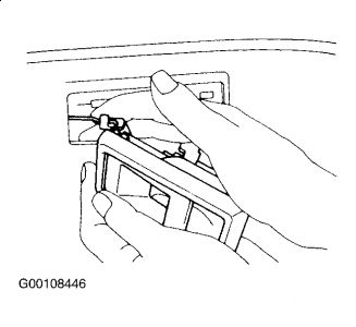

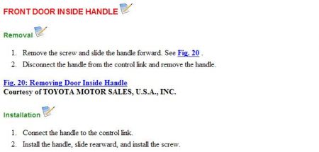

How do you remove the inside door handle assembly from the door panel on the drivers side.
I am trying to remove the door panel to replace either the power window regulator or motor and the inside door handle assembly is the hang-up.
updated 1/14/10

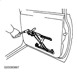

Thanks for your quick reply. Honestly, I figured out how to remove the handle yesterday and was able to remove the door panel.
My problem now is to how to remove the power window motor, because it's behind and bolted on to the inside door frame. The bolts I can remove from the outside but there are other screws that needs to be removed which are inaccesible from the outside. Can you help?
Thanks in advance.
Jan 9, 2010 at 5:57 PM
BLUELIGHTNIN6
  • 16,542 POSTS
https://images.2carpros.com/forum/automotive_pictures/261618_Noname_1427.jpg
https://images.2carpros.com/forum/automotive_pictures/261618_Graphic_264.jpg

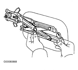

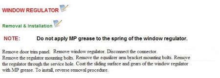

Jan 11, 2010 at 3:40 PM
BLUELIGHTNIN6
  • 16,542 POSTS
The power window motor is attached to the window regulator. If service is required, remove the window regulator from the inside of the door panel and detach the motor from the regulator. Removal and installation of the regulator is described below..
