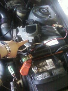

Problem: Engine will turn over but won't start.
Noticed: Check engine light won't turn on anymore at all. Also the spark plugs aren't getting any power.
What I replaced: distributor/cap/wireset/rotor/alternator/all efi and ignition fuses - brand new w/warranty
I also tried checking the ignitor and computer with various parts from a junk yard ( I know it's not a reliable source but the pickens were good ).
My assumption:
My guess is that I have a bad computer that's not grounding properly or the ignitor is bad.

For those of you that ever come accross this situation:
Check your Mass Air flow sensor. If the check engine light comes back on when you disconnect it, the car should start. YOU CAN'T DRIVE IT THOUGH. That should be it. If you you still have a problem after checking that, be sure you don't have a ground loop. I hope my-self-research is helpfull to anyone out there.
