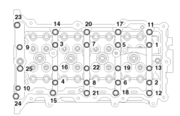

Just need the torque specs and tightening sequence for the camshaft cap bolts.

I don't see a 2.4-liter engine, there is a 2.0-liter engine though so here are the specs for that engine. There seems to be two different bolt sizes, here are the specs for both.
Tightening torque
M6 bolts:
11.8 - 13.7 N.m (1.2 - 1.4 kgf.m, 8.7 - 10.1 lb-ft)
M8 bolts:
18.6 - 22.6 N.m (1.9 - 2.3 kgf.m, 13.7 - 16.6 lb-ft)
Here is the tightening sequence. Check out the images (below). Let us know if you need anything else.

For the 2.0L engine, torque camshaft cap M6 bolts to 11.8-13.7 N.m (8.7-10.1 lb-ft) and M8 bolts to 18.6-22.6 N.m (13.7-16.6 lb-ft), then follow the factory tightening sequence in the service images. Confirm the engine is the 2.0L, since no 2.4L listing was found.
