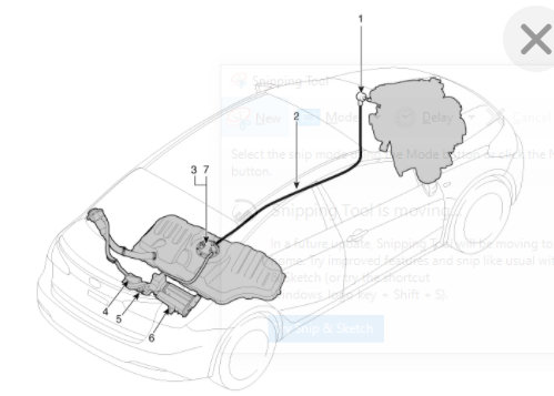

It's a 2016 Kia Forte. I did connect my code reader again and this time I got it give me the actual code for the $07E8... Gave me error P0456 - "Evaporative Emission System Leak Detected (very small leak)" The code reader had nothing under the $7E9, however. I asked my question on here because I was finding conflicting information about what the codes mean.

You are correct in the definition of the code. This indicates an 'air pressure' loss for the evaporative emission control system. This is "not" meaning that there is a fuel leak.
Possible causes:
Fuel filler cap damage or missing
Faulty or damaged fuel filler pipe
Leaking, disconnected or plugged fuel vapor lines
Faulty CCV (Canister Close Valve)
Faulty PCSV (Pressure/Purge Control Solenoid Valve)
Faulty Canister
Faulty FTPS (Fuel Tank Pressure Sensor)
Faulty seal of the fuel pump
The (by far) most common reason for this code is the fuel filler cap. This does not effect drivability, but this is an emissions related code that would cause you to fail a Smog Check inspection if they are done in your area.
Recommendation: (1) Contact your Dealer/Manufacturer and inform them of the "Emissions" related code that you are getting and question if the diagnostic/repair is covered under warranty. Most Manufacturers are required to cover most emissions related issues for 6 years... and it's Free! (2) If '1' is unsuccessful, replace the fuel cap -- clear codes -- using your scanner (which you obviously have) and have it run an "EVAP Leakage Test" (conditions needed before test -- engine is warmed up and running at idle, no trouble codes, fuel level in tank between 15% and 80%). If is passes, you are done! If not, then -- (3) Get a 'smoke test' on the EVAP system because the leak can be as small as a sewing needle hole that you'll never be able to visually find. With a smoke test, then you can.
The pic is where your components are at that are EVAP system related.
1. Purge Control Solenoid Valve (PCSV)
2. Vapor line
3. ORVR valve (On-board Refueling Vapor Recovery)(it controls the fuel vapors to the EVAP canister during refueling)
4. Fuel tank air filter
5. Canister Close Valve (CCV)
6. Canister
7. Fuel Tank Pressure Sensor (FTPS)
It's been a pleasure, and I hope this helps. Let me know the outcome, or if you need further information.
Thanks for using 2CarPros. Glenn...
