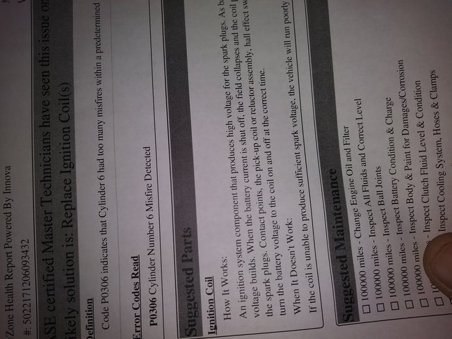

Check engine light came on with a ignition coil code. But saying misfire on cylinder six.

What are the codes?
Wednesday, July 29th, 2020 AT 11:32 AM (Merged)
PATENTED_REPAIR_PRO
  • 1,853 POSTS
Were they P0306, P0356 and/or P0353?
+2
JBOISCLAIR70
P0306.
PATENTED_REPAIR_PRO
  • 1,853 POSTS
P0306 is not an ignition coil code it is a misfire on number six cylinder, although it could mean the ignition coil is bad if this has a coil on each cylinder (coil on plug).

I meant to write thats what someone said to change. I did plugs and wires about 7 months ago.
PATENTED_REPAIR_PRO
  • 1,853 POSTS
Swap the coil with another cylinder and see if the misfire moves or stays on #6. If it moves then the coil is bad, but if it stays then the coil is fine and something else.
