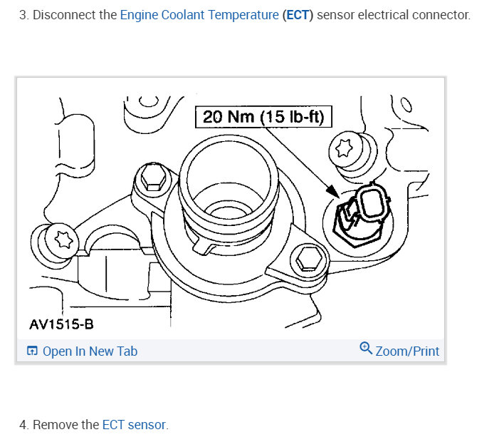

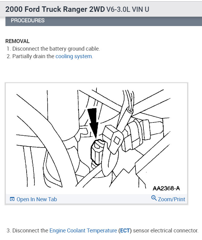

If I can jump in here. I have seen the engine coolant temperature sensor short out causing the PCM to go rich. This condition may or may not create a trouble code. Here is a guide to help walk you through the the steps and diagrams below to show you how on your car:
https://www.2carpros.com/articles/coolant-temperature-sensor-cts-replacement
Apr 29, 2019 at 5:21 AM

that sensor is brand new and the wire has voltage to it. I have a pretty good idea that the MAF sensor is bad cause when you plug it in the truck wont start and when its not plugged in the truck runs but blows a lot of black smoke and fouls out the plugs
Apr 30, 2019 at 10:44 PM

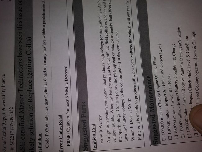

JBOISCLAIR70
Check engine light came on with a ignition coil code. But saying misfire on cylinder six.
Jul 29, 2020 at 4:32 AM (Merged)
PATENTED_REPAIR_PRO
  • 1,853 POSTS
What are the codes?
PATENTED_REPAIR_PRO
  • 1,853 POSTS
Were they P0306, P0356 and/or P0353?
JBOISCLAIR70
P0306.
PATENTED_REPAIR_PRO
  • 1,853 POSTS
P0306 is not an ignition coil code it is a misfire on number six cylinder, although it could mean the ignition coil is bad if this has a coil on each cylinder (coil on plug).

JBOISCLAIR70
I meant to write thats what someone said to change. I did plugs and wires about 7 months ago.
PATENTED_REPAIR_PRO
  • 1,853 POSTS
Swap the coil with another cylinder and see if the misfire moves or stays on #6. If it moves then the coil is bad, but if it stays then the coil is fine and something else.
