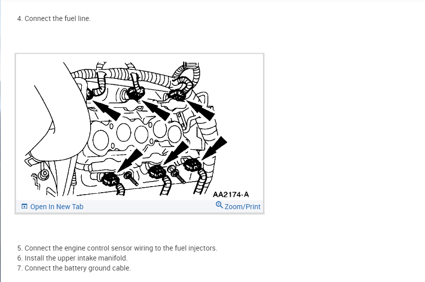

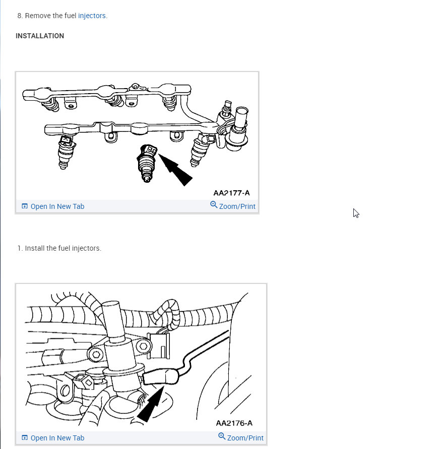

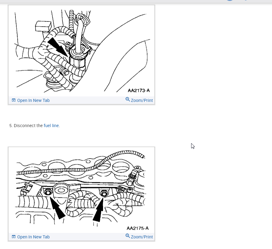

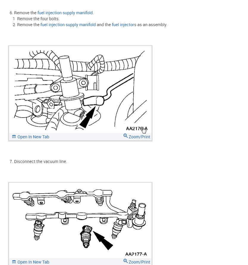

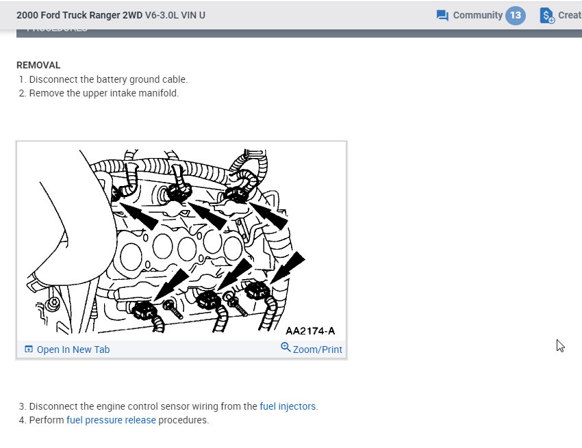

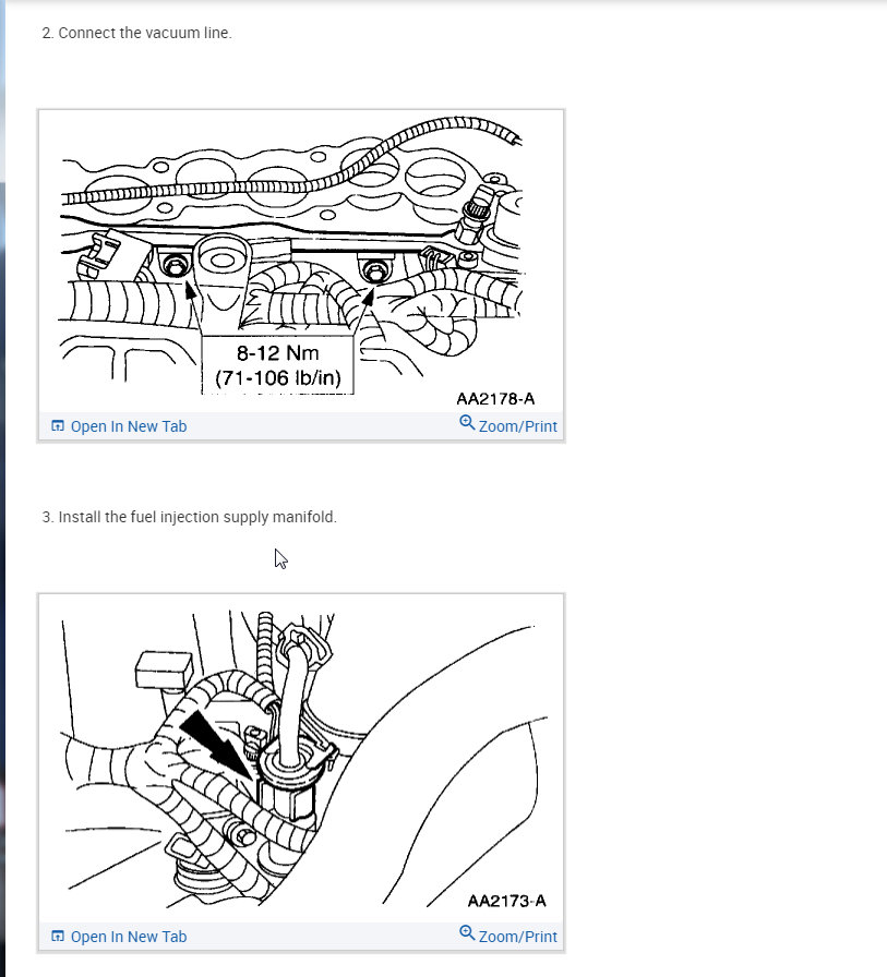

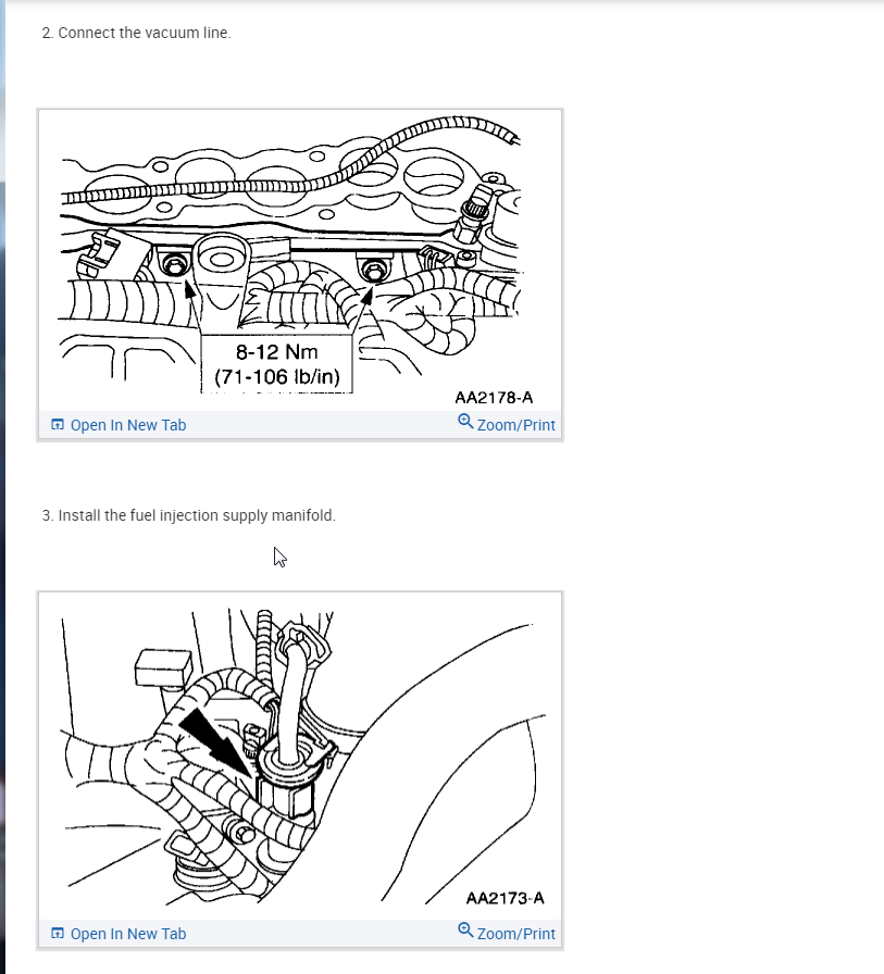

DDP
Problem with a misfire on #4 (according to computer). Isolated to fuel injector problem and have been told that I need to do all 6 and not just 1. Can only one injector be pulled, checked and replaced/repaired or must all be done? This is a 2000 Ford Ranger.
Jul 29, 2020 at 4:05 AM (Merged)
KIN CHAN
  • 453 POSTS
is okay to do one, but is more likely the rest are about the same condition as the defected one. scope and volume test can verify the condition of the rest.
You can replace one injector at a time. That school of thought comes from people who only want to take apart the vehicle one time. So if there is something wrong with one just replace them all while you are there because they suspect the others are going to fail as well. However, I do not subscribe to this because if it is not broken I leave it alone. These injectors deliver the same fuel so unless the fuel is contaminated which caused the failure, I would only replace what is broken.
Here is the process for replacing the injectors.
Please reach out if there are issues. Thanks
