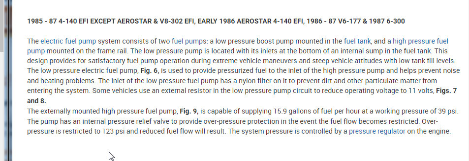

Sometimes it starts sometimes it does not. It will start perfect for a month then one day it just won't. It will start when the fuel pump shuts off, but will not start when the pump runs continuously even though it has 50 PSI at the rail. When the pump continuously runs, it gurgles in the tank. And now it has started cutting out when you mash the throttle. So far have replaced: computer, pickup coil, coil, ignition control module, high pressure fuel pump, fuel pump in tanks, fuel filter, and steering column.

Thanks for the links, but I didn't really find anything helpful in them. It seemed to be mainly aimed towards newer vehicle parts that this truck does not have.
