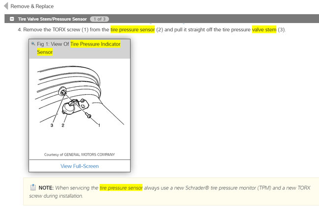

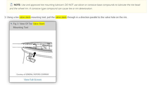

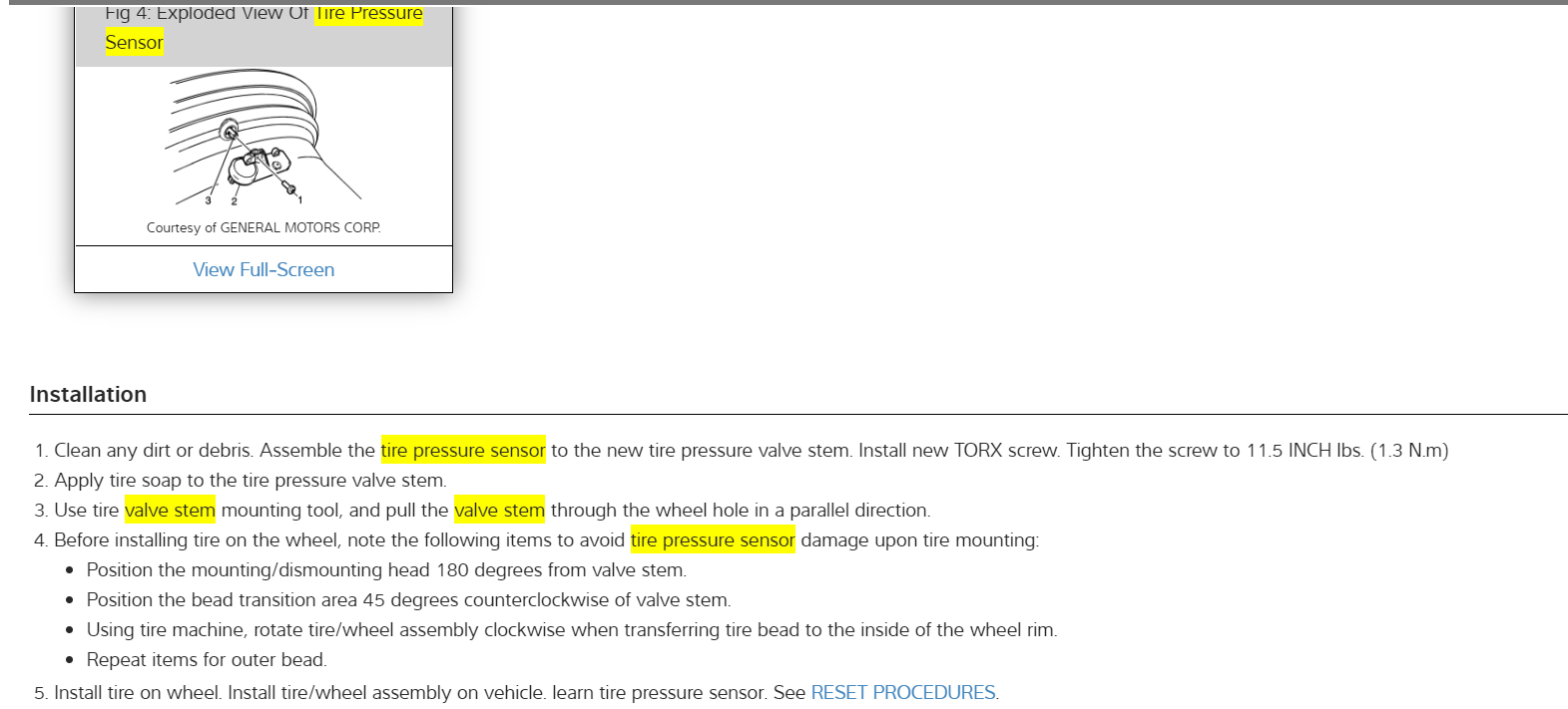

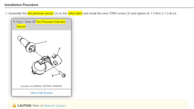

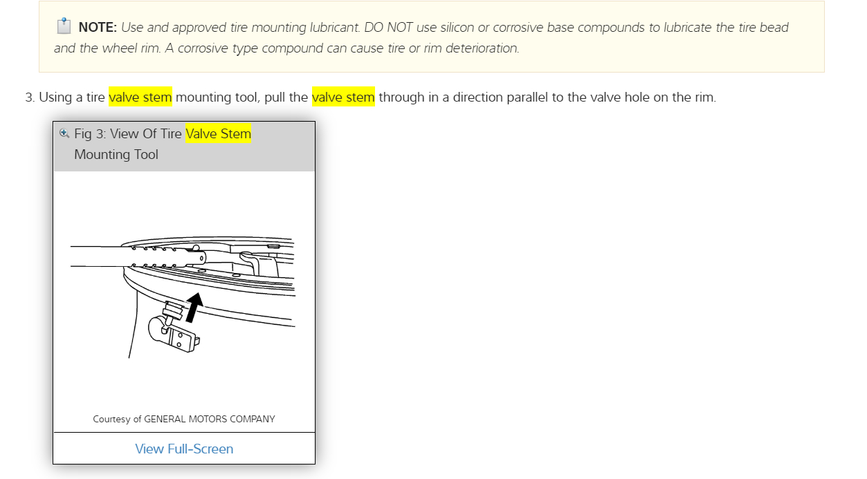

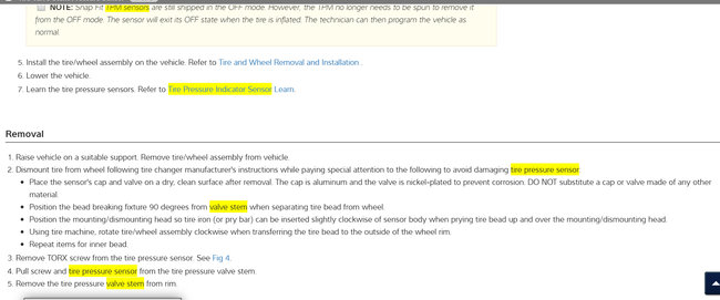

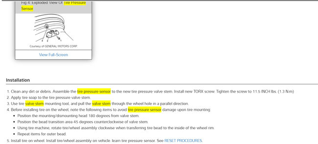

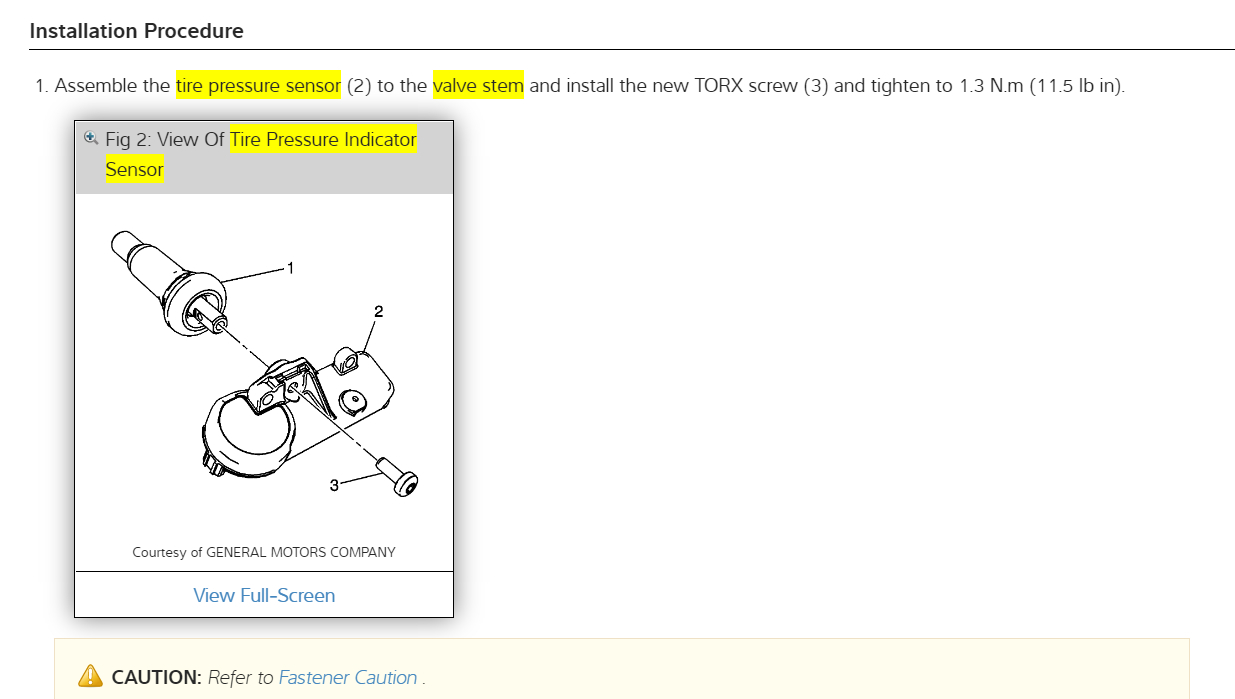

Here is how to replace the tire pressure sensors in the images below. Let me know how it goes.

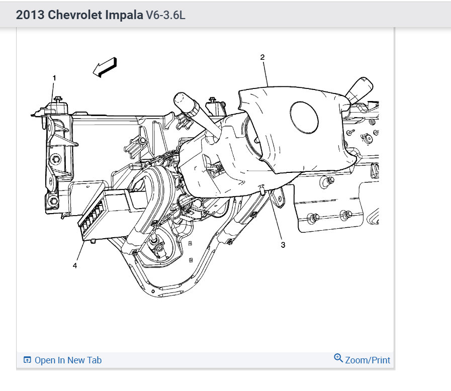

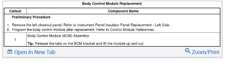

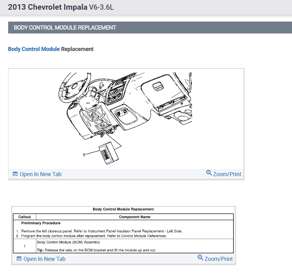

Here is how you can replace the BCM as well which you can get preprogrammed for your car from services if you search google.
