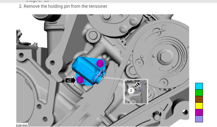

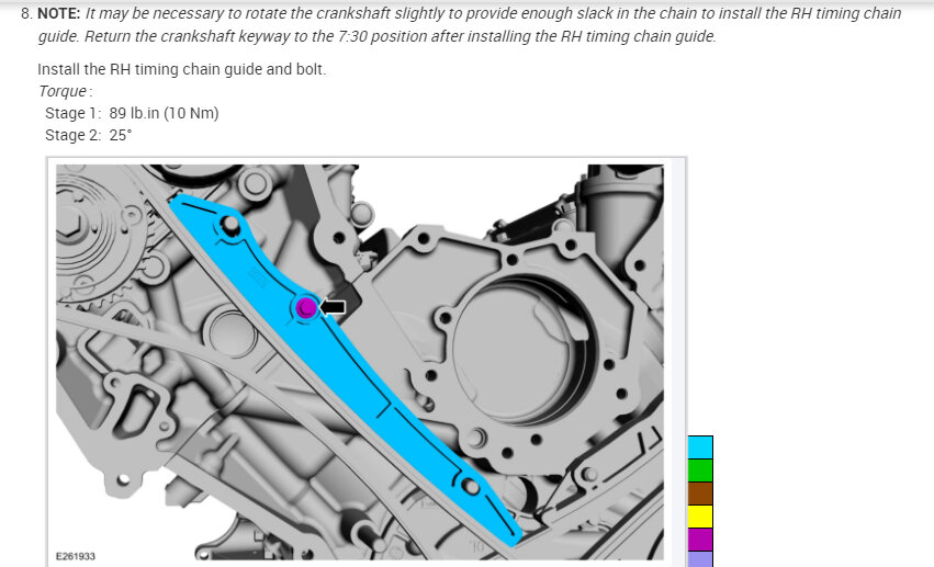

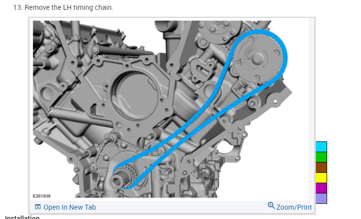

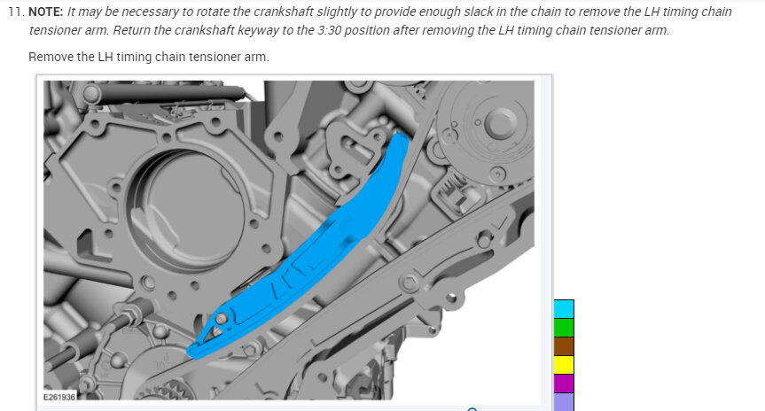

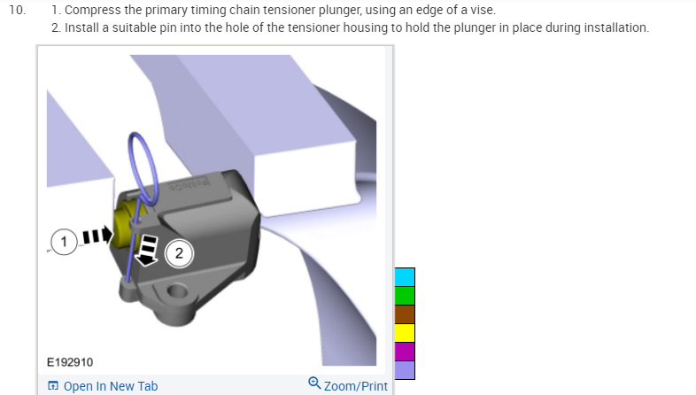

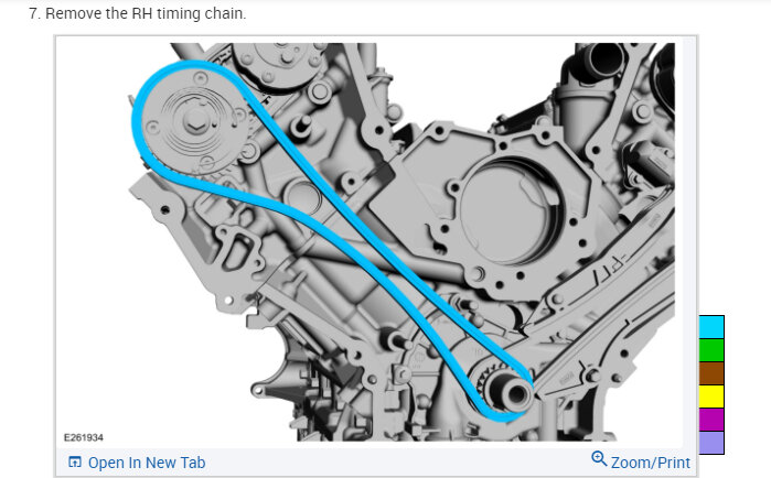

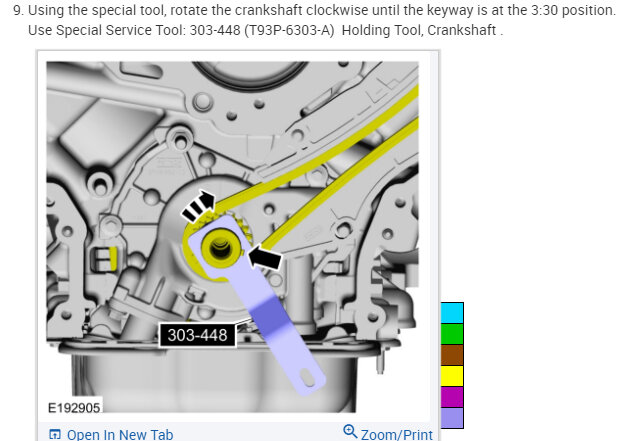

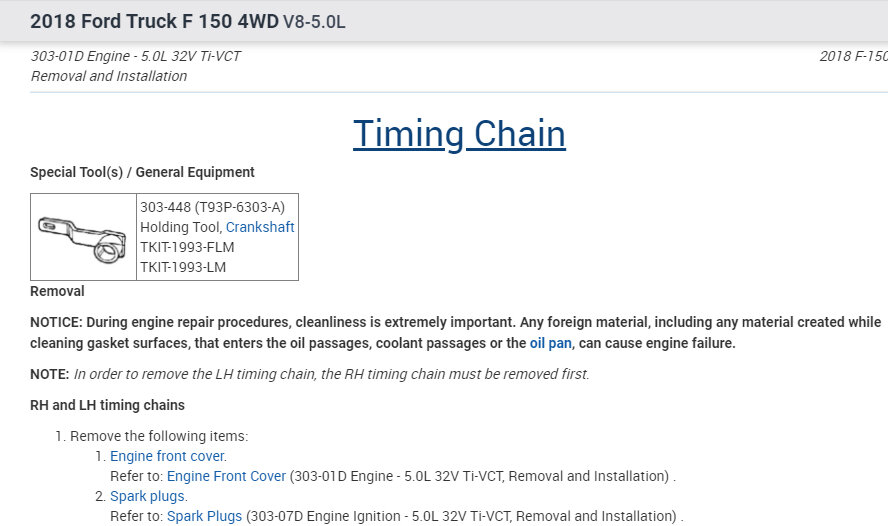

Timing marks diagram?
65,000 MILES • 5.0L • V8 • 4WD
JUEZZFANTAZMA13
Head replacement.
Nov 17, 2022 at 12:16 PM
  • 110,246 POSTS

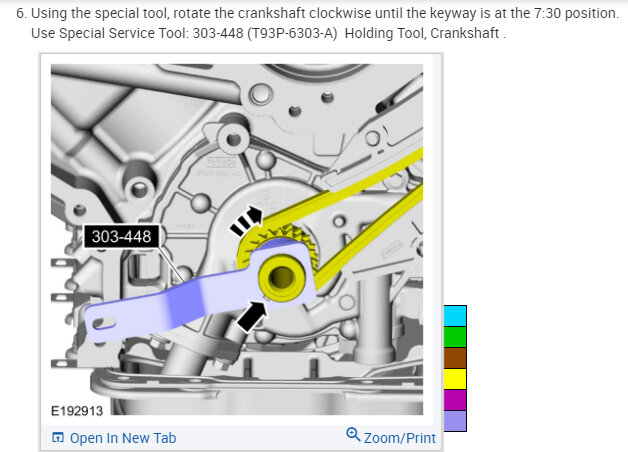

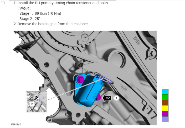

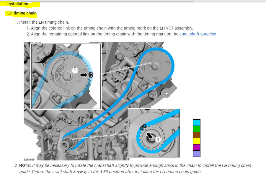

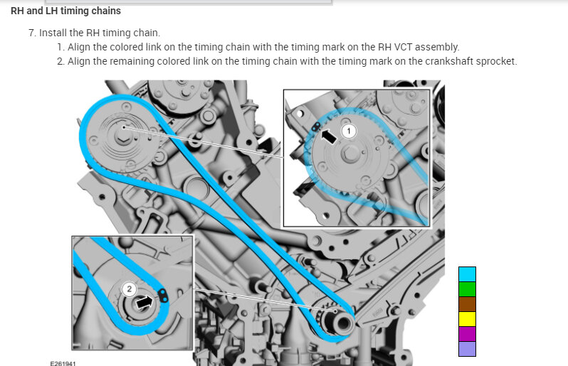

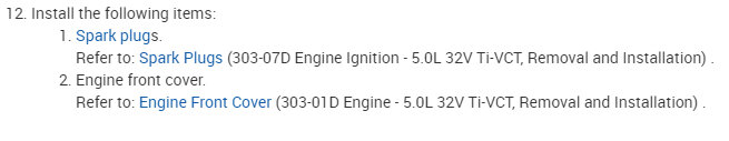

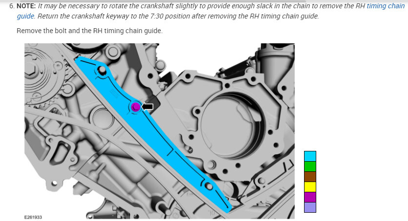

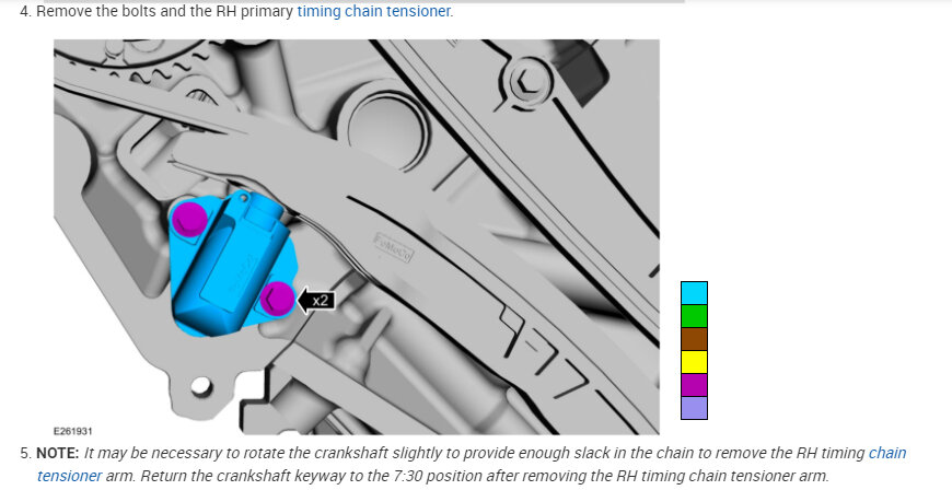

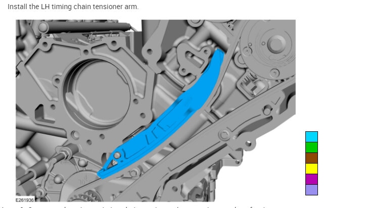

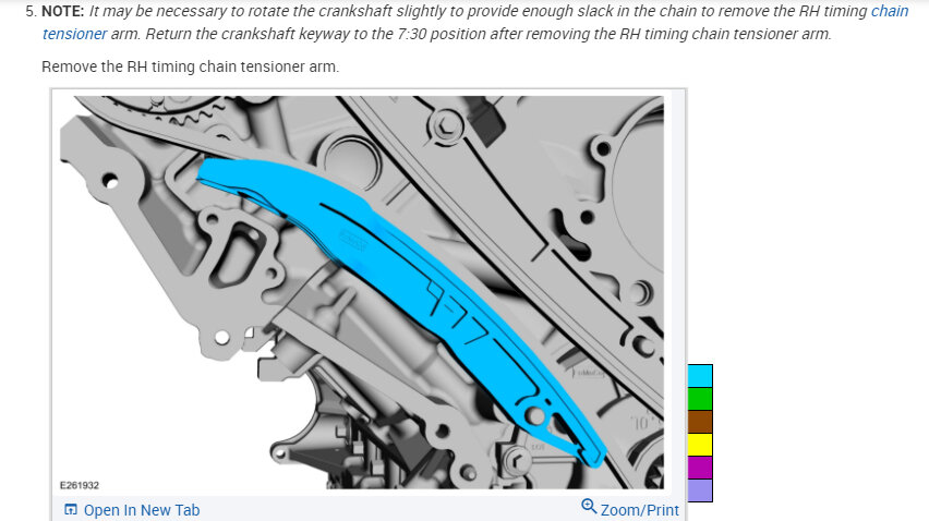

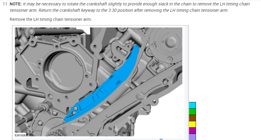

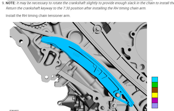

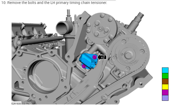

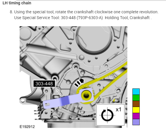

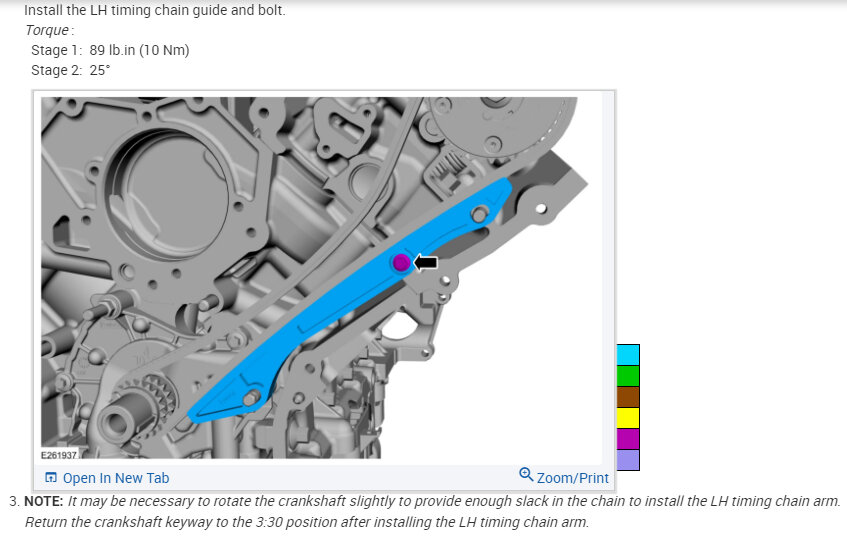

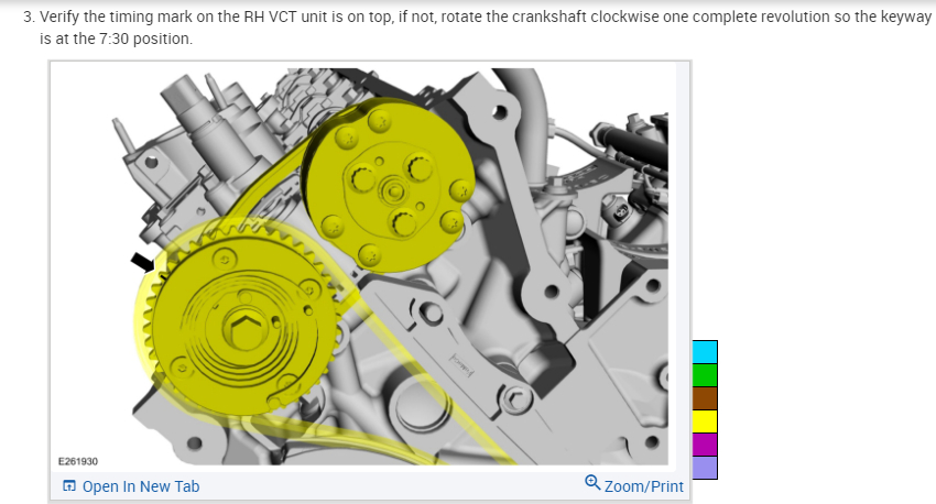

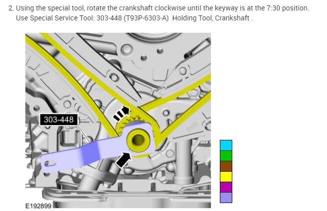

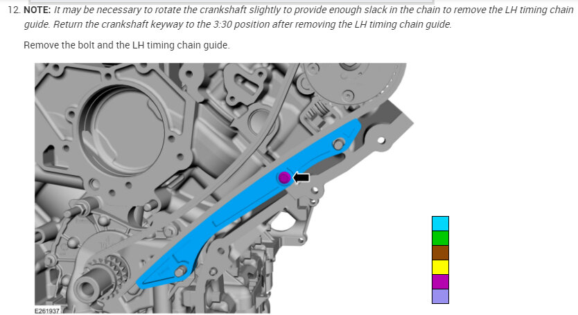

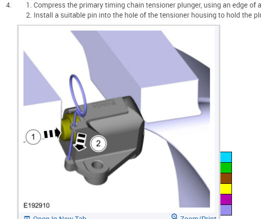

There are two chains. Are you replacing both heads or only one? If it is on the left side, the right needs to be removed first. If it is the right side, only the right needs removed.
Regardless, I attached all timing chain and component info below for you. If you need anything with the cylinder head such as torque specifications, let me know.
See pics below and let me know if that is what you needed. As far as timing marks, you will be focusing on colored links on the chain and positioning.
