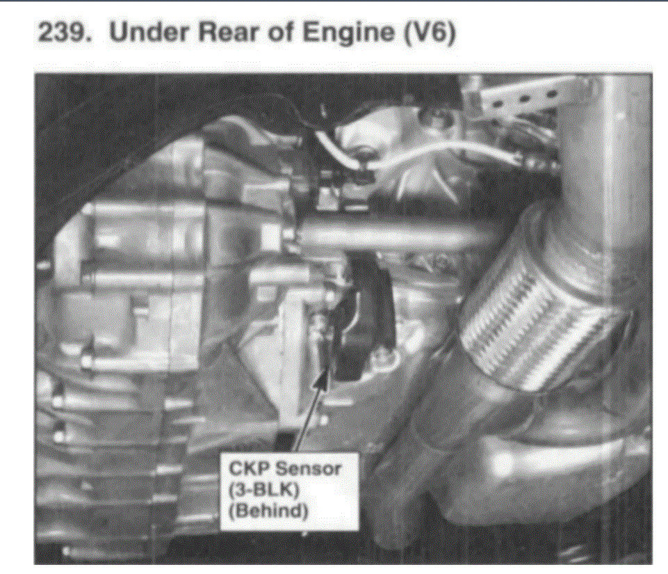

  • 110,248 POSTS
Are you certain the timing is correct? I hear a jump in the starter which sounds like low compression, at least in one of the cylinders.
As far as a compression gauge, most parts stores will lend one to you. However, if you don't have spark, we need to get that working first.
Since you noticed the tach, start by checking to make sure the crankshaft position sensor isn't damaged or disconnected.
The sensor is on the rear of the engine. See pic below.
Let me know what you find.
