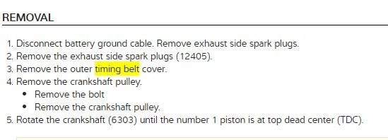

In the middle of replacing timing belt on my truck. Haynes manual shows a timing belt guide ( looks like a big washer) that slides onto crankshaft. There was no guide on it when I tore it apart ( broken belt was not OEM, so someone has been in it before). Ford does not list one for my year truck, but does for 1996, and back. I am told the washer would to keep the belt from sliding, but I do not see how it could slide (much). Any help would be appreciated.

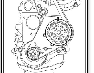

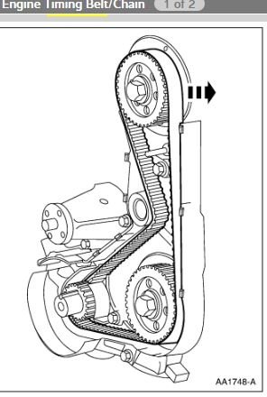

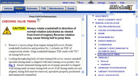

I just read through the removal and replacement process for this year. Nothing is mentioned about a guide. I have attached several pictures. The first ones are the directions for removal direct from Mitchel Prodemand (snap-on). You will see there is nothing mentioned. The last pictures are of the engine and nothing is indicated.
Let me know if this helps.

After the belt broke, and I took everything apart, I was careful to put all of the bolts, washers, etc. in clear plastic Ziploc bags, and I did not remember seeing the belt guide. I had to let it sit for a couple of weeks before I could get to putting it back together; when I started on it again, I got stuck on the timing, and a couple of people said, more as an afterthought, " do not forget to put the belt guide back on." Haynes manual shows one in a picture, but does not mention it. Now, both yourself, and the parts counter guy at the Ford dealership tell me that there is not one for my year truck. In the words of my favorite character from "O Brother, Where Art Thou," Delmar, says, " Well, I am with you fellows." I am going to start buttoning her back up, sans a belt guide. Thanks for the help.

First, that is a good idea to keep the parts removed in ziplock bags. I do it myself sometimes because there are so many things to keep track of. Then, with a sharpie, I label where each bag came from. It make it ten times faster to put things back together.
So, with that being said, I feel you are an organized person. If you do not have the part, do not remember seeing it, my manual does not show one, and the parts man at a Ford dealership said it does not exist on that year, I feel confident you have done it right.
This has been driving me crazy. LOL I think I may have figured out why your engine is different. Up until 1997, the 2.3L was used. In 1998, the 2.5 was introduced in this vehicle. Maybe you are looking at a 2.3 in the manual which is different. I believe the 2.3L did have the guide.
Regardless, I hope I have helped in some way. Take care and let me know if you have other questions.

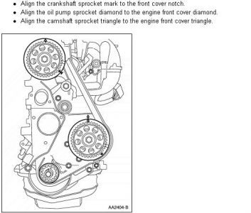

LILLIEIII
  • 15 POSTS
How do you align the timing mark perfect once the new belt is in place, timeing is so close the moter runs but can tell tinming is off
Nov 11, 2020 at 10:22 AM (Merged)

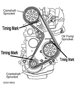

DOCFIXIT
  • 18,828 POSTS
Hi
https://images.2carpros.com/forum/automotive_pictures/198357_Graphic_113.jpg
Aling the gears as in diagram crank and Dist go 12 o'clock cam goes @ 5 o'clock Hope this helps Thanks for donate

LILLIEIII
  • 15 POSTS
Have align the proper points but having trouble getting perfect timing motor run but slightly rough need to know how to get alignment right on by stretching new belt
DOCFIXIT
  • 18,828 POSTS
When putting on belt start at cam then oil pump then crank NO SLACK get those big clips for papers and clip belt to each gear. Use wrecn to move gear slightly to get good belt placement. Then release tensioner. Rotate 2 turns check marks.
LILLIEIII
  • 15 POSTS
When doing a timing alignment, marks should be aligned with the marks on the back cover, the diamond or the triangle

BLUELIGHTNIN6
  • 16,542 POSTS
Hello and thanks for the donation! Timing marks diagram for your vehicle is below..
https://images.2carpros.com/forum/automotive_pictures/261618_Noname_902.jpg

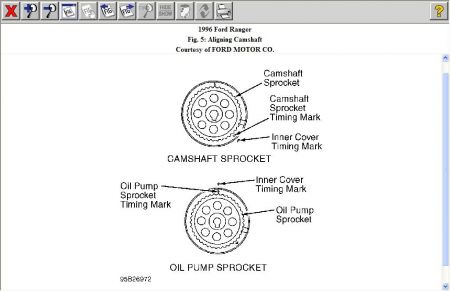

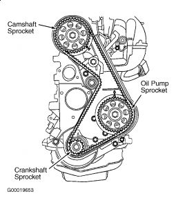

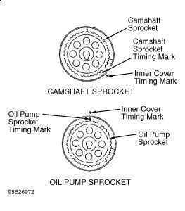

BACCHUS357
i have the truck ready for new belt, but i need to know here all the timing marks are and where to place them. thanks
  • 75,992 POSTS
See below
https://images.2carpros.com/forum/automotive_pictures/12900_cam_6.jpg
https://images.2carpros.com/forum/automotive_pictures/12900_cam1_3.jpg
RONSON
  • 77 POSTS
I was trying to locate A 2.3L head, but could not so I bought a running engine from the wrecking yard with 123,000 miles. I am getting ready to install it and I have a new timing belt to install. I am checking the timing, (as they told me they ran the engine before I purchased it). But after turning it manually the marks are off. When I put the crank key way at 12:00 the auxiliary mark is four teeth before the diamond and the cam mark is four teeth from the arrow. Is this the correct way to time a 1996 2.3L Ford Ranger? Any advice would be much appreciated. Thanks.
WRENCHTECH
  • 20,761 POSTS
https://www.2carpros.com/images/external/62574994.gif
JEFFERYSG
I broke my timing belt in my 1996 Ford Ranger 2.3L 4 Cyl. I was wondering what the possiblilty was that i bent any valves? Thanks you
Nov 11, 2020 at 10:23 AM (Merged)
MHPAUTOS
  • 31,937 POSTS
Hi there,
From the information i have to hand , this is a non interference type engine so you should not have any valve problems.
Mark (mhpautos)
