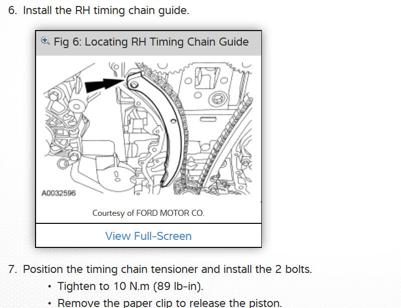

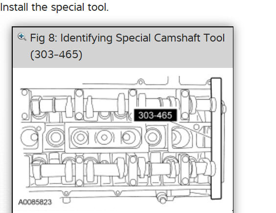

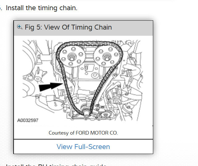

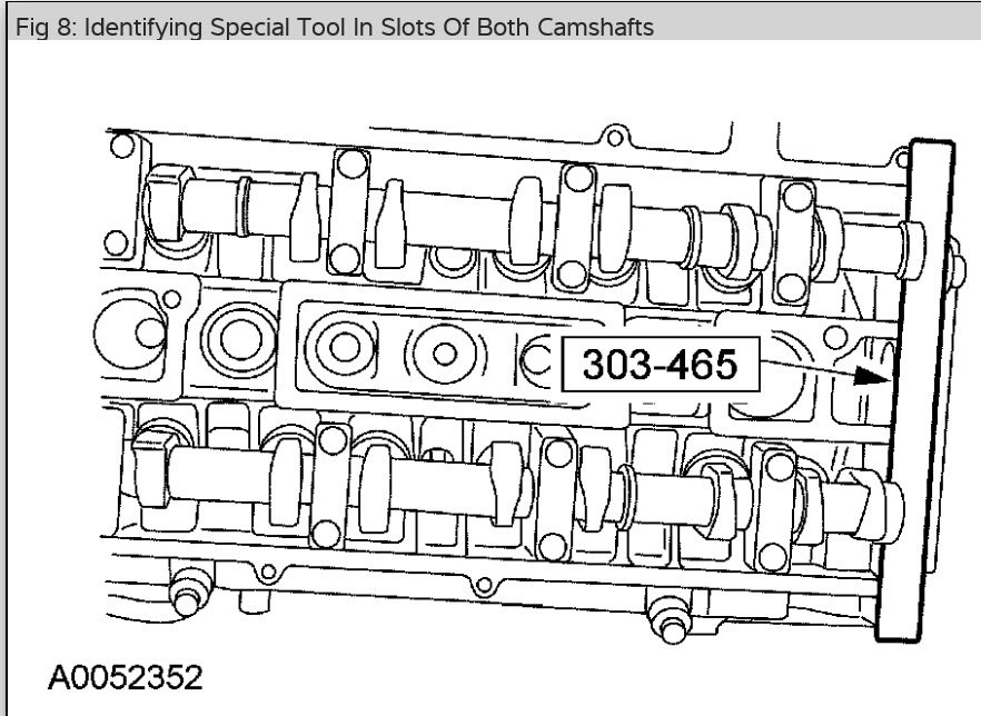

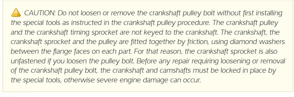

Cannot find any references to timing marks.
Jan 12, 2017 at 9:21 AM
HMAC300
  • 48,601 POSTS

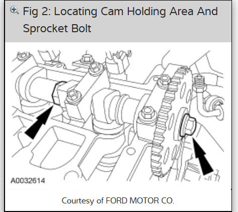

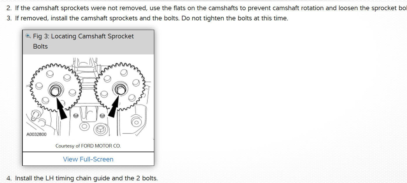

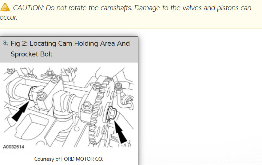

there are no timing marks, you must lock down cams with special tool or one like it prior to replacing timing chain. See pictures.

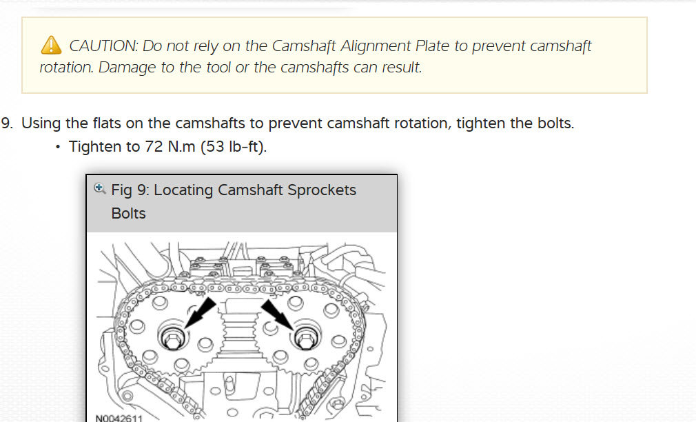

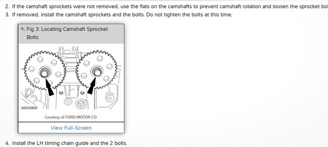

the sprockets have to come off and use a flat tool to align cams with slots in cam then lock them down and put sprockets on as well as chain. See pictures.

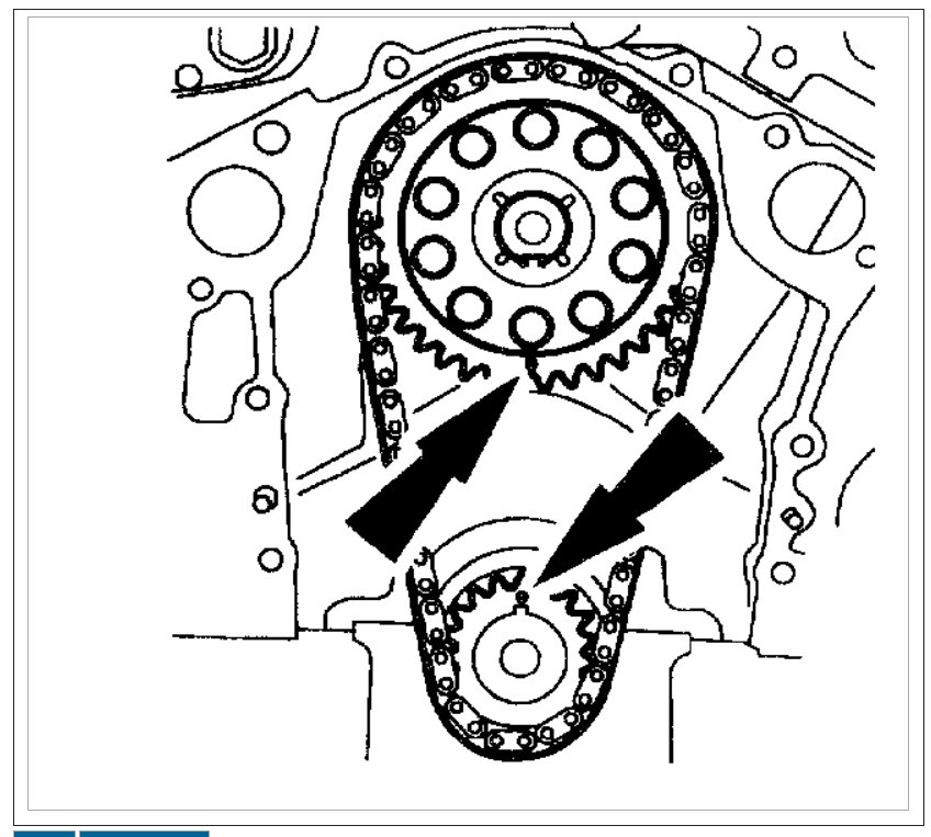

Ford, 2002, 3.0 V6, how do you figure when is TDC to install new Camshaft Synchronizer.
Nov 27, 2020 at 10:57 AM (Merged)
FIXITMR
  • 9,990 POSTS
this can be difficult because there is no timing indicator on the front of the engine like the good old days. Here is what the book shows.
You would need to remove the valve cover on the #1 cylinder side and make sure the valves are not open then remove the spark plug on #1 and watch it with a flashlight.
