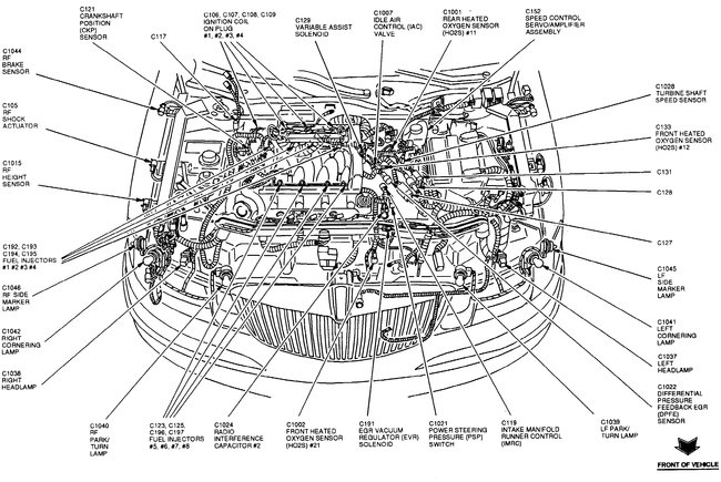

It drove fine until I pulled in home one day and will not start now.

Often times, a bad crankshaft position sensor will fail and the engine will lose spark. Take a look through this link:

What you need to do is this, check to see if there is spark and fuel to the engine. One will most likely be missing or weak. Here are general directions for both:

If you find there is no spark, my first suspect would be the crankshaft position sensor. The Crankshaft Position Sensor is located at the lower right side of engine, near heated oxygen sensor #22. See the attached picture.
