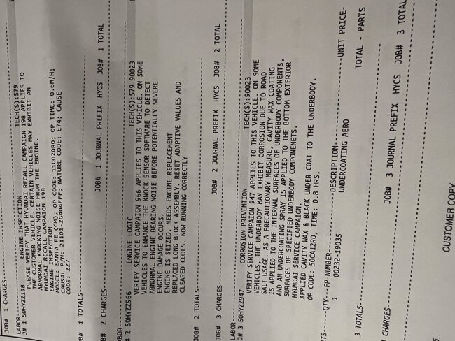

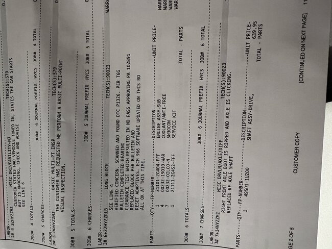

Hi Joe, Ken, et al. I got my vehicle from the dealer repair shop today. It drives like new! Attached are images of the repair list showing what they completed. Everything at no charge, covered by the recall, except for a right front axle boot/shaft, lower ball joints and a $120.00 wheel alignment. I'm sure I paid premium on those since it was a dealer. But overall, you helped save my car and thus saved me money. So, thank you again.

Thanks for the update. Wow! This is good news. Now, the engine is new, and you should have no issues with it.
I'm really glad to know you got it under warranty. I had a feeling you would.
