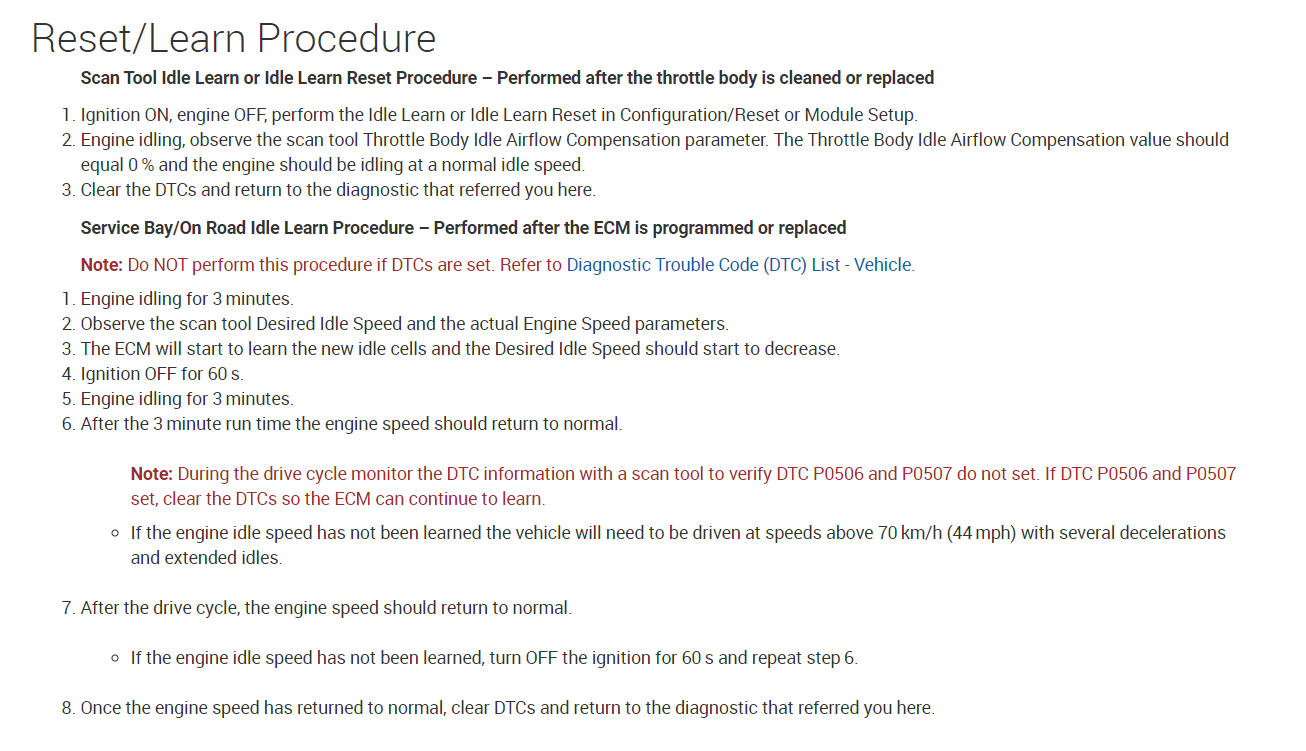

Good morning,
It sounds like you have battery issues if you have to charge it up to get it to crank. I would do a load test and verify the charging system.

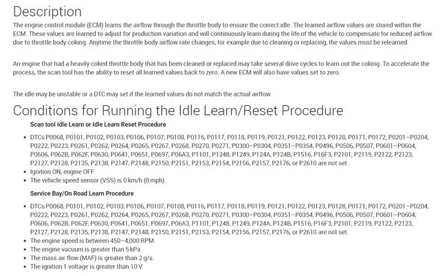

I attached the process for you of the relearn of the throttle body.

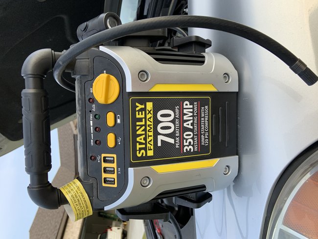

So I’ve had my battery hooked up to a charger for about 45 minutes and it’s been stuck at around 4 volts with my multimeter. I’ve attached an image of the charger I’m using. It appears it’s capable of having it charged already. There’s no power setting so maybe it’s feeding it 350 amps? That seems high. Should I just charge it longer? Or do you think there’s a problem here we could diagnose? Thanks
May 18, 2021 at 10:34 AM
Replace the battery. 4 volts is no good. You need 12.4 to 12.6 volts for it to work.
