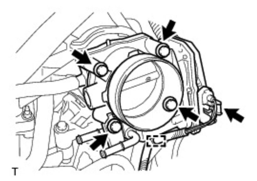

Is there a certain way to calibrate electronic throttle body assembly ? It's on intake manifold driver side.
Jul 11, 2020 at 10:37 PM
Good morning,
I attached the initialization of the throttle body for you.
https://www.2carpros.com/articles/how-a-throttle-body-works
Are there any issues that lead you to do this procedure?
PERFORM INITIALIZATION
NOTICE:
Be sure to perform this procedure after reassembling the throttle body or removing and reinstalling any throttle body component.
Perform the following procedure after replacing the ECM, throttle body assembly or any throttle body components. The following procedure should also be performed if the throttle body is cleaned.
Be sure to perform this procedure after replacing the ECM and reconnecting the battery cable.
Disconnect the cable from the negative (-) battery terminal. Wait at least 60 seconds and reconnect the cable.
Turn the ignition switch to ON without operating the accelerator pedal.
NOTICE:
If the accelerator pedal is operated, perform the above steps again.
Connect the Techstream to the DLC3 and clear the DTCs . [ 2GR-FE ENGINE CONTROL: SFI SYSTEM: DTC CHECK / CLEAR ]
Start the engine and check that the MIL is not illuminated and that the idle speed is within the specified range when the A/C is switched off after the engine is warmed up.

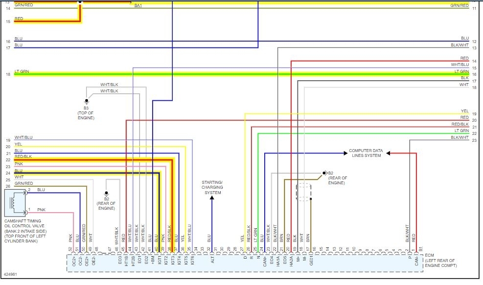

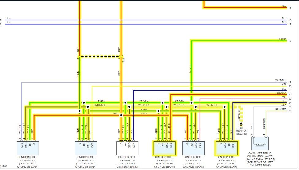

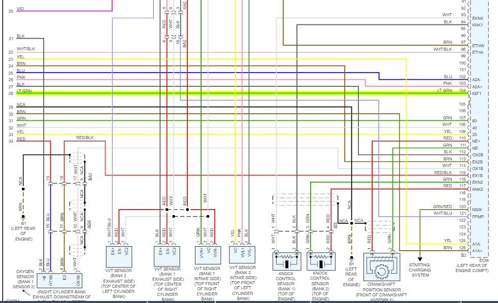

Also need ignition coils wiring diagram. Getting weak spark on cylinder 1 and 3. Any help would be great. thanks!!!
Jul 15, 2020 at 8:42 PM
Okay, I attached the wiring diagram for you of the ignition system.
Do you have any codes set in the system? If so, can you give those codes so I can help narrow the area of failure.
You will have a battery feed with the key on to the coil. Then the ECM will command it to fire based on the position of the crank sensor.

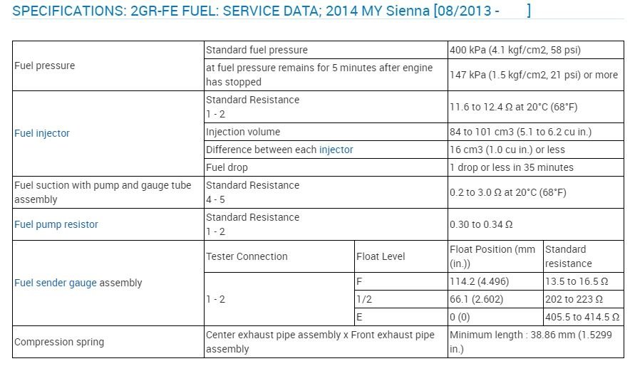

Still getting codes p0301,p0303 and p0305. after installing new spark plugs, checked coils, injectors and vacuum. But there is some noise coming from that Head Cylinder.
Jul 16, 2020 at 8:45 PM
Okay, I wish you would have told me about these codes in the beginning.
I would start with a compression test to verify no internal engine issues.
The most common failure for the 300 code is fuel pressure you need to test the fuel pressure to be sure there is sufficient pressure to the injectors.

Will lack of fuel pressure cause noise in head cylinder ? But will do compression test after work. Plus i think i need adapter for fuel check.
Jul 16, 2020 at 11:53 PM
Can you upload a video of the noise from the head?
Keep me updated.
Jul 16, 2020 at 11:56 PM
MECANICO3
  • 32 POSTS
Turned out to be no compression on cylinder on #1 (valve spring broken).Waiting on special socket for head cylinder bolts to arrive.. Can you provide timing procedure on on chains? Thanks very much in advance !!!
