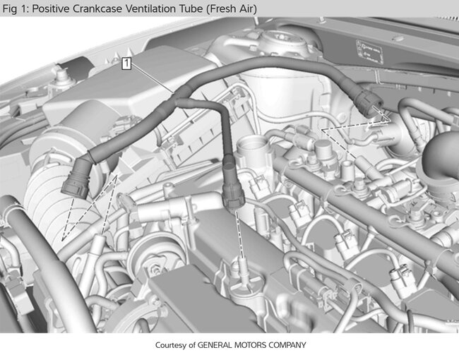

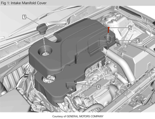

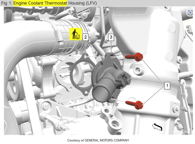

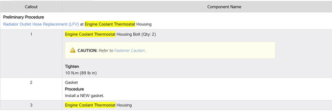

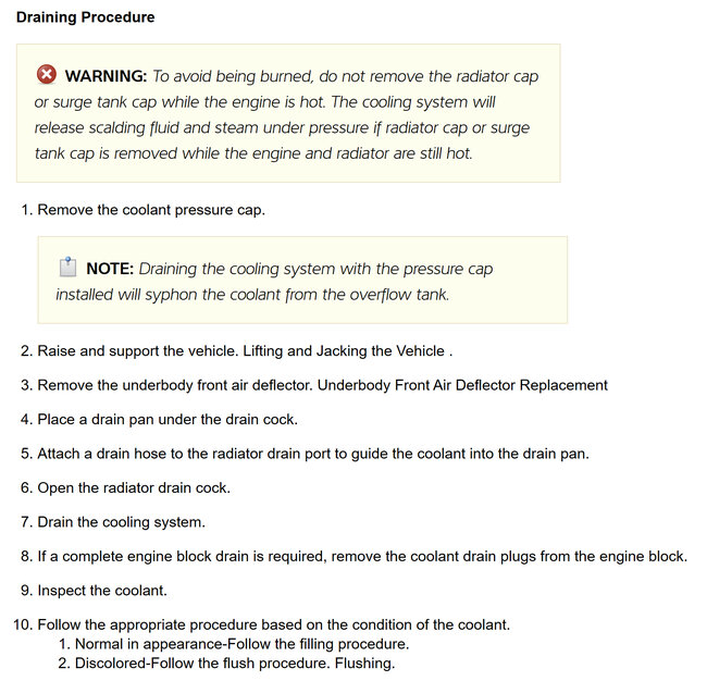

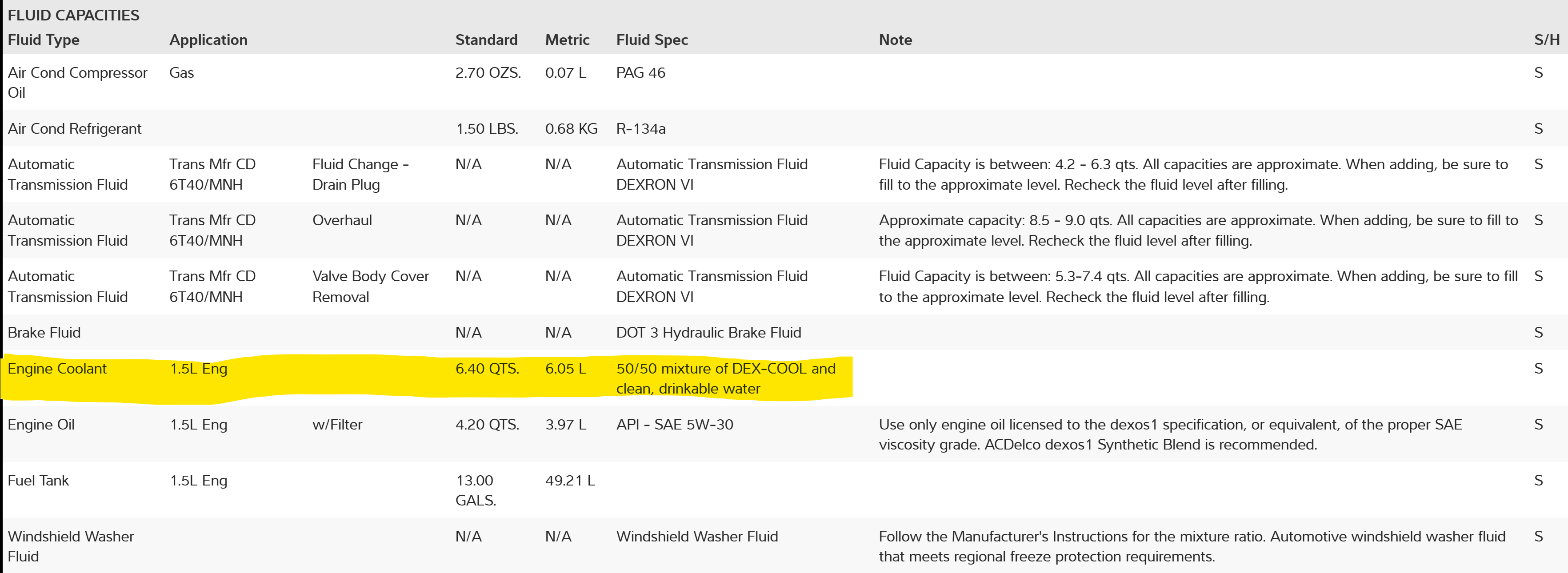

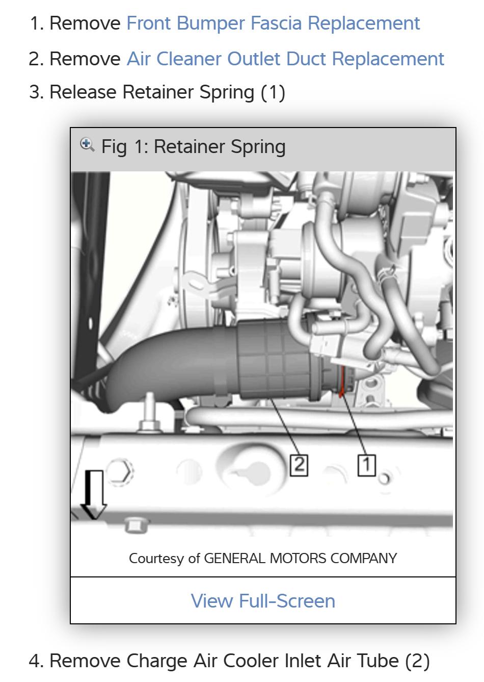

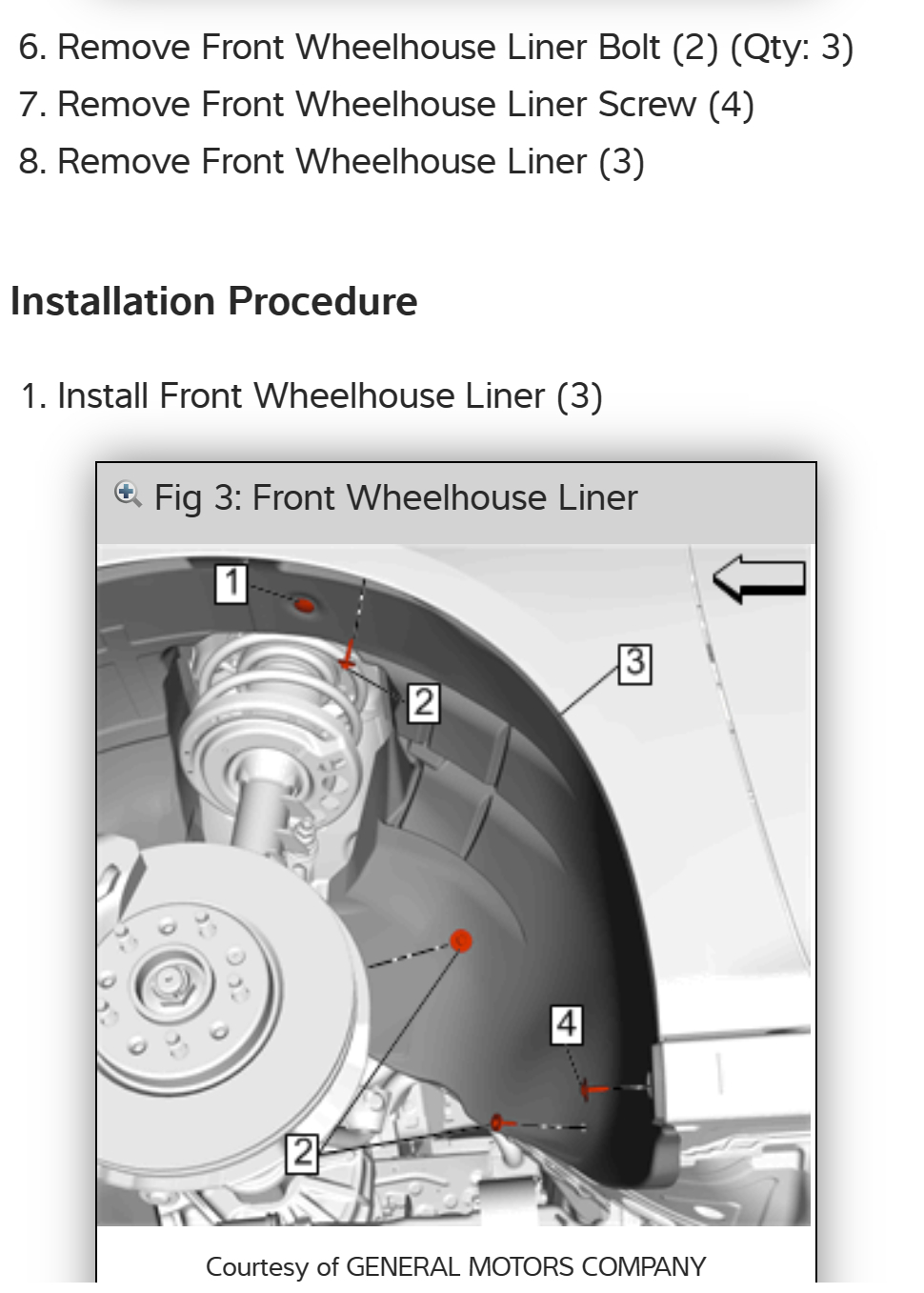

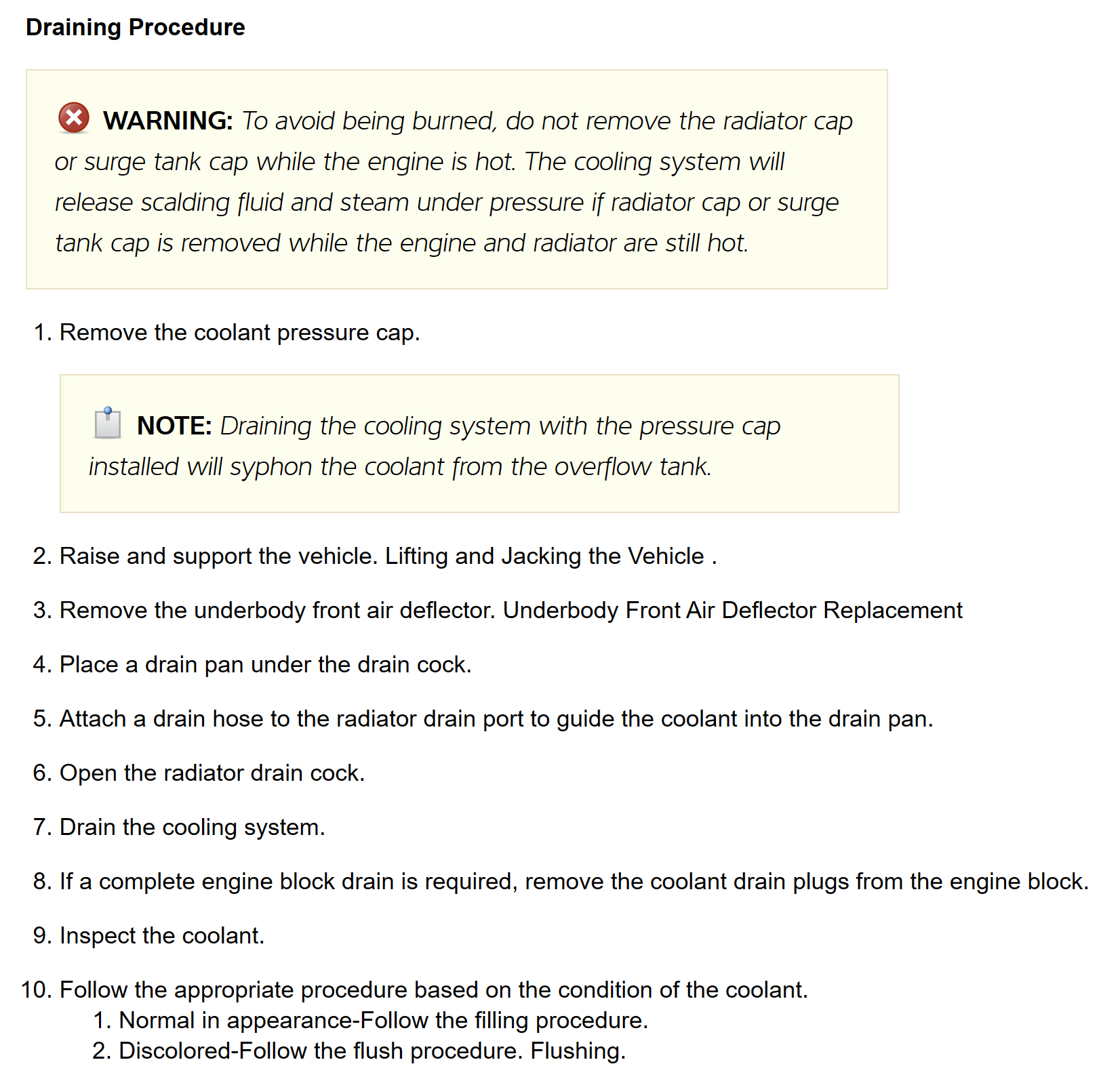

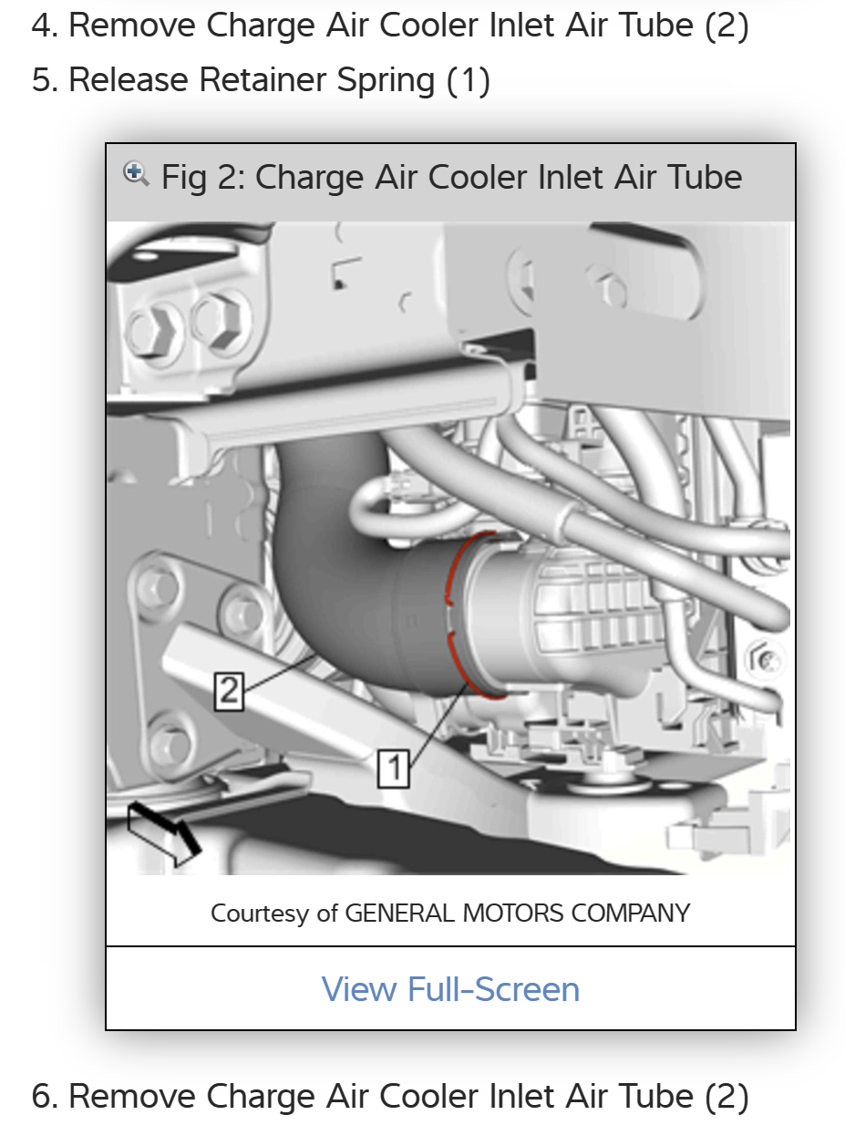

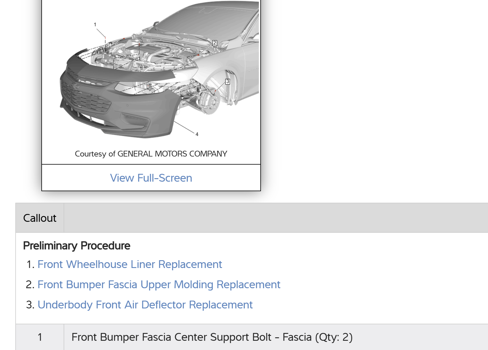

I'm trying to replace my thermostat and I'm having trouble finding it. can someone give me some information on how to locate remove and replace it? Please

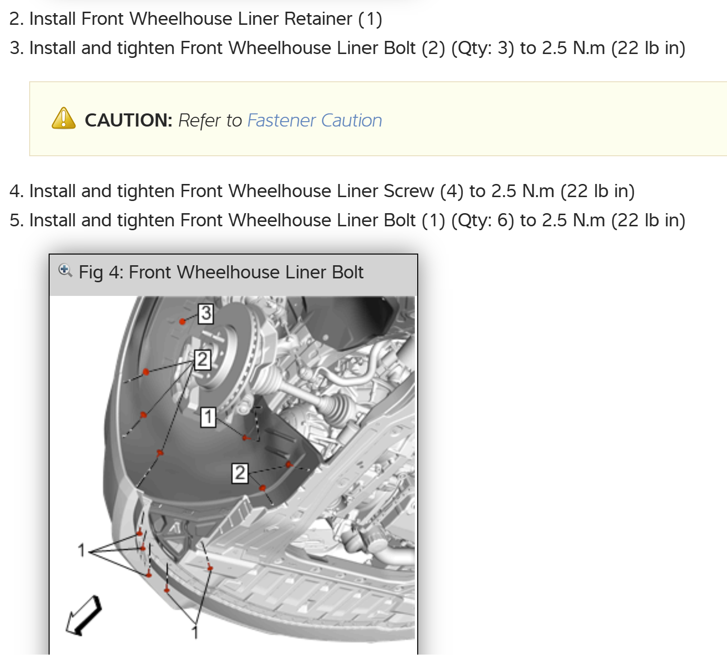

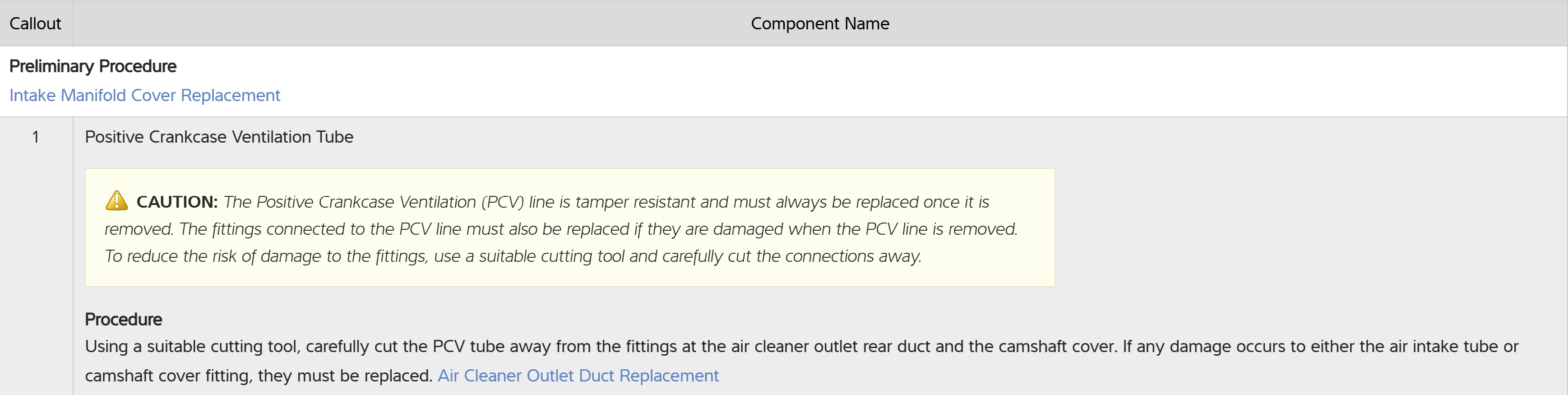

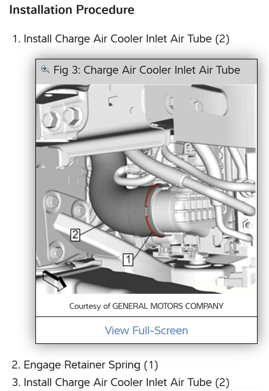

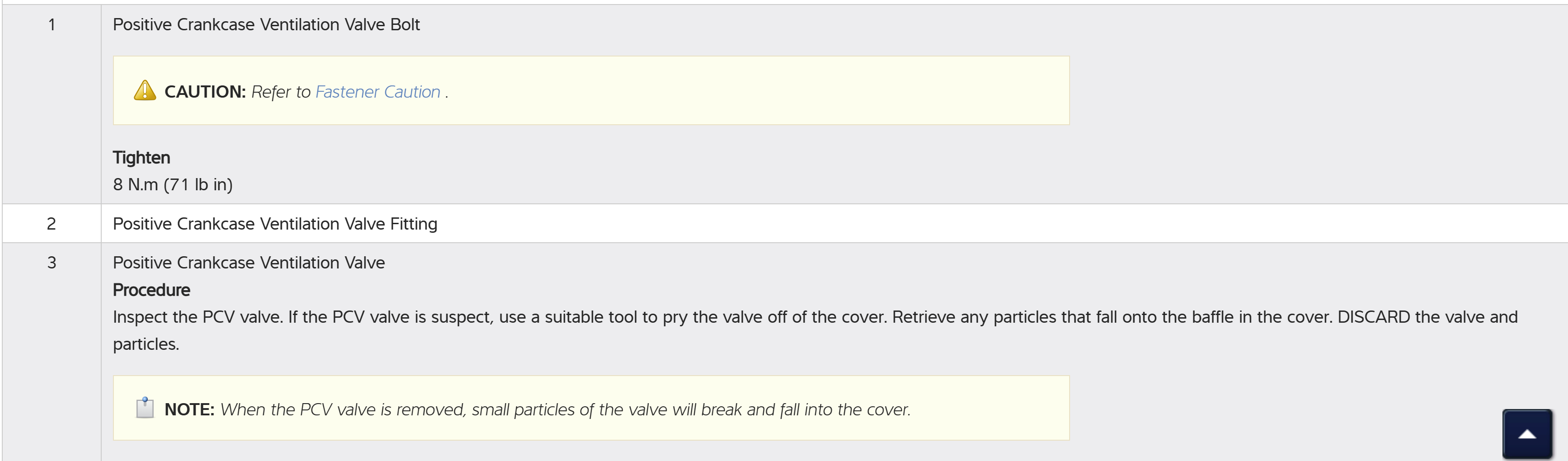

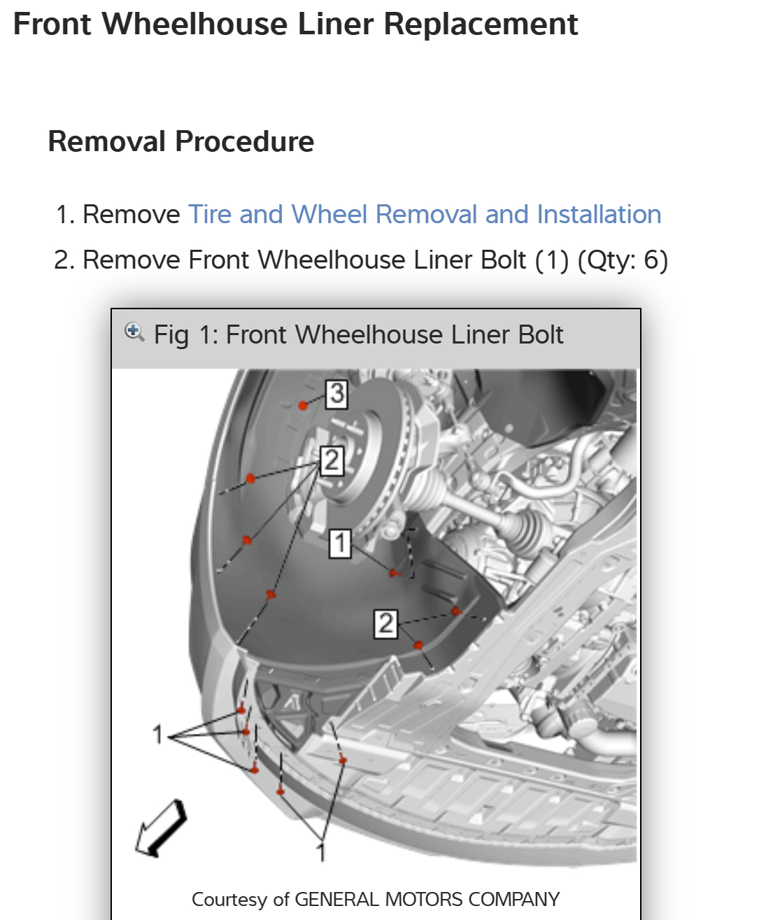

I noticed two questions from you that are nearly the same did you ask twice are did you have a problem with the site? Anyway here is the location of the thermostat and how to change it out. Check out the images (below). Let us know if you need anything else.

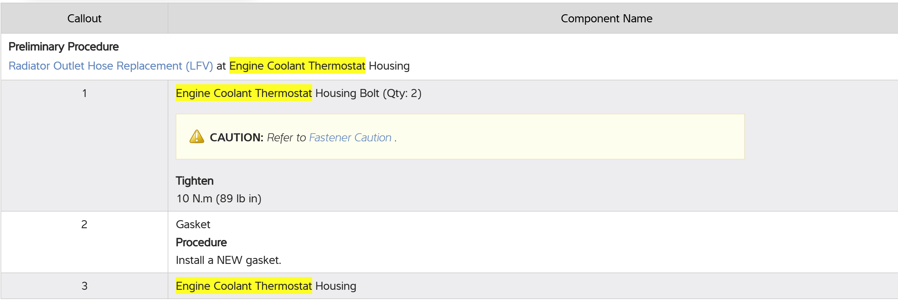

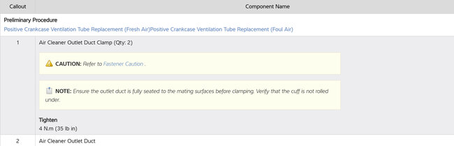

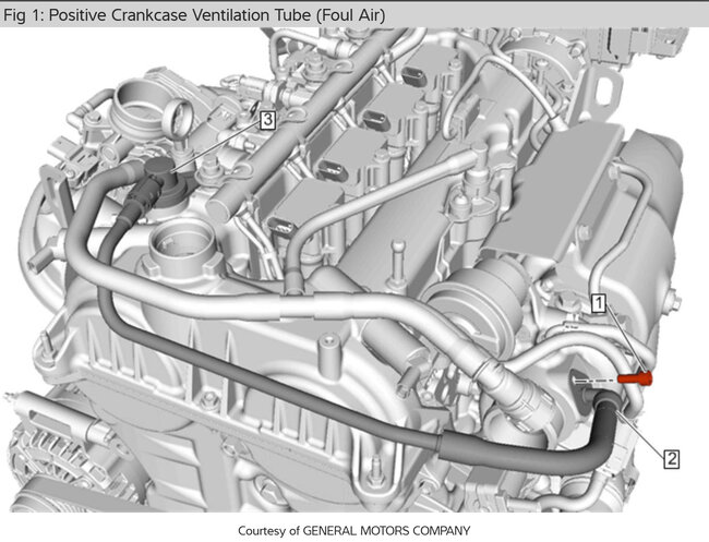

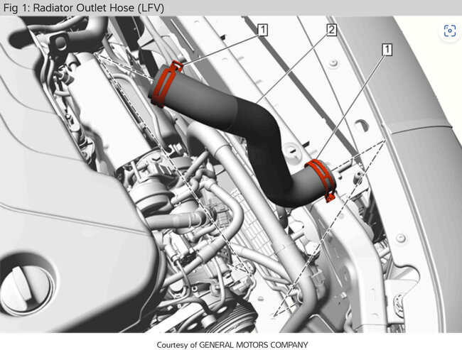

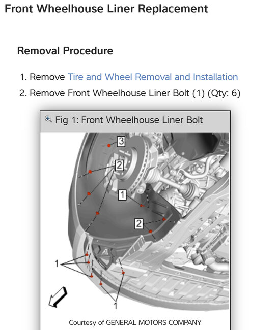

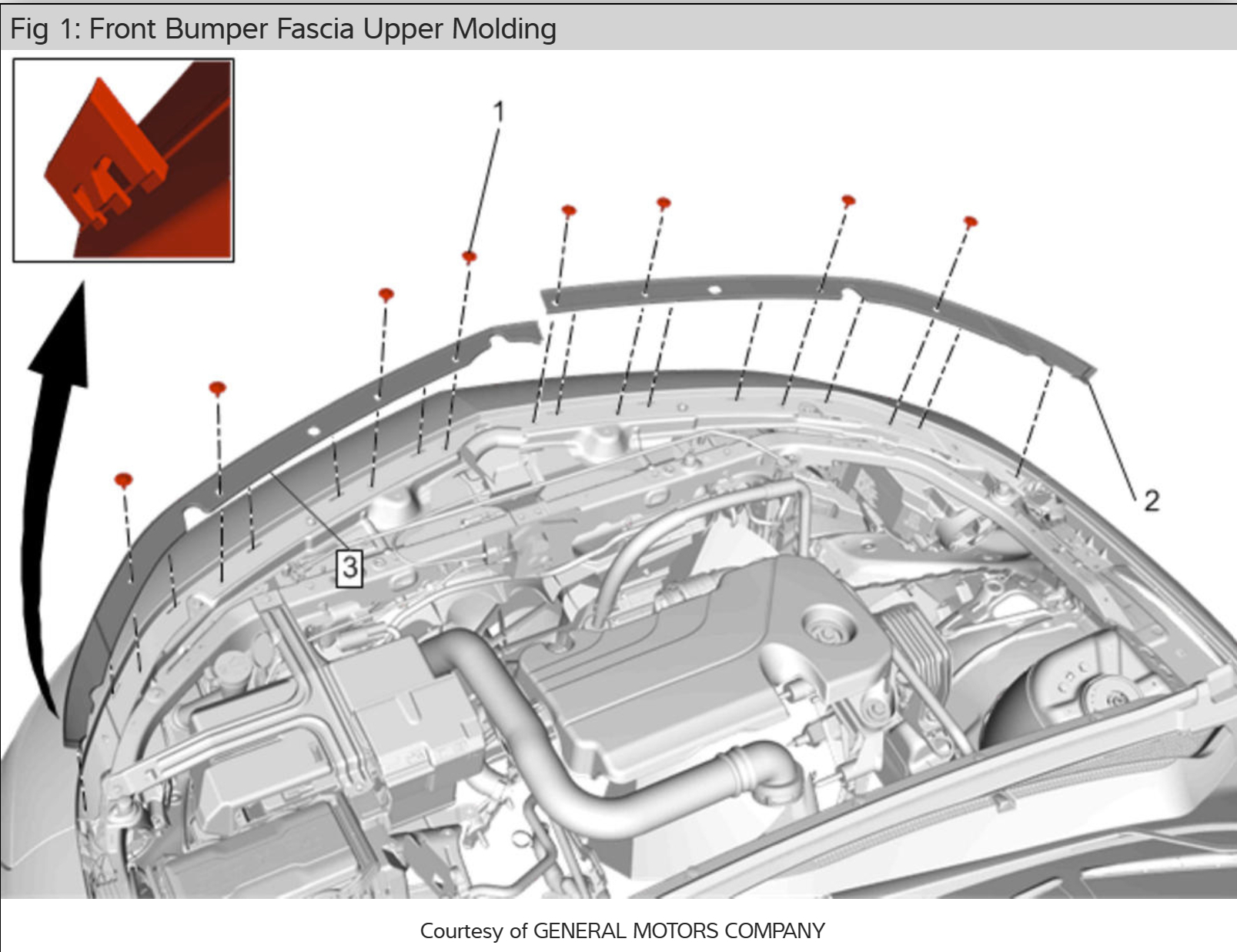

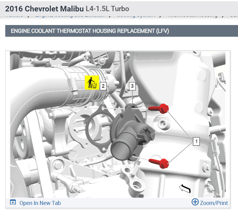

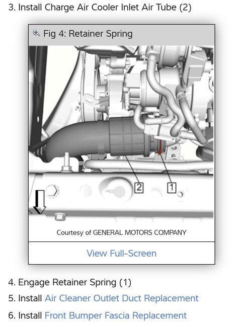

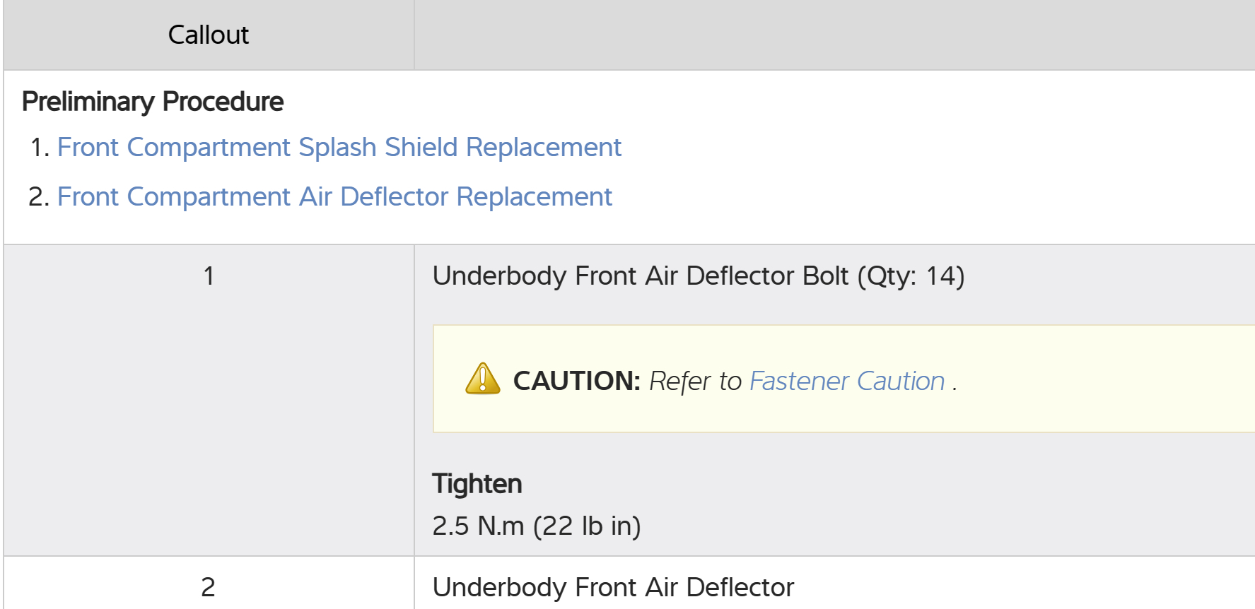

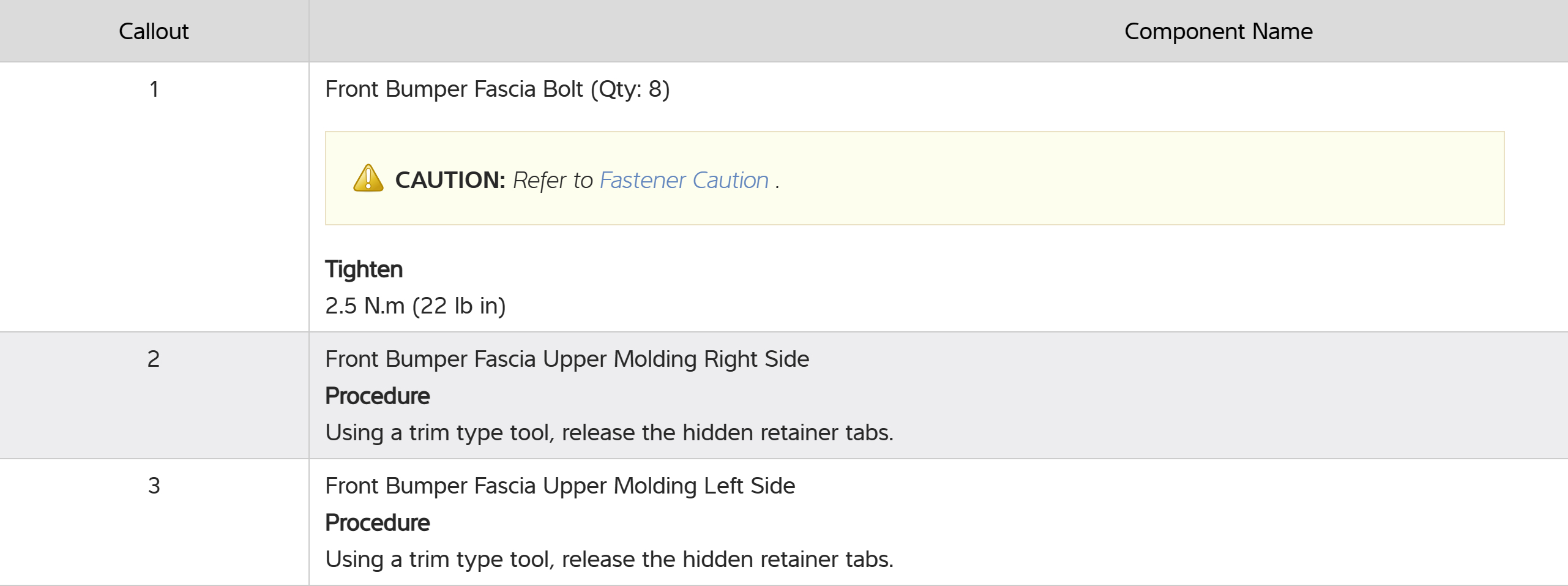

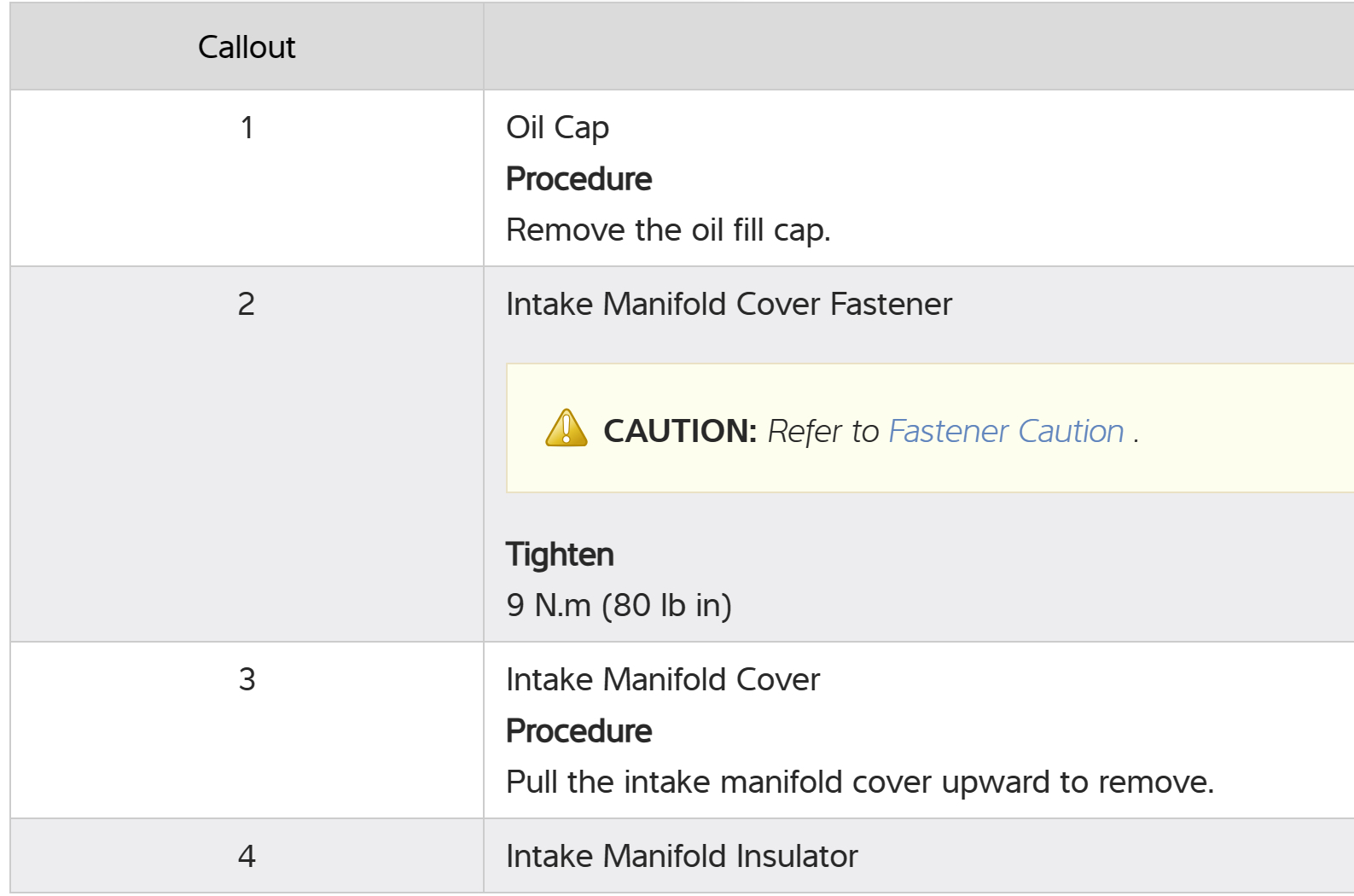

Hello QUANWALK87,

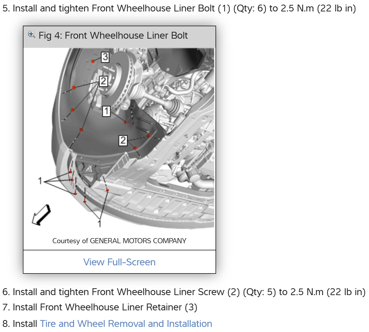

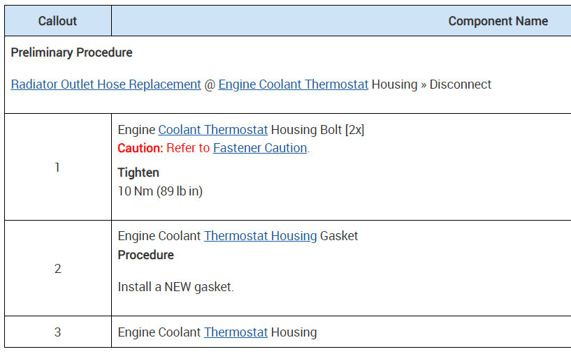

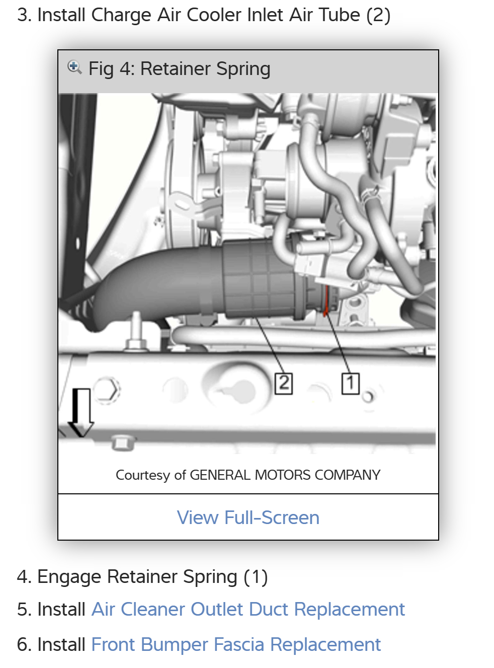

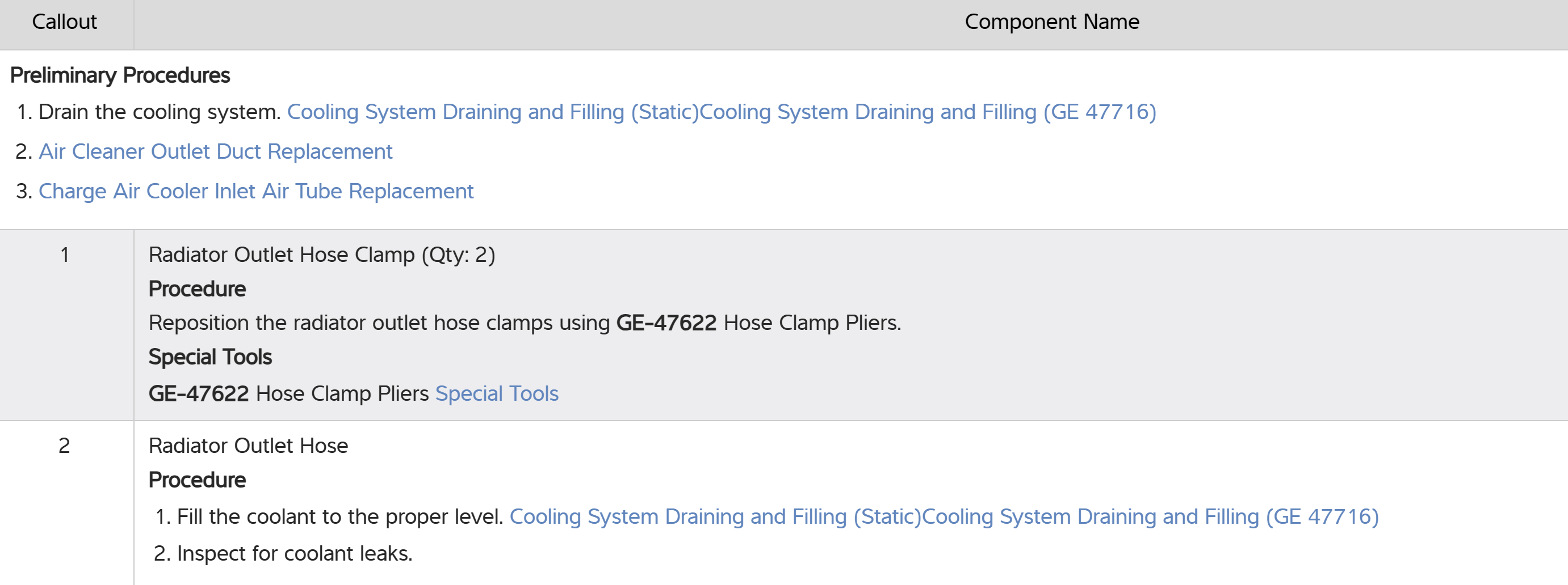

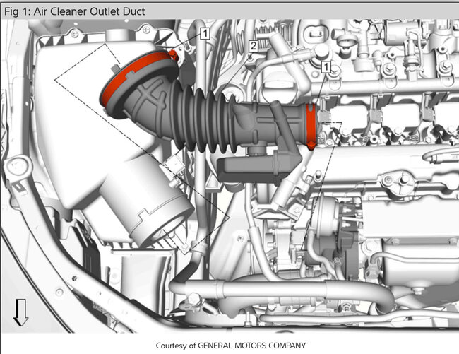

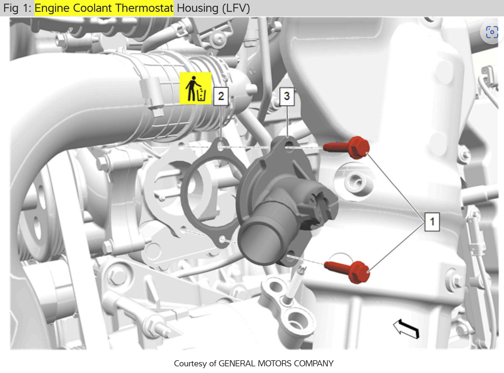

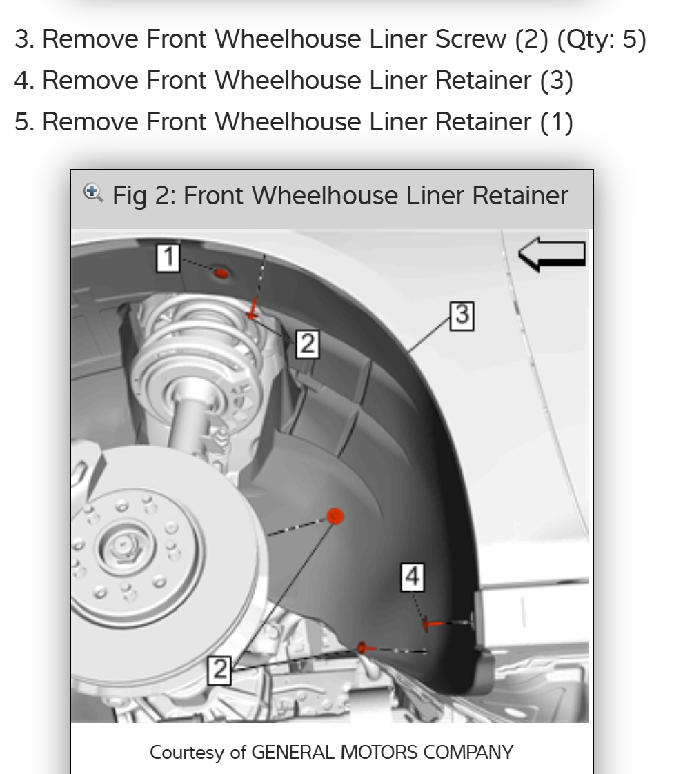

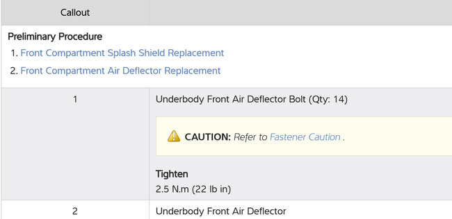

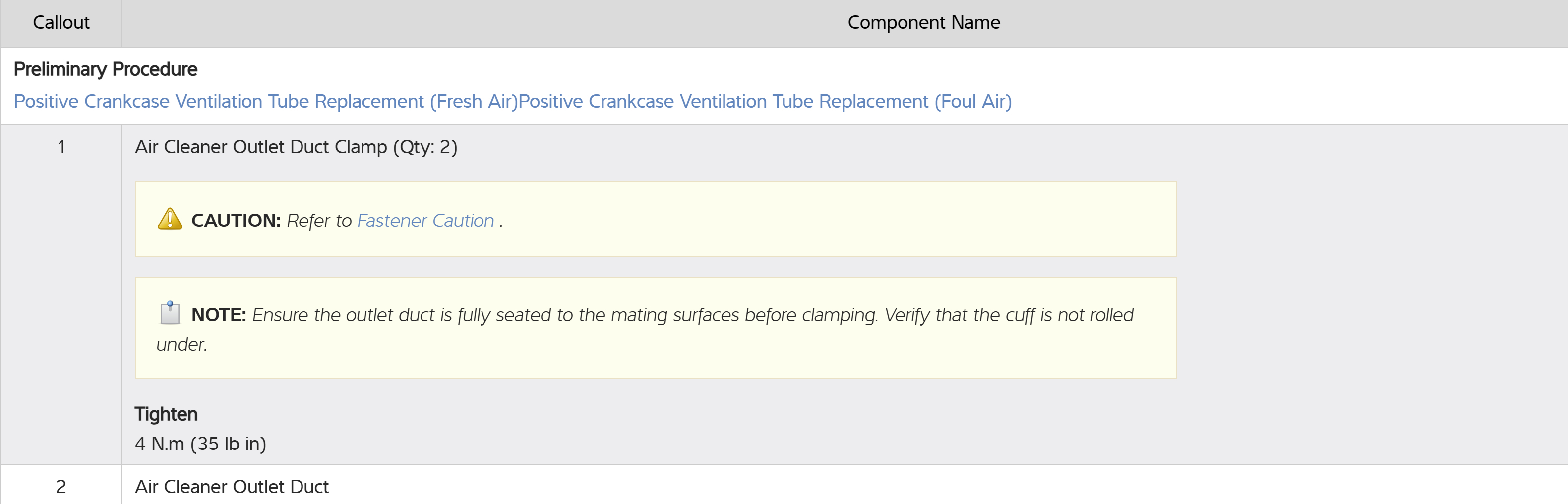

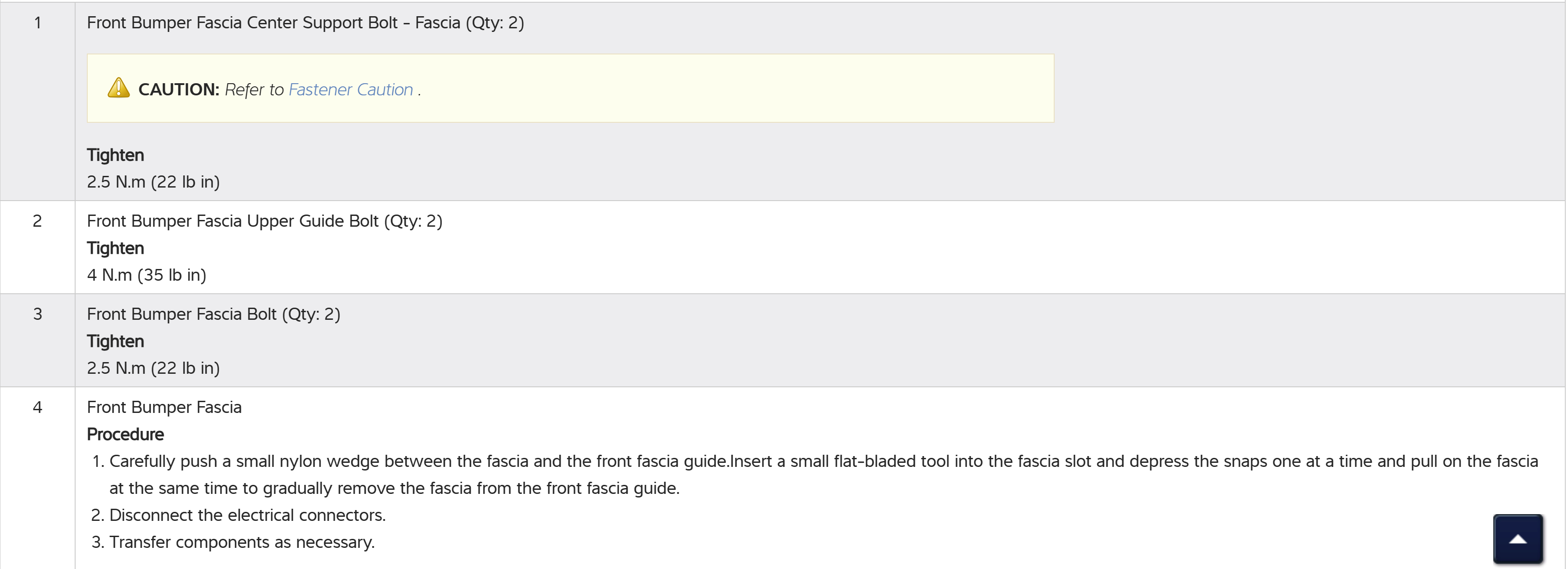

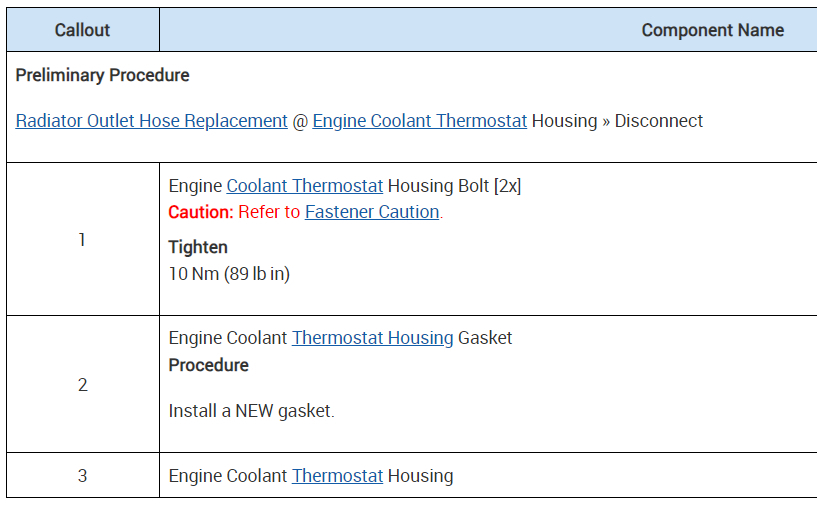

Looks like it is going to be on the left front of the engine. You may need to remove the air duct to see it.

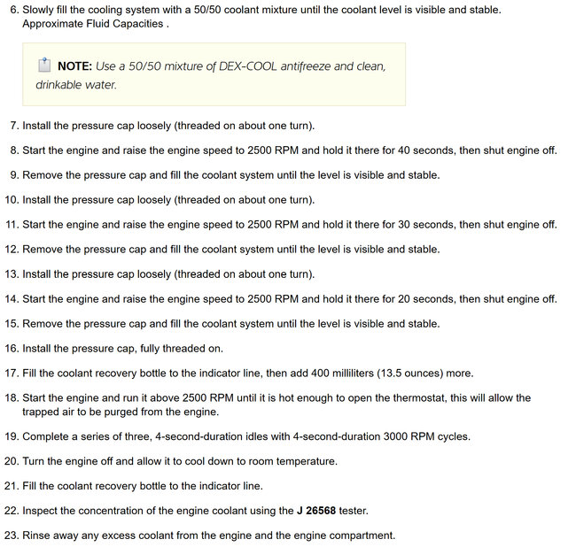

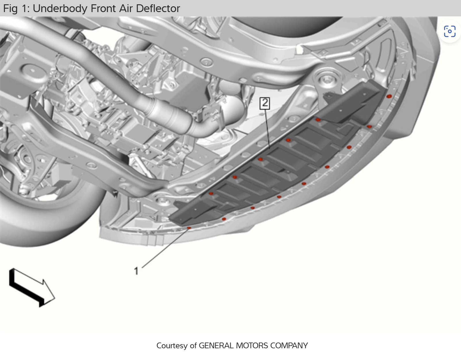

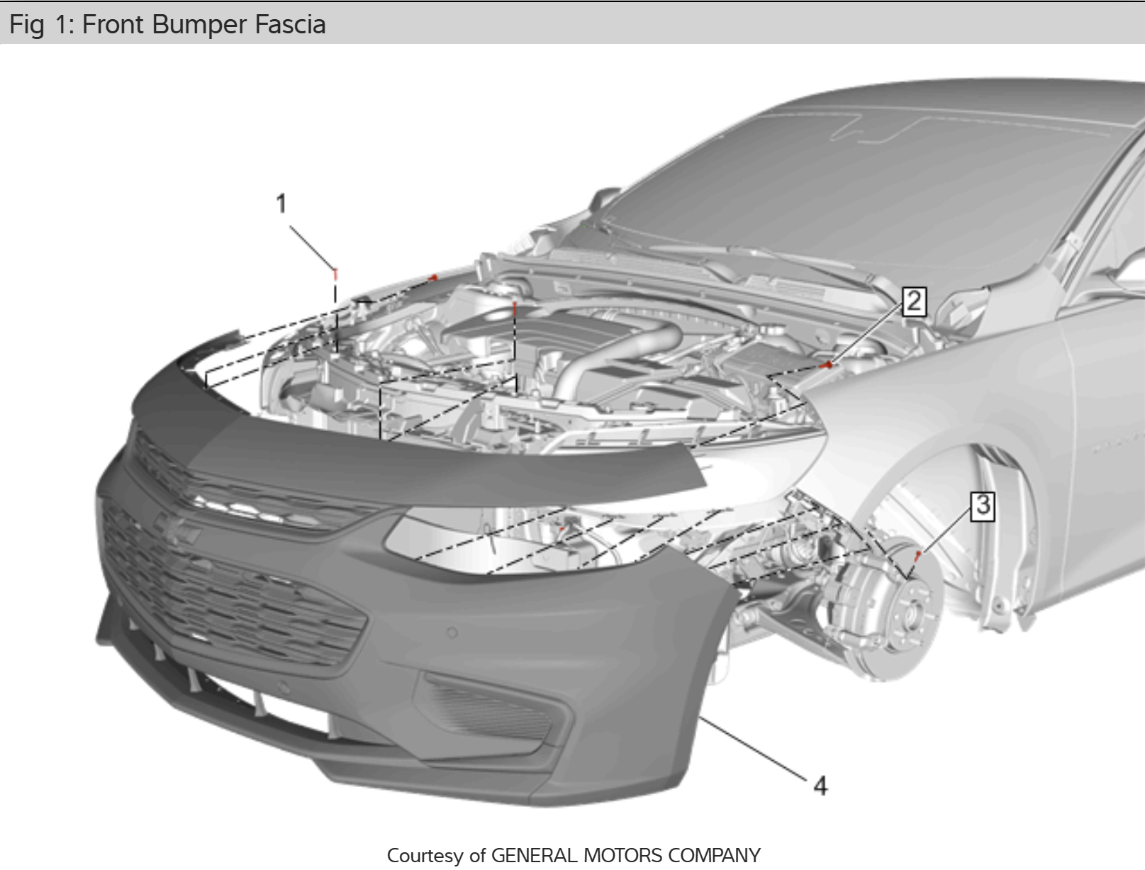

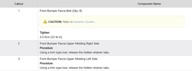

I am adding the procedure from my manual for this job. However, these manuals can sometimes have you removing things you don't necessarily have to remove. So, I have provided all recommended removal and installation procedures for you for every part the service manual wants you to remove but I would look and see if you maybe only need to partially remove something, or you can get by it.

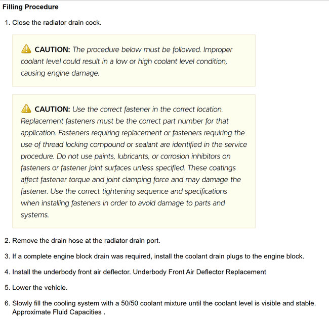

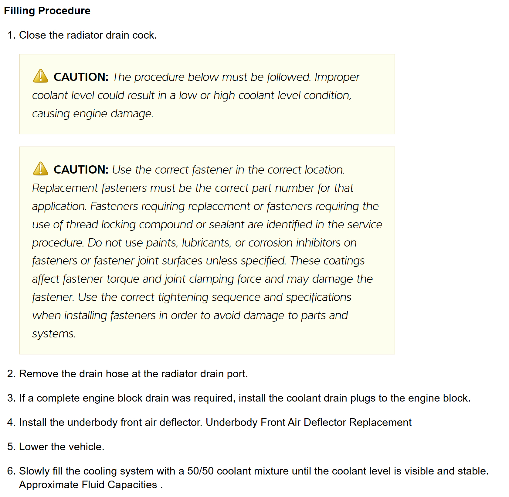

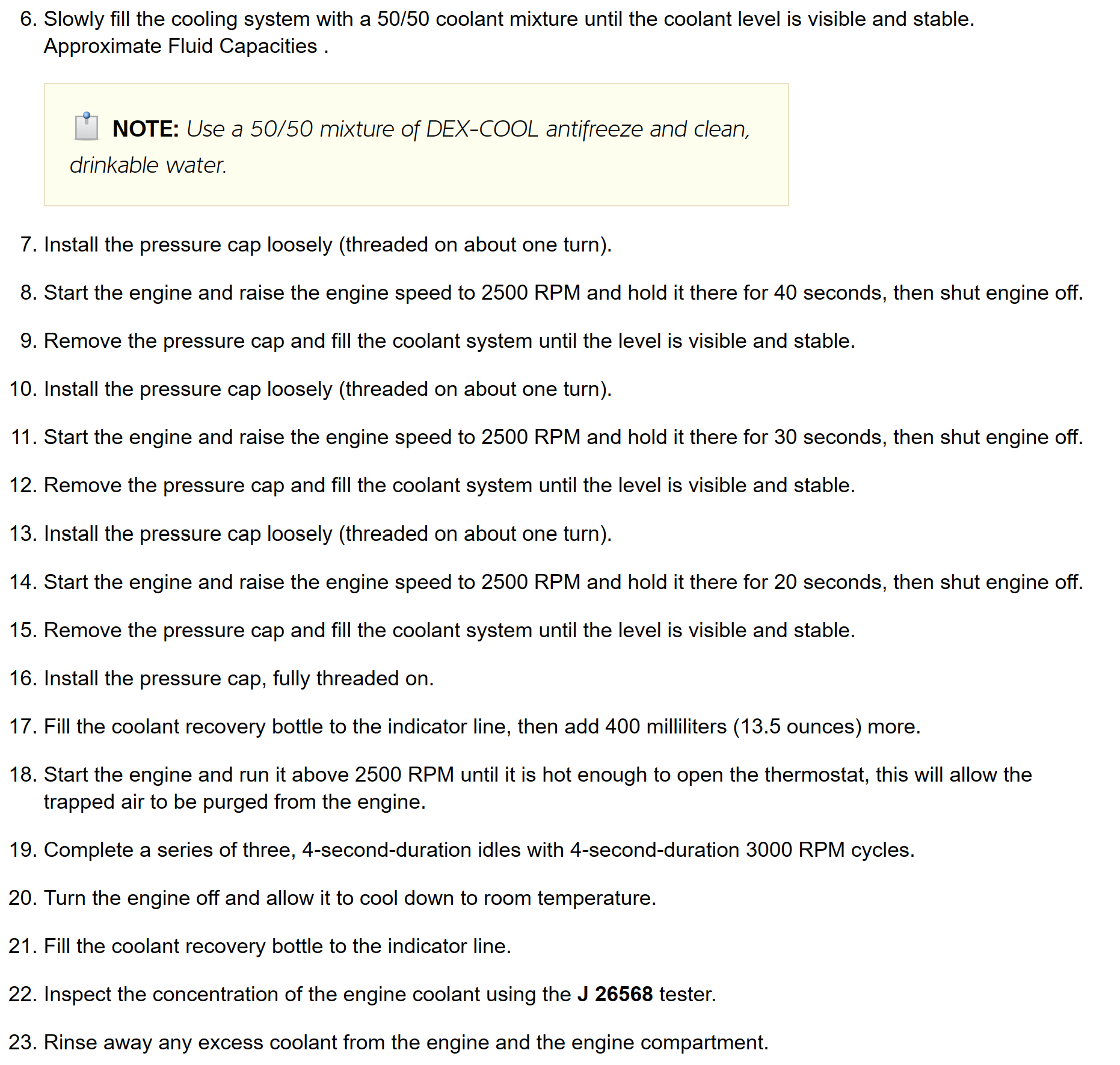

I have also added the procedure for draining and refilling the engine coolant.
Your vehicle takes 50/50 Dex-cool mix. You can get it right from the dealer or you can get it online as well as a local parts store.
Part number should be A/C Delco 10-5027
Total Capacity: 6.40Qts
I recommend using this coolant so there are no coolants of different types being mixed which will cause cooling system issues.
Regards,
Brendon
Jan 10, 2024 at 8:20 AM
Suggested Repair
Locate the thermostat on the left front of the engine, removing the air duct if needed for access. Drain and refill with 50/50 Dex-Cool (ACDelco 10-5027), about 6.4 quarts, and do not mix coolant types. Follow the service procedure but remove only the parts actually needed for access.
