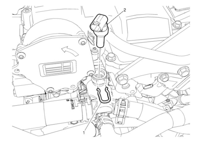

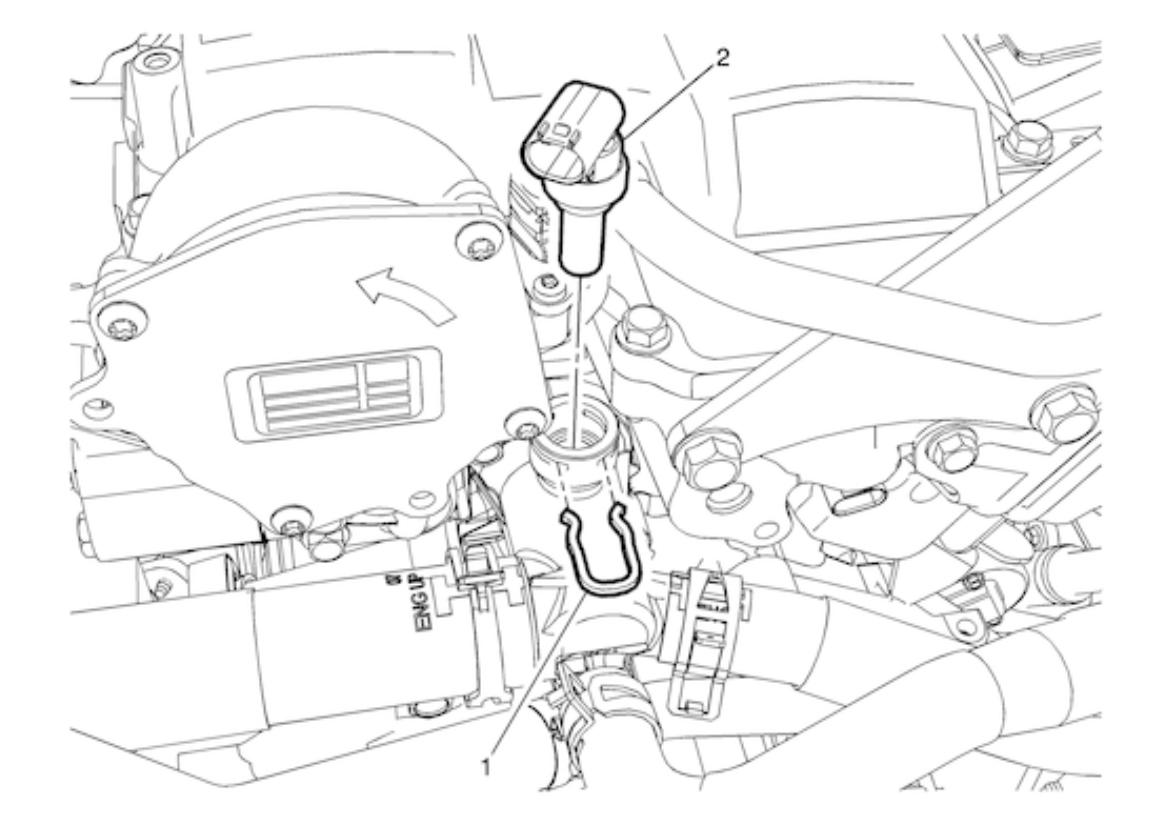

Can you help me in the temperature sensor of my car? It is the LT model. can you tell me where it is located?
Dec 21, 2017 at 12:01 AM

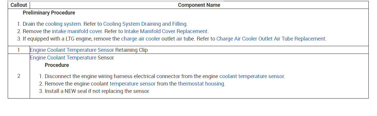

I attached the procedure and a picture for the location of the coolant sensor for the 2.5 engine. This guide can help drain the coolant
https://www.2carpros.com/articles/coolant-flush-and-refill-all-cars
Let me know if you have any other questions. Check out the images (below). Let us know how it goes

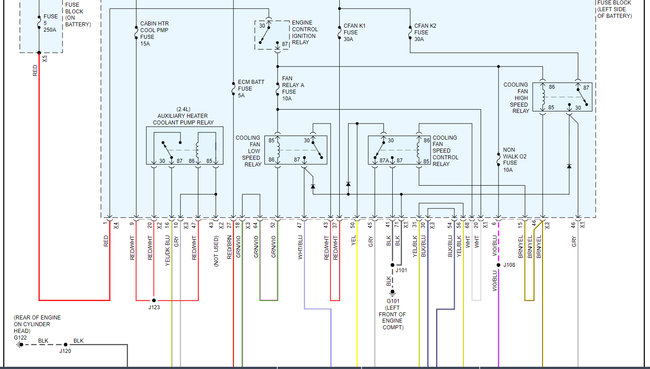

I attached a wiring diagram for you to view.
Check for 5 volts to the sensor to be sure it is able to communicate with the ECM.

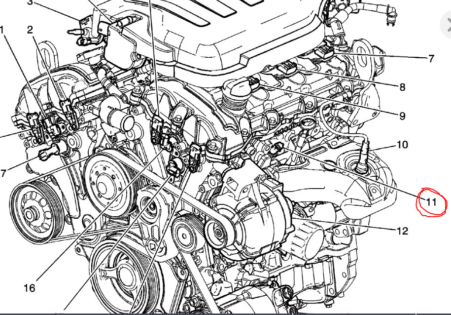

I have tried replacing the coolant temperature sensor, but that did not do anything. I replaced the thermostat. Now the next thing I’m reading about to replace is the coolant temperature switch, but I cannot find a location for that. Also I’m reading conflicting articles that the the two can be one in the same, but the auto parts store sold me a sending unit temperature switch that’s for my car but that had different wire terminals than the one I already attempted to replace.
Nov 1, 2020 at 6:09 AM (Merged)
DANNY L
  • 5,648 POSTS
Yes, the sensor/switch is one in the same. Just curious to know the complaint. Is there no hot air flow from the vents or is there air flow but just not hot enough? I've attached a picture below of coolant temp sensor location (#11)circled in red.Hope to hear back from you and thanks for using 2CarPros.

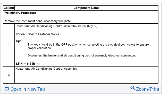

I don’t have them, and I don’t think scanning it will tell me anything now that my check engine light is no longer on. My heat/temperature gauge keeps working on and off now. Every time is stops working, we disconnect and reconnect the battery and it starts working again. So now we’re trying to figure out why is keeps randomly stopping like that.

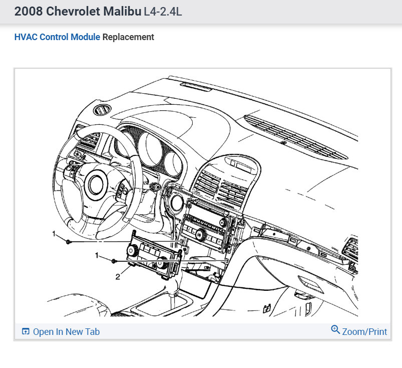

  • 55,691 POSTS
It sounds like the HVAC controller is out because it works after you reset it which is an indication of failure. Here is how you replace it the instruction are in the diagrams below. Check out the diagrams (below). Please let us know what happens.

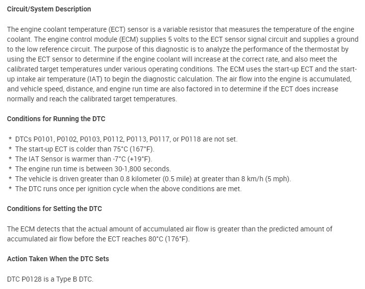

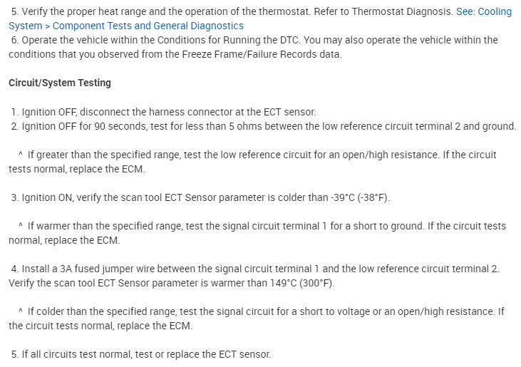

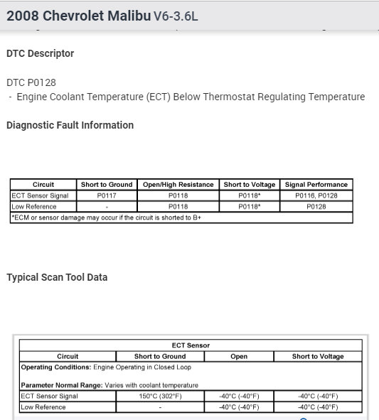

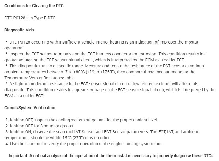

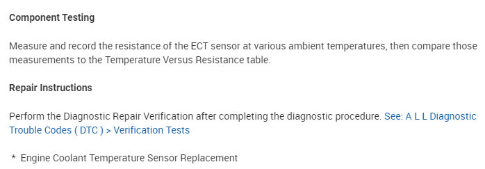

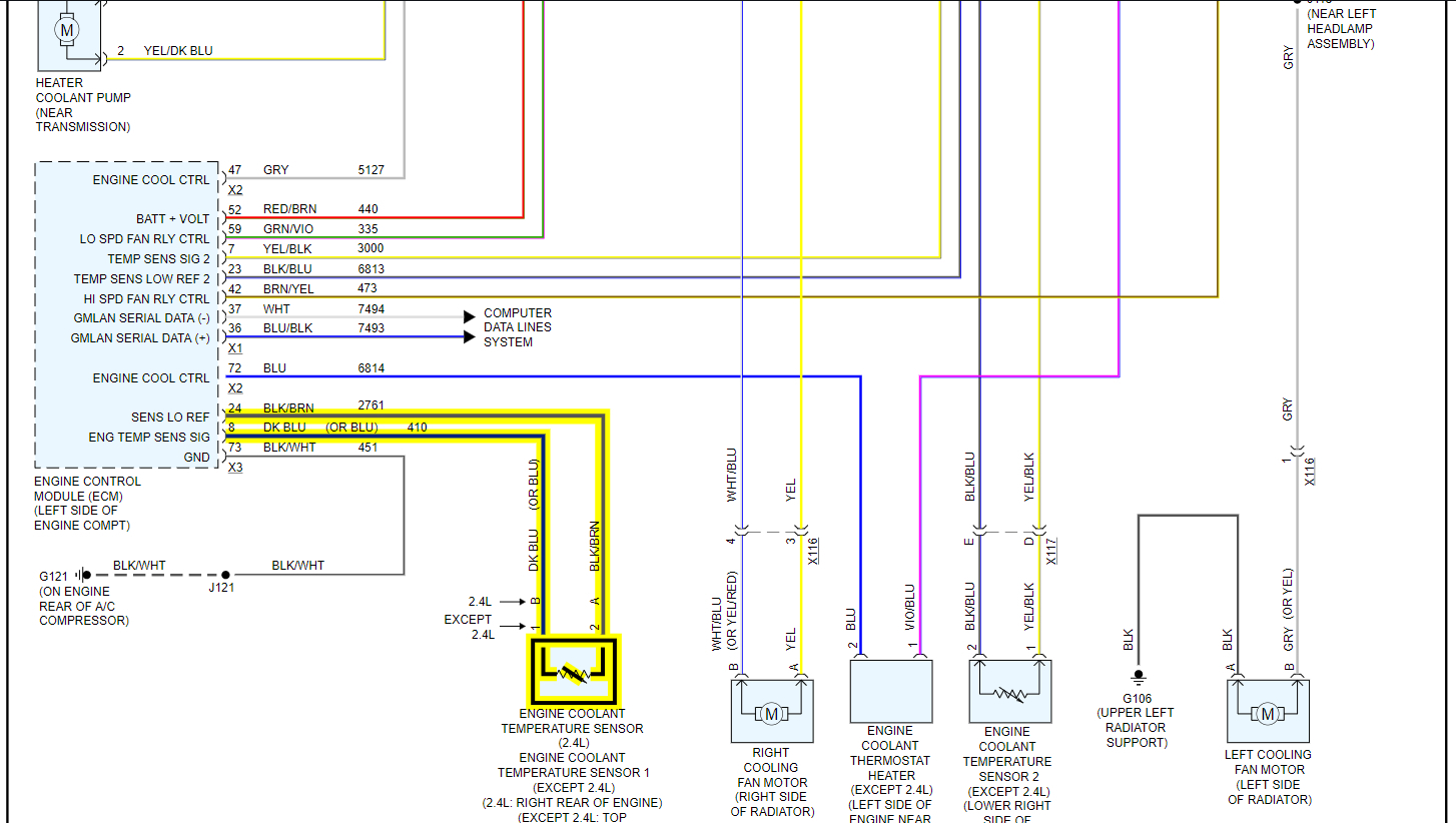

So I took my car to Advance Auto, the code it came back with was P0128.
DANNY L
  • 5,648 POSTS
Hello again,
I've attached below step-by-step pictures for a diagnostic test for that code.Since you have replaced the actual sensor you might try testing the electrical circuit.Hope this helps and thanks again for using 2CarPros.

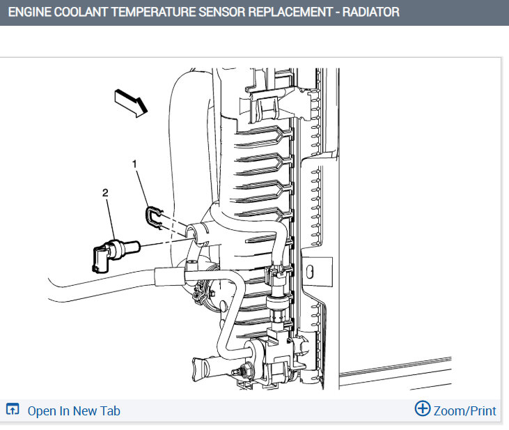

Where is the second cooling temperature sensor located, I know where that one where is the second one.
Apr 28, 2025 at 5:24 AM
  • 55,691 POSTS
The second coolant temperature sensor is on the lower right side of the radiator. Check out the images (below).
