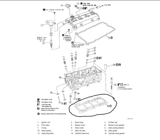

Replacing a cylinder head gasket is an in-depth procedure. However, with the right tools, most people should be able to do it. One thing I suggest is to confirm the gasket is the issue. Before starting the job, take a look through this link. It explains how to determine if the head gasket is bad.
If you determine it is bad, here are the directions specific to this vehicle. The attached pics correlate with the directions.

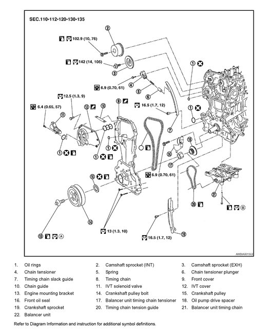

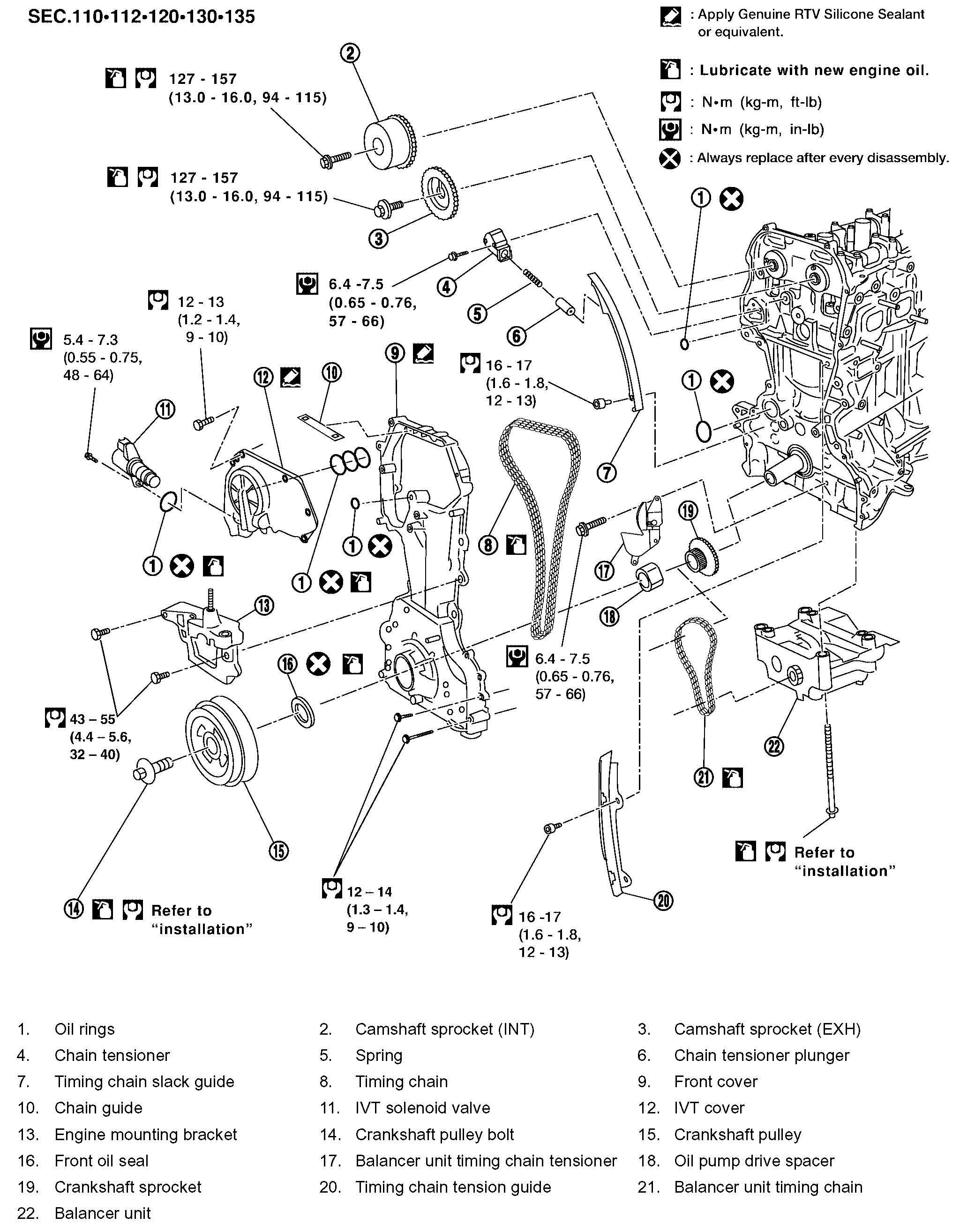

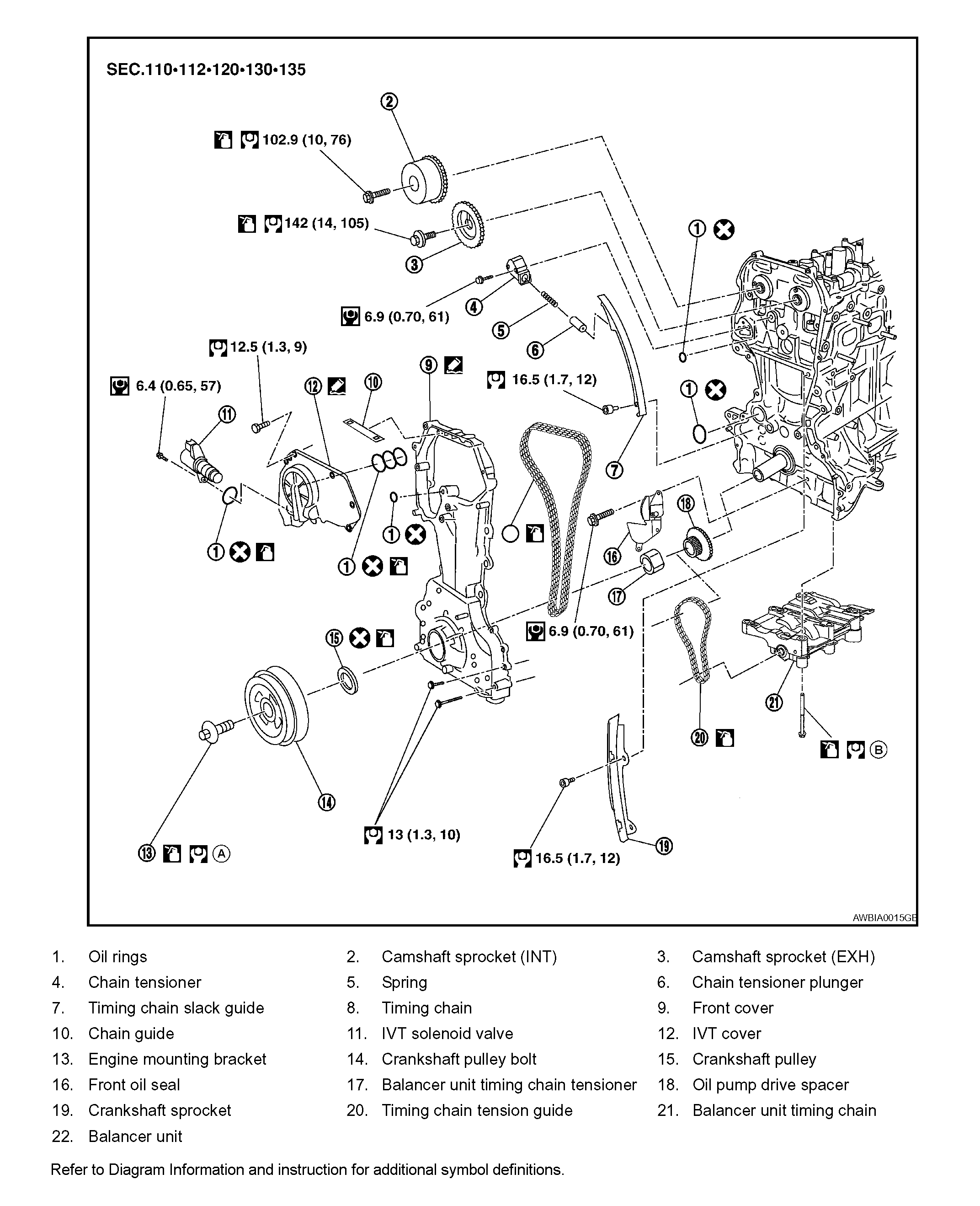

REMOVAL AND REPLACEMENT
TIMING CHAIN
Removal and Installation
Exploded View EM-51
Pic 1
CAUTION: Apply new engine oil to parts marked in illustration before installation.
REMOVAL
1. Support the engine and transaxle assembly with suitable tools.
2. Remove RH splash shield.
3. Remove the upper and lower oil pan, and oil strainer.
4. Remove generator.
5. Remove engine cover.
6. Disconnect variable timing control solenoid harness connector.
7. Remove engine ground.
8. Remove the coolant overflow reservoir tank.
9. Position the RH engine compartment fuse and relay box aside.

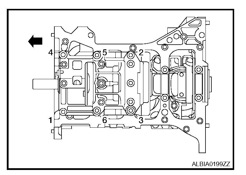

10. Remove the RH engine mount and bracket.

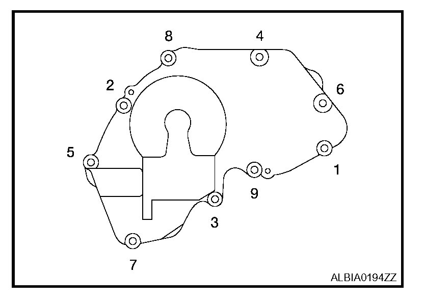

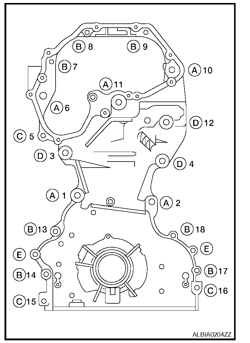

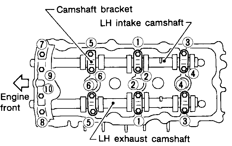

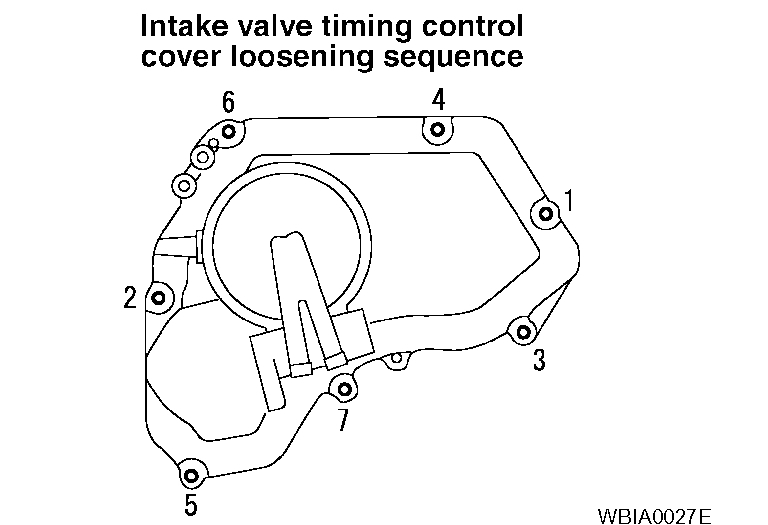

pic 2

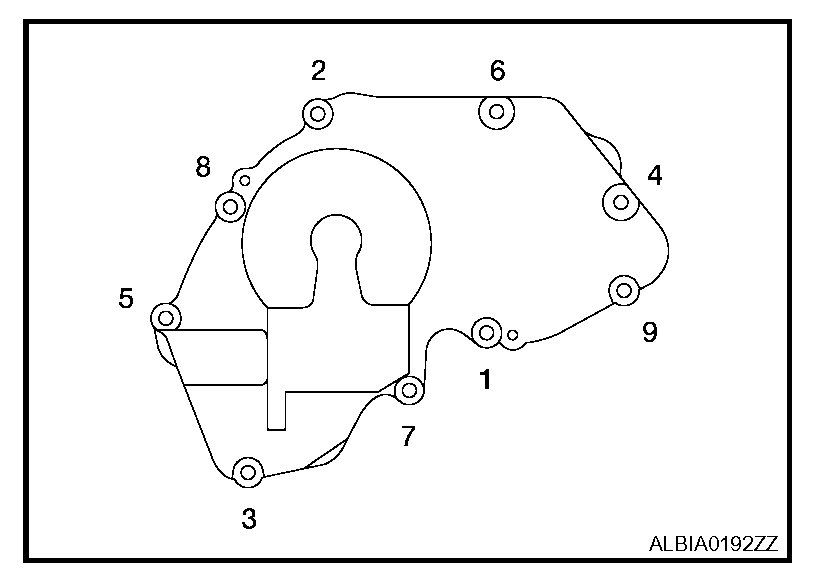

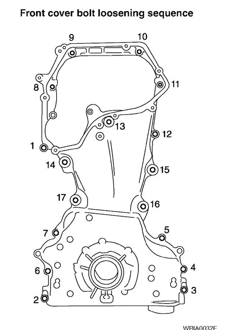

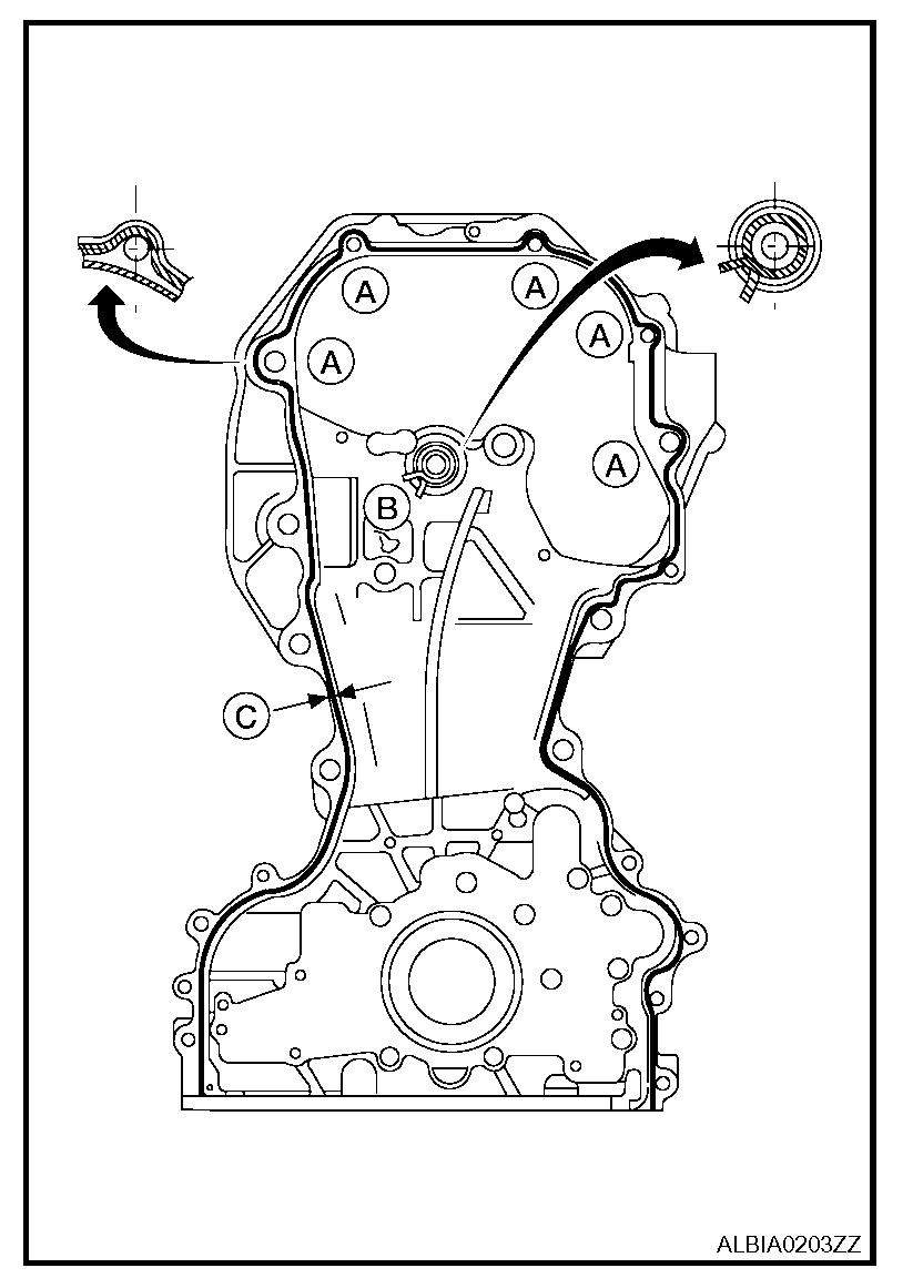

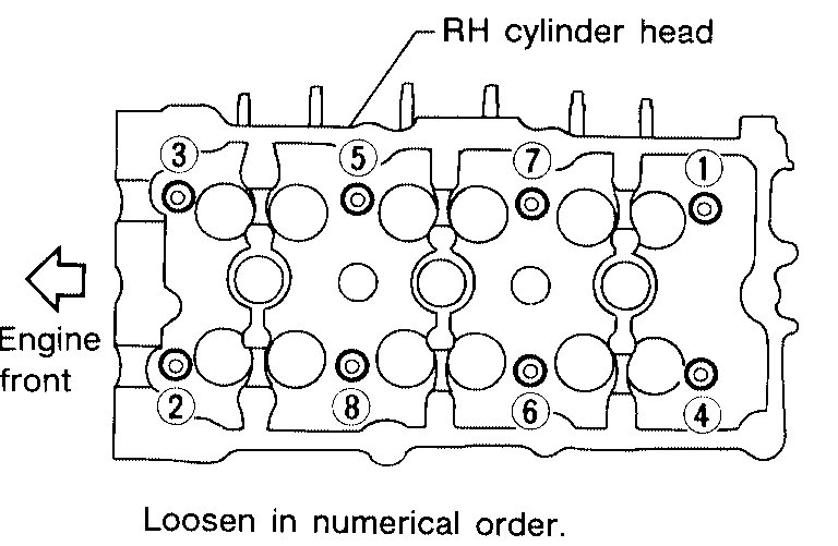

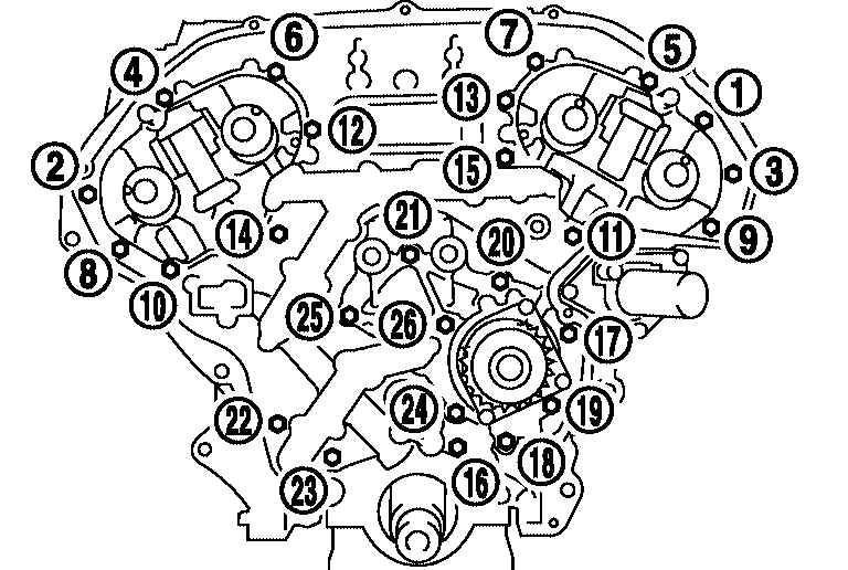

11. Loosen bolts in the numerical order as shown.

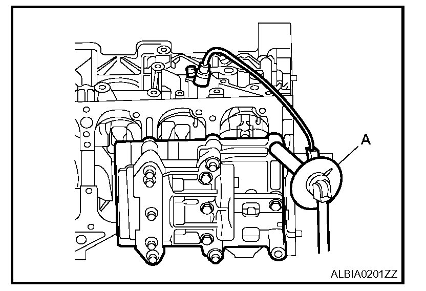

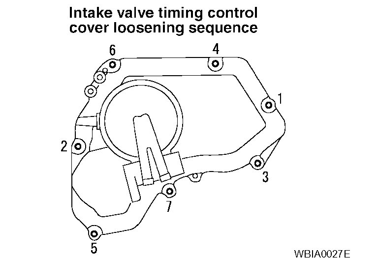

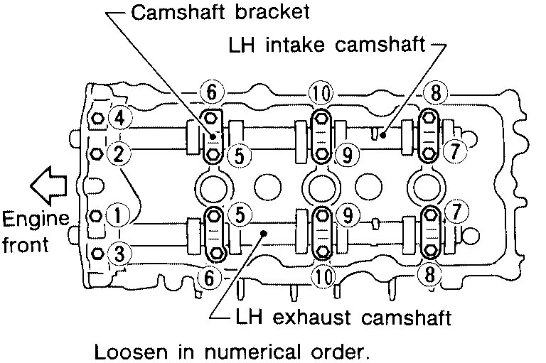

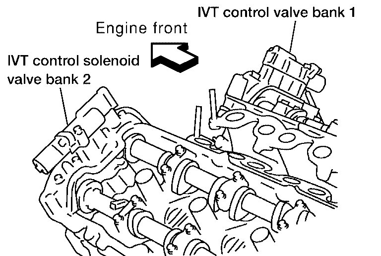

pic 3

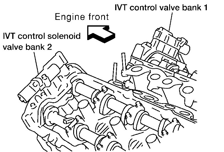

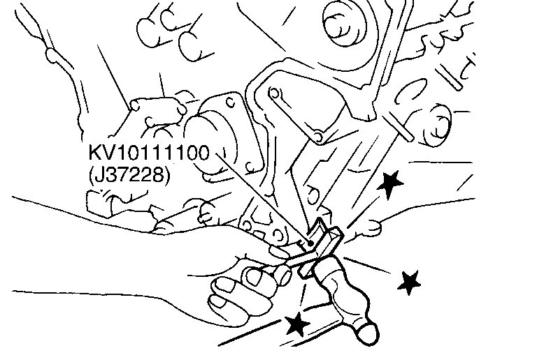

- Remove the IVT (intake valve timing) control cover using Tool.
Tool number: KV10111100 (J-37228)

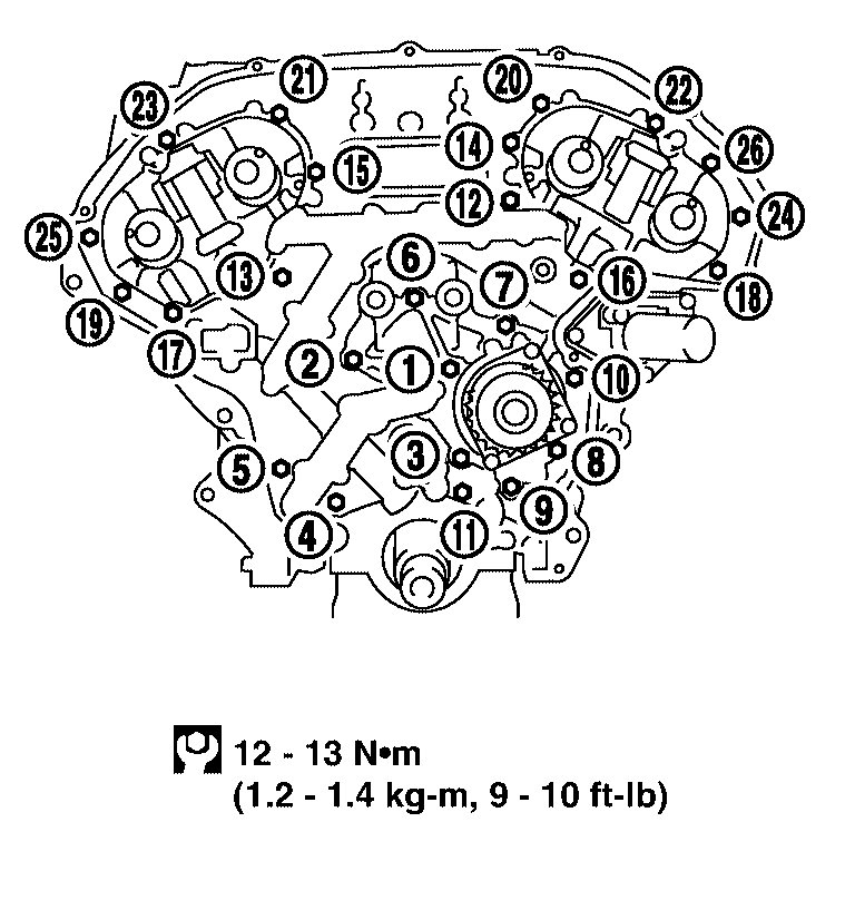

12. Pull chain guide between camshaft sprockets out through front cover.
pic 4

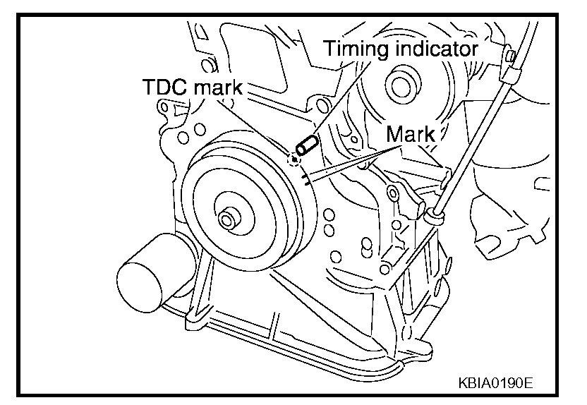

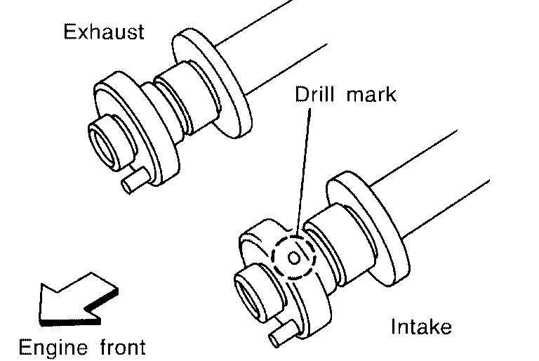

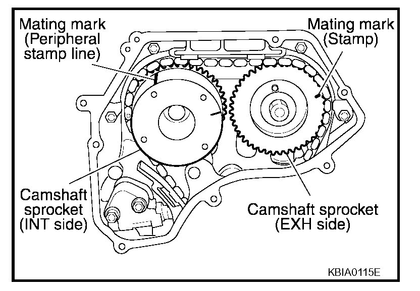

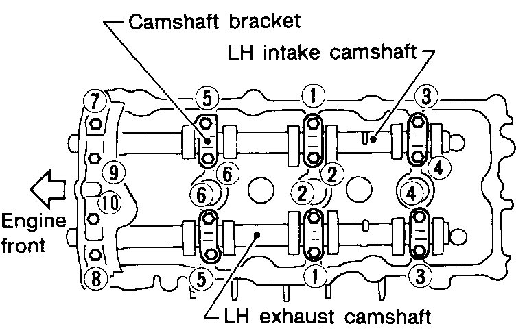

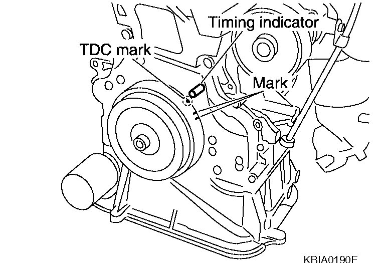

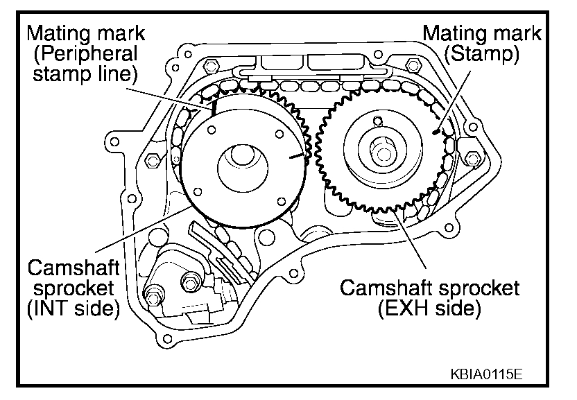

13. Set the No.1 cylinder at TDC on the compression stroke with the following procedure:
a. Rotate the crankshaft pulley clockwise and align the mating marks to the timing indicator on the front cover.
pic 5

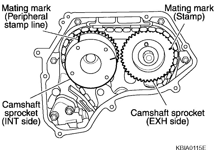

b. Line up the mating marks on camshaft sprockets with the yellow links in the timing chain, and paint an indelible mating mark on the sprocket and timing chain link plate.
- If not lined up, rotate the crankshaft pulley one more turn to line up the mating marks to the positions as shown.
pic 6

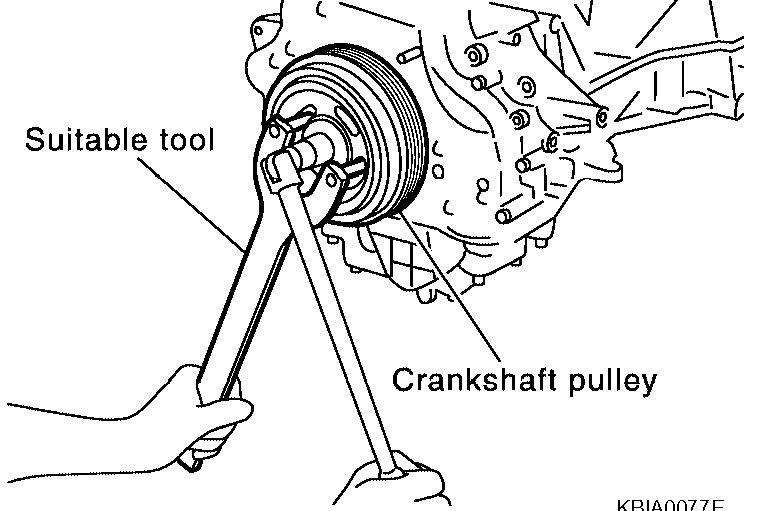

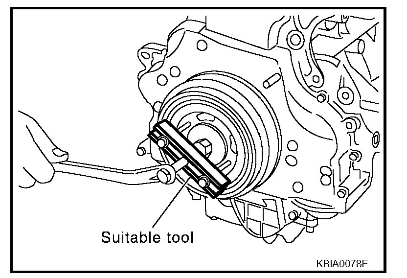

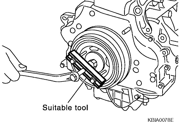

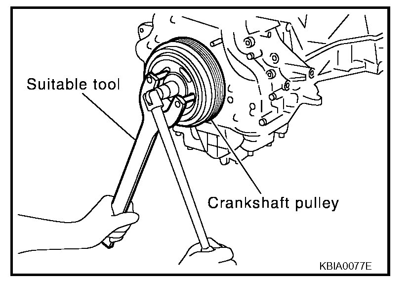

14. Remove crankshaft pulley with the following procedure:
a. Hold the crankshaft pulley using suitable tool, then loosen the crankshaft pulley bolt, and pull the pulley out about 10 mm (0.39 in).
pic 7
b. Attach suitable pulley puller in the M6 (0.24 in diameter) thread hole on crankshaft pulley, and remove crankshaft pulley using a suitable puller.

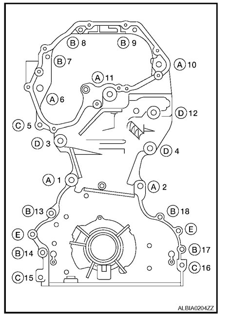

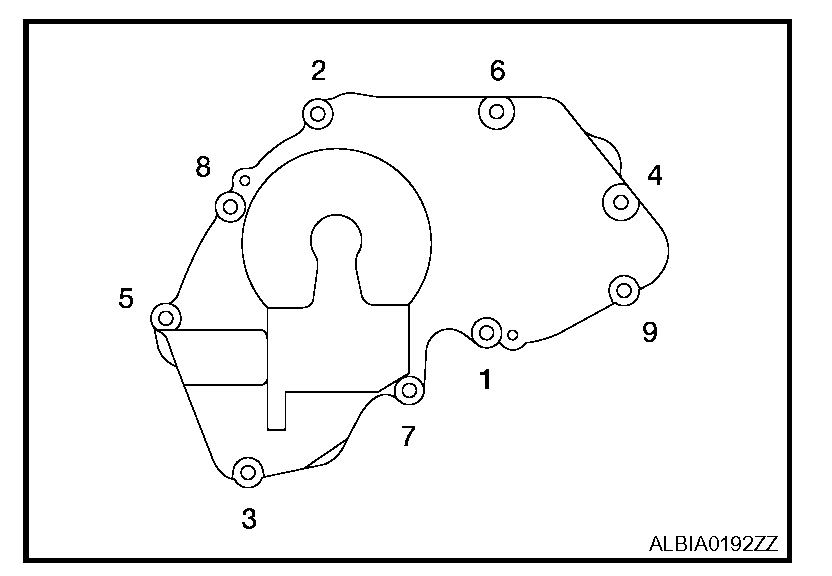

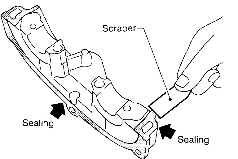

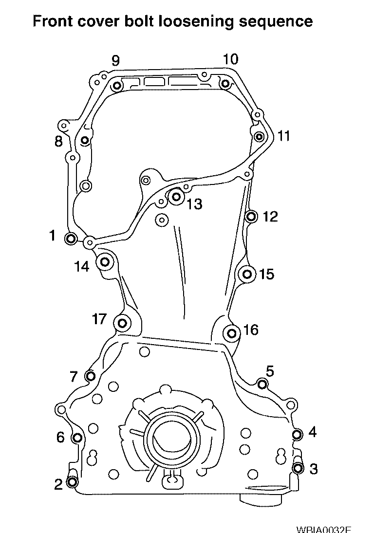

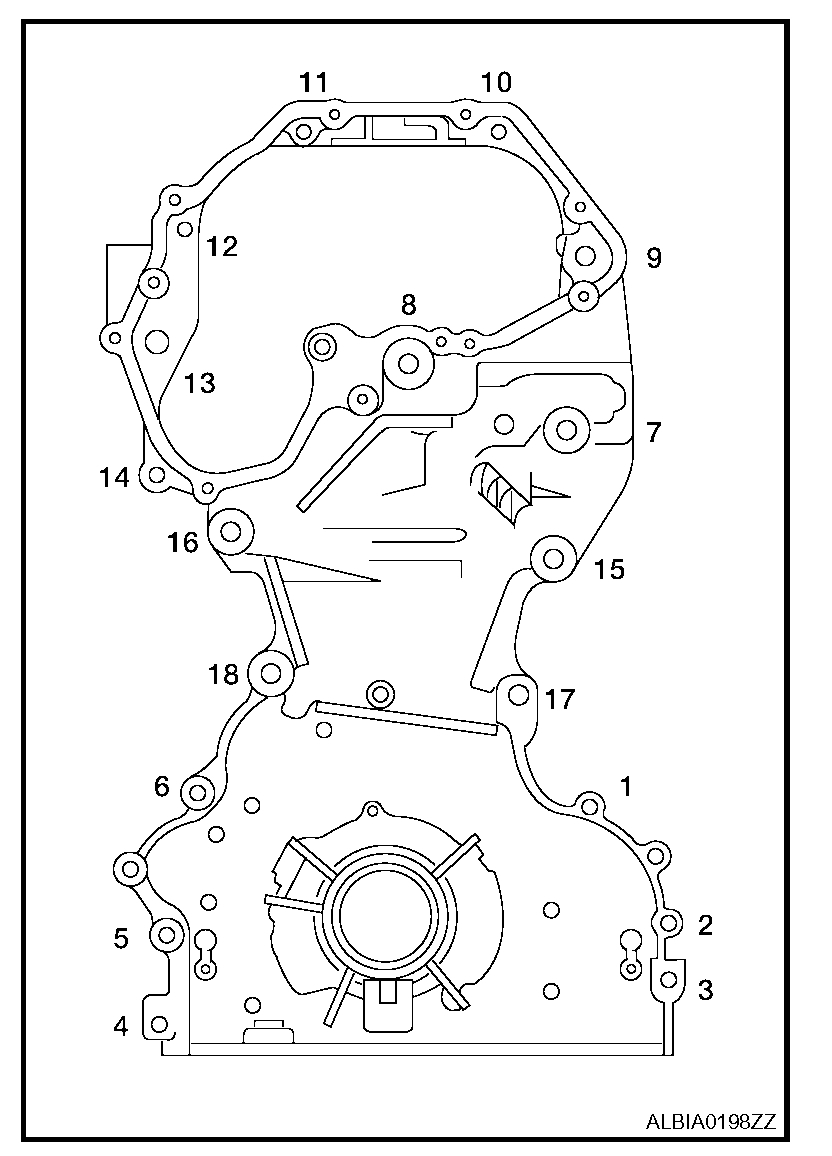

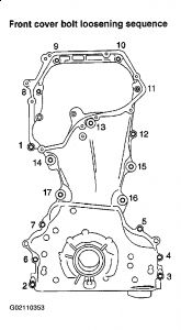

15. Remove the front cover with the following procedure:
a. Loosen the bolts in the reverse order as shown, and remove them.
b. Remove the front cover.
CAUTION:
- Be careful not to damage the mounting surface.

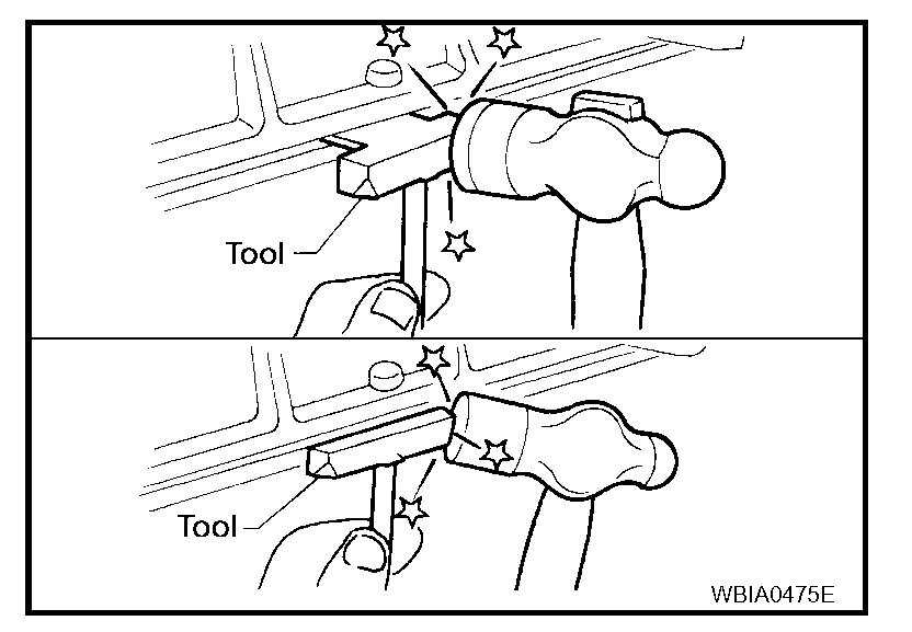

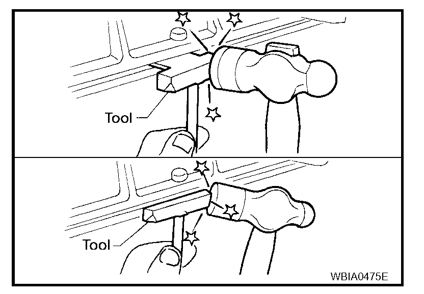

16. If the front oil seal needs to be replaced, lift it out with a screwdriver to remove it.

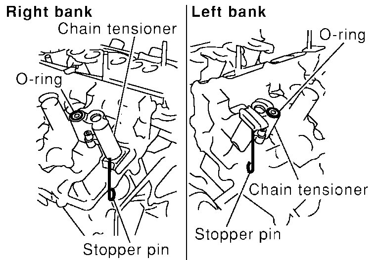

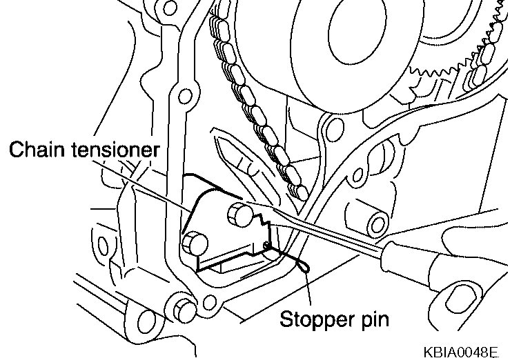

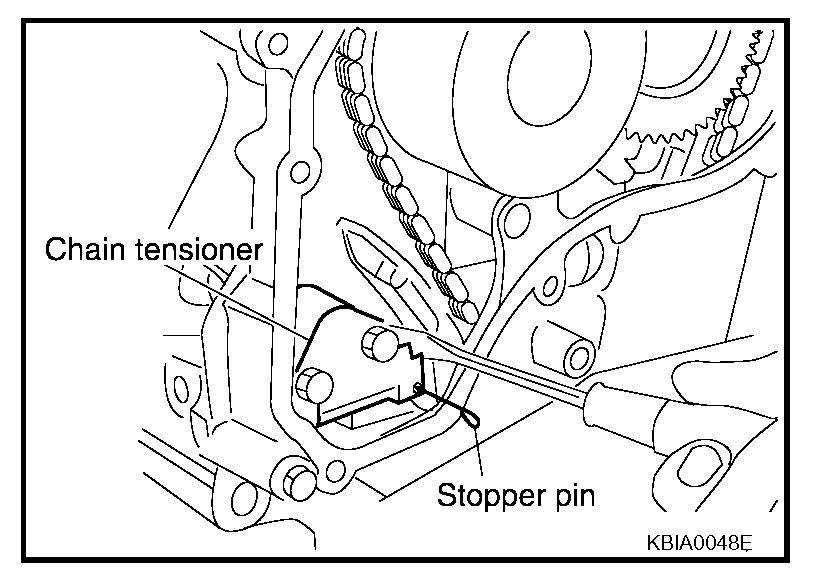

17. Remove timing chain with the following procedure:
a. Push in the tensioner plunger. Insert a stopper pin into the hole on the tensioner body to secure the chain tensioner plunger and remove chain tensioner.
- Use a wire of 0.5 mm (0.02 in) diameter as a stopper pin.
b. Remove the timing chain.
pic 10

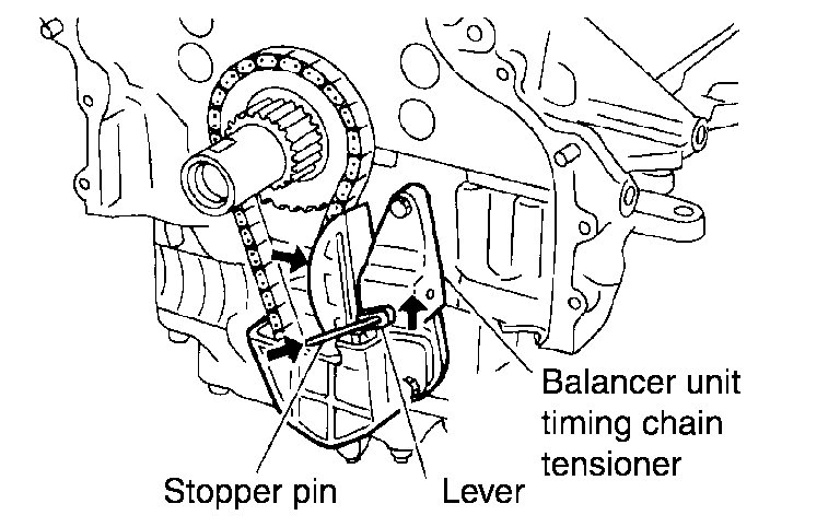

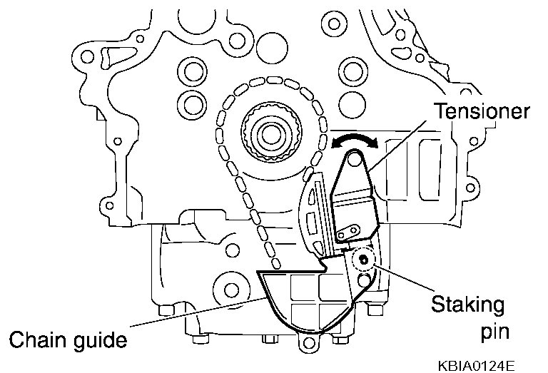

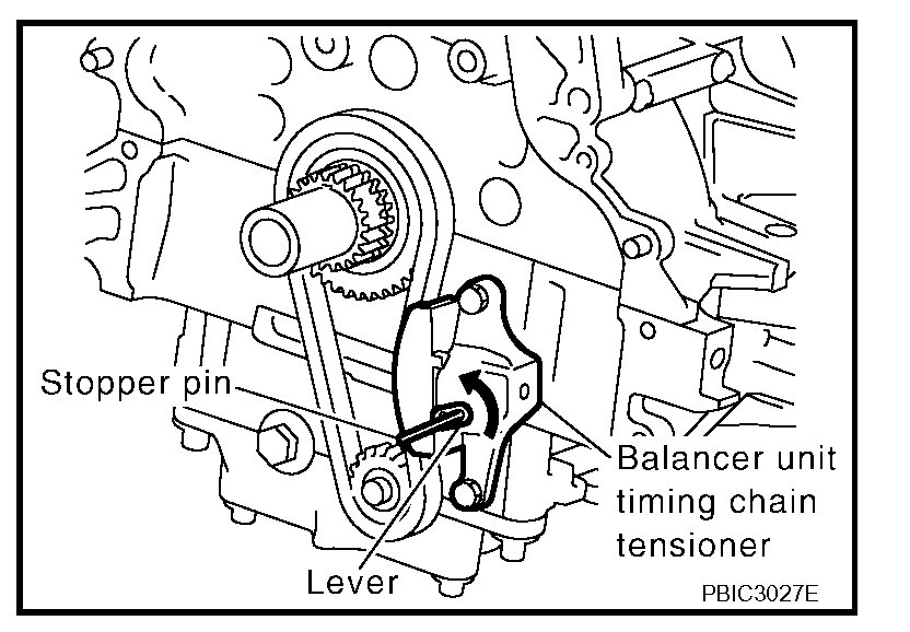

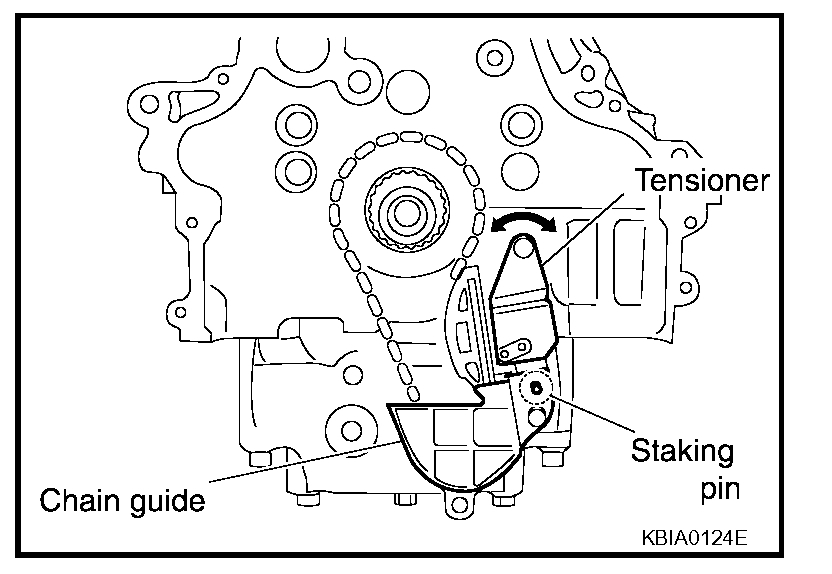

19. Remove balancer unit timing chain tensioner with the following procedure:
a. Lift lever up, and release the ratchet claw for return proof.
b. Push tensioner sleeve in, and hold it.
c. Matching the hole on lever with the one on body, insert a stopper pin to secure tensioner sleeve.
NOTE: Use approximately 1 mm (0.04 in) dia hard metal pin as a stopper pin.
d. Remove the timing chain tensioner for the balancer unit.

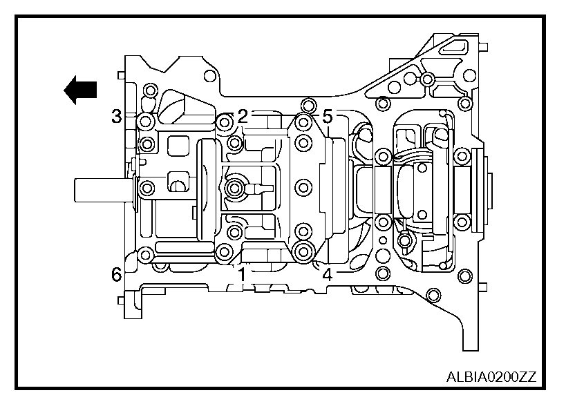

20. Secure width across flats of the balancer LH side shaft using a suitable tool. Loosen the balancer sprocket bolt.
21. Remove balancer unit timing chain, balancer unit sprocket and crankshaft sprocket.
pic 12

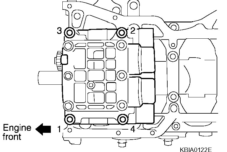

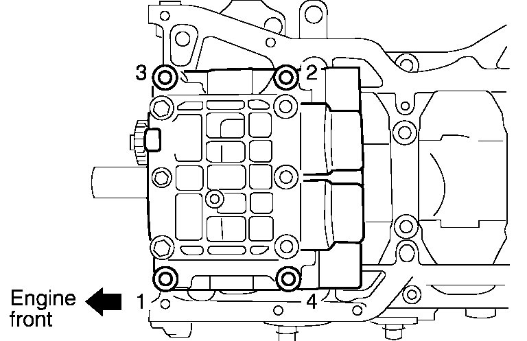

22. Loosen bolts in order as shown, and remove balancer unit.
- Use Torx socket (size E14)
CAUTION:
- Do not disassemble balancer unit.

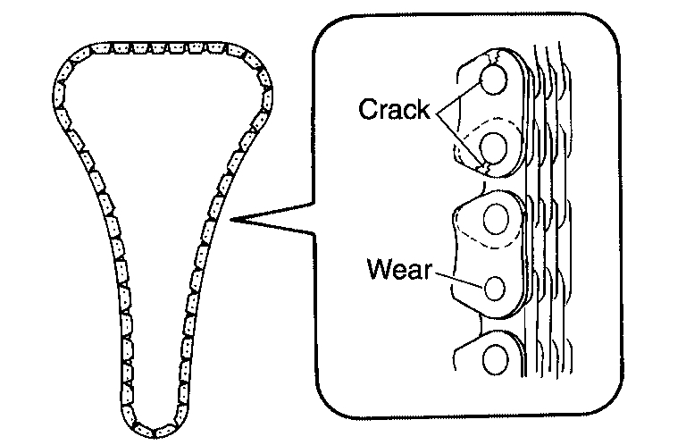

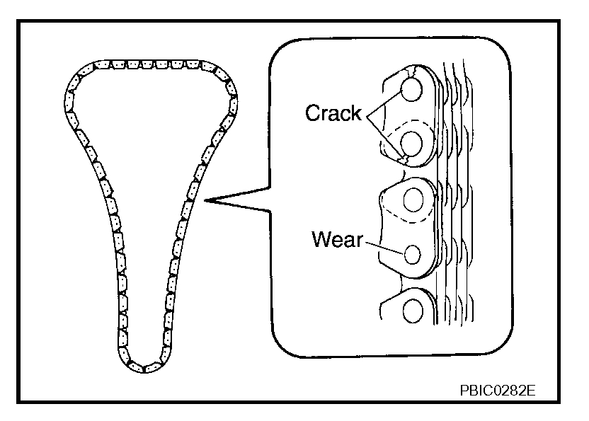

INSPECTION AFTER REMOVAL

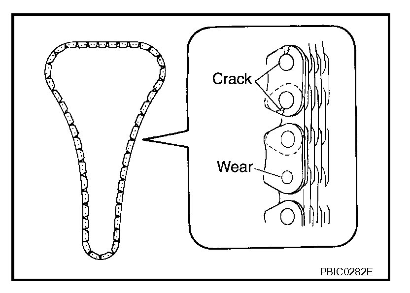

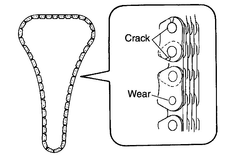

Timing Chain
pic 13

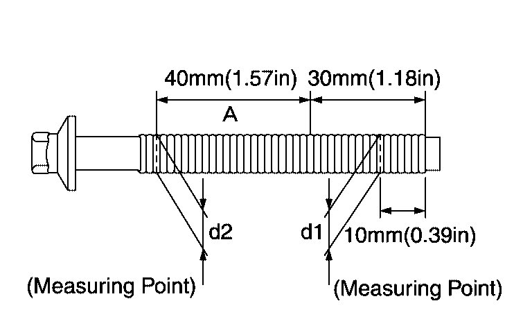

Check the timing chain for cracks or serious wear. If a defect is detected, replace it.

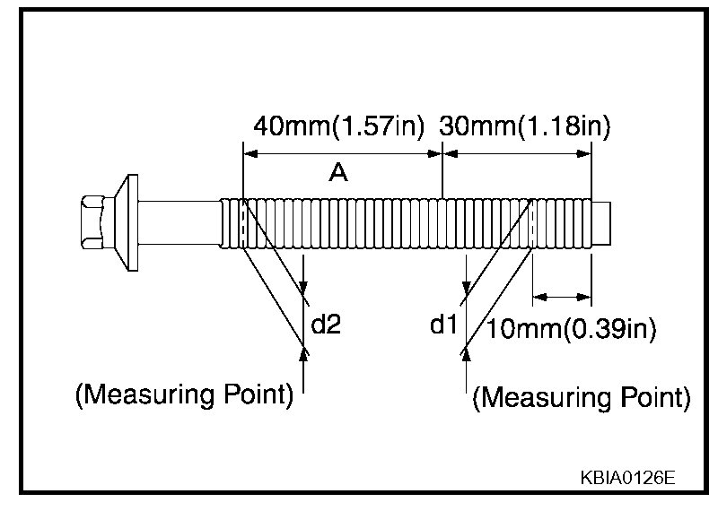

Balancer Unit Bolt Outer Diameter
pic 14
- Measure outer diameters (d1, d2) at the two positions as shown.
- Measure d2 within the range A.
- If the value difference (d1 - d2) exceeds the limit (a dimension difference is large), replace it with a new one.
Limit: 0.15 mm (0. 0059 in) or more

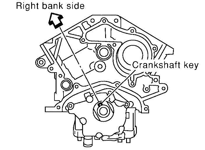

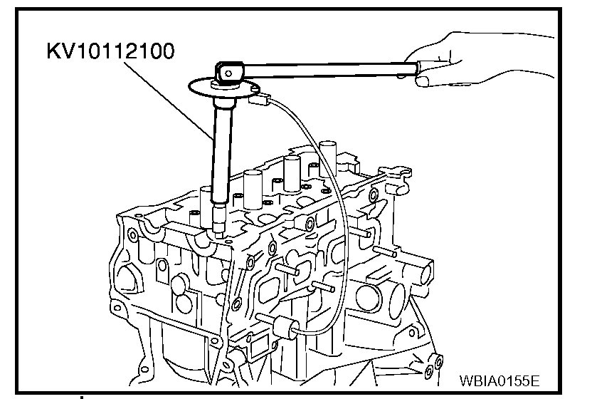

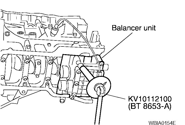

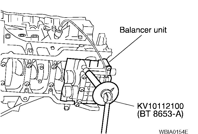

1. Make sure the crankshaft key points straight up.
pic 15

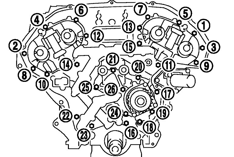

2. Install the balancer unit and tighten the bolts in the numerical order as shown:
CAUTION:
- When reusing a bolt, check its outer diameter before installation. Refer to "Balancer Unit Bolt Outer Diameter".
Tool number: KV10112100 (BT-8653-A)
CAUTION:
- Check tightening angle with an angle wrench or a protractor. Do not make judgment by visual check alone.
- Apply new engine oil to threads and seating surfaces of bolts.
pic 16
Balancer unit bolts
Step 1
Bolts 1-5: 42 Nm (4.3 kg-m, 31 ft-lb)
Bolt 6: 36 Nm (3.7 kg-m, 27 ft-lb)
Step 2
Bolts 1-5: 120°
Bolt 6: 90°
Step 3 (Loosen in reverse order or tightening): 0 Nm (0 kg-m, 0 ft-lb)
Step 4
Step 5
Bolts 1-5: 120°
Bolt 6: 90°
pic 17

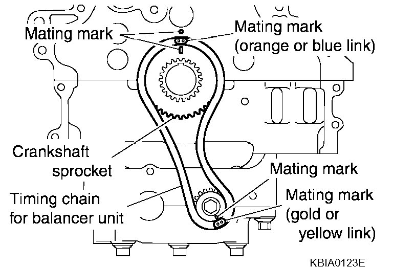

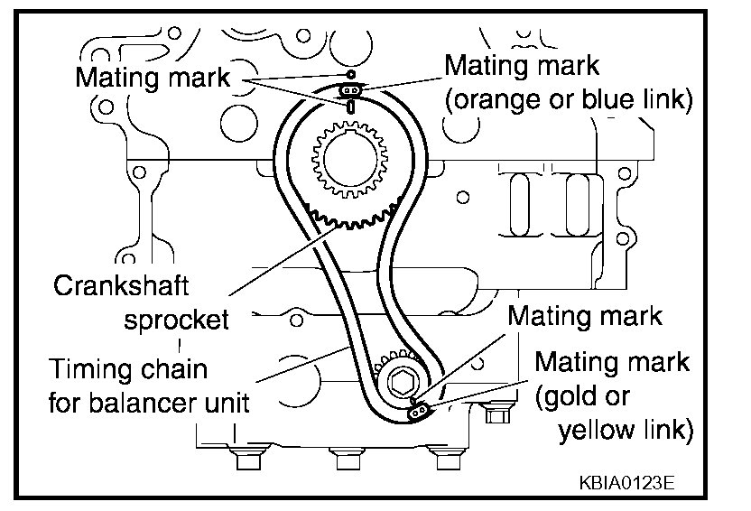

3. Install the crankshaft sprocket and timing chain for the balancer unit.
- Make sure that the crankshaft sprocket is positioned with mating marks on the block and sprocket meeting at the top.
- Install it by lining up mating marks on each sprocket and timing chain.
pic 18

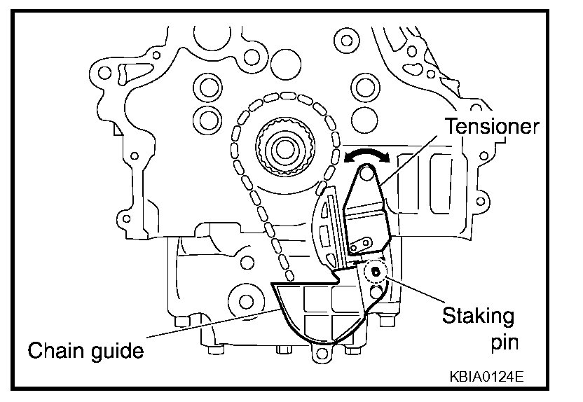

4. Install timing chain tensioner for balancer unit.
NOTE: Chain guide and tensioner move freely with the staking pin as the axle. Therefore, bolt hole position of the three points could be changed during removal. If points change, temporarily tighten the two bolts on the chain guide and move the tensioner to match the bolt holes.
- Be careful not to let mating marks of each sprocket and timing chain slip.
- After installation, make sure the mating marks have not slipped, then remove stopper pin and release tensioner.

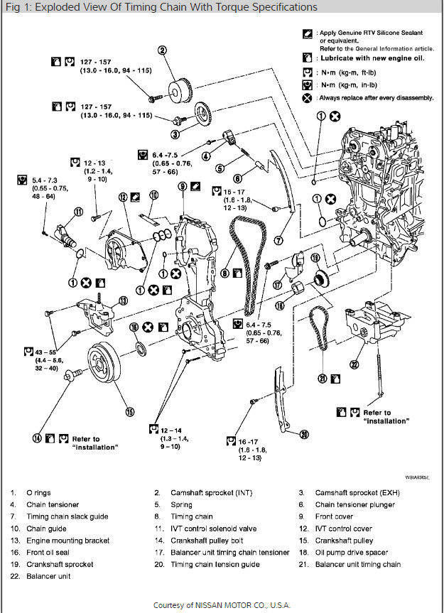

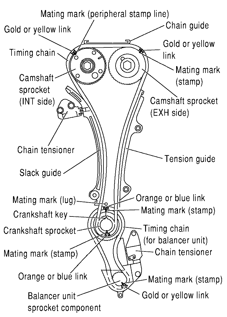

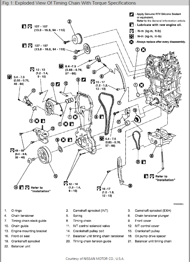

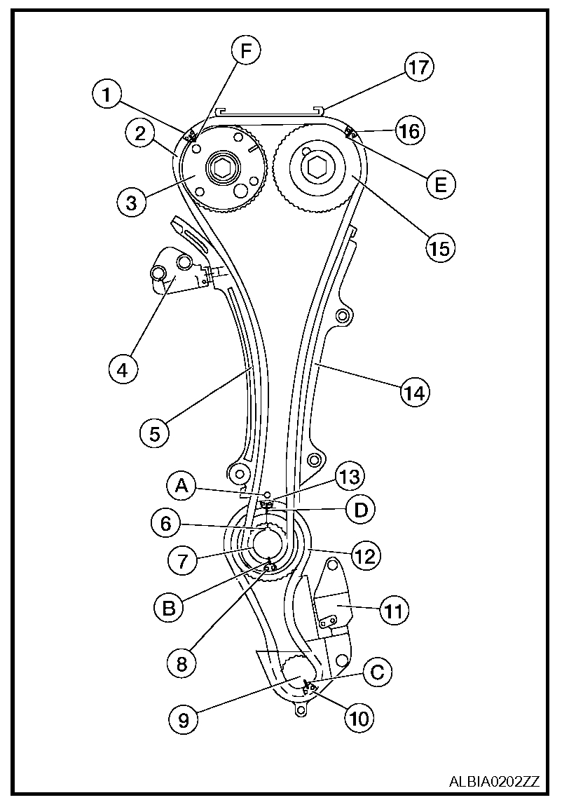

5. Install timing chain and related parts.
- Install by lining up mating marks on each sprocket and timing chain as shown.
- 1 Yellow link
- 2 Timing chain
- 3 Camshaft sprocket (INT side)
- 4 Chain tensioner
- 5 Slack guide
- 6 Crankshaft key
- 7 Crankshaft sprocket
- 8 Orange link
- 9 Balancer unit sprocket component
- 10 Yellow link
- 11 Chain tensioner
- 12 Timing chain (for balancer unit)
- 13 Orange link
- 14 Tension guide
- 15 Camshaft sprocket (EXH side)
- 16 Yellow link
- 17 Chain guide
- A Mating mark (lug)
- B Mating mark (stamp)
- C Mating mark (stamp)
- D Mating mark (stamp)
- E Mating mark (stamp)
- F Yellow link
CAUTION: For the above reason, after the mating marks are aligned, keep them aligned by holding them with a hand.
NOTE:
- Before installing chain tensioner, it is possible to change the position of mating mark on timing chain for that of each sprocket for alignment.
- Before and after installing chain tensioner, check again to make sure that mating marks have not slipped.
- After installing chain tensioner, remove stopper pin, and make sure the tensioner moves freely.
- To avoid skipped teeth, do not move crankshaft and camshaft until front cover is installed.

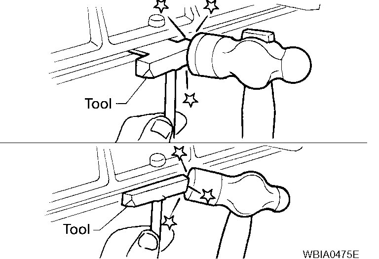

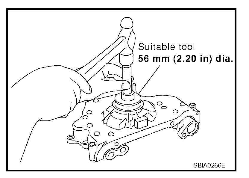

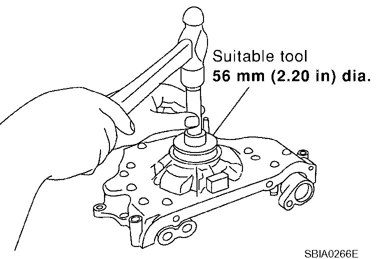

6. Install new front oil seal to front cover, using suitable tool
- Install new oil seal in until it is flush with front end surface of front cover.
CAUTION:
- Be careful not to cause damage to circumference of oil seal.

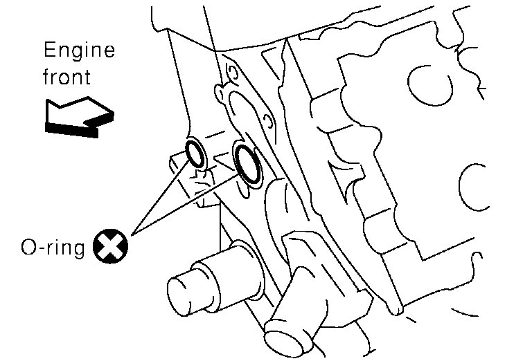

pic 21

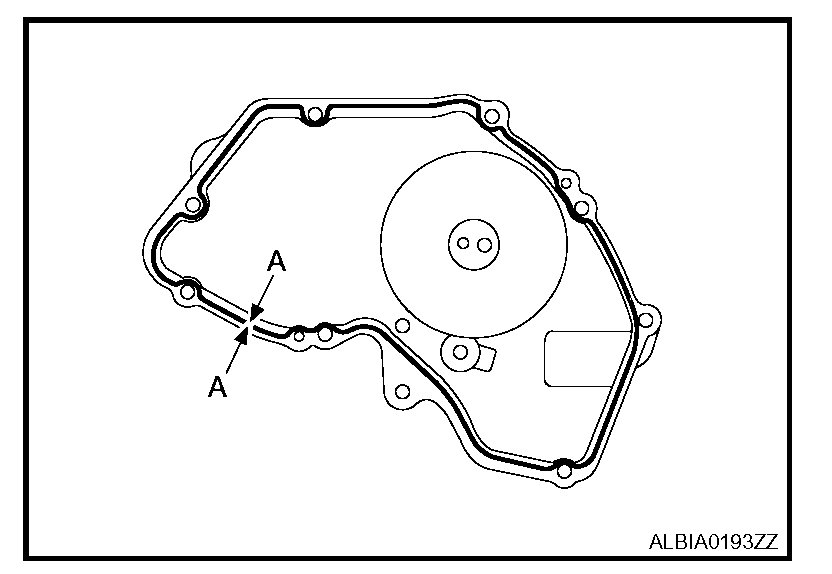

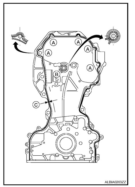

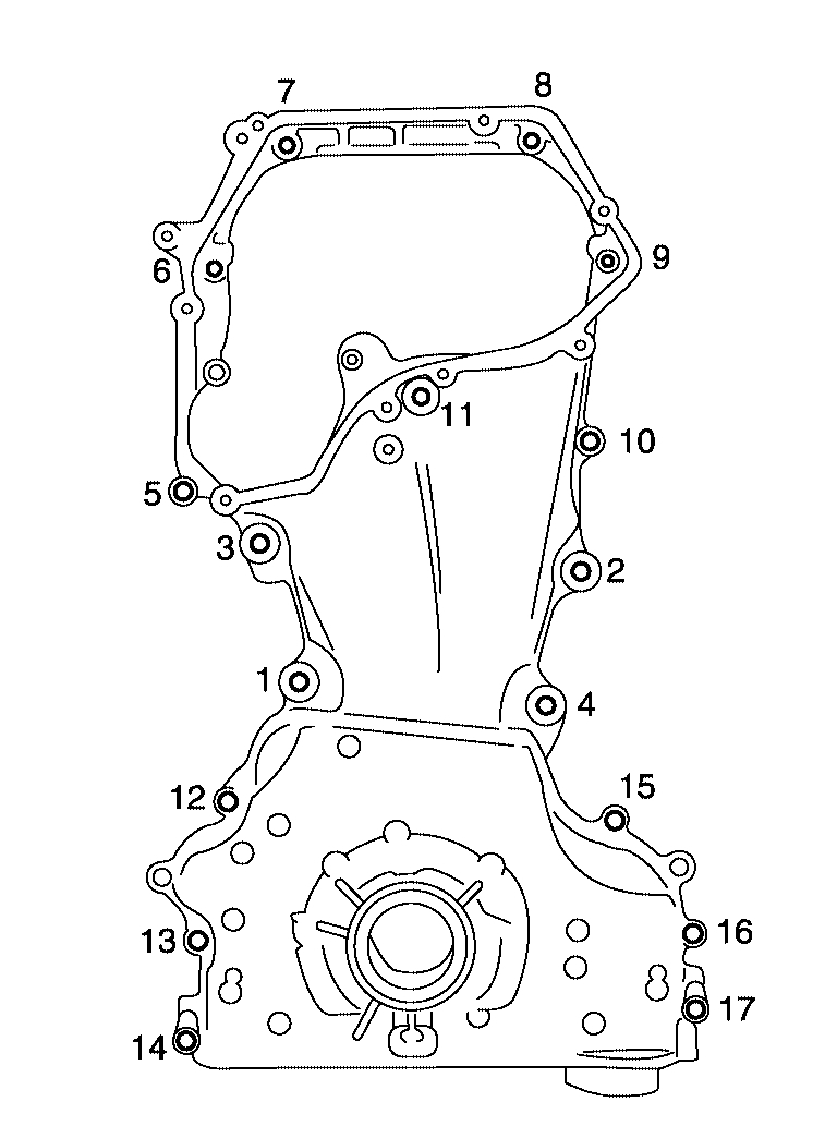

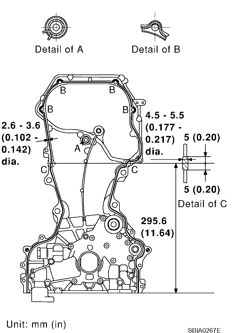

7. Install front cover with the following procedure:
a. Install O-rings to cylinder head and cylinder block.
b. Apply Genuine Silicone RTV Sealant or equivalent, to positions specified as shown.
c. Make sure the mating marks on the timing chain and each sprocket are still aligned. Then install the front cover.
Sealant dimension: 3.9 mm (0.154 in) dia.
CAUTION:
- Be careful not to damage the front oil seal during installation with the front end of the crankshaft.
pic 22
d. Tighten front cover bolts in the numerical order as shown.
e. After all bolts are tightened, retighten them to the specified torque.
Front cover bolts
Bolts A: 49 Nm (5.0 kg-m, 36 ft-lb)
Bolts B: 12.7 Nm (1.3 kg-m, 9 ft-lb)
Bolts C: 12.7 Nm (1.3 kg-m, 9 ft-lb)
Bolts D: 49 Nm (5.0 kg-m, 36 ft-lb)
E Dowel pins
CAUTION: Wipe off any excess sealant leaking at the surface for installing the oil pan.

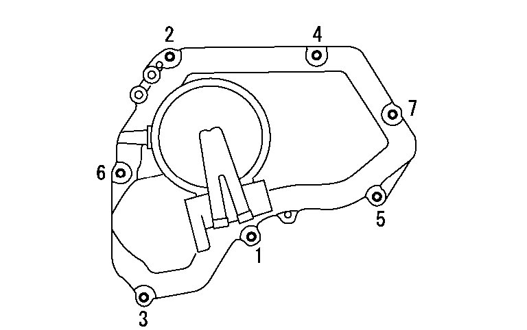

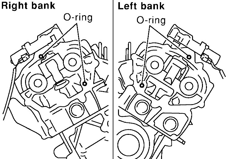

9. Install IVT cover with the following procedure:
a. Install IVT solenoid valve to IVT cover.
b. Install new O-ring to front cover.
pic 23

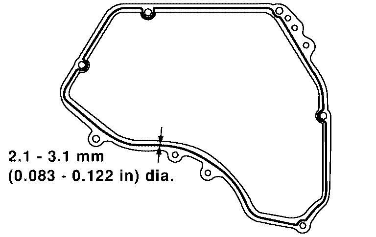

c. Apply Silicone RTV Sealant to the IVT cover as shown.
- Apply Genuine Silicone RTV Sealant or equivalent, to positions specified as shown.
pic 24
d. Tighten the IVT cover bolts in the numerical order as shown.

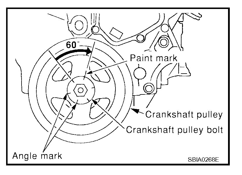

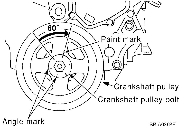

11. Tighten crankshaft pulley bolts.
- Secure crankshaft pulley with a pulley holder to tighten the bolt.
- Perform angle tightening with the following procedure:
a. Apply new engine oil to threads and seat surfaces of bolts.
b. Tighten to initial specifications:
Crankshaft bolt: 42.1 Nm (4.3 kg-m, 31 ft-lb)
pic 25
c. Apply a paint mark on the front cover, mating with any one of six easy to recognize stamp marks on bolt flange.
d. Turn crankshaft pulley bolt another 60° to 66° [Target: 60°].
- Check vertical mounting angle with movement of one stamp mark.

Cylinder Head Removal and Replacement
Vehicle Engine, Cooling and Exhaust Engine Cylinder Head Assembly Service and Repair Removal and Replacement

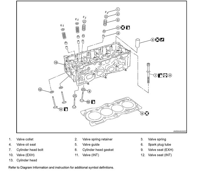

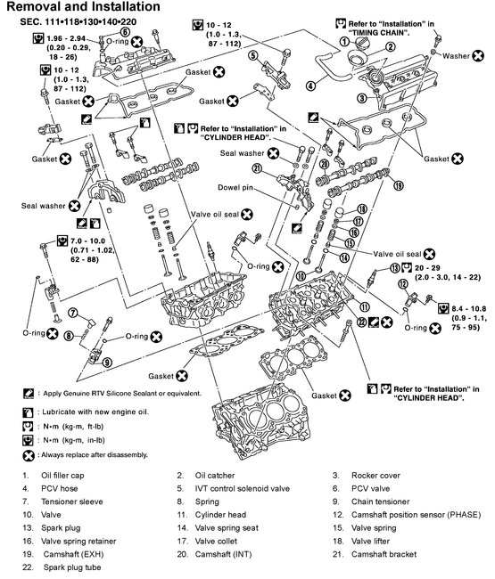

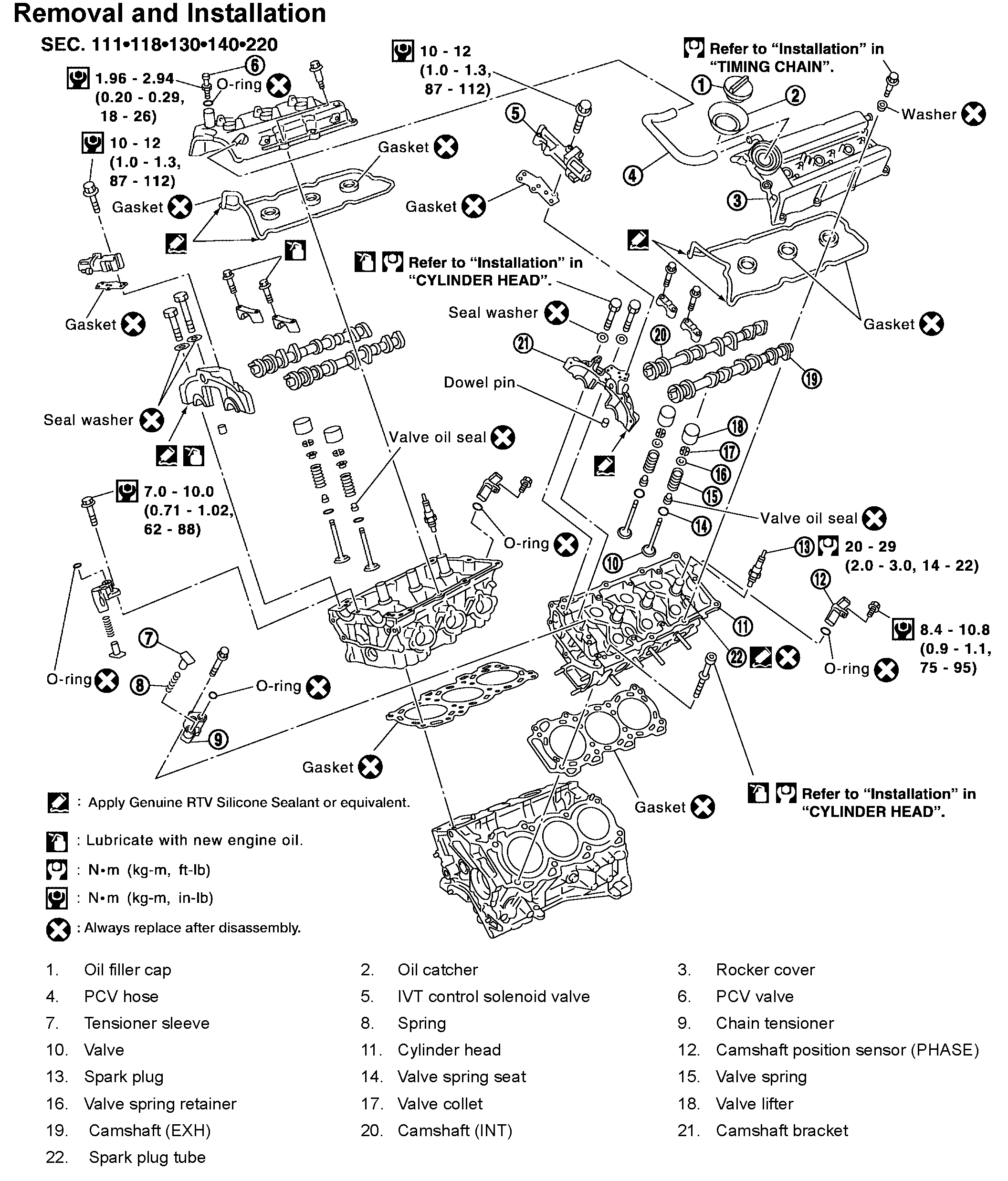

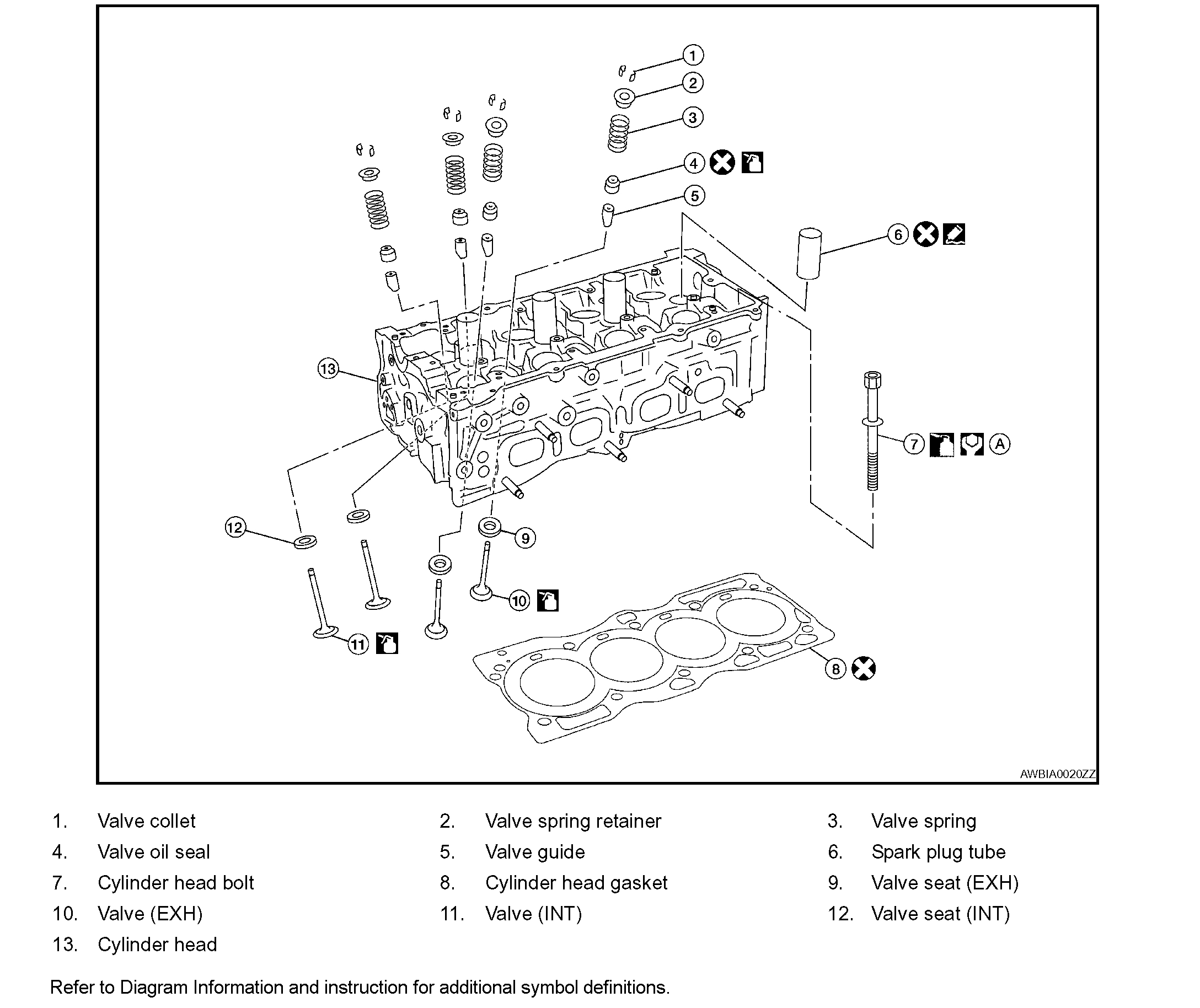

Exploded View EM-63
Pic 26
REMOVAL
1. Remove the timing chain.

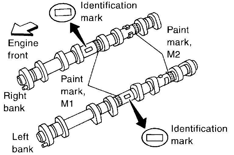

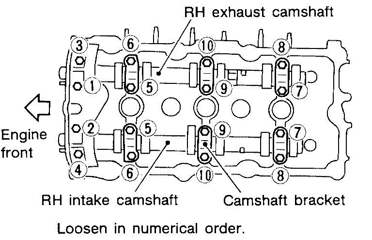

2. Remove the camshafts.
3. Remove spark plugs.
4. Remove the front suspension member.
5. Position the power steering pump and reservoir aside.
6. Disconnect the A/C compressor and position it out of the way with wire.

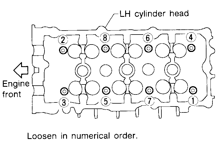

pic 27

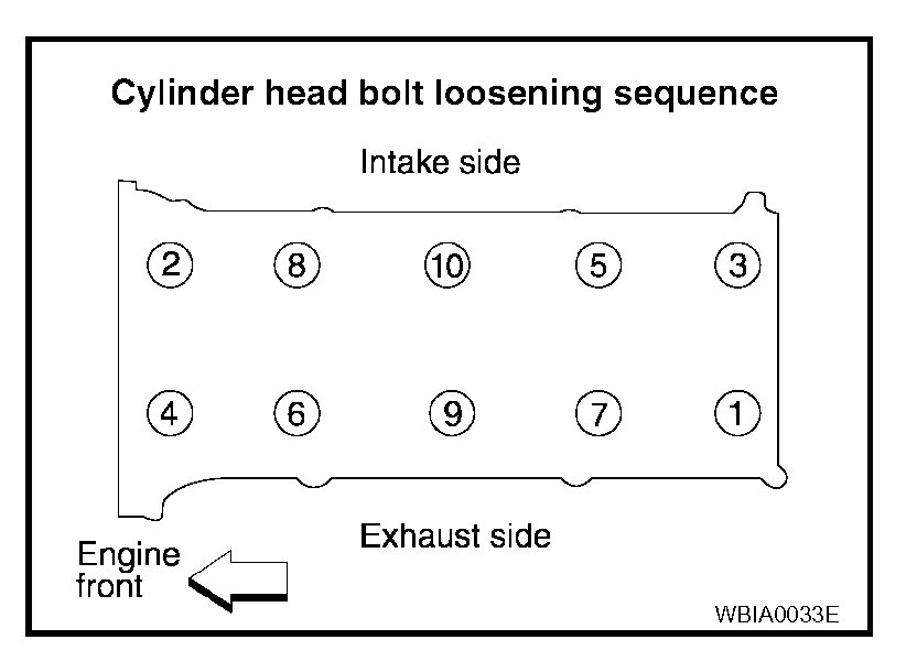

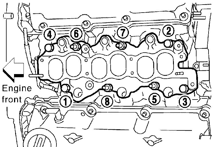

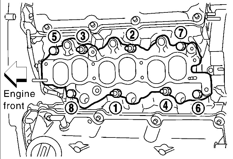

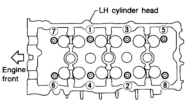

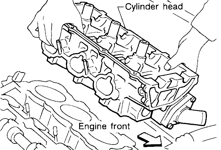

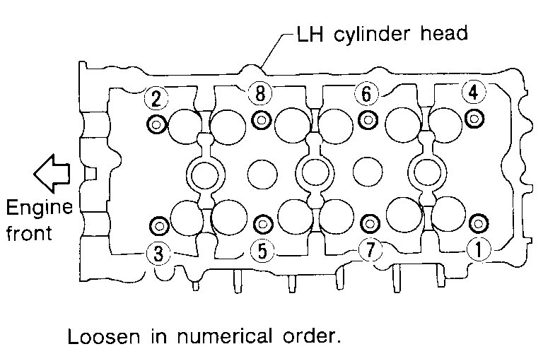

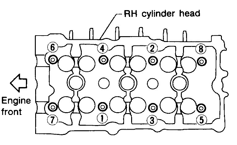

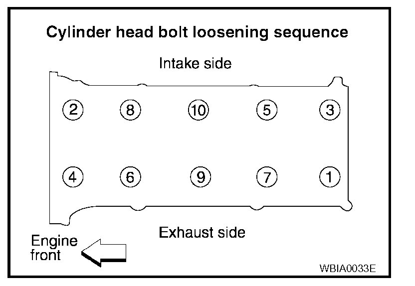

7. Remove cylinder head loosening bolts in the order as shown, using power tool.
8. If necessary to transfer to new cylinder head or remove for reconditioning, remove the intake manifold collector, intake manifold, and fuel tube assembly.

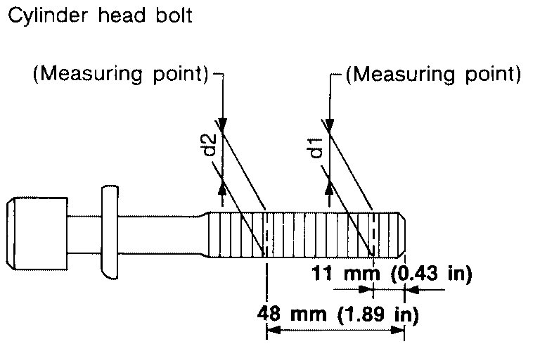

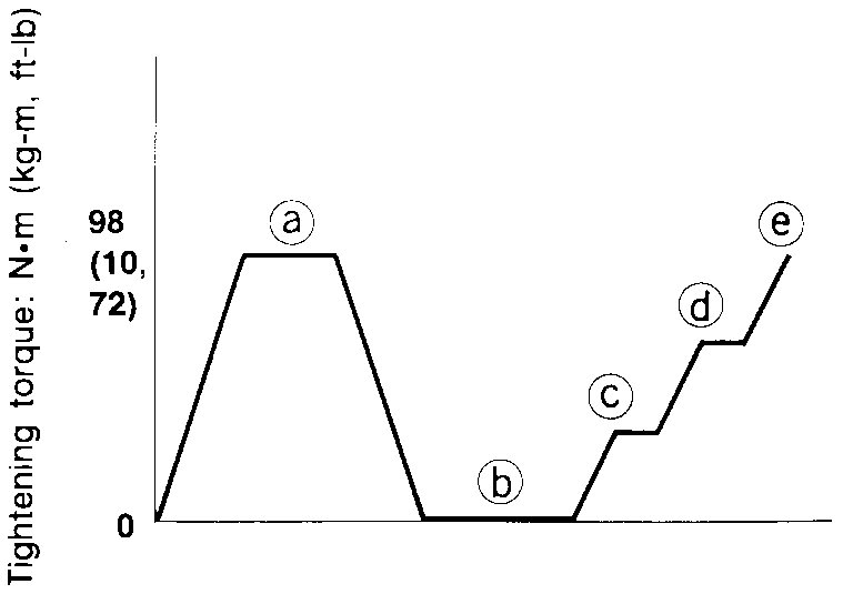

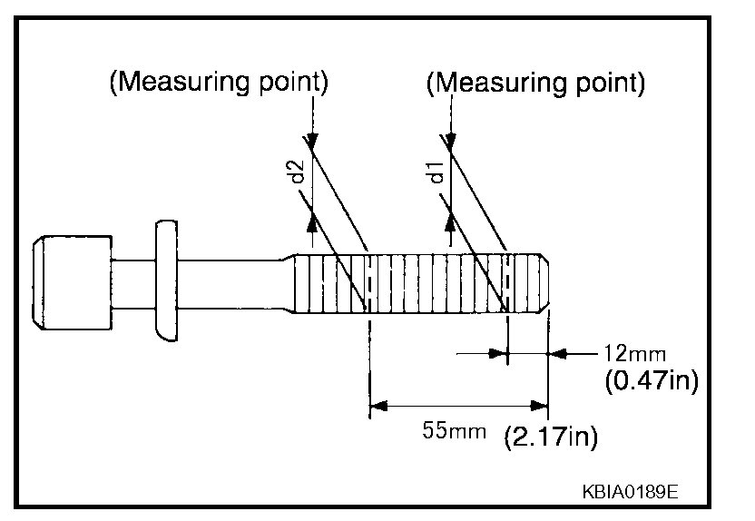

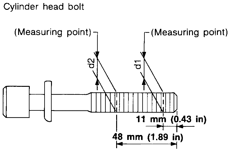

Outer Diameter of Cylinder Head Bolts
^ Cylinder head bolts are tightened by plastic zone tightening method. Whenever the size difference between d1 and d2 exceeds the limit, replace the bolts with new ones.
pic 28
Limit (d1 - d2): 0.23 mm (0.0091 in) or less
^ If reduction of outer diameter appears in a position other than d2, use it as d2 point.

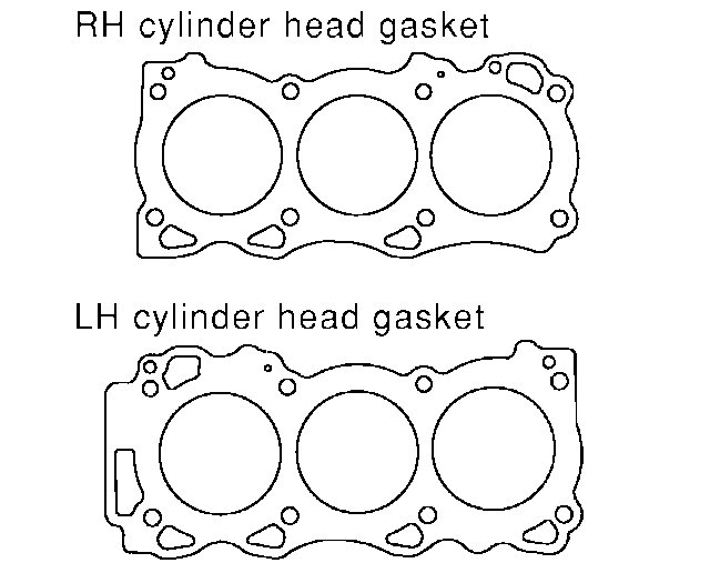

INSTALLATION
1. Install a new cylinder head gasket.

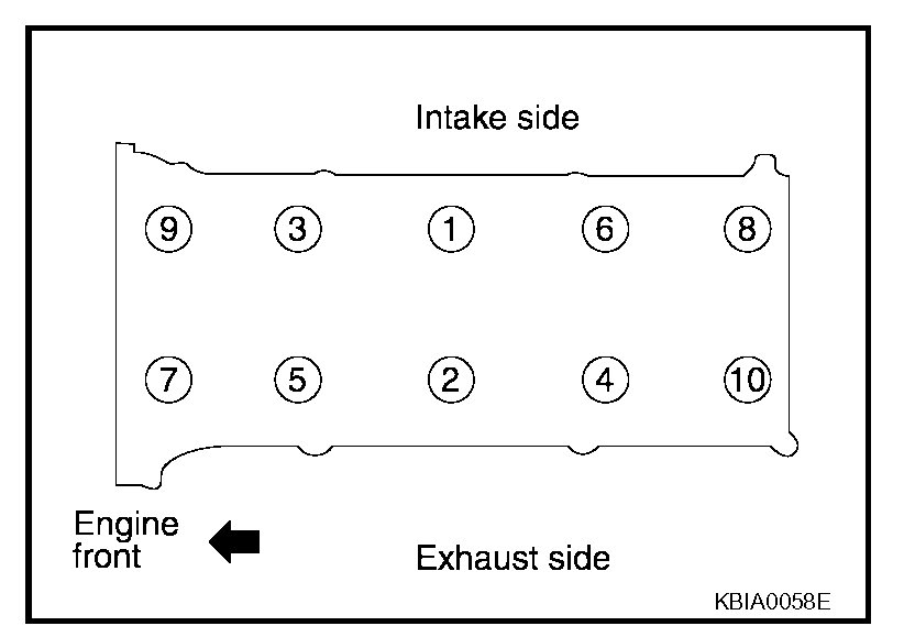

pic 29
2. Follow the steps below to tighten the cylinder head bolts in the numerical order as shown.
CAUTION:
^ If cylinder head bolts are re-used, check their outer diameters before installation. Refer to "Outer Diameter of Cylinder Head Bolts".
Step a: 98.1 Nm (10 kg-m, 72 ft-lb)
Step b: Loosen to 0 Nm in the reverse order of tightening.
Step c: 39.2 Nm (4.0 kg-m, 29 ft-lb)
Step d: 75° clockwise
Step e: 75° clockwise
pic 30
^ Apply new engine oil to the threads and the seating surfaces of bolts.
CAUTION: Check and confirm the tightening angle by using angle wrench or protractor. Avoid judgment by visual inspection without the tool.
pic 31

This is a big job, but if you take your time, you should be fine. Here are the directions specific to your vehicle for cylinder head removal. The attached pics correlate with the directions.
_____________________________________________
2006 Nissan-Datsun Altima V6-3.5L (VQ35DE)
Vehicle Engine, Cooling and Exhaust Engine Cylinder Head Assembly Service and Repair Procedures Removal and Installation
REMOVAL AND INSTALLATION

3. Remove the intake manifold using power tool.
^ Loosen the bolts in the numerical order as shown.

pic 3
5. Remove rear timing chain case bolts using power tool.
pic 4
6. Remove rear timing chain case using Tool.

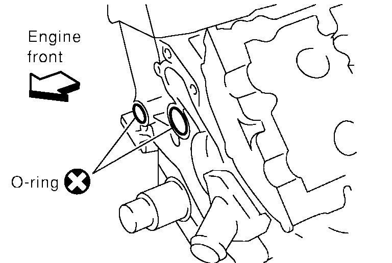

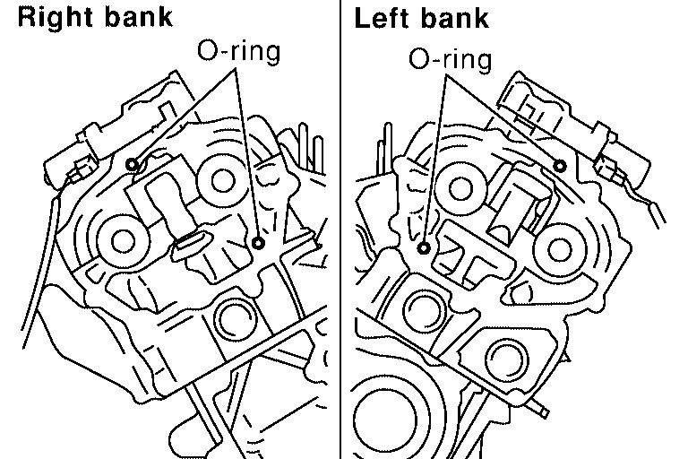

7. Remove the O-rings from the front of the cylinder heads.
^ Discard the O-rings and use new O-rings for installation.
pic 6
8. Remove the O-rings from the cylinder block.
pic 7

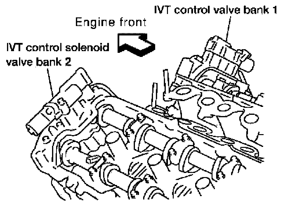

9. Remove the IVT control valves.
^ Discard the IVT control valve gaskets and use new gaskets for installation.

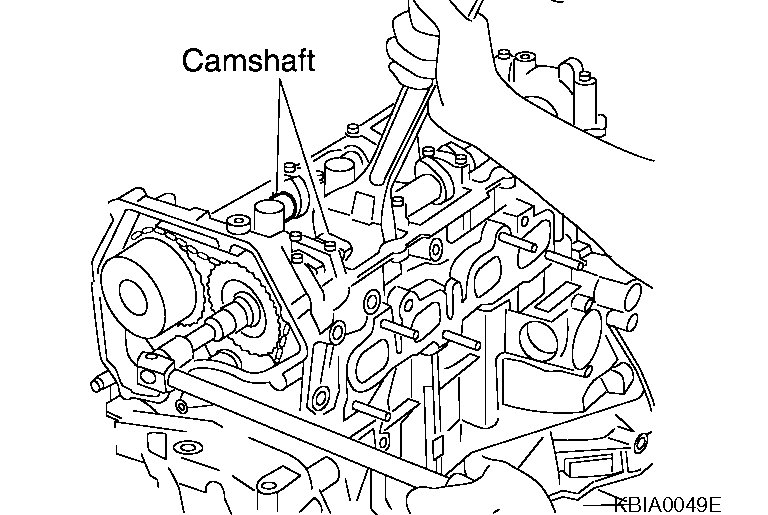

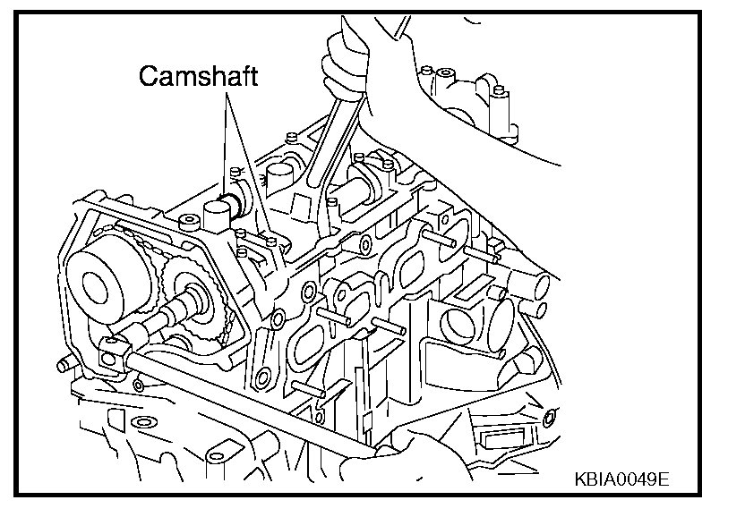

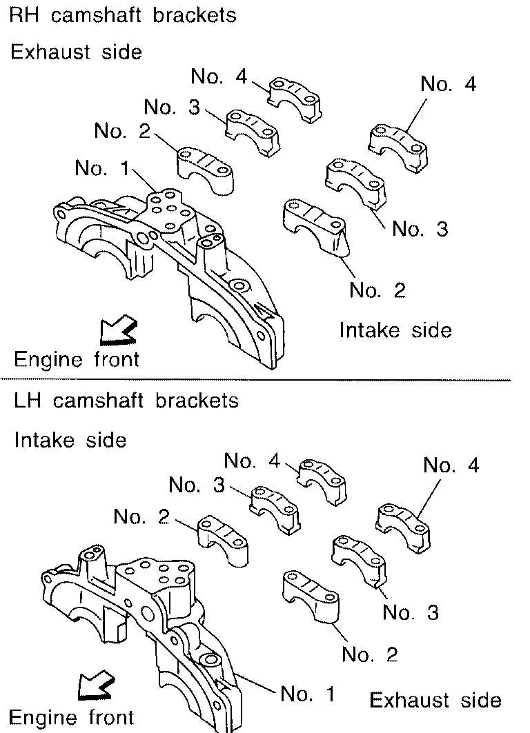

10. Remove the intake and exhaust camshafts and the camshaft brackets.
^ Mark the camshaft brackets so they are placed in the same position and direction for installation.
^ Equally loosen the camshaft bracket bolts in several steps in the numerical order as shown.
pic 10
pic 11
11. Remove the RH and LH cylinder head bolts, with power tool.
^ The bolts should be loosened gradually in three stages.
pic 12
12. Remove cylinder heads and gaskets.
^ Discard the cylinder head gaskets and use new gaskets for installation.

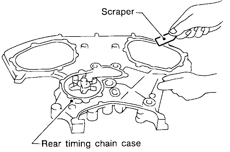

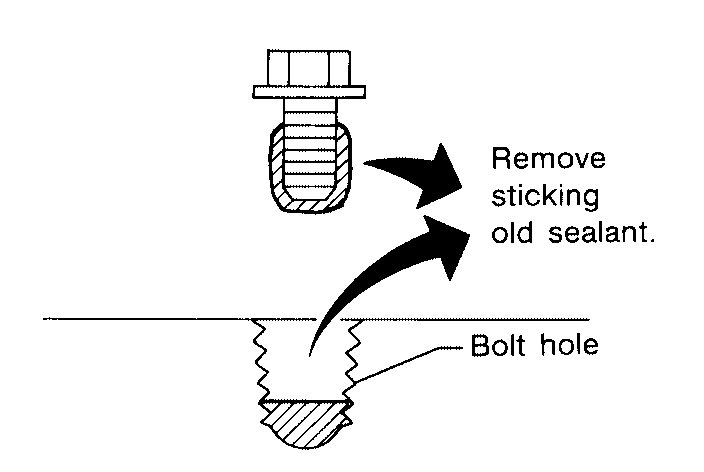

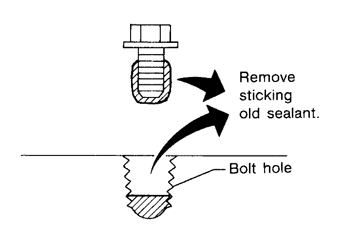

1. Before installing the rear timing chain case, remove the old Silicone RTV Sealant from mating surface using scraper.
^ Also remove old sealant from mating surface of cylinder block.
Pic 14
^ Remove the old Silicone RTV Sealant from the bolt hole and thread.
pic 15
2. Before installing the front cam bracket, remove the old RTV Silicone Sealant from the mating surface using scraper.
^ Do not scratch the mating surface.

3. Turn the crankshaft until No. 1 piston is set at TDC on the compression stroke.
^ The crankshaft key should line up with the right bank cylinder center line as shown.
4. Install new gaskets on the cylinder heads.
pic 17
CAUTION: Do not rotate crankshaft and camshaft separately or valves will strike piston heads.
5. Inspect the cylinder head bolts before installing the cylinder heads.
pic 18
CAUTION: Cylinder head bolts are tightened by degree rotation tightening method. Whenever the size difference between d1 and d2 exceeds the limit, replace the bolts with new ones.
Limit (d1 - d2): 0.11 mm (0.0043 inch)
^ Lubricate threads and seat surfaces of the bolts with new engine oil.

6. Install the cylinder heads on the cylinder block. Tighten the cylinder head bolts in the five stages in the numerical order as shown.
^ Tightening procedure:
pic 20
pic 21
Cylinder head bolts
Step a: 98.1 Nm (10 kg-m, 72 ft. lbs.)
Step b: Loosen in the reverse order of tightening
Step c: 32.9 Nm (4.0 kg-m, 29 ft. lbs.)
Step d: 90° rotation clockwise
Step e: 90° rotation clockwise
pic 22
7. Install camshaft chain tensioners on both sides of cylinder head.
Camshaft chain tensioner bolts: 7 - 10 Nm (0.7 - 1.0 kg-m, 62 - 89 inch lbs.)

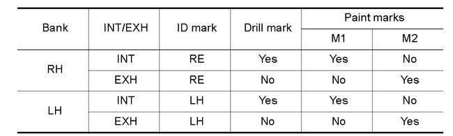

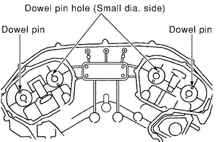

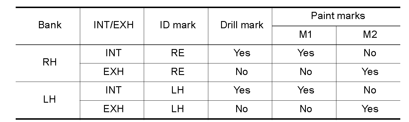

8. Install exhaust and intake camshafts and camshaft brackets.
^ Intake camshaft has a drill mark on camshaft sprocket mounting flange.
pic 24
^ Follow your identification marks made during removal, or follow the identification marks that are present on the new camshaft components for proper placement.
pic 25
pic 26
^ Position the camshafts:
RH exhaust camshaft dowel pin at about 10 o'clock
LH exhaust camshaft dowel pin at about 2 o'clock.
pic 27

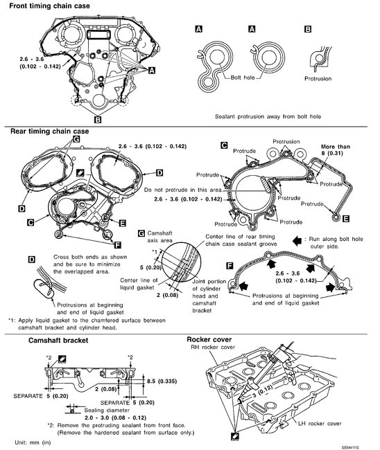

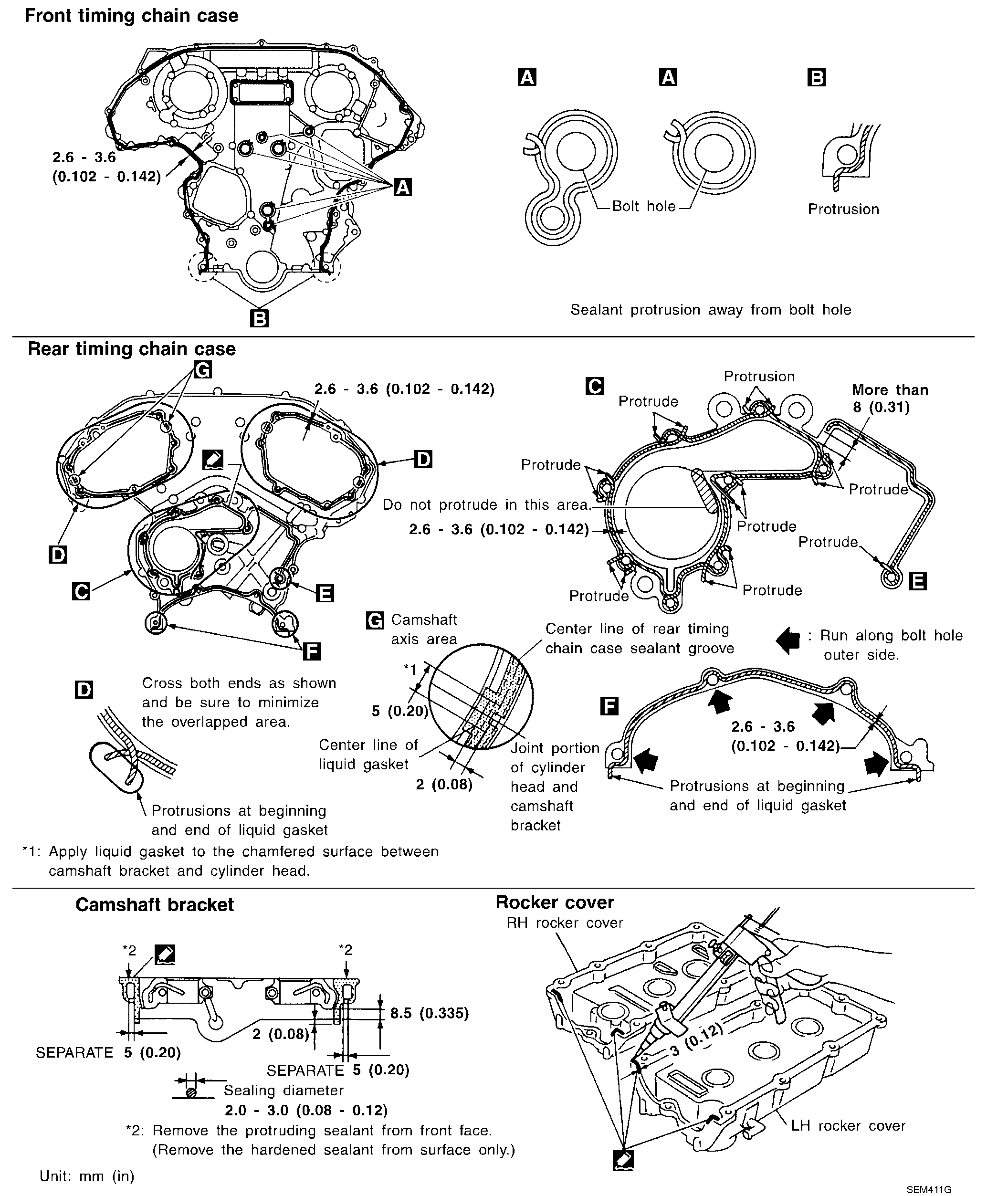

9. Before installing camshaft brackets, apply sealant to mating surface of No. 1 journal head.
^ Use Genuine RTV Silicone Sealant, or equivalent.
pic 28

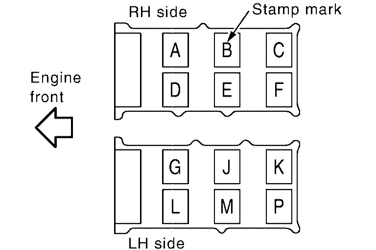

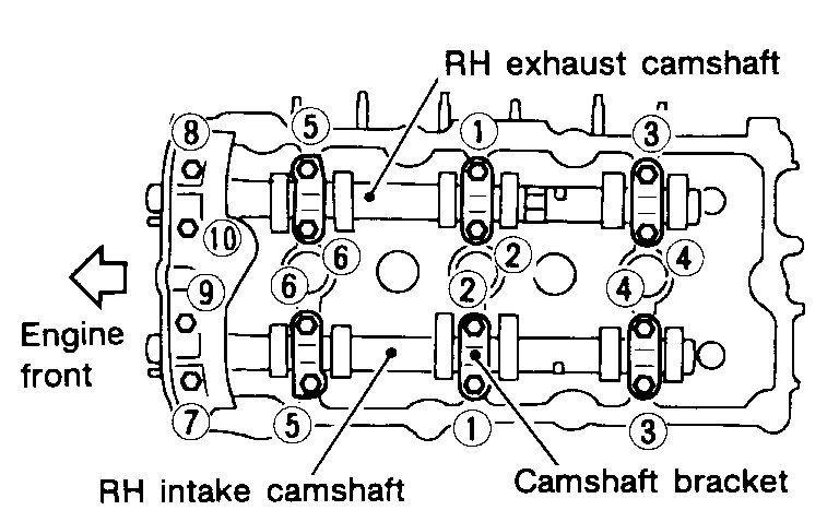

^ Install camshaft brackets in their original positions and direction. Align the stamp marks as shown.
^ If any part of valve assembly or camshaft is replaced, check and adjust the valve clearance.
Valve clearance (cold)
Intake: 0.26 - 0.34 mm (0.010 - 0.013 inch)
Exhaust: 0.29 - 0.37 mm (0.011 - 0.015 inch)
^ Lubricate the threads and seat surfaces of the camshaft bracket bolts with new engine oil before installation.
10. Tighten the camshaft brackets in the following three steps in the numerical order as shown.
pic 29
pic 30
pic 31
pic 32
11. Install the IVT control solenoid valves with new gaskets.
IVT control solenoid valve bolts: 10 - 12 Nm (1.0 - 1.3 kg-m, 87 - 112 inch lbs.)
pic 33
12. Install the new O-rings on the cylinder block.
pic 34
13. Install the new O-rings on the cylinder head.
14. Apply sealant to the specified portion of the rear timing chain case.
^ Use Genuine Silicone RTV Sealant, or equivalent.
pic 35
^ Before installation, wipe off the protruding sealant.
pic 36
15. Align rear timing chain case with dowel pins, then install on cylinder head and block.
16. Tighten rear chain case bolts in two stages.
a. Tighten bolts in numerical order as shown.
b. Retighten bolts in numerical order as shown.
17. Install the coolant outlet housing.

18. Install the intake manifold with a new gasket.
^ Tighten the bolts in the numerical order as shown.
Step 1: 5 - 10 Nm (0.5 - 1.0 kg-m, 44 - 86 inch lbs.)
Step 2: 26 - 31 Nm (2.7 - 3.2 kg-m, 20 - 23 ft. lbs.)
TIMING CHAIN
pic 1
REMOVAL
4. Remove generator. Refer to "Removal".
pic 2
pic 3
Tool number : KV10111100 (J-37228)
pic 4
13. Set the No. 1 cylinder at TDC on the compression stroke with the following procedure:
pic 5
b. At the same time, make sure that the mating marks on camshaft sprockets are lined up with the yellow links in the timing chain, as shown.
pic 6
a. Hold the crankshaft pulley using suitable tool, then loosen the crankshaft pulley bolt, and pull the pulley out about 10 mm (0.39 inch).
pic 7
b. Attach suitable pulley puller in the M 6 (0.24 inch diameter) thread hole on crankshaft pulley, and remove crankshaft pulley using a suitable puller.
pic 8
CAUTION:
pic 9
a. Push in the tensioner plunger. Insert a stopper pin into the hole on the tensioner body to hold the chain tensioner.
- Use a wire of 0.5 mm (0.02 inch) diameter as a stopper pin.
b. Remove the chain tensioner.
pic 10
c. Secure hexagonal part of the camshaft with a wrench and loosen the camshaft sprocket bolt and remove the camshaft sprocket for both camshafts.
CAUTION:
- Do not rotate the crankshaft or camshafts while the timing chain is removed. It can cause damage to the valve and piston.
pic 11
18. Remove the chain slack guide, tension guide, timing chain, and oil pump drive spacer.
19. Remove the timing chain tensioner for the balancer unit with the following procedure:
a. Lift the tensioner lever up, and release the ratchet claw for installation.
20. Remove timing chain for balancer unit and crankshaft sprocket.
pic 12
21. Loosen bolts in reverse order as shown, and remove balancer unit.
CAUTION:
Timing Chain
pic 13
pic 14
Limit : 0.15 mm (0.0059 inch) or more
INSTALLATION
NOTE:
- There may be two color variations of the link marks (link colors) on the timing chain.
- There are 26 links between the gold/yellow mating marks on the timing chain; and 64 links between the camshaft sprocket gold/yellow link and the crankshaft sprocket orange/blue link, on the timing chain side without the tensioner.
pic 15
CAUTION:
Tool number : KV10112100 (BT-8653-A)
CAUTION:
pic 16
Balancer unit bolts
Step 1 : 45.2 - 51.0 Nm (4.6 - 5.2 kg-m, 34 - 37 ft. lbs.)
Step 2 : 90° - 95° degrees rotation (Target: 90° degrees)
Step 3 (Loosen in reverse order or tightening : 0 Nm (0 kg-m, 0 ft. lbs.)
Step 4 : 45.2 - 51.0 Nm (4.6 - 5.2 kg-m, 34 - 37 ft. lbs.)
Step 5 : 90° - 95° degrees rotation (Target: 90° degrees)
pic 17
pic 18
pic 19
- Install by lining up mating marks on each sprocket and the yellow links in the timing chain as shown.
NOTE: Before installing chain tensioner, it is possible to change the position of mating mark on timing chain for that of each sprocket for alignment.
CAUTION:
b. Apply Genuine Silicone RTV Sealant or equivalent, to positions specified in the figure. Refer to "RECOMMENDED CHEMICAL PRODUCTS AND SEALANTS".
CAUTION:
pic 22
Front cover bolts : 12 - 13 Nm (1.2 - 1.4 kg-m, 9 - 10 ft. lbs.)
8. Install the chain guide between the camshaft sprockets.
a. Install IVT solenoid valves to IVT cover.
b. Install new oil rings to the intake camshaft sprocket insertion points on IVT control cover backside.
c. Install new O-ring to front cover.
pic 23
d. Apply Silicone RTV Sealant to the IVT cover as shown.
- Apply Genuine Silicone RTV Sealant or equivalent, to positions specified in the figure. Refer to "RECOMMENDED CHEMICAL PRODUCTS AND SEALANTS".
pic 24
e. Tighten the IVT cover bolts in the numerical order as shown.
IVT cover bolts : 12 - 13 Nm (1.2 - 1.4 kg-m, 9 - 10 inch lbs.)
10. Insert crankshaft pulley by aligning with crankshaft key.
- Tap its center with a plastic hammer to insert.
- Do not tap the belt hook.
Crankshaft pulley bolt initial tightening : 37.3 - 47.1 Nm (3.8 - 4.8 kg-m, 28 - 34 ft. lbs.]
pic 25
d. Turn crankshaft pulley bolt another 60° to 66° degrees [Target: 60° degrees].
12. Installation of the remaining components is in reverse order of removal.

After putting new head gasket on and having the head shaved, I set the timing marks on triple checked them and also put a new VVT on it. after filling up with oil and water I hooked the battery cable up the car started right up drove it five or six miles ran like a dream. then after driving it back home and parking it about ten to fifteen minutes later after the car had been turned off I got back in it started to town I got half a mile from the house and the check engine light came on. it still starts up and runs but it won’t let you give it any throttle. I had the code checked it was P0011. I don’t want to break it all back down just to make sure it is still in time. I need some advice thanks.
Feb 24, 2021 at 10:41 AM (Merged)
SCGRANTURISMO
  • 4,897 POSTS
Hi Matt, my name is Alex and I will be helping you today. I'm sorry, but this DTC is set when your camshaft for bank 1 is over advanced. The only real fix is to go back in and reset it, lining up the timing marks. Hope this helps.

Thanks for your help. I figured. Can just the timing cover come off without taking the whole oil pan off?
Feb 24, 2021 at 10:42 AM (Merged)
SCGRANTURISMO
  • 4,897 POSTS
From the looks of this exploded diagram it looks like there are two bolts in the front of the oil pan that need to be removed. If you choose not to remove the oil pan, I would very careful not to damage the oil pan gasket when removing the timing chain cover.

DOCFIXIT
  • 18,828 POSTS
Hi Must remove upper and lower oil pans first. Crankshaft pully then unbolt cover see diagram
https://images.2carpros.com/forum/automotive_pictures/198357_Graphic_350.jpg
You may want to click on site at bottom of post ie. manuals and get instructions . It is fairly complex task Hope this helps Thanks for donate

TGBARON
I thought that might be the case, I have a haynes manual it didnt say anything about removing the oil pans first. Well thanks Docfixit that helped alot. Greg
Feb 24, 2021 at 10:45 AM (Merged)
DOCFIXIT
  • 18,828 POSTS
Your Welcome sometime Haynes leaves out a few steps

REMOVAL: Disconnect the negative battery cable. Drain and recycle the engine coolant. Drain and recycle the engine oil. Properly relieve the fuel system pressure. Disconnect the air duct from the throttle body. Disconnect the intake manifold braces from the rear of the engine. Remove the exhaust manifold. Remove the alternator and all related brackets. Remove the distributor assembly. Using a block of wood, set a jack under the aluminum oil pan and remove the passenger's side engine mount. Remove the cylinder head cover. Remove the timing chain and camshaft sprockets. The lower timing chain should not be disengaged from the crankshaft sprocket. Remove the camshafts. The valve train components must be reassembled in their original positions. Be sure to note their locations. Loosen the cylinder head bolts in the illustrated order.
https://images.2carpros.com/forum/automotive_pictures/261618_1_20.jpg
A warped or cracked cylinder head could result from loosening in incorrect order. The cylinder head bolts should be loosened in two or three steps. Remove the cylinder head and intake manifold as an assembly. Remove the cylinder head gasket. INSTALLATION: Clean the gasket mating surfaces thoroughly. Inspect both the engine block and cylinder head for damage. Install a new cylinder head gasket. Ensure that the proper side of the gasket is facing up. Each gasket manufacturer will have a slightly different way of telling which side is up. Read the manufacturer's instructions carefully. Install the cylinder head and temporarily tighten the cylinder head bolts. This is necessary to avoid damaging the cylinder head gasket. Be sure to install washers between the bolts and cylinder head. Install the upper timing chain and cover. Tighten the cylinder head bolts in the proper sequence to the following torque specifications: A.Tighten all the bolts to 22 ft. lbs. (29 Nm). B.Tighten all the bolts to 10 ft. lbs. (79 Nm). C.Loosen all the bolts completely. D.Tighten all the bolts to 18-25 ft. lbs. (25-34 Nm). E.Turn all the bolts 86-91 degrees clockwise.If an angle wrench is not available, tighten all the bolts to 6-13 ft. lbs. (75-84 Nm). Install the camshafts. Install the timing chain and sprockets. Install the cylinder head cover. Install the passenger's side engine mount and lower the engine. Install the distributor assembly. Install the alternator and all related brackets. Install the exhaust manifold. Install the intake manifold braces. Connect the air duct to the throttle body. Refill and bleed the cooling system. Refill the engine with the proper grade and viscosity of engine oil. Connect the negative battery cable. Start the engine and make the necessary adjustments. Check for proper operation and leaks.

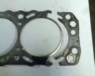

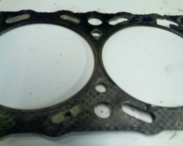

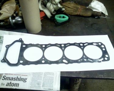

the head gasket is probably broken around cyl 4, by the dist. and ignition coil. the coolant will be leaking out between the head and block and will start to spray the ignition coil and kill the engine(takes only 5 minutes or so during a warm up), and, you won't be able to get it going again until it dries(next day). that cyl. is the one that fails on these because the coolant is allowed to flow between the head and block, but, the others don't because of the gasket design. over time the gasket can get saturated by the coolant and it looses it's integrity, then fails. the pics show a 2.4, 4cyl altima with this problem, however, the cyl bore was ok because of the ring aroung each one from the gasket and they kept the coolant out. when changing the gasket . . .
https://images.2carpros.com/forum/automotive_pictures/400521_082509_20581_1.jpg
https://images.2carpros.com/forum/automotive_pictures/400521_082509_20591_1.jpg
https://images.2carpros.com/forum/automotive_pictures/400521_082509_20592_2.jpg
