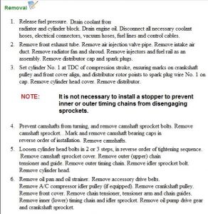

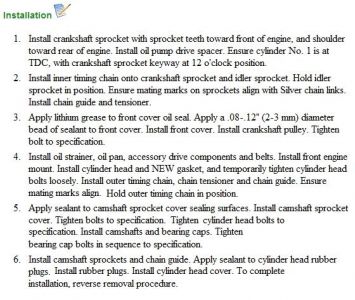

I Have The engine Ready For Dis-assembly but Need Two Have Step by Step Instructions Or Diagrams?Need To Know How To Remove Sprockets On Cams And How To Mark For Replacement? any Other Information,Tips Or Tricks To Get This Repair Done?

https://images.2carpros.com/forum/automotive_pictures/261618_Noname_2456.jpg
https://images.2carpros.com/forum/automotive_pictures/261618_Noname2_803.jpg
https://images.2carpros.com/forum/automotive_pictures/261618_1_185.jpg
https://images.2carpros.com/forum/automotive_pictures/261618_Graphic_609.jpg
https://images.2carpros.com/forum/automotive_pictures/261618_Graphic2_84.jpg
