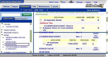

my wife forgot to put coolant on the car then when we were traveling the car overheated and i noticed a holes on the radiator..so we rested and bought a coolant and filled the radiator but every couple of miles the temp goes up so we took a break and re-fill the radiator with water until we arrived at my mechanic. he called me today at work and said that my car has a blown head gasket. Thanks

Radiator leaking will cause it to overheat there's not enough or no coolant flowing-get it block and pressure tested to find out for sure if its the headgasket

So how much is the estimate for the repair of blown head gasket for my car please ?...i need to know so i can make decisions?

Labor rate per hour varies with location could range from $70 to $130.00 USD per hr shop around
https://images.2carpros.com/forum/automotive_pictures/12900_headgasket_1.jpg
