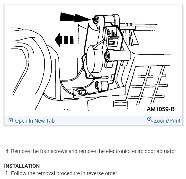

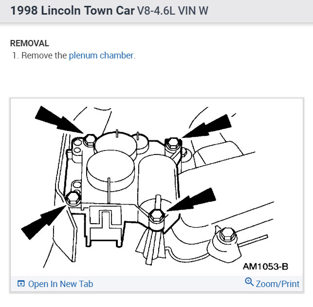

It sounds like your blend door actuator needs to be replaced. You can do it yourself but its a long and annoying job that requires removing the dash. The part cost between $65.00 to $80.00 depending on where you go. If you go to a shop expect to pay between $600.00 to $850.00. Sometimes you can get your hands in there to do it here is a guide to help walk you through and the location of the blend door actuators.
Check out the diagrams (Below). Please let us know if you need anything else to get the problem fixed. Cheers,

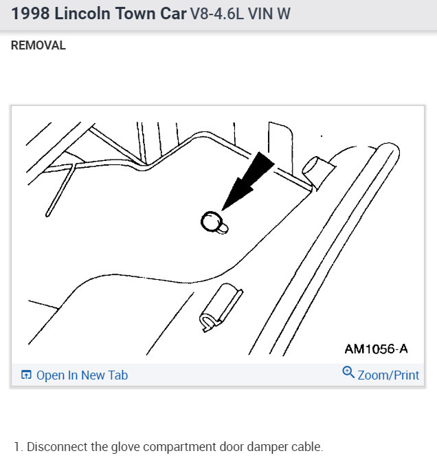

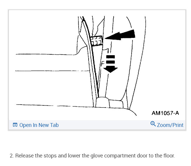

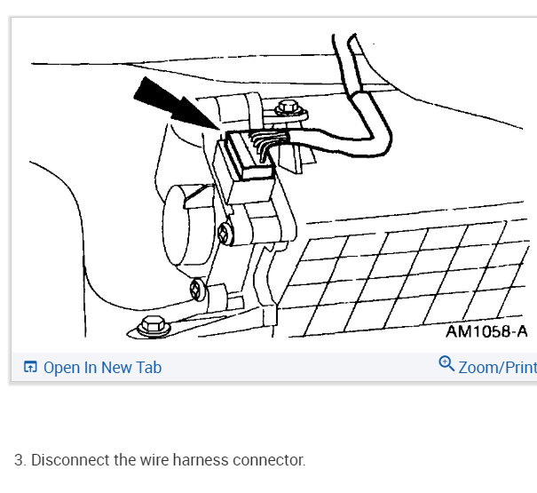

Found answer to my question. The drive module for the blend door behind the glove box (no need to remove dashboard) has an internal variable resistor that signals its location to the automatic climate control module. (ATC) From resistance changes the ATC determines the drive location.
