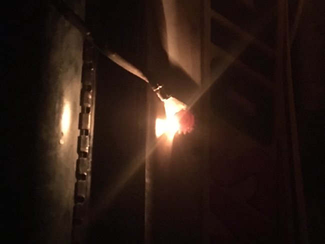

Just recently my car Temperature gauge will climb to hot and sometimes it will start to ding. I can shut it off and start it back up and the needle will go back down. When I drive with a scan tool hooked up the Temperature never goes above 164. Voltage does not go down past 2.32 volts. Should I change the Thermostat since it's only reading the coolant at 164 degrees. OE temp for the Thermostat is 195 degrees. Could this be a coolant flow problem, Temp sensor but it seems to be reading fine. Voltage and temp isn't erratic, possibly the Thermostat is opening to soon?

Ok I replaced the thermostat and temp sensor. On the scan tool the temp is showing how it should now. I have a check engine light P0118 which is temp sensor voltage too high. I'm assuming I have a short some where. The car is getting hot. It's gets to 325 degrees and higher.

Checked the temp on my car after work. Car had been sitting for 9 hrs. Temp was reading 188 degrees. When you unplug the pigtail the temp jumps to 290 degrees 5volts. With isn't right. Checked the wire from the pcm harness to the temp sensor and it reads .2 ohms and beeps. No break in that wire. At this point I'm assuming it's electrical. I swapped out the pcm with a known working one and it didn't change the temps. Thought maybe the pcm was sending the wrong reference voltage.

I fixed it. Sorry for the very late response. It ended up being a ground wire. The bolt that holds it down was broken in half and was arcing cause (causing high resistance) the guage to be irratic. Replaced the bolt and the problem went away.
