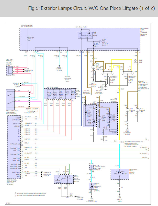

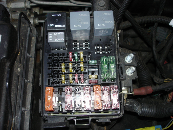

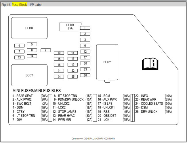

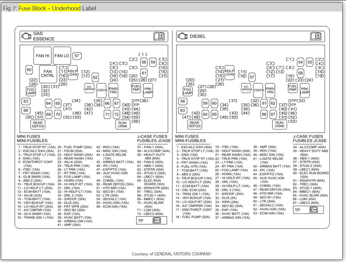

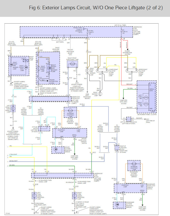

So, my LED lights on both left and right as well as the top rear light don't work as running lights suddenly. Lights are not burnt out as when I press on brake, all lights light up as brake lights. They are just not running on their normal dim running light. all other parking lights work, on back and front. just the two rows that function as both break and running lights. I only find a parking light fuse in the motor fuse box. nothing in the cabin fuse box that would relate to running lights.
Dec 13, 2014 at 2:33 AM
HMAC300
  • 48,601 POSTS

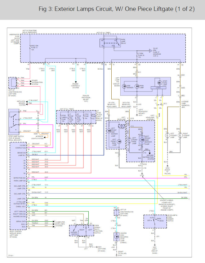

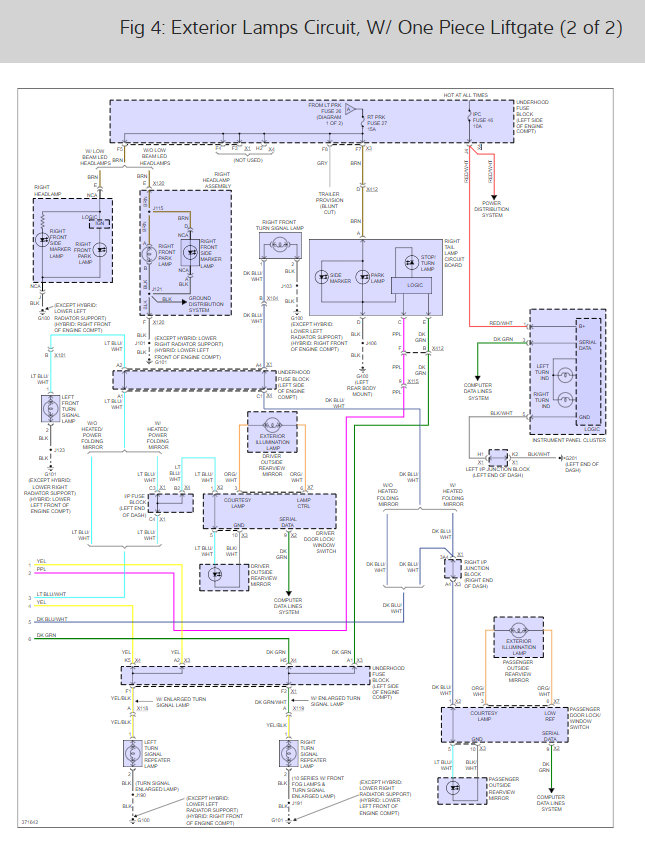

It sounds like you have a tail light relay that is not working here is a guide to help you check it.
Here are the tail light wiring diagrams so you can see how the system works and relay location
Cheers
Dec 13, 2014 at 3:24 AM
DALEBLAKE
Thanks, all fuses are good. Then I checked the relay and it was out. I got a new one for $23.00 and installed it everything works great again thanks I love this site.
