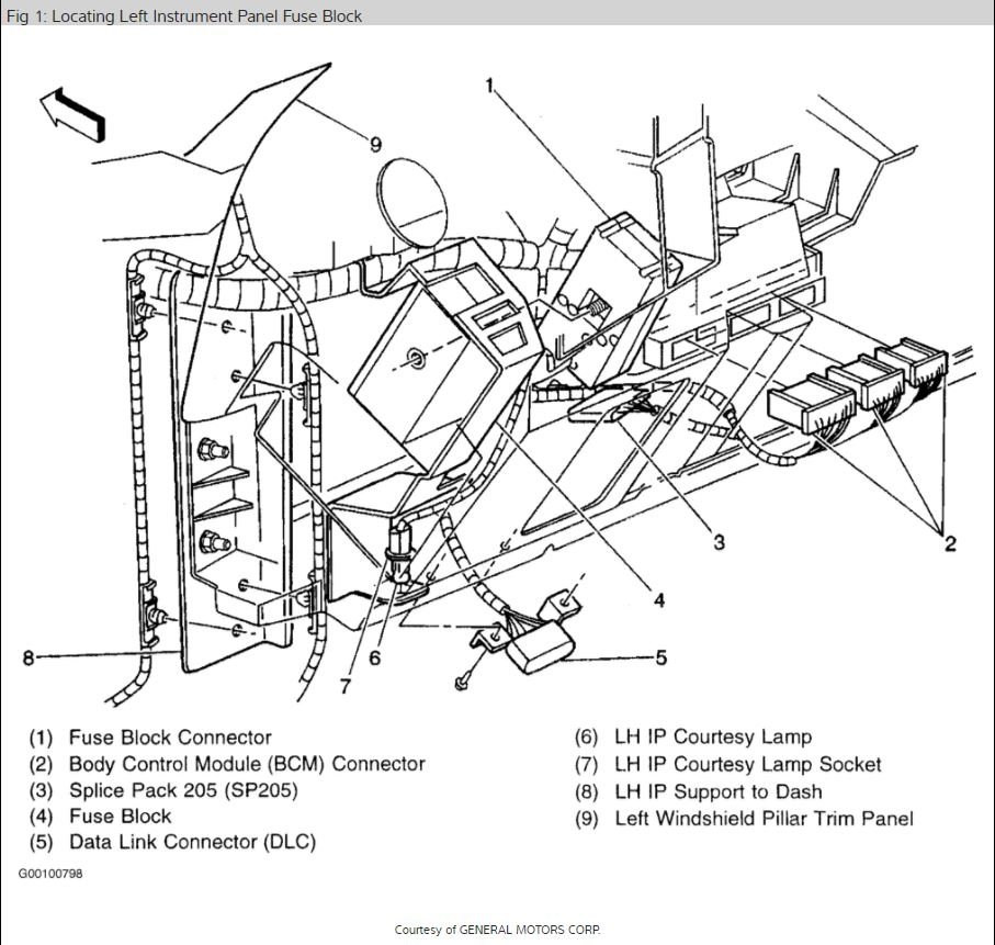

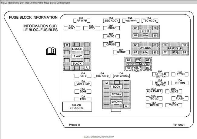

Check the "VEH CHMSL" fuse in the left I/P fuse block, located behind lower left side of dash. That is for the third brake light.

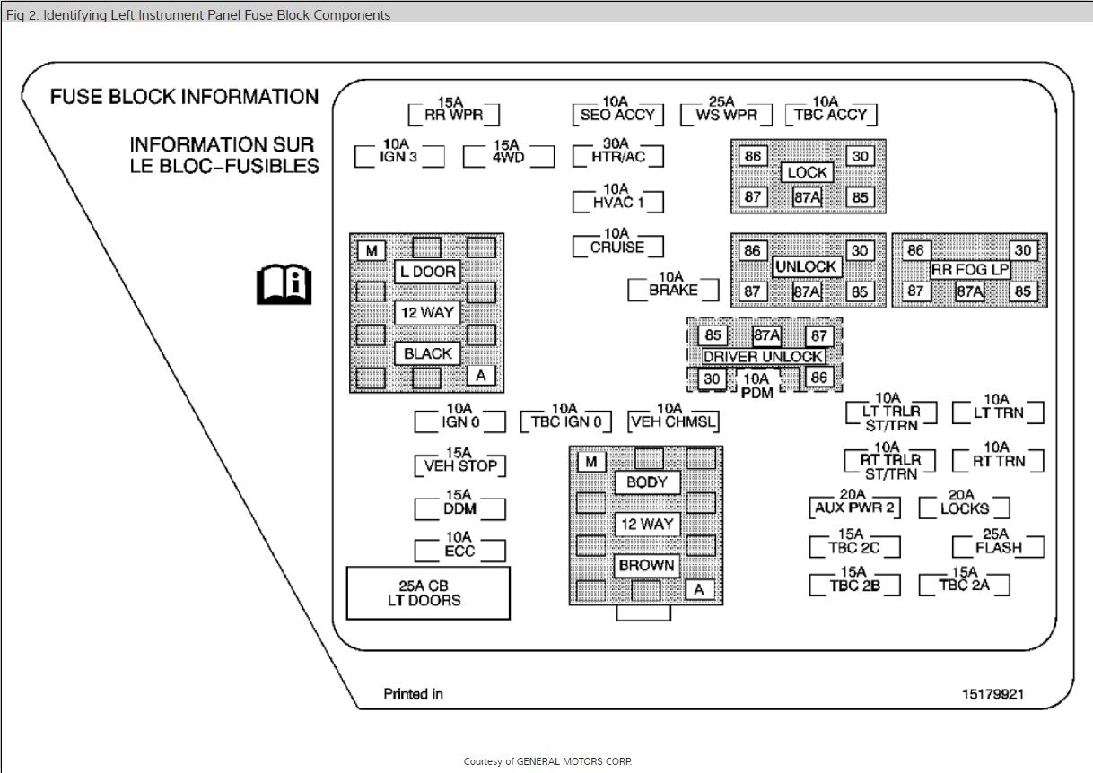

Which fuse is it exactly?
Apr 19, 2018 at 2:35 AM
VEH CHMSL in the fuse box. use a test light and make sure it has power on both sides with the brakes applied.

In the I/p fuse block shown and the fuse shown in the center shown as VEH CHMSL.
