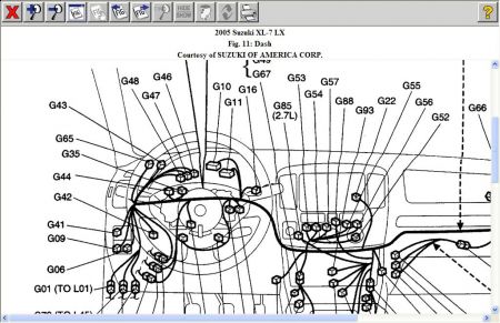

the a/c compressor on my 2005 suzuki xl7 short cycles on hot,sunny days only. dealer checked it out. charge and pressures good. he found no problems at all. i told him when it happens etc. and writer told me that it shouldn't matter where and when he checks it. after 2 days of nothing i picked it up and got a different writer who mentioned that another suv had the same problem and it was the sun sensor but he couldn't be sure if i had the same problem. i am trying to find out where the sun load sensor is located. i don't even know what it looks like. can anyone help?

In my references I came up as sunlight sensor its located under top left side of dash-see below item G43-Good Luck
https://images.2carpros.com/forum/automotive_pictures/12900_sunlight_sensor_1.jpg
