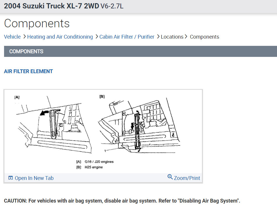

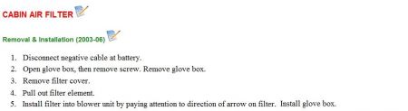

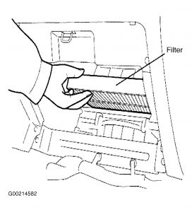

I would like to replace a cabin filter in my Suzuki XL-7 2004?
Sep 5, 2010 at 3:27 AM
BLUELIGHTNIN6
  • 16,542 POSTS
Here is a guide to help you step by step with instructions in the diagrams below to show you how on your car.
https://images.2carpros.com/forum/automotive_pictures/261618_Noname_2668.jpg
https://images.2carpros.com/forum/automotive_pictures/261618_Graphic_682.jpg

I've check my owner's manual but cannot find ref to the location of the air cabin filter, or how to change it. Can you assist?

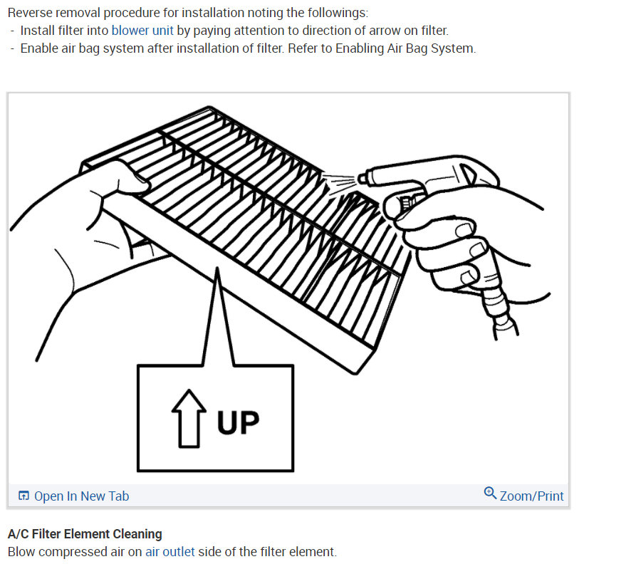

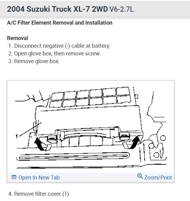

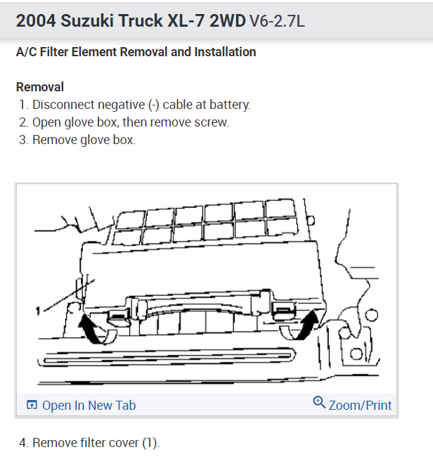

CABIN AIR FILTER
Removal & Installation (2003-06)
Disconnect negative cable at battery.
Open glove box, then remove screw. Remove glove box.
Remove filter cover. See Fig. 1 .
Fig. 1: Removing Filter Cover
Courtesy of SUZUKI OF AMERICA CORP.

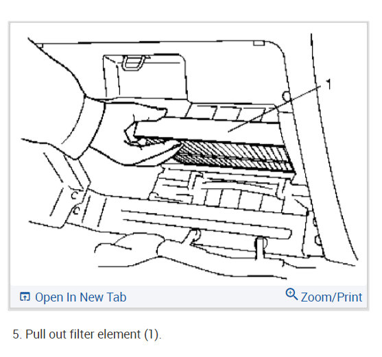

Pull out filter element. See Fig. 2 .
Fig. 2: Removing Filter

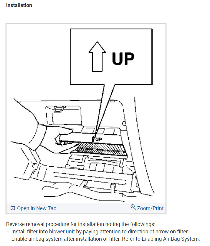

Install filter into blower unit by paying attention to direction of arrow on filter. See Fig. 3 . Install glove box.
Fig. 3: Installing Filter
Sep 11, 2020 at 6:22 AM (Merged)
