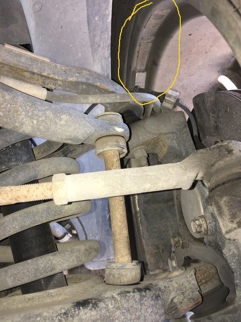

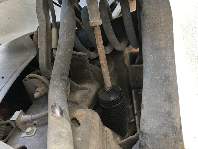

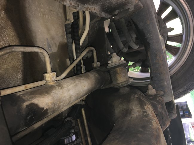

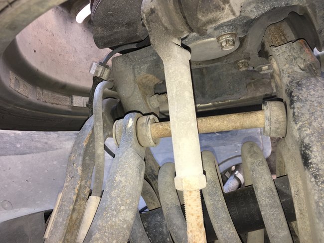

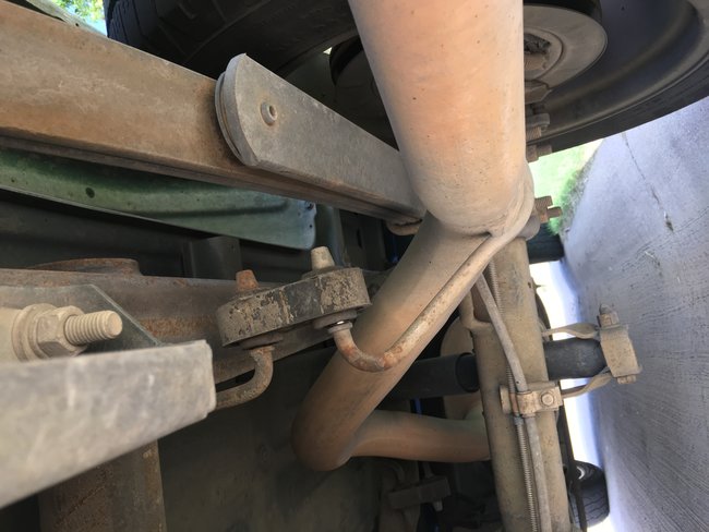

I will send a picture of the underneath so you can tell me for sure what I have.
May 11, 2017 at 11:21 PM
HOFFY52
  • 16 POSTS
Here are pictures of my under carriage. Can you tell if I am torsion bar. I have rack and pinion steering. I need to know exactly what version suspension I have to order parts of needed after I do the wheel rotation.
May 12, 2017 at 1:17 AM
STEVE W.
  • 15,322 POSTS
You have a coil front leaf rear suspension system. With rack and pinion.
But take a close look at the circled area in your picture. That is leftover tape from stick on wheel weights. It looks like you have lost quite a few. First thing I would do is get those tires looked at and re-balanced. Then see if the shake is gone.
May 12, 2017 at 3:50 AM
HOFFY52
  • 16 POSTS
Your a genius. I never noticed. That is the side it feels like it is coming from. I will do that today and get back to you.
May 12, 2017 at 3:54 AM
HOFFY52
  • 16 POSTS
Update: I took my truck in. They found the left side front and back had separated belts. I bought two new tires put them on the front. Balanced all. And severe shaking is gone. Great diagnosis guys. Much appreciated in your help. Now I am going to return all the parts I bought. I will get two more new tires soon and hopefully it did not wear out my front end too bad.
