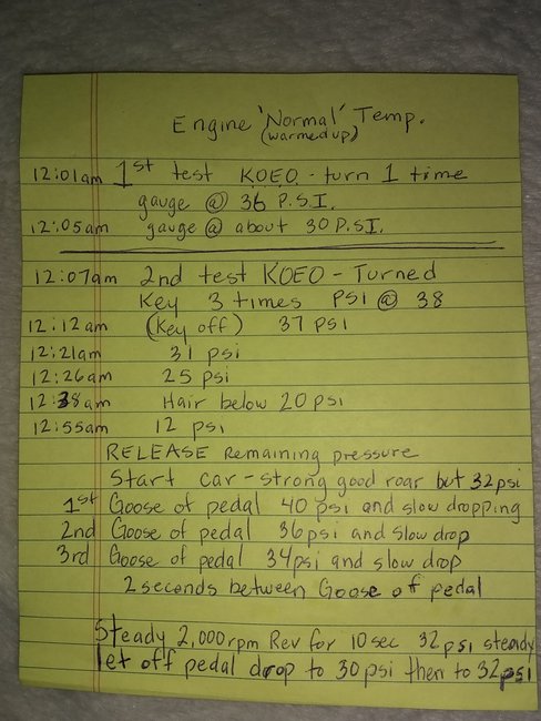

Okay, as per our last conversation, did you check the fuel pressure?
Yes, it could be the ECM but we need to be sure as that is an expensive guess.

What should the fuel pressure be?
Jun 17, 2020 at 7:28 PM
The fuel pressure should be 40-45 pounds with the key on.
It should be 40 pounds running.

I did the fuel pressure test. I ran the test with the car is norma idle temperature. Attached are the notes that I took during the test. As you can see the pressure is low.
Jun 24, 2020 at 7:14 AM
Thanks. I wish everybody would take notes like that.
Looks like you need a fuel pump.
https://www.2carpros.com/articles/how-to-replace-an-electric-fuel-pump
