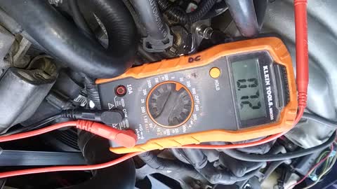

Once warmed up the RPM's will surge between 2,000 to 3,000 with my foot steady on the gas pedal. Sometimes the car jerks hard and will stay at 3,000 RPM's for 5 seconds. Sometimes it jerks and go's to 2,000 RPM'S. Sometimes after the RPM's come down to normal it goes back up after I put my foot on the gas pedal again. I always take my foot off the pedal as soon as the surges start, keeping it off until RPM'S come down.
Twice I put a new TPS (non adjustable type) in and each time it reads 1.34 volts and I only get it to go as low as 1.24 volts. It should be 1 volt.
There are no trouble codes, no check engine light and the repair shop couldn't find the problem.
I cleaned and checked the IAC, MAF, Throttle body/butterfly, lubed the cables and spring. Changed the transmission filter and fluid, new fuel pump, filter and strainer. New temperature sensor and radiator. Cleaned the air filter, there's a high performance air intake in the car.
I also changed out the dry vacuum hoses and smoke tested the engine for leaks.
I've increased the mpg from 14 to 17 with all this work but I can't stop the RPM's from surging. I've been fighting this issue for over a year and I'm at my wits end.

The TPS voltage should be .5 to .75 volts at closed throttle. Are you sure the throttle plate is not partially open?

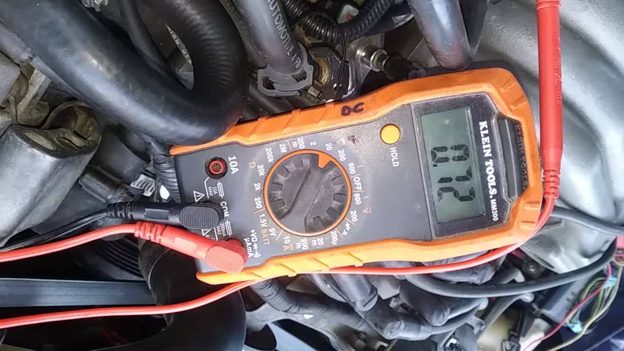

Sorry Its been a while since my last reply. I've been experimenting with several TPS settings. I'm down to a setting of .72 and I still keep getting the surges. I've made two discoveries. #1)When the engine is cold and I pulled the IAC off the car stalls immediately. It stays running when the engine is warm and I pull off the IAC although kind of weak. #2)When the engine is cold I get a steady TPS reading of .72 but when the engine is warm I get an erratic bouncy reading between .72 and .73 on the voltmeter. Staying mostly towards .72, I'm using a good Klein tool multimeter. I'm not sure if my discoveries has any relevance to my problems but I thought I'd let you know. Also I did as you said and put the base idle at 500 RPMs with the IAC off
Oct 1, 2019 at 11:50 AM
AKANYR
  • 52 POSTS
Here's a video of the reading bouncing erratically.
Oct 1, 2019 at 12:07 PM
The TPS voltage is good. that is not causing the problem.

That voltage to the TPS is fine. You are good.
You need to look in another direction. The TPS is not the issue at all.

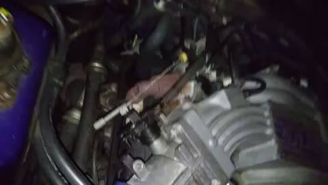

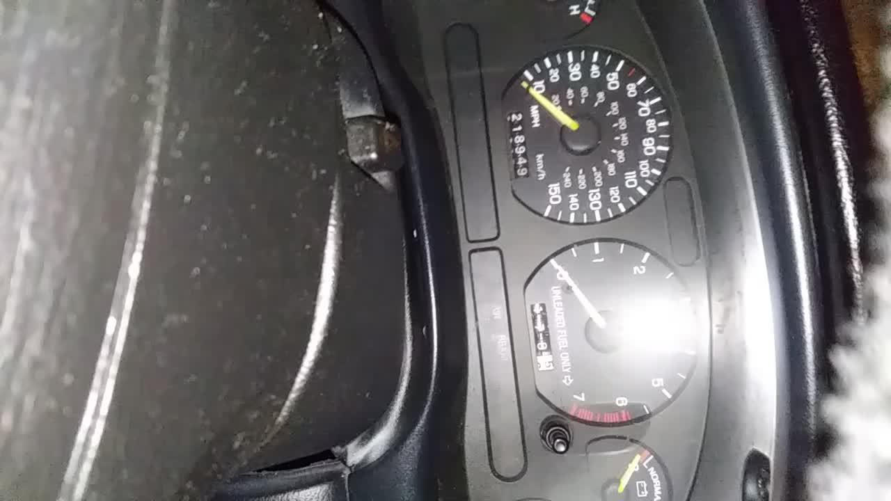

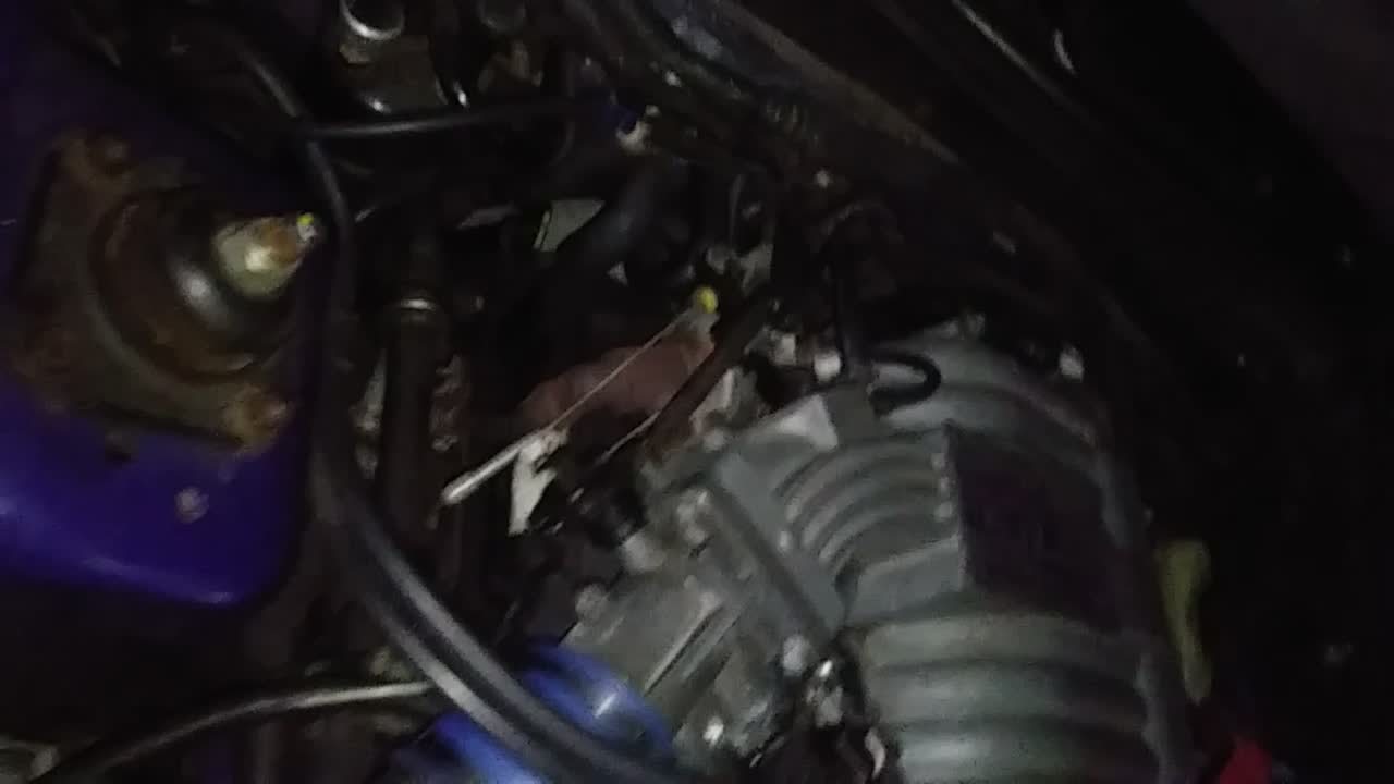

Here's the videos of how it sounds running you asked for. The dashboard video is it starting up after sitting 9 hours in 60ish degree weather. The second video is after driving it 35 minutes home. The rattling noise in the engine is the alternator, its always been like that.
Nov 18, 2019 at 2:59 PM
Do you have a scan tool that you can read what the IAC counts are?

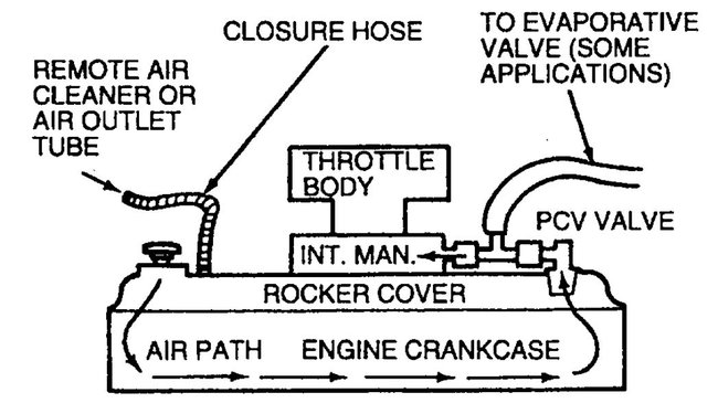

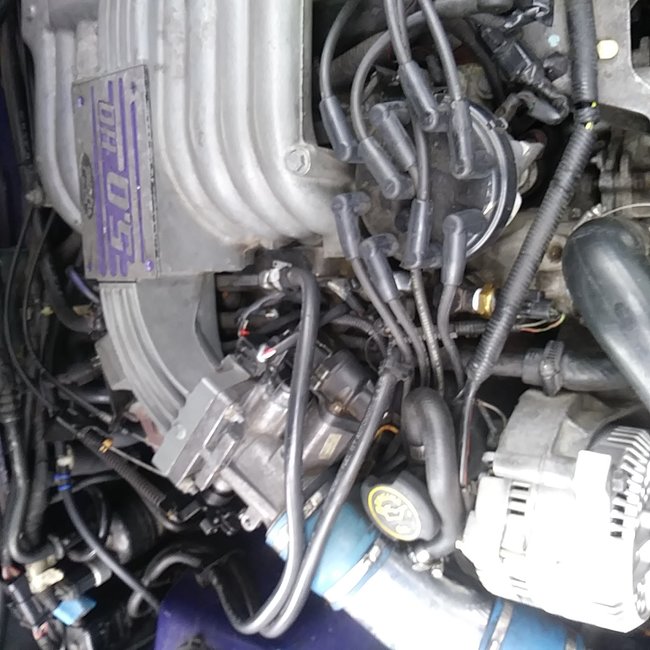

Okay, I attached the PCV location for you.
I would replace the IAC valve. It cannot be cleaned as the part that sticks is not available to clean.
The TPS has no effect on the high RPM. Make sure the voltage is set at .5 to .75 volts at closed throttle.

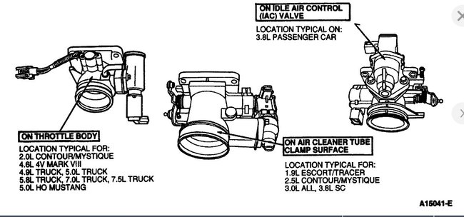

Throttle Body Assembly Decal Location
Throttle bodies with sludge tolerant design are identified with a yellow/black decal. This decal warns that the throttle plate stop screw must not be adjusted counterclockwise (backed off), as this will not reduce the engine speed but may cause the throttle plate to stick in the bore. Backing out the screw may be required if the throttle body has been previously serviced (a plug in the throttle plate orifice may be present), or the plate stop screw tampered with (TP Self-Test output out of range). The decal also warns that the throttle body must NOT be cleaned inside the bore, as this cleaning will impair the sensitive coating. The sludge accumulation will not affect the idle air flow. The cleaning procedure for the IAC valve still applies.

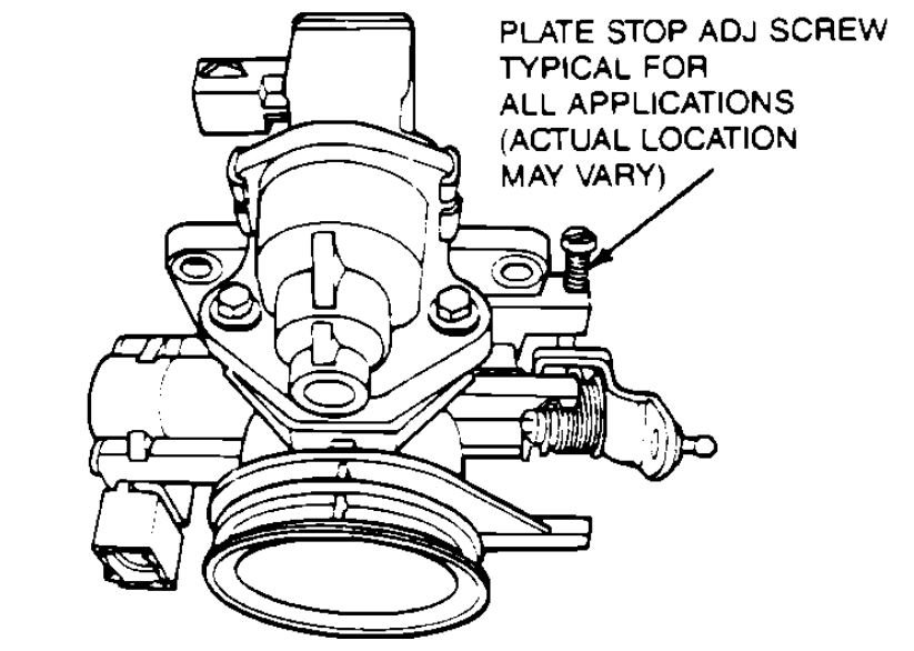

PROCEDURE
STEP 1
With the engine Off, connect a tachometer according to manufacturers instructions. Disconnect the negative (-) terminal of the battery for 5 minutes, then reconnect it.
STEP 2
Start the engine and allow the idle to stabilize for two minutes. Goose the accelerator, and let the engine return to idle. Lightly depress and release the accelerator, then let the engine idle.
STEP 3
If the engine does not idle properly, proceed with this procedure.
NOTE: In some cases, even if the idle speed is OK, proceed with this procedure if the customer's complaint persists (idle air control duty cycle may be out of range).
STEP 4
Turn the engine Off, and install a 0.025 in feeler gauge between plate stop screw and the throttle lever.

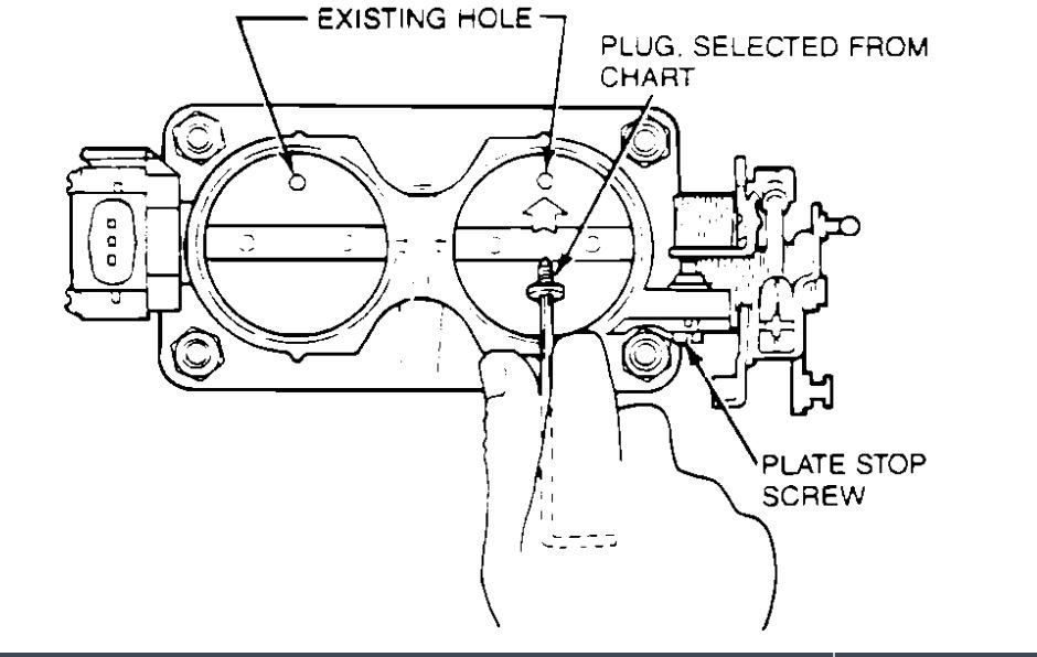

Throttle Plate Orifice Plug
RPM TOO LOW
a. DO NOT clean the throttle body, check for the plate orifice plug.
IF NO PLUG, turn the screw clockwise to the desired rpm.
IF PLUG from previous service, remove and adjust the screw in either direction as required. Screw must be in contact with the lever pad after adjustment.
RPM TOO HIGH
a. Turn Off the engine.
b. Disconnect air cleaner hose.
c. Temporarily block the throttle plate orifice with tape. If the orifice already has a plug from previous service, proceed to Step (e).
d. Restart the engine, and check idle speed, using a tachometer.
NOTE: Vehicles with Mass Air Flow Sensors, reconnect the air intake duct hose before checking idle rpm. If the engine stalls, crack open the plate stop screw, DO NOT over adjust.

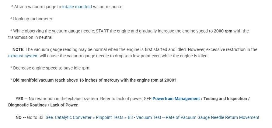

e. If rpm continues to be fast, Run Key On Engine Off (KOEO) Self-Test.
f. If rpm drops to the the value in Step 7 or lower, or the engine stalls, turn the engine Off, disconnect the air cleaner hose, and remove tape from throttle plate.
g. Install the proper color coded orifice plug, according to the throttle plate orifice size.
h. Reconnect the air cleaner hose, and Start the engine. Check the idle rpm using a tachometer. Turn the plate stop screw clockwise to the nominal rpm +/- 25 rpm shown in Step 7.

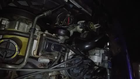

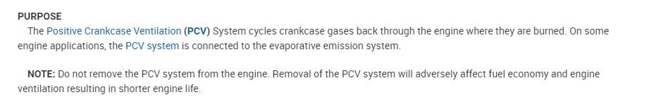

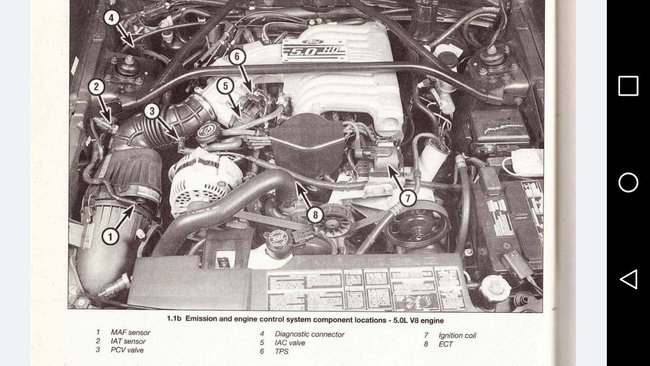

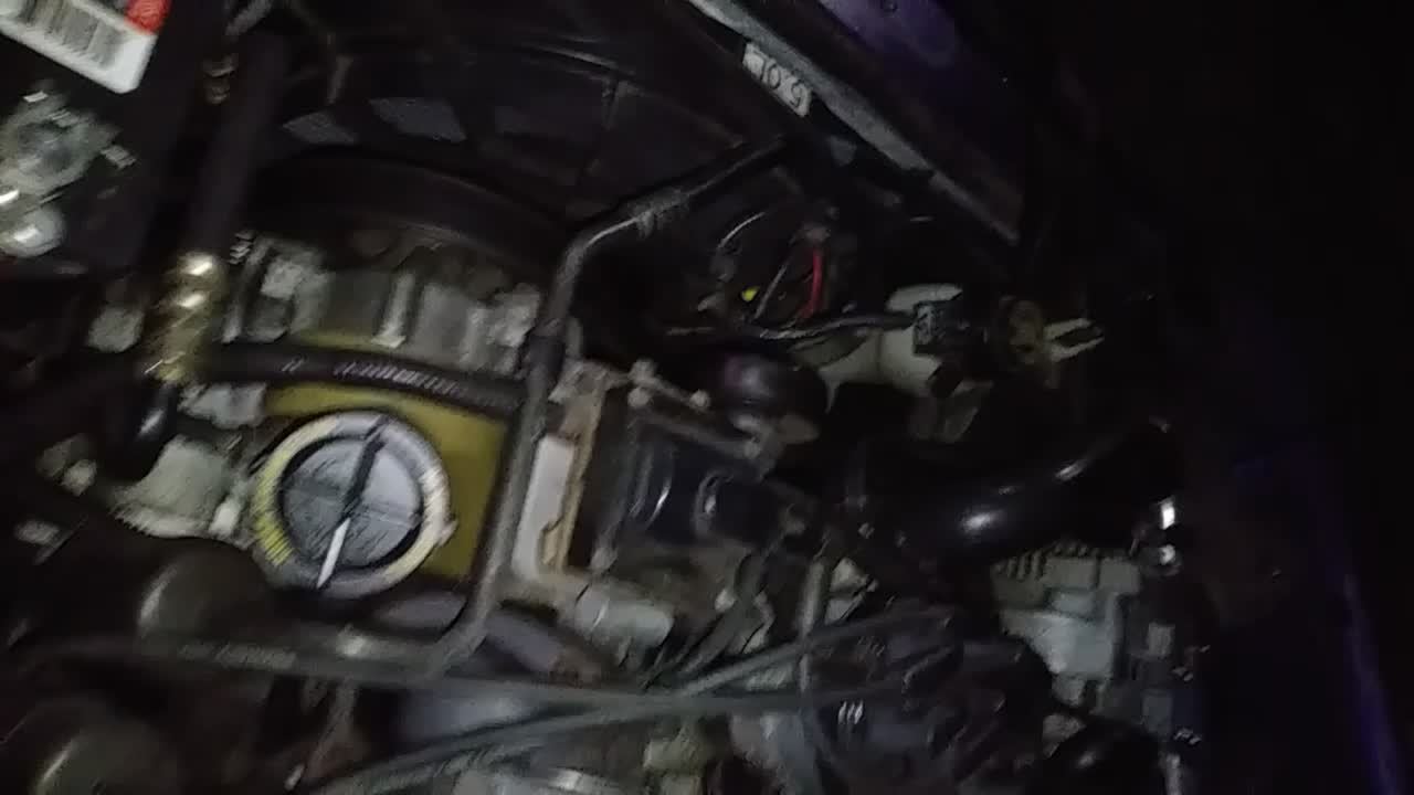

I attached a picture of where my PCV should be but its not there. I found it in a Hayne repair manual for my car. It should attach to a tube from the oil filler neck to the cold air induction near the throttle body. I've been running my car almost 3 years without one. The one that's made for my engine won't fit into the cold air induction tube a prior owner put on. I'm thinking of finding a PCV that will fit on even if I have to rig one up. What do you think?
Feb 12, 2020 at 10:09 AM
What is the complete VIN number of your car?
Feb 12, 2020 at 10:49 AM
AKANYR
  • 52 POSTS
VIN: 1FALP42T5SF105453.
Feb 12, 2020 at 11:50 AM
You do not have the PCV in the passenger valve cover at the rear?
Feb 12, 2020 at 1:04 PM
AKANYR
  • 52 POSTS
No PCV on passenger valve cover. Here's a video, am I not seeing it?
Feb 12, 2020 at 5:41 PM

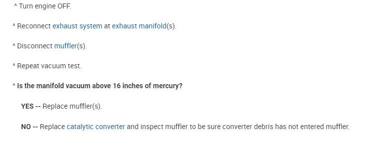

If they eliminated the PCV, that will damage the motor.
I would check the actual fuel pressure to be sure it is in spec.
Also, I am concerned the cat converter may be an issue as well. If it is partially clogged, it will cause surging.
Feb 13, 2020 at 12:40 AM
AKANYR
  • 52 POSTS
I read a few days ago how not having a PCV or a bad one will damage and shorten the life engine. Since then I've been searching for it hard. That's why I bought one that will fit in the area it needs to be and fit in the tube in my engine. If I find for sure there is no PCV I'm going to see if I can find a stock air filter housing and duct work in a junk yard.
