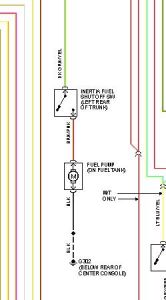

Hello my 1995 mustang gt is having some electrical issues that I cannot figure out. The car will start if it has been sitting for awhile but will have a really high idle when it warms up. But after a little while of driving it I will turn the car off and it will not fire back up, it will try to start just never fire up. Car has plenty of battery power but will just not fire like not getting spark. After trying and trying the smell of gas is present so I know its getting fuel. I am getting really weak spark with tester from the igniton coil. Please help.

Start by checking, cleaning or replacing the CKP (crankshaft position sensor) located behind the crankshaft pullley also test the Ignition Control Module (ICM)On right inner fender panel, forward of strut tower.

I have replaced the ignition control module and the ignition coil. The car will start with the gas pedal all the way to the floor then instantly die. The car will start with the inertia switch unplugged then while itrs running I plug it back in then th car instantly shuts off.

The fuel pump should not run at all with inertia switch unplugged as this supply's the pumps hot feed ? .. the pump must be getting a power supply from somewhere else ? there must be a short to power in the pump wiring somewhere .. when you connect the hot feed from the inertia switch it overloads the pump ?
