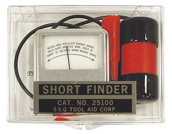

STEVE W.
  • 13,576 POSTS
Or see if you can hunt up a short finder. Basically a 12 volt circuit breaker and the meter. The breaker will snap open and reset creating a field in the wire and it will cause the meter to move until you reach the shorted area. Tool Aid 25100 Can be used on 6 volt systems as well. I've got extra breakers for mine so I can use it with lower amp circuits easier.
