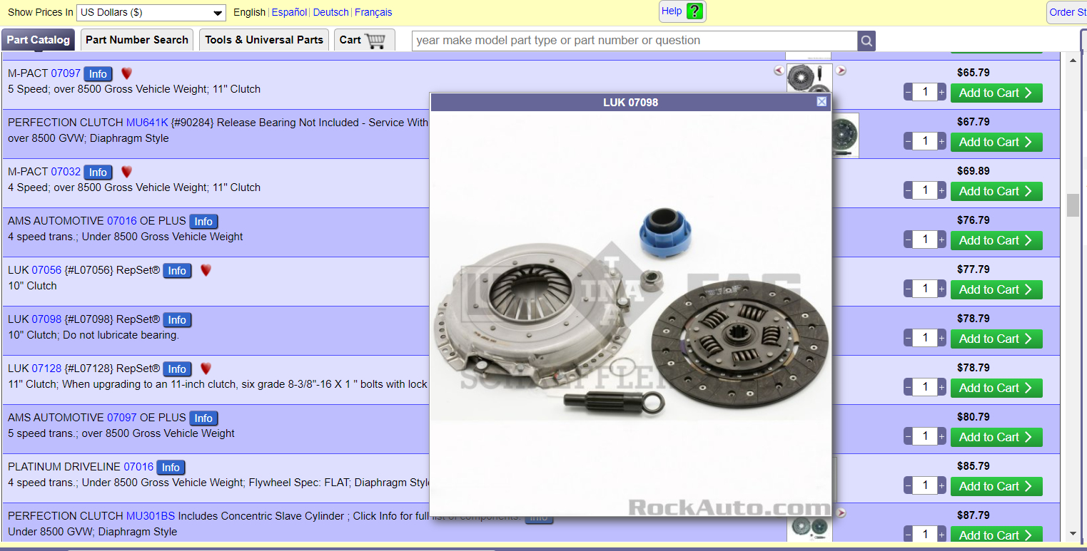

I think the noise is coming from the fan clutch and it sounds like the fan blade is hitting the radiator or the fan shroud or something is stuck in the shroud, but it isn't. What has me stumped is when I push the clutch in, the noise stops. The noise is random at times and other times, it won't stop. Sometimes, it sounds like a bearing that moves really fast then slows down, but when it is making a racket, I press the clutch in and it stops until it let it out. Could it be that the fan clutch bearing is bad even though the clutch is a year old?

From your description, it sounds like the throw-out bearing in the clutch has failed. You stop the noise when pressed on the clutch but when you let it out, it makes noise.
https://www.2carpros.com/articles/how-to-replace-a-clutch
The clutch will have to be replaced.

That's what I thought at first too. I thought it was either the throw out bearing or the clutch diaphragm fingers was bent. I raised the hood this morning and it's really loud as if it's coming from the front of the engine.
Mar 24, 2021 at 5:49 AM
Yep, noises travel all over the powertrain form the metal involved.
The fact it goes away with the clutch pedal is the clue that points right at the throw out bearing.
