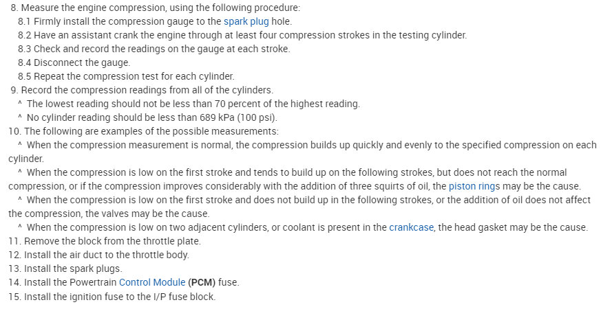

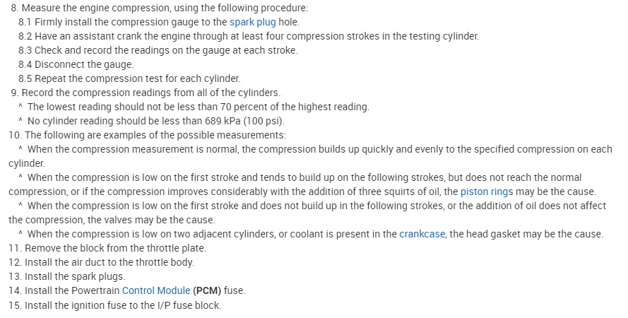

If we have spark and fuel, the timing is correct, there is one thing left, compression. I realize the engine was rebuilt, but the issue started after the work. Have you checked compression in the affected cylinders? If not, that is what I would check next.

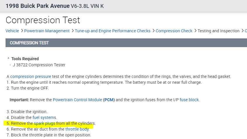

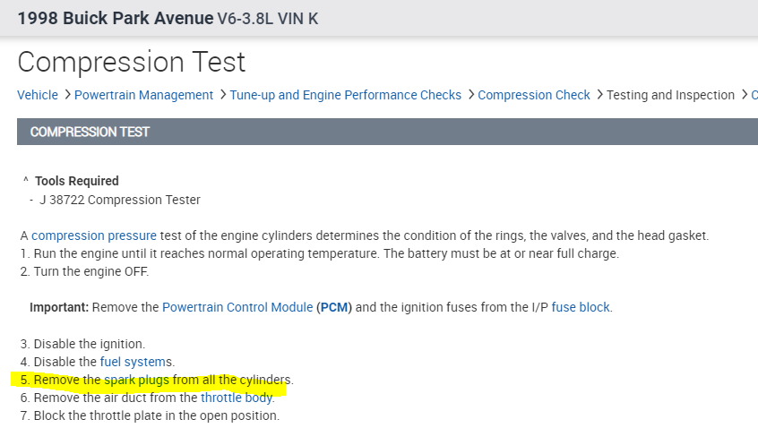

I will need to do this with spark plugs in correct? Except for the cylinder I am testing.

All spark plugs should be removed when testing.
If you look at the pics below, they are the directions specific to your vehicle right from the repair manual. Take a look through them and let me know if you have questions.

Everything says normal operating temperature. How can I do this if it won’t run? Also when I pulled off the rubber boot between the air filter and the throttle body it had antifreeze in it. I am so confused. Engines used to be easy to rebuild!
