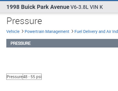

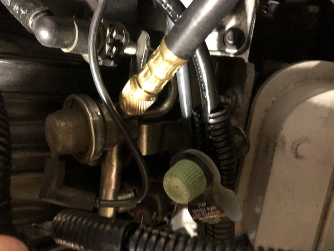

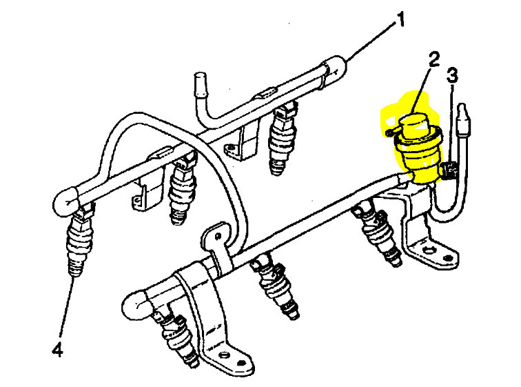

Have you checked to make sure the fuel pressure regulator is working properly? Also, if you disconnect the vacuum hose to it, is there fuel in the hose, and does the hose have a vacuum when cranking the engine? (See pic 1 below)
The regulator is at the end of the fuel rail. Check the aforementioned things first. Also, make sure the fuel return isn't clogged.
See pic below.

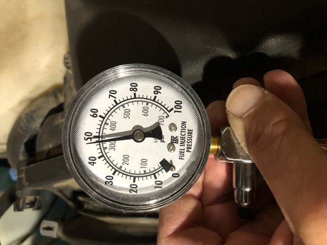

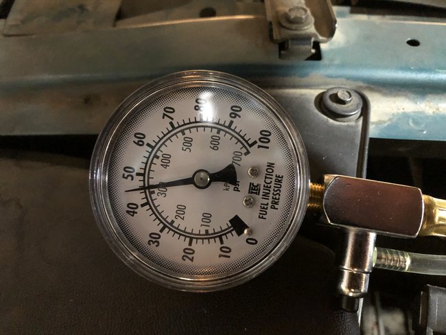

No fuel in vacuum line appears to have suction. Started and ran longer but was sputtering and smoke coming out of exhaust. Fuel pressure was 45 PSI.

Is the exhaust smoke black or dark gray? Also, believe it or not, the fuel pressure is low (see pic below), which leads me to one thing. A sticking injector or injectors.
When you checked fuel pressure and the key was turned off, did the pressure drop quickly? If we have an injector stuck or leaking, that will cause lower pressure and flooding.
Let me know. Also, let me know if you have a live data scan tool. If you do, tell me what the short-term fuel trims are.

The smoke was dark grey fuel pressure at 45 when key was on and actually went up to 48 when key was turned off. See pictures below. The last picture is where the gauge was connected. The pressure didn’t seem to drop when the key was turned off. Could it be the gauge I bought?

The dark gray smoke does usually indicate a rich fuel mixture. Also, the fuel gauge is likely correct. How long did you wait to see if the pressure would drop after turning the key off?

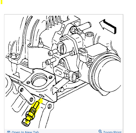

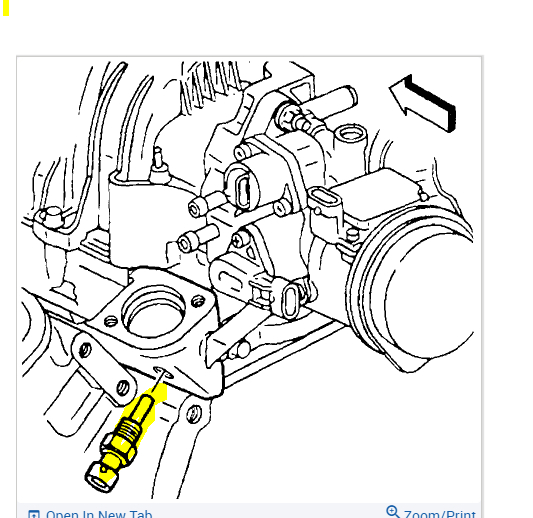

The issue could even be the engine coolant temperature sensor. Check to make sure the wire to the sensor isn't pinched or damaged and shorting. If the ECM thinks it is neg 40 degrees F, it will dump fuel to make it run. Keep in mind, the vehicle has two coolant temperature sensors. The one of interest can be seen in the attached pic and is used by the ECM.

Have been unable to get alive scan tool. The pressure dropped about 8 lbs over an hour. The problem did start after the engine was rebuilt. The temperature sensor is cracked a little. Guess I should replace it.

No problem. The coolant temperature sensor should be replaced. The engine coolant temperature affects most systems the PCM controls which includes fuel injection.

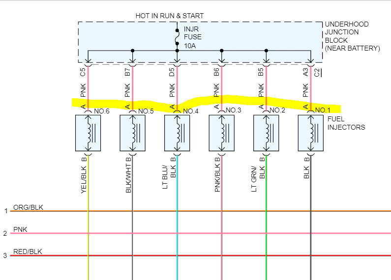

Do me a favor. Each fuel injector will have a solid pink wire to it. Confirm there is 12v to each pink wire. There is a second wire as well that will be different colors by the cylinder. See pic below. That wire provides a ground path to the PCM to complete the circuit, time the injection, and adjust the air/fuel mixture based on conditions.
If the pink wires all have power, check the other wire on the cylinders having wet plugs and see if it has a constant ground. If it does, that is the problem.

There are 11.97 volts to each injector. Not sure what you mean by constant ground? Between the pink and ground wires there is 6.06 volts on all of them.

When I meter the ground wire to the frame or negative side of battery it reads open.

With the key off, if you place the voltmeter between the two wires from the connector, you have 6V? You shouldn't have anything because the low reference from the computer shouldn't be supplying power.
Let me know. Also, I was wondering if there was a constant ground that would allow the injector to continuously inject fuel.
Let me know. Also, check the wire (other than the pink) for continuity to ground. You should have an open circuit until the ECM provides the ground path.

With key off no voltage between wires. No continuity with ground except for the pink wires.

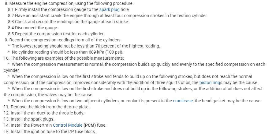

If we have spark and fuel, the timing is correct, there is one thing left, compression. I realize the engine was rebuilt, but the issue started after the work. Have you checked compression in the affected cylinders? If not, that is what I would check next.

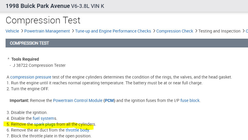

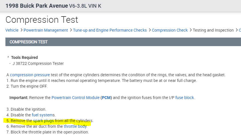

I will need to do this with spark plugs in correct? Except for the cylinder I am testing.
Oct 20, 2022 at 7:46 AM
  • 110,240 POSTS

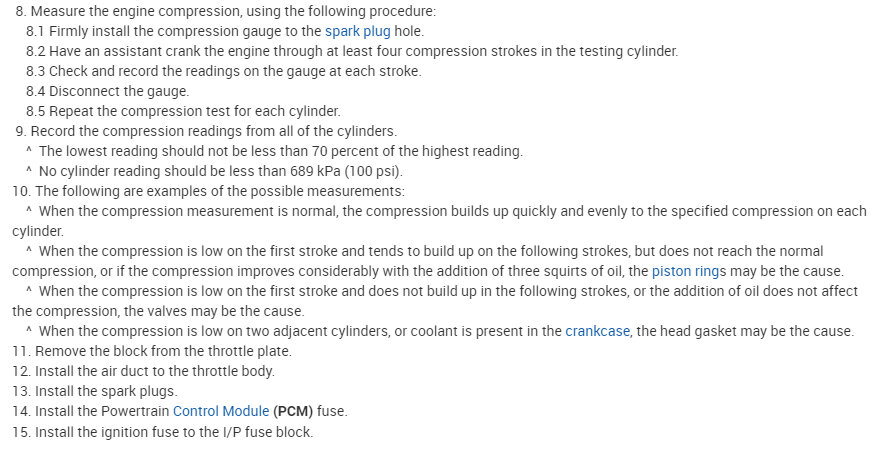

All spark plugs should be removed when testing.
If you look at the pics below, they are the directions specific to your vehicle right from the repair manual. Take a look through them and let me know if you have questions.

Everything says normal operating temperature. How can I do this if it won’t run? Also when I pulled off the rubber boot between the air filter and the throttle body it had antifreeze in it. I am so confused. Engines used to be easy to rebuild!
