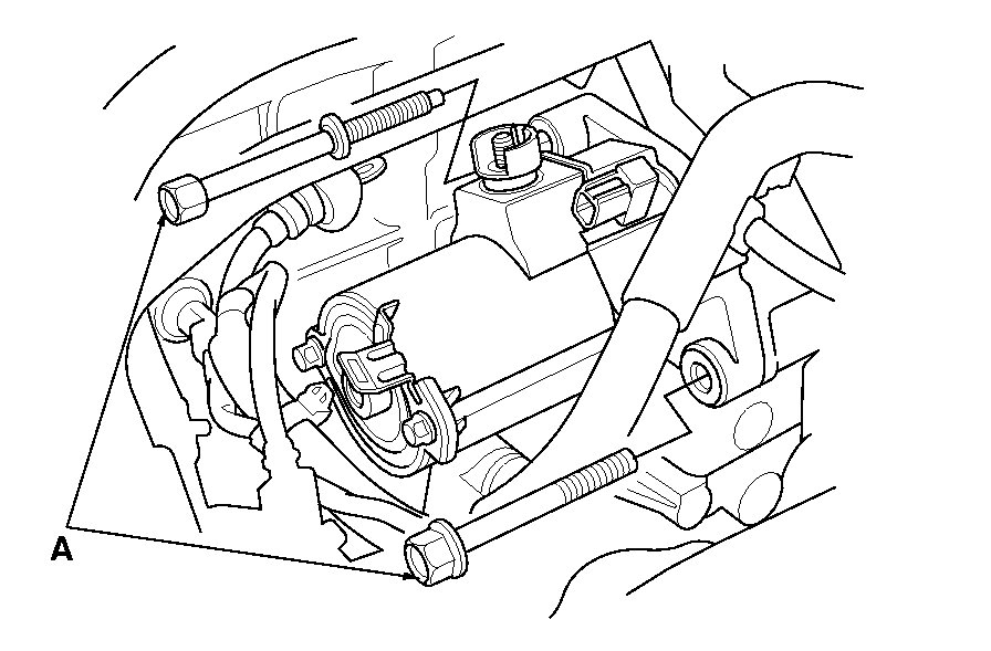

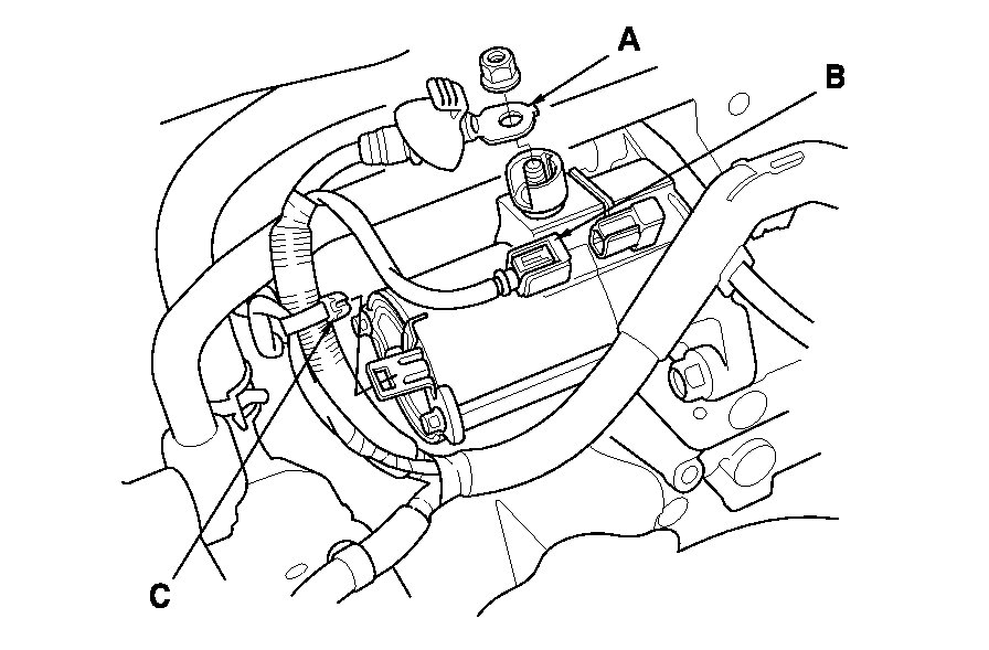

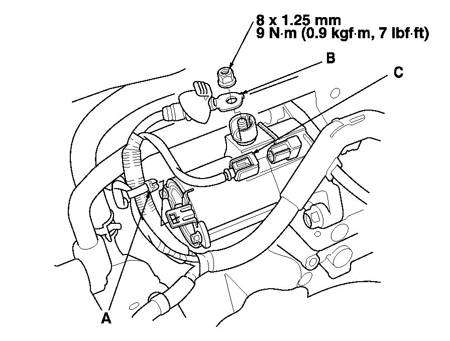

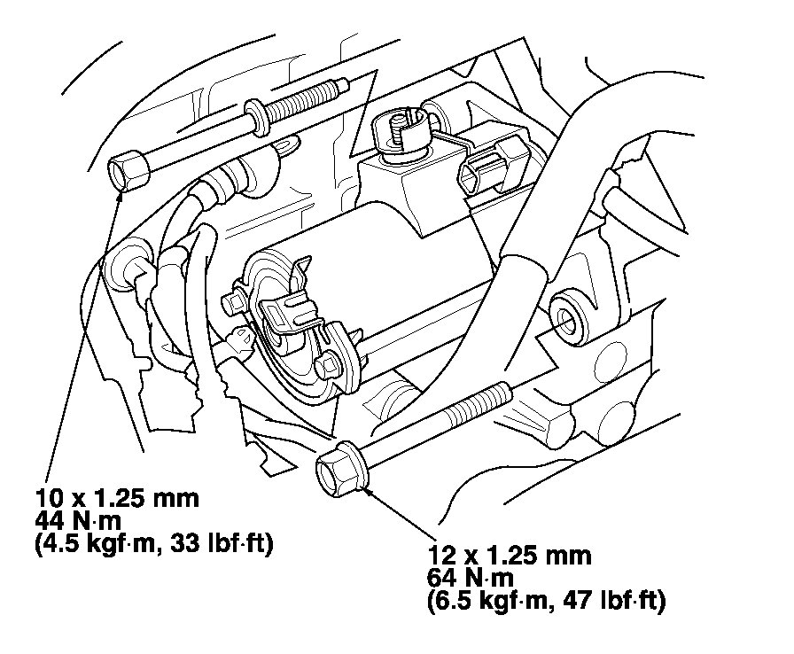

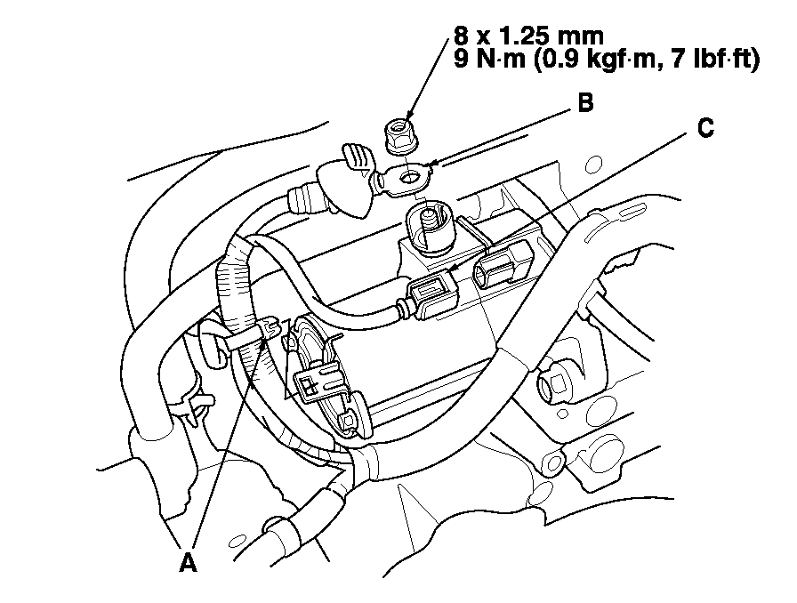

Here are the directions specific to your vehicle. The attached pictures correlate with the directions.
2009 Honda Accord L4-2.4L
Removal and Replacement
Vehicle Starting and Charging Starting System Starter Motor Service and Repair Removal and Replacement
REMOVAL AND REPLACEMENT
Starter Removal and Installation
Removal
1. Do the battery removal procedure. See: Battery > Removal and Replacement
2. Remove the intake manifold.
3. Disconnect the positive starter cable (A) and the S terminal connector (B).
4. Remove the harness clamp (C).
pic 1
5. Remove the two bolts (A) securing the starter, then remove the starter.
pic 2
Installation
1. Install the starter, then tighten the two bolts.
pic 3
2. Install the harness clamp (A).
pic 4
3. Connect the positive starter cable (B) and the S terminal connector (C). Make sure the crimped side of the ring terminal faces away from the starter when you connect it.
