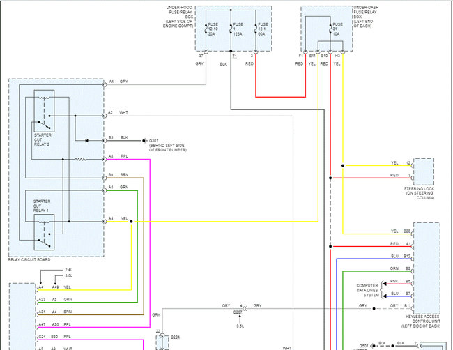

When starting sometimes won't start just click. Sometimes after 3-4 tries it starts. Replaced starter and battery sensor. Worked for a couple of months now have the same problem. Battery good alternator good. Had original starter tested and it passed. Don't know what's wrong with it.
Apr 24, 2020 at 1:09 PM
  • 110,241 POSTS
Since both the new and original starter do the same thing, it sounds like it is a connection issue.
Do me a favor. Check and make sure the battery terminals are clean and tight. Also, follow the ground wire from the battery to the engine block and make sure it is tight, free of corrosion, and undamaged.
Since you are getting a clicking from the starter, that tells me the circuit itself is good but there is a loss of power at some point. Usually (and don't laugh) it is at the battery itself.
Check those few things and let me know what you find.

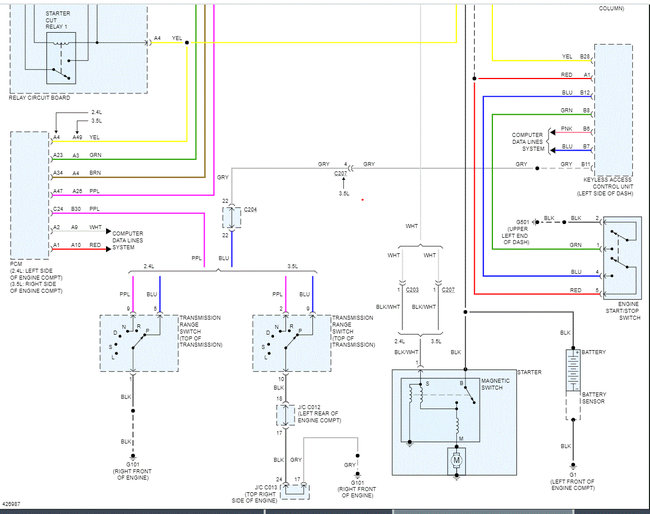

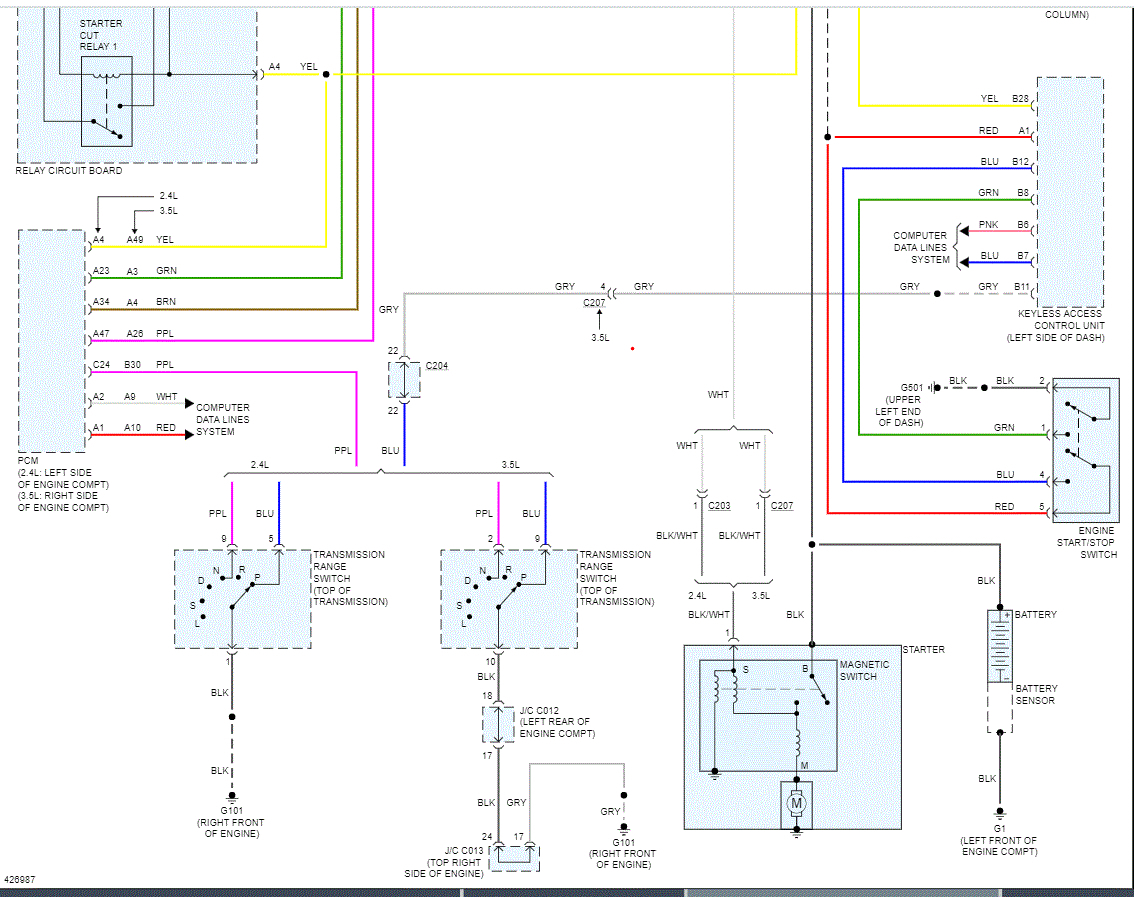

There is no ground wire on the starter. You should have two wires. Once (larger in diameter) runs from the battery direct to the starter and should have 12v all the time. The other is smaller in diameter and should only have 12v when the key is in the start position. As far as ground, it is done by the engine block when the starter is bolted on.
I attached two pics below for you to see the wiring to the starter system. I overlapped them so you could follow easier.
Do me a favor. If you follow the negative battery terminal from the battery, it will go to the engine block. Unbolt it from the engine block, clean and inspect it. Make sure where it mounts on the engine is also clean.
Let me know if that helps.

  • 110,241 POSTS
I looked through schematics and I see no ground to the engine block which is very odd. If you follow the wire from the negative of the battery, does it only lead to the body?
If that is the case, for certain the starter is grounded via the engine block. So make sure the starter itself hasn't come slightly loose from the engine. If loose, it can cause a problem.
If it is tight, then we need to check the starter cut relay 2 in the relay panel.

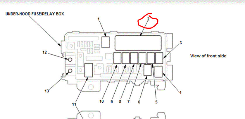

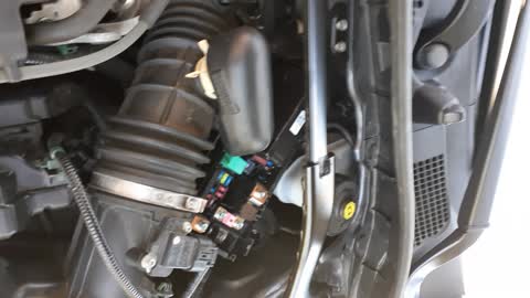

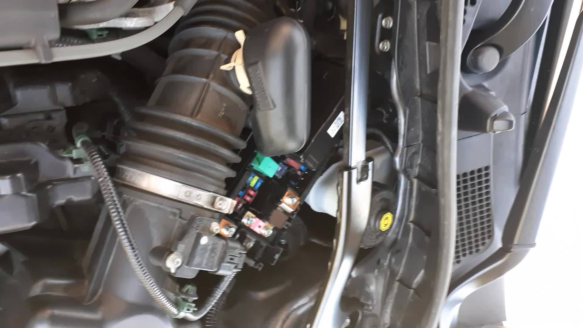

Okay, If everything is tight, then it must have to do with the starter cut relays. They relay circuit board is under the hood in the fuse/relay box. It may not even be serviceable. First, locate it and let me know if it one that can be removed.
See pic 1 for location.
Apr 28, 2020 at 1:38 PM
STATONE52
  • 8 POSTS
Found the relay. It doesn't look like it's serviceable but it looks like it can be replaced. I haven't been able to see how to remove it. Was able to pull it about 9/10 of the way out. Does it plug in?

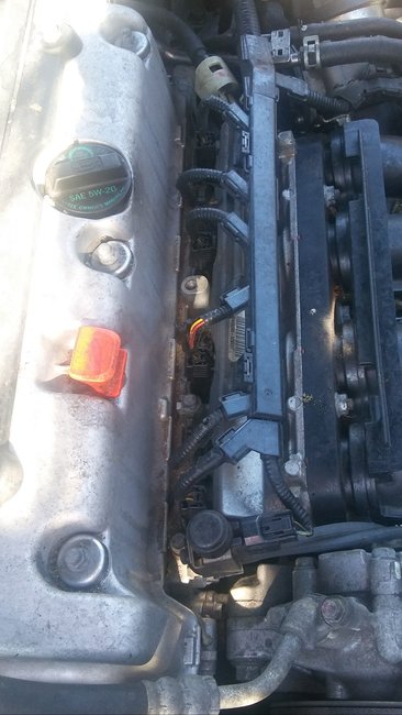

I started my car this morning and backed up a few feet. Noticed it was a bit reluctant to turn over, but it did. Thirty minutes later, it will not start. The starter clicks, and the battery should be working (car serviced and battery tested just two weeks ago). Then I noticed droppings around the battery (which is not corroded, and seems well attached with connections tight) and then found a chewed wire (pictured). It thankfully seems to be the only one. It is red in color, and it is mostly severed, though I did try squishing it together and starting again (did not work). Could it be just this?
Sep 30, 2020 at 5:13 AM (Merged)
KHLOW2008
  • 41,814 POSTS
Hi Carlacar,
The wire pictured in your post is for one of the injector and would most probably not cause the non starting.
You mentioned the engine reluctant to turn over and later the starter just clicks, that would mean a weak battery or its connection. Try a jump start to see if it works.

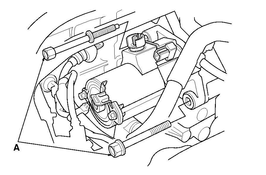

REMOVAL AND REPLACEMENT

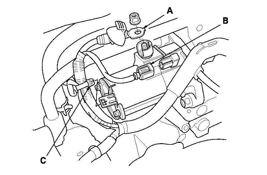

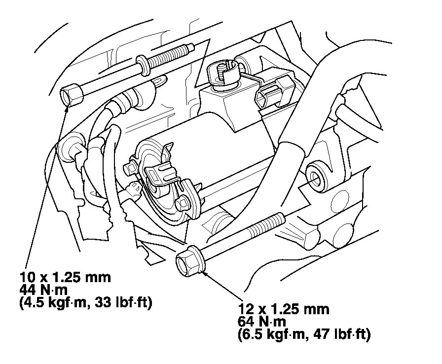

Starter Removal and Installation
Removal
1. Do the battery removal procedure. See: Battery > Removal and Replacement
2. Remove the intake manifold.

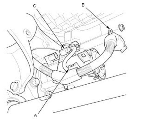

3. Disconnect the positive starter cable (A) and the S terminal connector (B).
4. Remove the harness clamp (C).
pic 1

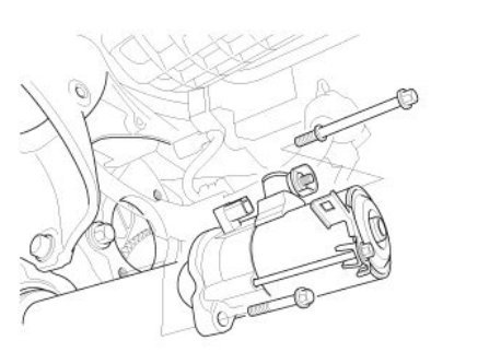

5. Remove the two bolts (A) securing the starter, then remove the starter.
pic 2

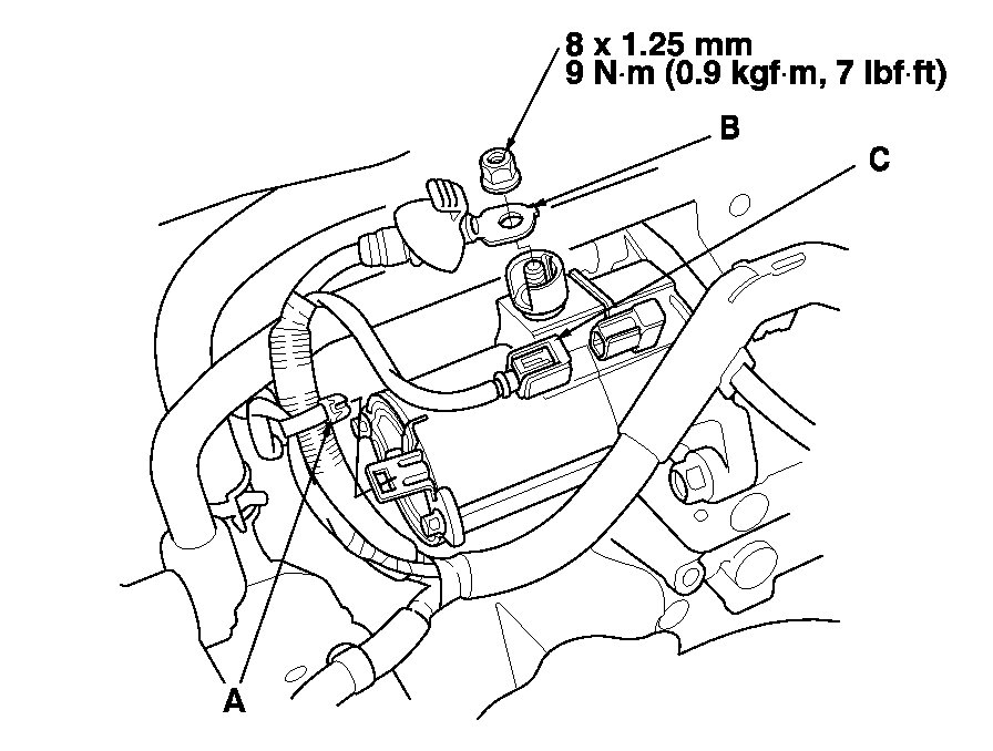

Installation
1. Install the starter, then tighten the two bolts.
pic 3
2. Install the harness clamp (A).
pic 4
3. Connect the positive starter cable (B) and the S terminal connector (C). Make sure the crimped side of the ring terminal faces away from the starter when you connect it.
4. Install the intake manifold.
5. Do the battery installation procedure. See: Battery > Removal and Replacement
6. Start the engine to make sure the starter works properly.
