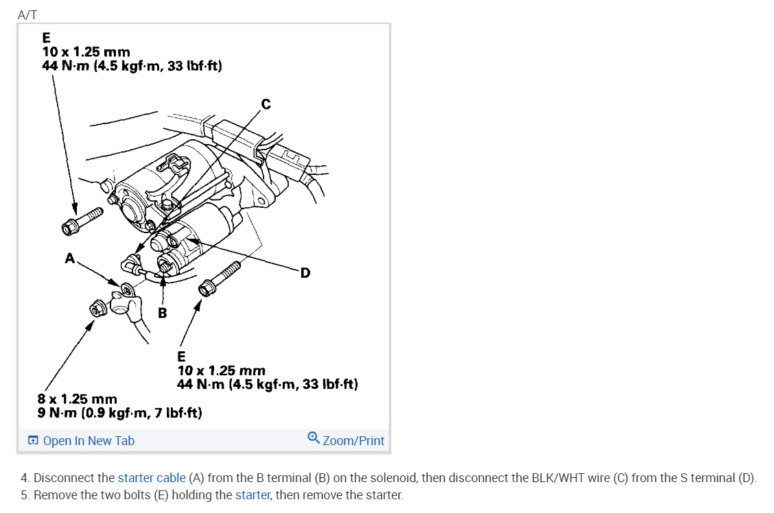

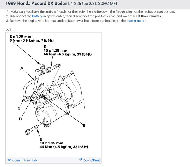

Where is the starter motor located?
Saturday, November 24th, 2007 AT 12:11 PM
17 Replies
  • 75,992 POSTS
The starter is near the transmission here is a guide to help you walk through the steps with instructions in the diagrams below to help you with your car.

1998 honda accord where is the starter located
Saturday, April 25th, 2020 AT 2:32 PM (Merged)
KHLOW2008
  • 41,814 POSTS
On top of the transmission, below the distributor. If you follow the battery positive cable you would come to it.

I NEED T REPLACE THE STARTER ON MY HONDA ACCORD. DO YOU HAVE ANY DIAGRAMS THAT SHOW WHERE THE STARTER IS LOCATED AND HOW TO REPLACE IT?
BLUELIGHTNIN6
  • 16,542 POSTS
If you have trouble finding starter motor, just follow positive battery cable down engine compartment, it leads to the starter.
NOTE:
The factory sound system has a coded theft protection system. It is recommended that you know your reset code before you begin.
REMOVAL:
Disconnect the negative battery cable.
Remove the wiring harness from the starter motor.
Disconnect the lower radiator hose from the bracket on the starter motor.
Remove the starter cable from terminal B located on the back of the solenoid.
Remove the black/white wire from the S (solenoid) terminal.
Unfasten the two bolts that mount the starter to the transaxle assembly, then remove the starter from the vehicle.

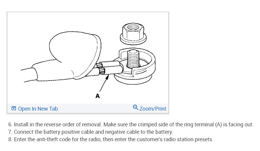

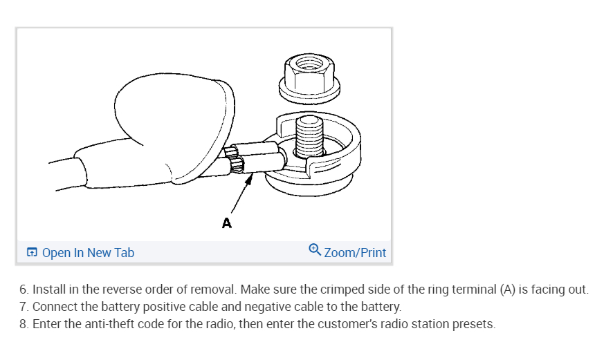

INSTALLATION:
Install the starter in the reverse order of removal. Tighten the starter mounting bolts to 33 ft. Lbs. (45 Nm) and the wire terminal nut to 7 ft. Lbs. (9 Nm).
When installing the heavy gauge starter cable, make sure the crimped side of the terminal end is facing out.
Enter the anti-theft code and radio presets.

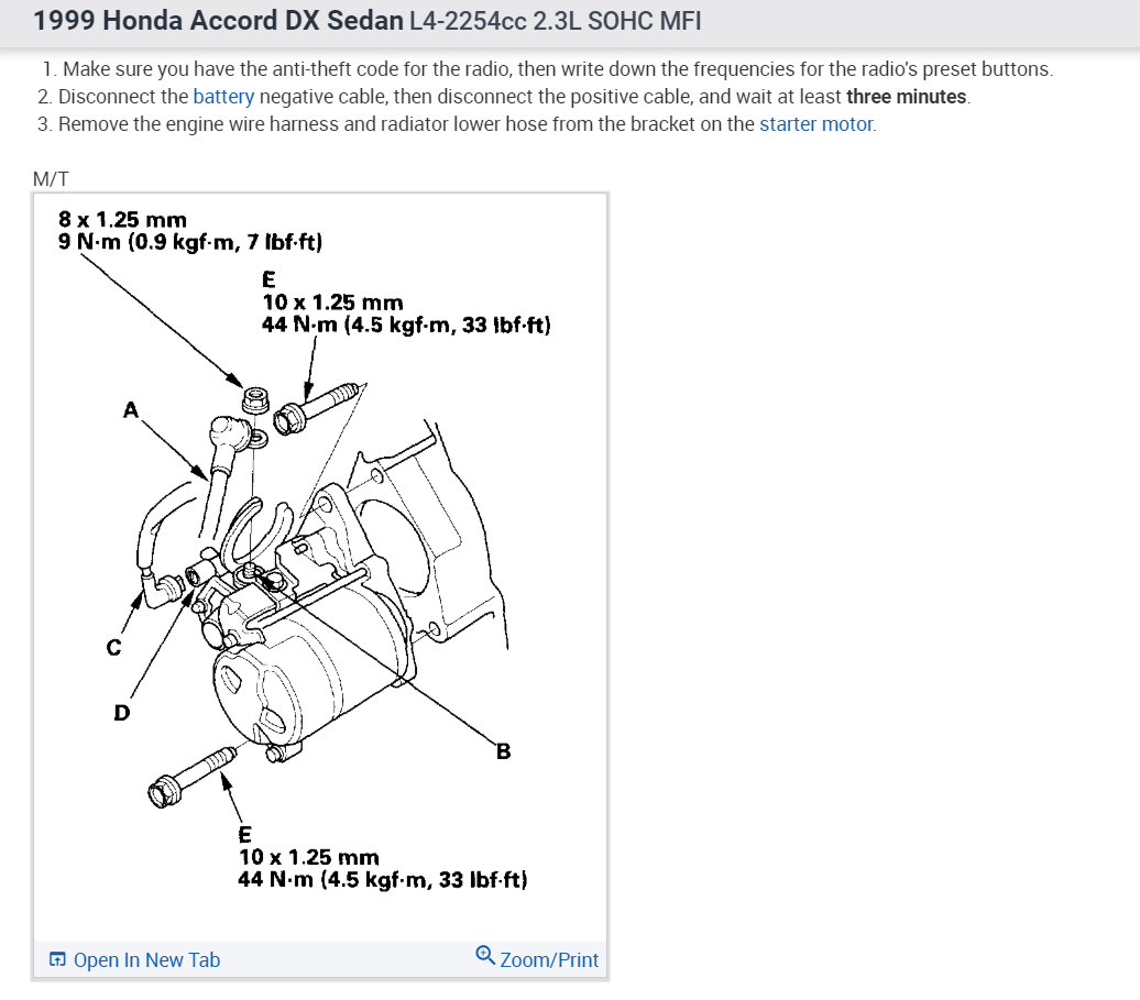

1995 Honda Accord LX 2.1 Stick shift. I just want to know if the starter to my car is up on top(easy to get to) or underneath?
CARLUCCIJA
  • 29 POSTS
Starters are on the side of the motor facing the transmission. Yours maybe closer to the firewall to your car if its front wheel drive and easier to get to from underneath the car
