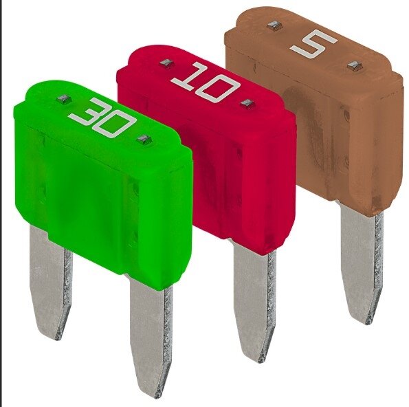

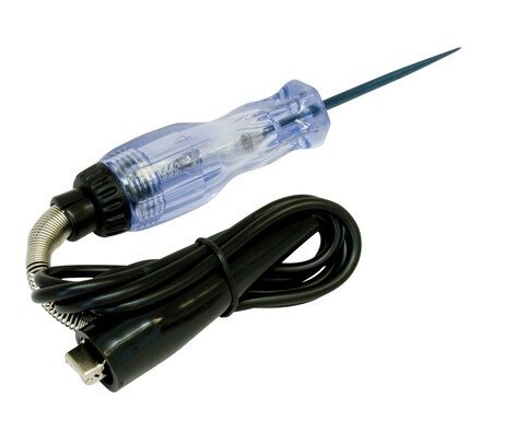

If you don't have a test light, you can get one from your local auto parts store. (I will add a picture of this for you)
