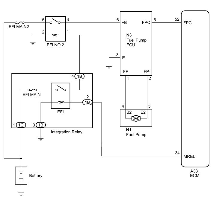

Thanks for the reply, I have gone through the list checked everything on my car from the list so what I found on my car is that my pump is pumping diesel to my injector rail but the rail does not transport the diesel to my injectors, I loosened the injector rail pipes and cranked the car for about two minutes but there is no diesel coming so I went to my pump and disconnected my outlet pipe from the pump then cranked the car again then I could see that the diesel does get to the pump and also the pump does pump the diesel up but cannot figure out why I cannot get the diesel from rail up.

Yes, the fuel filter was replaced and after working on it last night I managed to get the fuel running, but now I am not getting any signal to my pump and injectors.

Check the integration relay (under hood relay box) for power. If there is another relay with the same part number, switch them to see if changes. Confirm power to the fuel pump ECU unit. (pin 6 should have between 11v and 14v). Also, check EFI relay 2 under the hood/relay box.
Let me know what you find.
