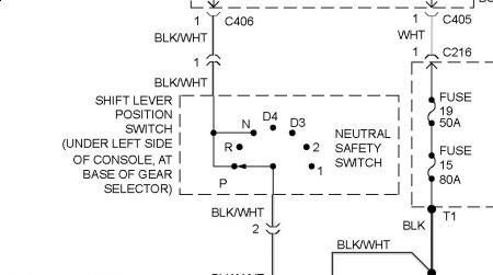

neutral safety switch?
2007 HONDA ACCORD
100,000 MILES • AUTOMATIC
BERTHA49

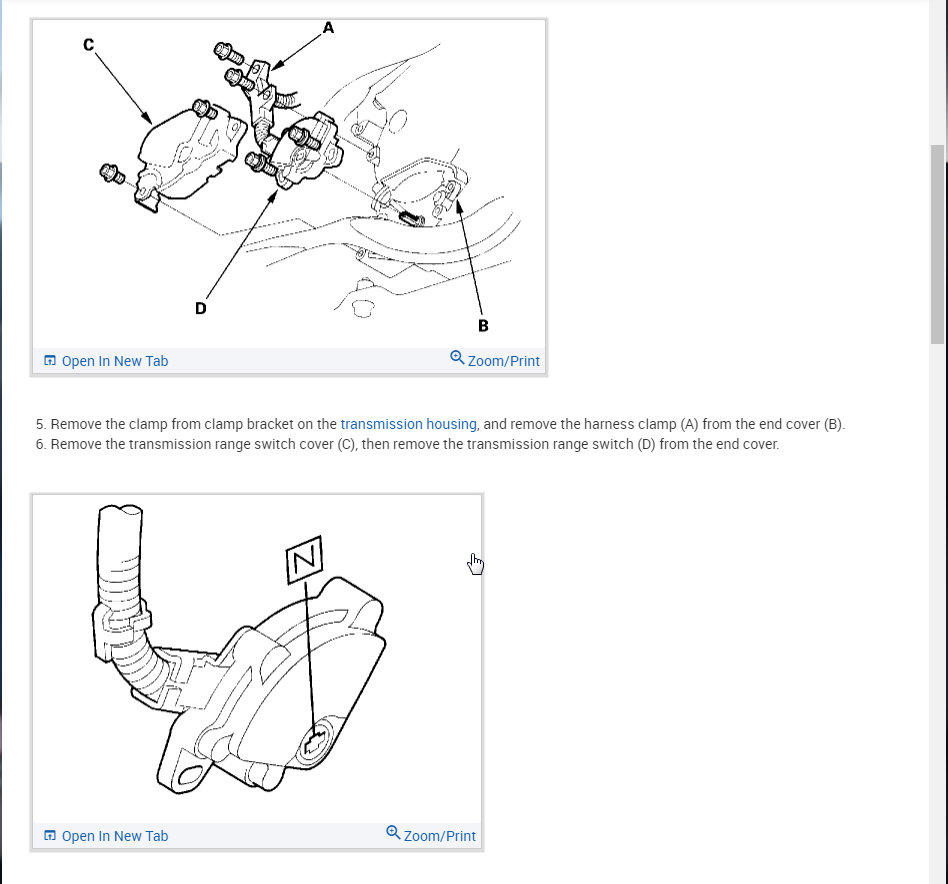

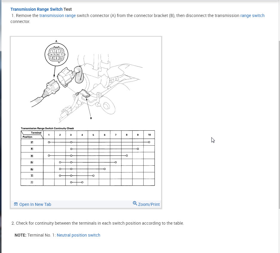

I had trouble starting my car and took it in to the shop. They told me I needed a new starter. A month later, I started having more issues , car would only start if I moved gears, hit brake or put it in neutral. I brought it back in and they said it was the neutral safety switch that needed to be replaced. I felt that they probably charged me for new starter when in fact it was the neutral safety switch in the first place. Do you agree? They adamantly disagreed and I was forced to pay for the neutral safety switch as well.
Apr 9, 2019 at 9:42 AM
SCGRANTURISMO
  • 4,897 POSTS

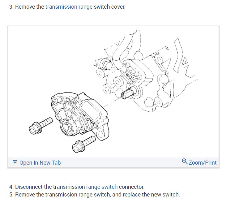

It happens. The problem is that without the original starter to test there is no way to know. This guide will help you check the starter with diagrams below to show you how to replace the neutral safety switch.
Check out the diagrams (Below). Please let us know what happens. The 4 and 6 cylinder cars are the same

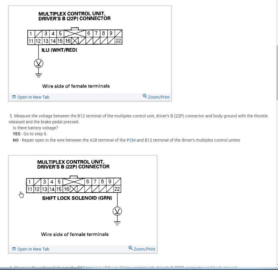

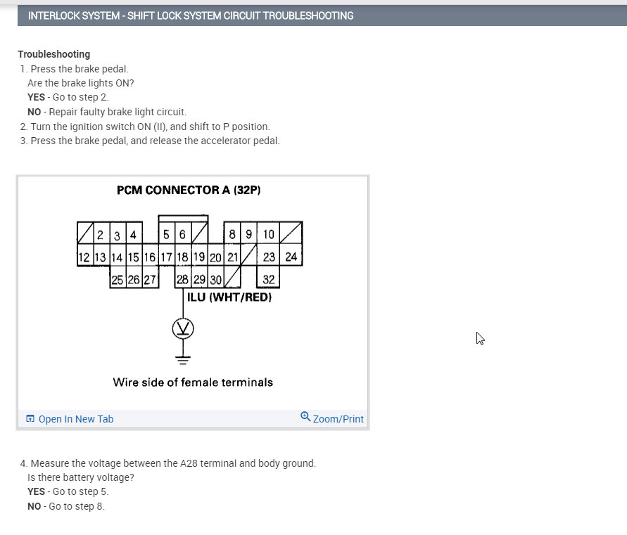

The gear is stuck in Park postion and you have to engage the button on the sifter numerous times in order for it to move to reverse or drive.
Sep 24, 2020 at 11:08 AM (Merged)
KHLOW2008
  • 41,814 POSTS
Hi beav44,

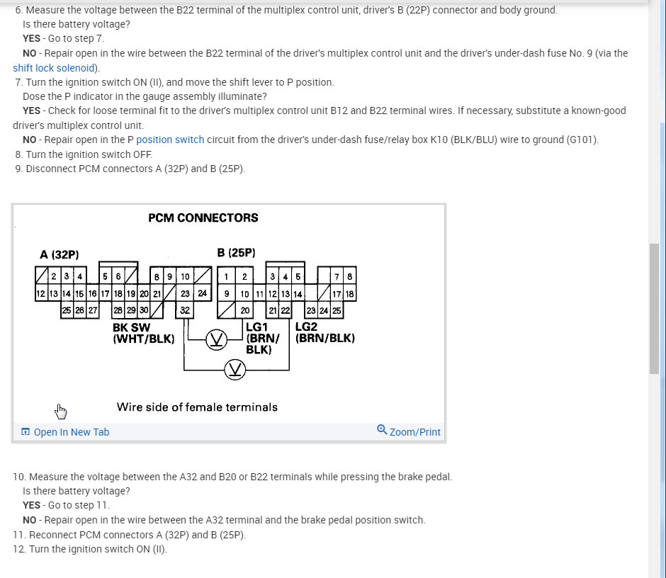

Seems the interlock system is causing the problem.
With ignition switch turned ON and depress the brake pedal. Listen for a clicking noise at gear shift. If the interlock solenoid is clicking and you are not able to move out of Park, you would have to check the solenoid.
If no clicking noise is heard, check if the brake lights are working. A faulty brake switch would not operate the solenoid.

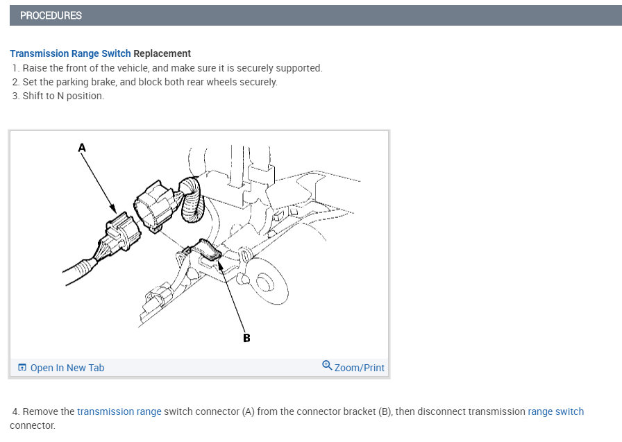

More than likely this is not the range sensor but the shift interlock. The range sensor just tells the PCM which gear the transmission is in. If it is not in park or neutral it will not allow it to start.
If the shifter is not coming out of park or the shifter button (if equipped) is not depressing then this interlock is the issue.
I attached the info and testing if you would like to prove this out. However, if it were me, based on this info I would just go ahead and replace the shifter. You can also find quite a few videos online that show people fixing this switch. I have not had long term success with this so I would just replace it.
Let me know if you have questions. Thanks
Sep 24, 2020 at 11:16 AM (Merged)
ALBERTO ESPARZA
  • 9 POSTS

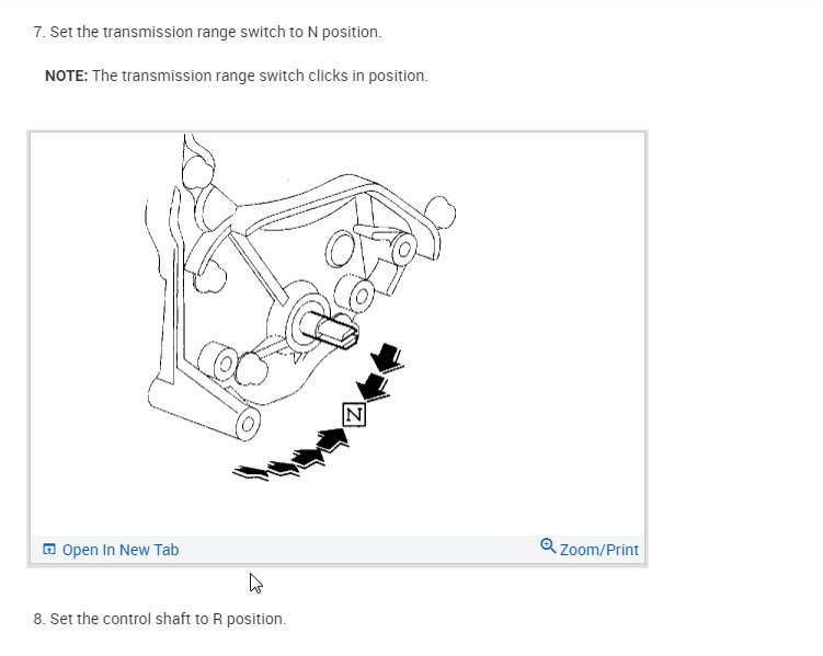

Okay, the shifter moves the gears are not entering it's in parking sometimes it gets revers or not it gets neutral the D jumps to D1 or D2.

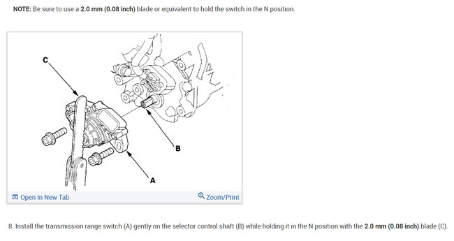

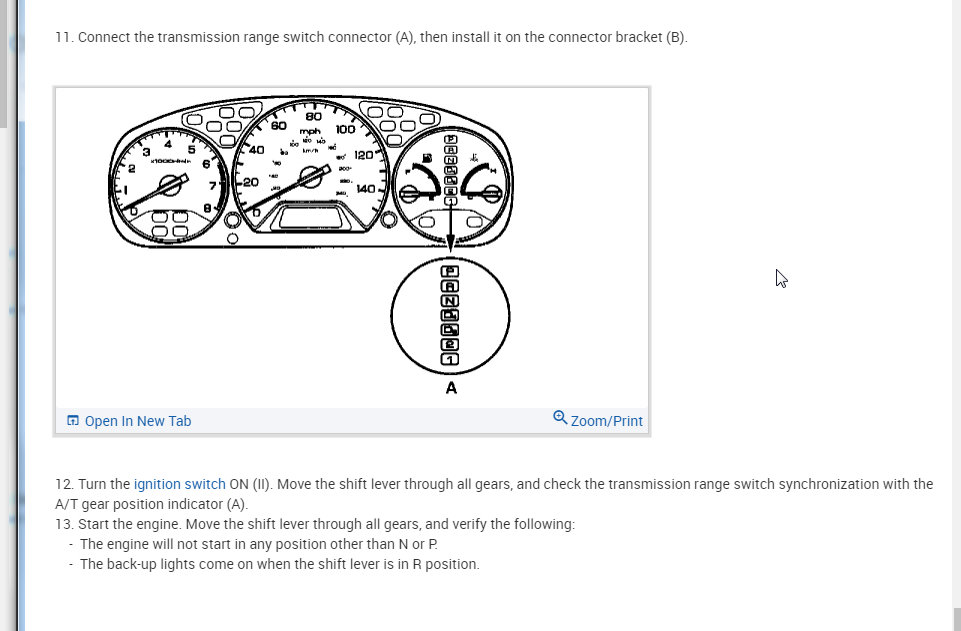

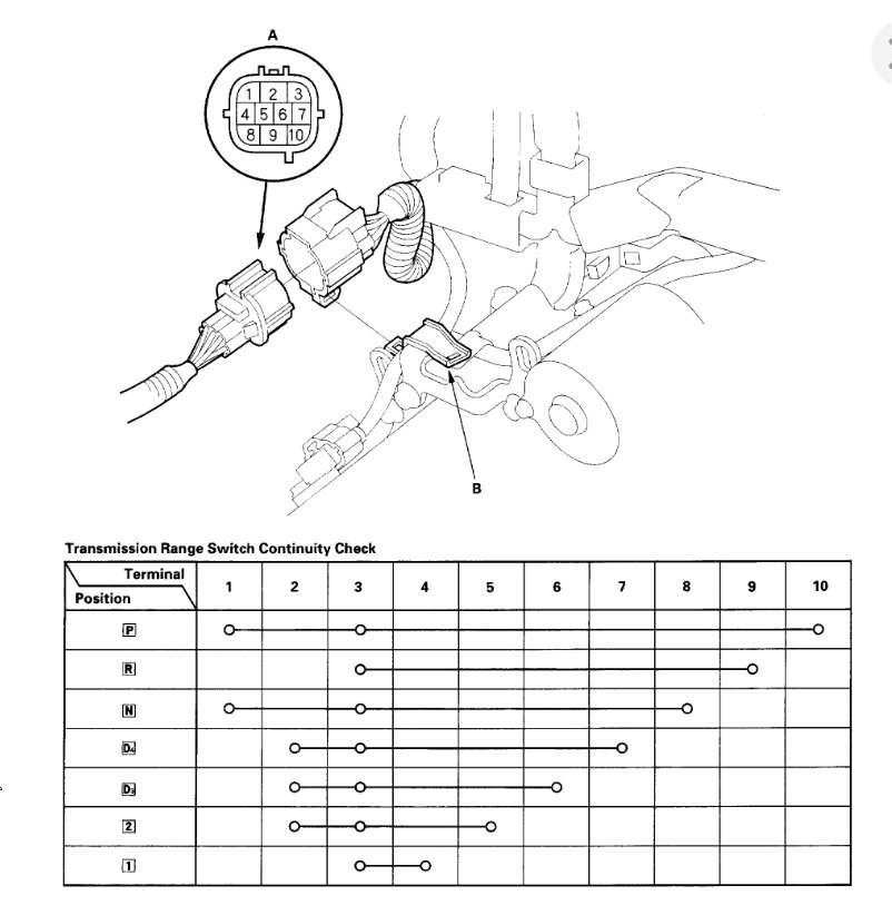

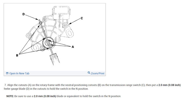

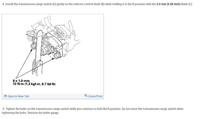

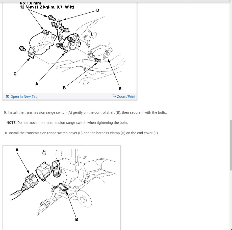

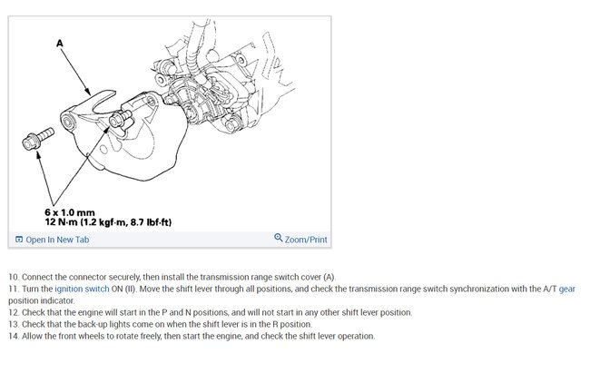

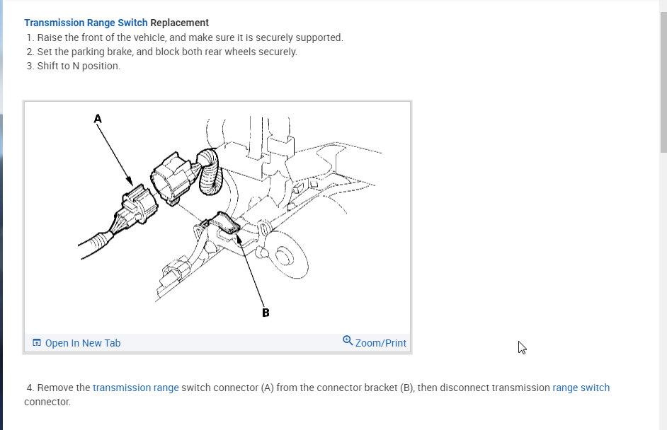

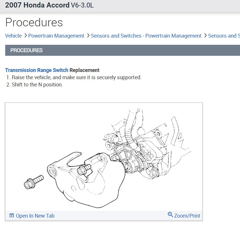

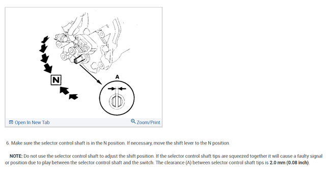

Okay. This could the range sensor if it is not adjusted properly or is failing. However, it normally causes a no start. Have you check the transmission fluid to make sure that is full and in good condition? That would be a more likely cause of this.
Here is a procedure to test the TRS and replace it. There is a process for making sure it is installed correctly.

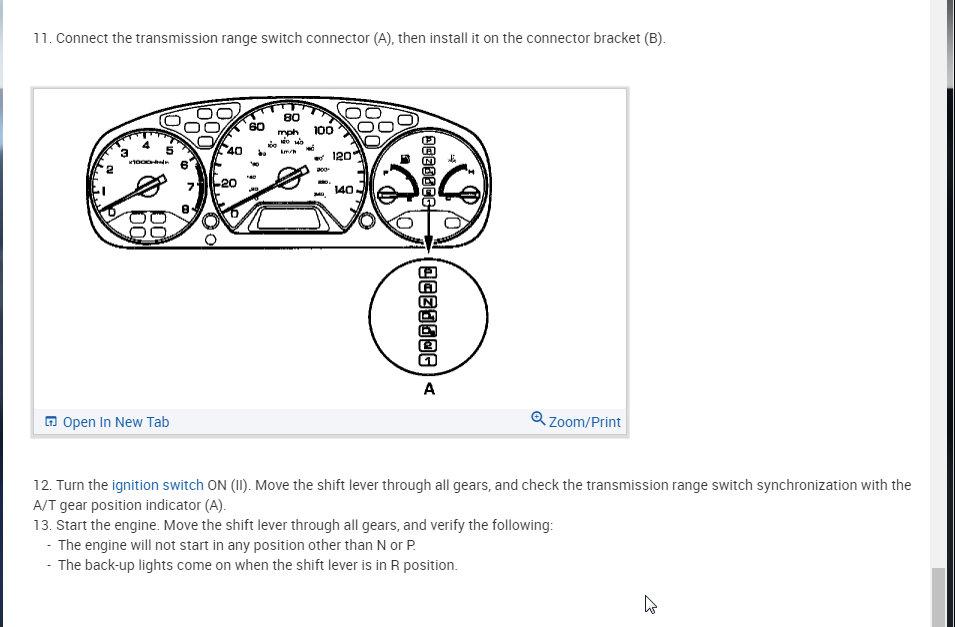

ALBERTO ESPARZA
  • 9 POSTS

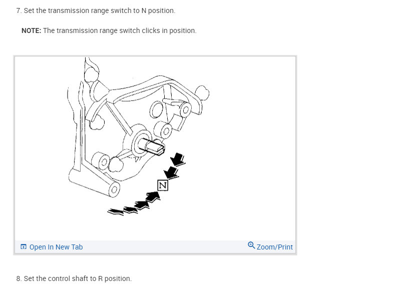

Okay, as soon as we connect the range sensor sensor we make sure the put the gear in parking and turn the key to make sure the parking light displays in the dash, but when I shift the gears they skip gears or some won't display in the dash.

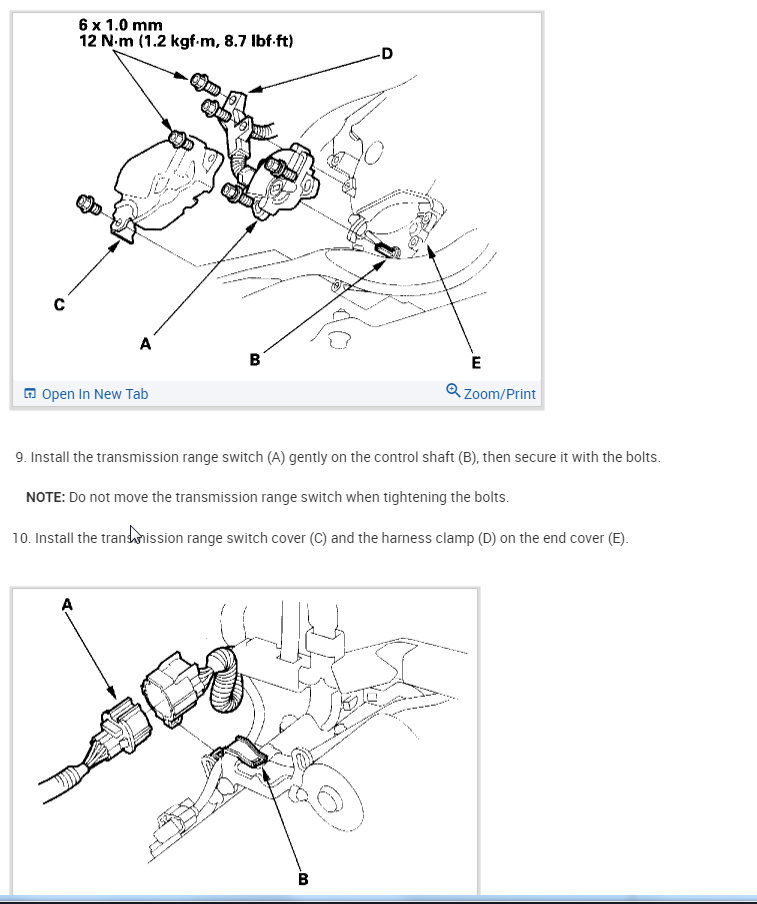

Sounds like it is out of alignment. I am attaching the process. Just run through it and make sure you had each position correct when installing it.

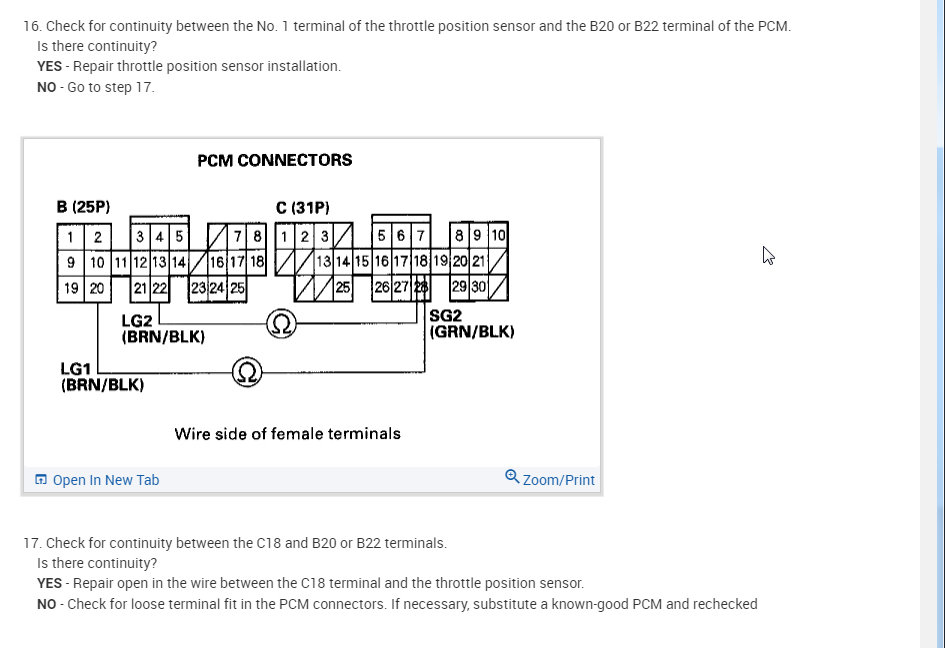

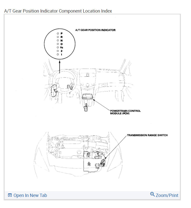

PETWAT1507
Engine light steadily stays on got it checked out and got the code p0705 and p0706. My tcs lights also come on. Are they related and could it be caused by the neutral safety switch ?
KHLOW2008
  • 41,814 POSTS
Yes, the PNP is the culprit and it can cause the TCS indicator to come on.
Check the PNP wire harness conector for contaminations and looseness.

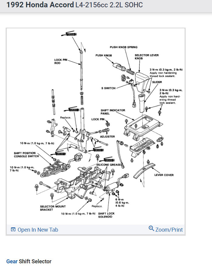

SNVASQUEZD
Transmission problem
1993 Honda Accord 4 cyl Automatic 200,00 miles
I have a 1993 automatic transmission accord, it has problems identifying in which gear it is driving, took it to the mechanic he said it gave him a code 5, but it's not giving any other information. The mechanic mention neutral switch or ground problems.
Sep 24, 2020 at 11:18 AM (Merged)
KHLOW2008
  • 41,814 POSTS
Hi snvasquezd,
DTC # 5 means
1. Short in Shift Position Console switch wire.
2. Faulty Shift Position Console switch.
The problem would result in gears shifting only between 2 and 4.
Does the meter indicator lights for the gear shift positions indicate the correctly?
You need to check the switch which is located under the gear shift console.
HOMY
where is the neutral safty swith on this car. on hot days some times it will start and sometimes not. but it always cranks. when it will not start i have to trick it by turing key to on position put foot on brake then slide shifter to reverse then hold key to starting position and slowly slide shifter towards park and in the middle it hits a sweet spot and starts. go figure? so what is the component causing this problem.
  • 75,992 POSTS
Check and test the shift position switch and the ignition switch-see below
https://images.2carpros.com/forum/automotive_pictures/12900_shift_switch_1.jpg

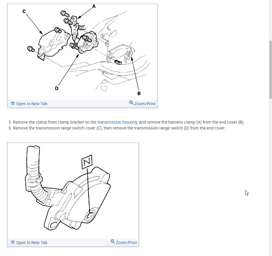

Hi johnathancook89,
You need to remove the centre console. It is attached to the side of the gear shift assy.
Make sure adjustment is correct by testing the positions before assembling of console.
