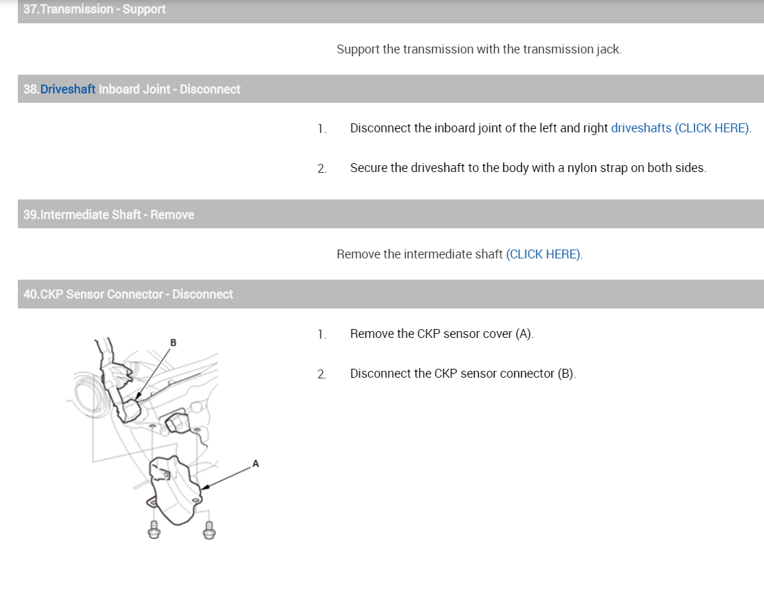

Received a Product update for the CVT transmission and completed the update. The DTC P 1890 did not set. But the transmission is behaving a little differently( may be a good thing). Is it possible that the transmission was slipping a little, causing some damage, but not enough to set the DTC P 1890?
Sep 23, 2016 at 6:42 AM
  • 55,402 POSTS
Yes that is possible, I would take it into the dealer so they can do the update to be safe. The CVT transmission had problem so you might need a rebuild depending on the problem they find. This video shows the job being done on a similar car with instructions below for your car.
https://youtu.be/6N6b5F2ChyE

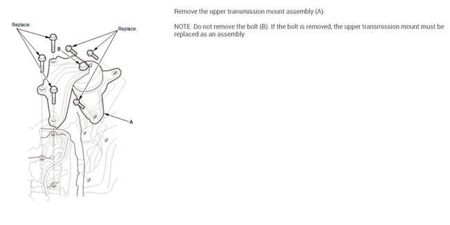

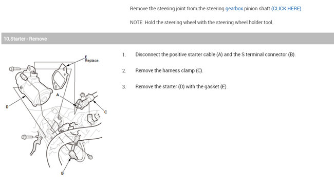

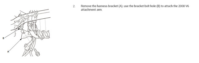

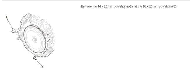

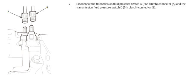

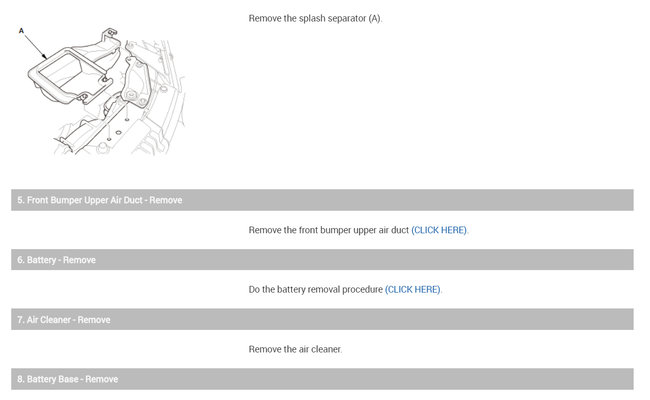

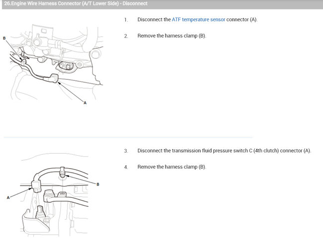

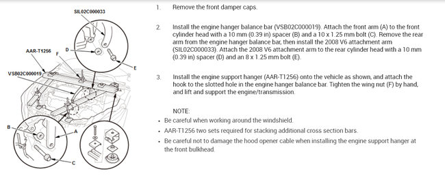

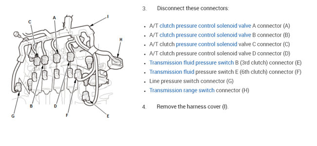

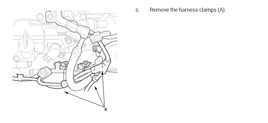

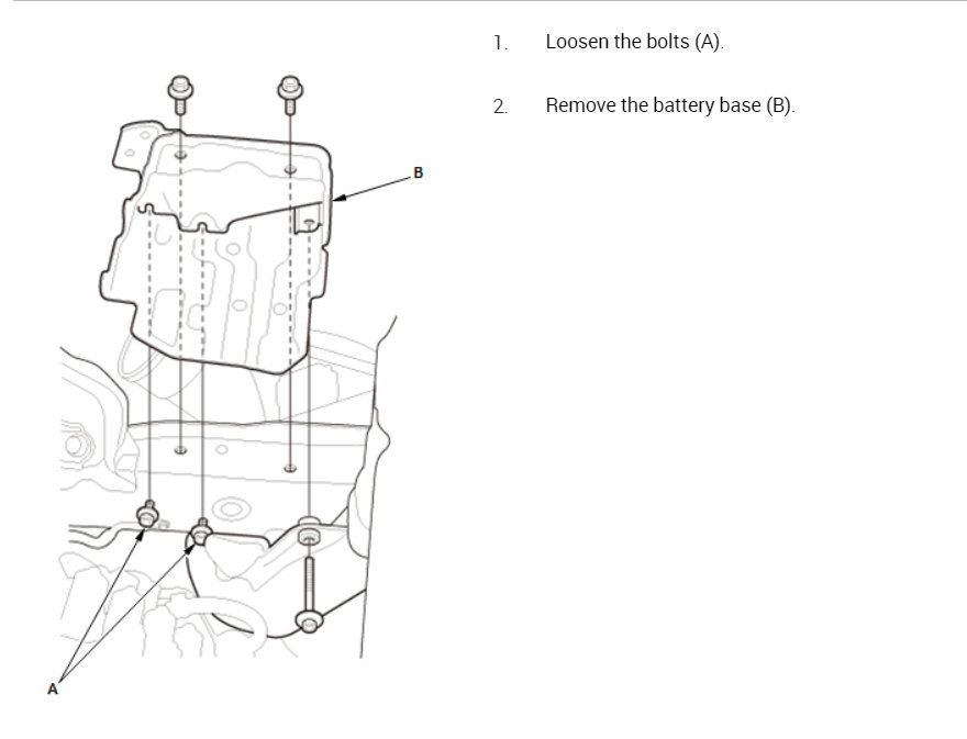

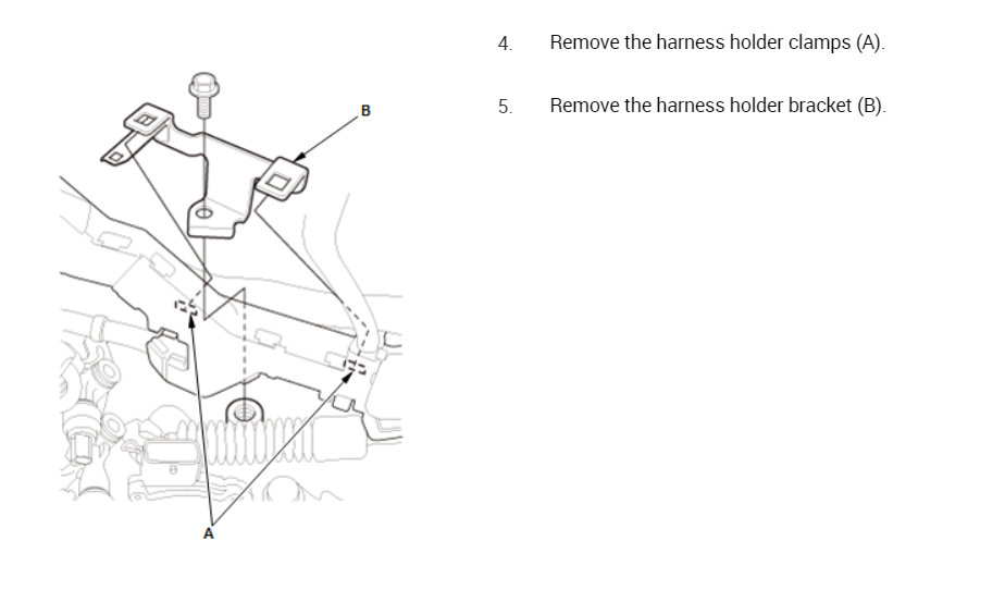

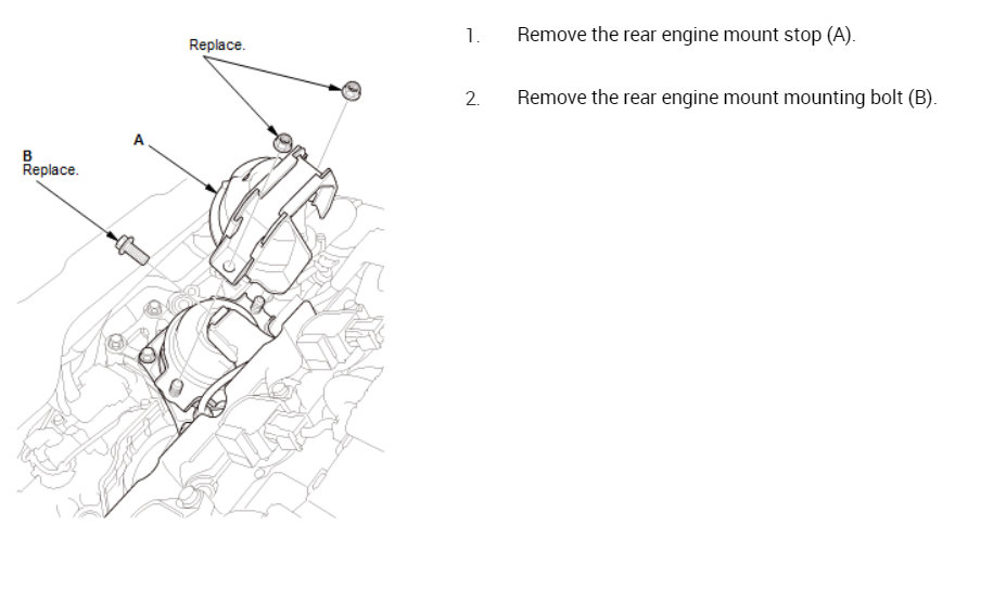

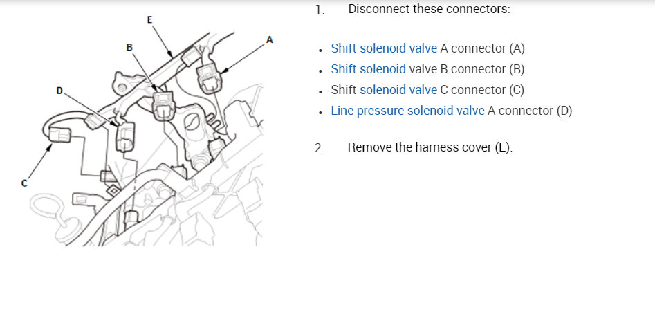

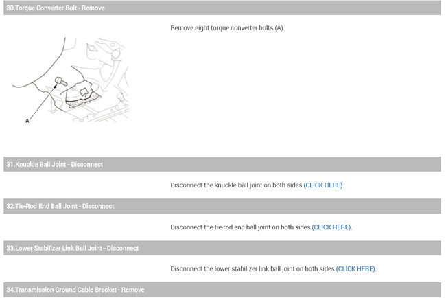

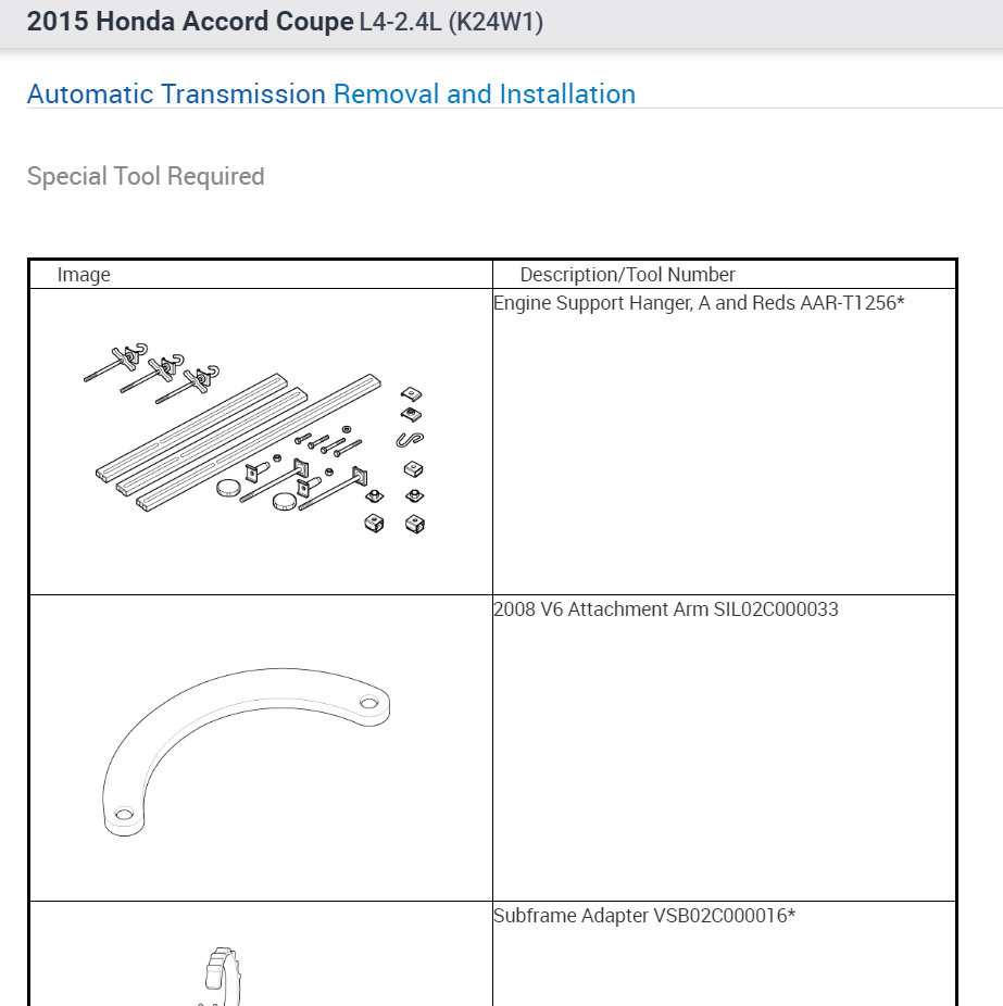

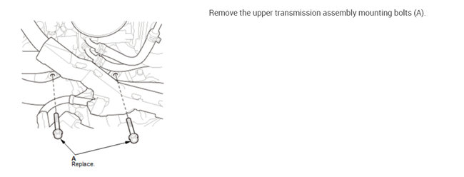

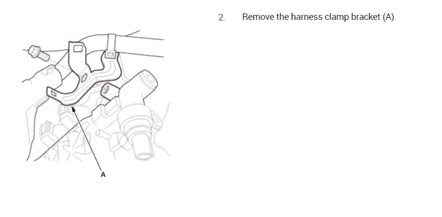

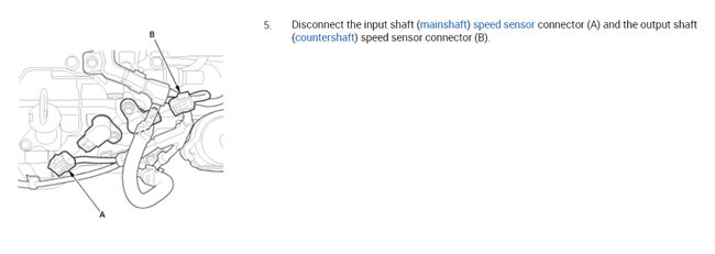

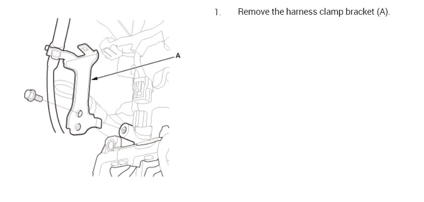

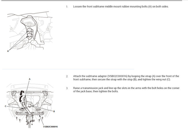

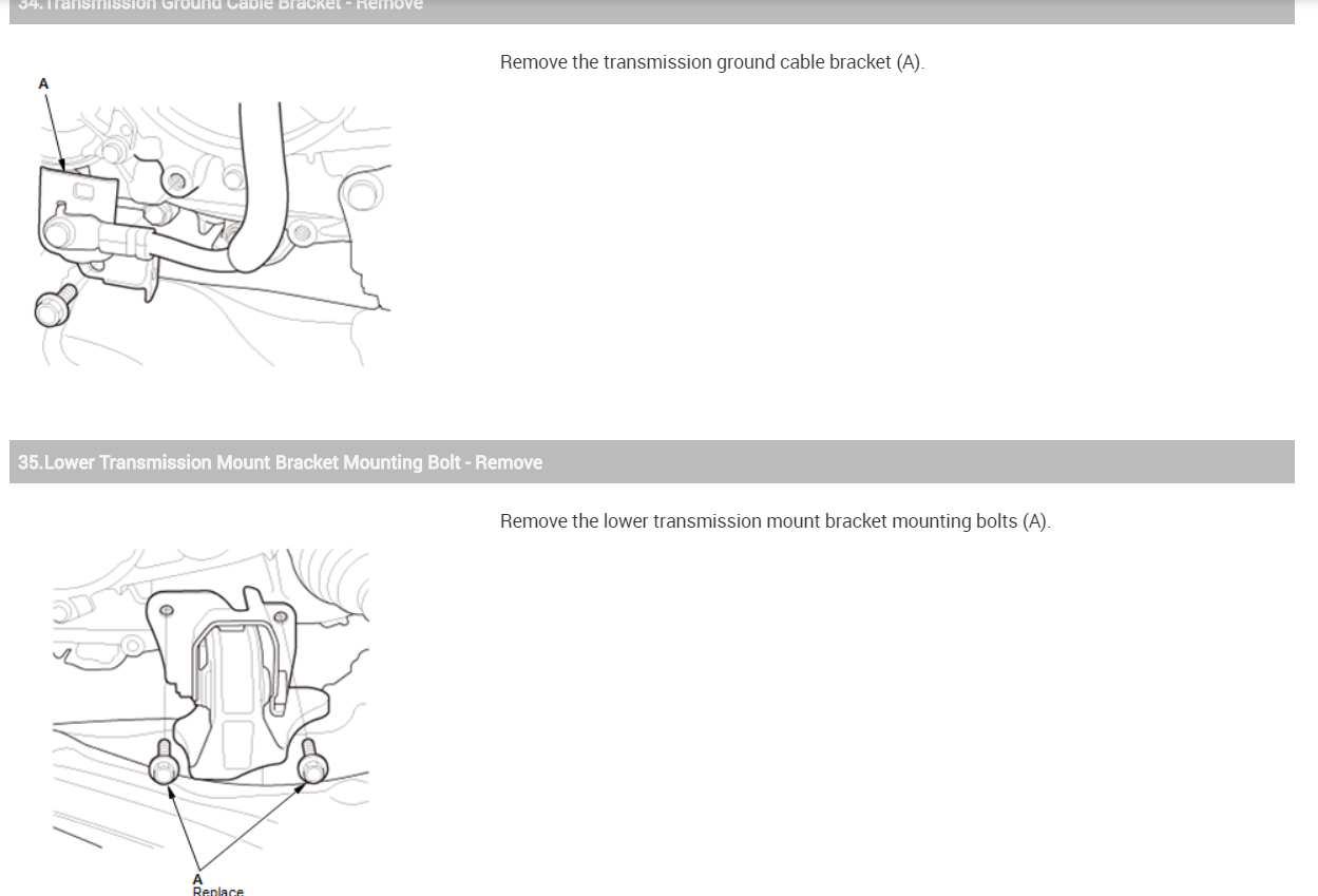

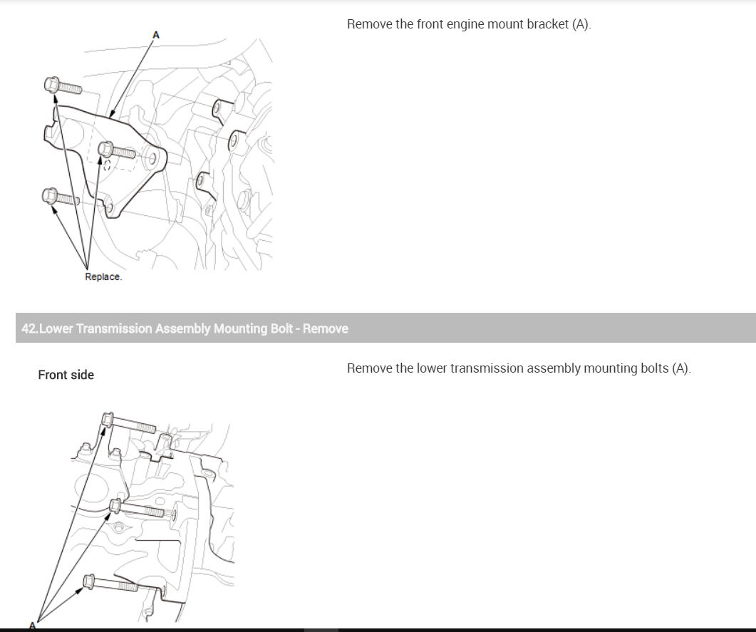

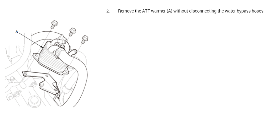

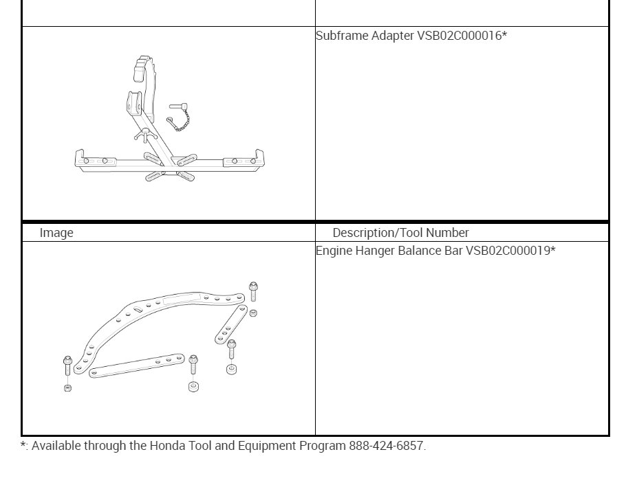

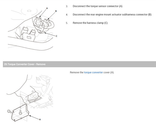

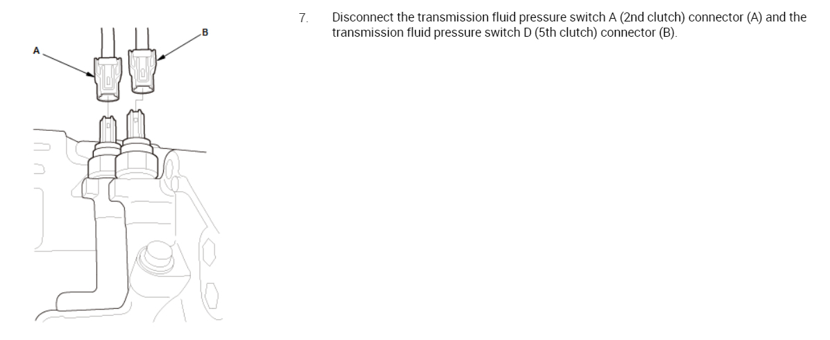

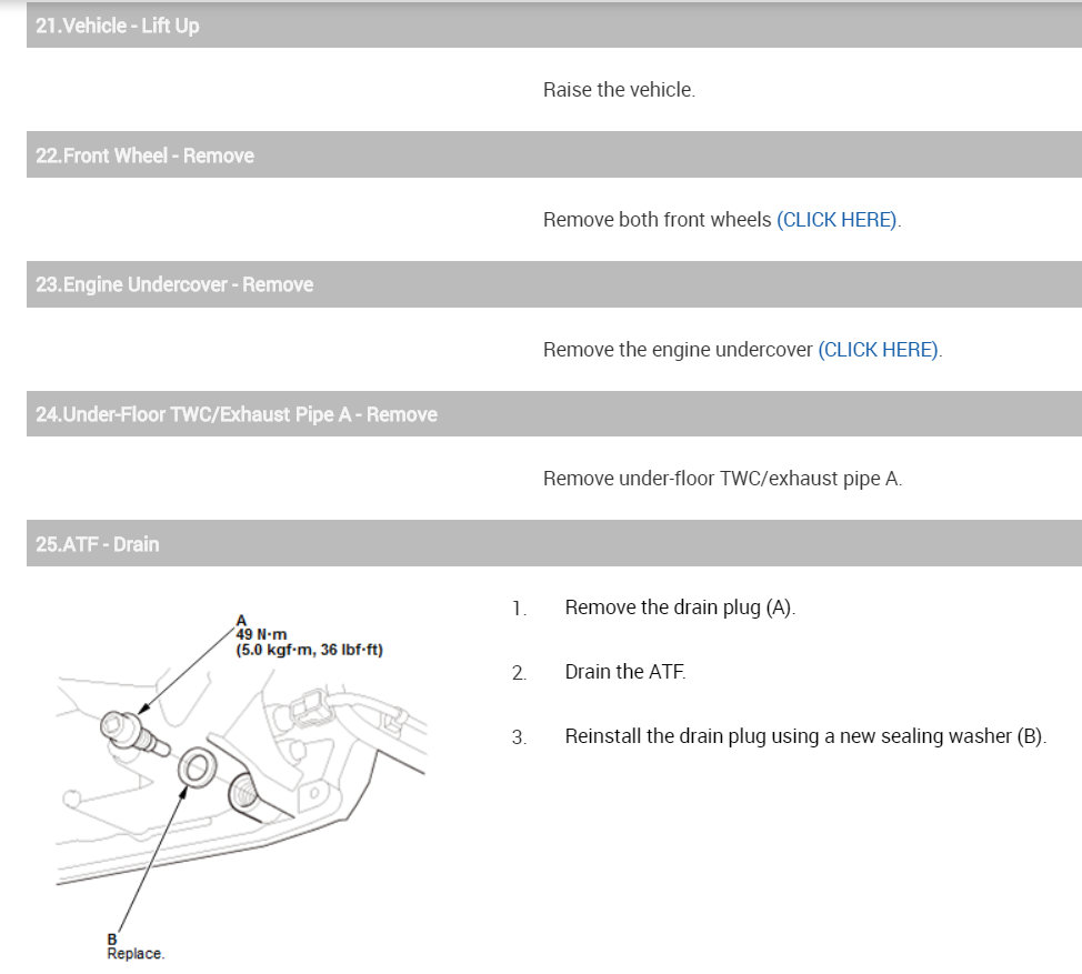

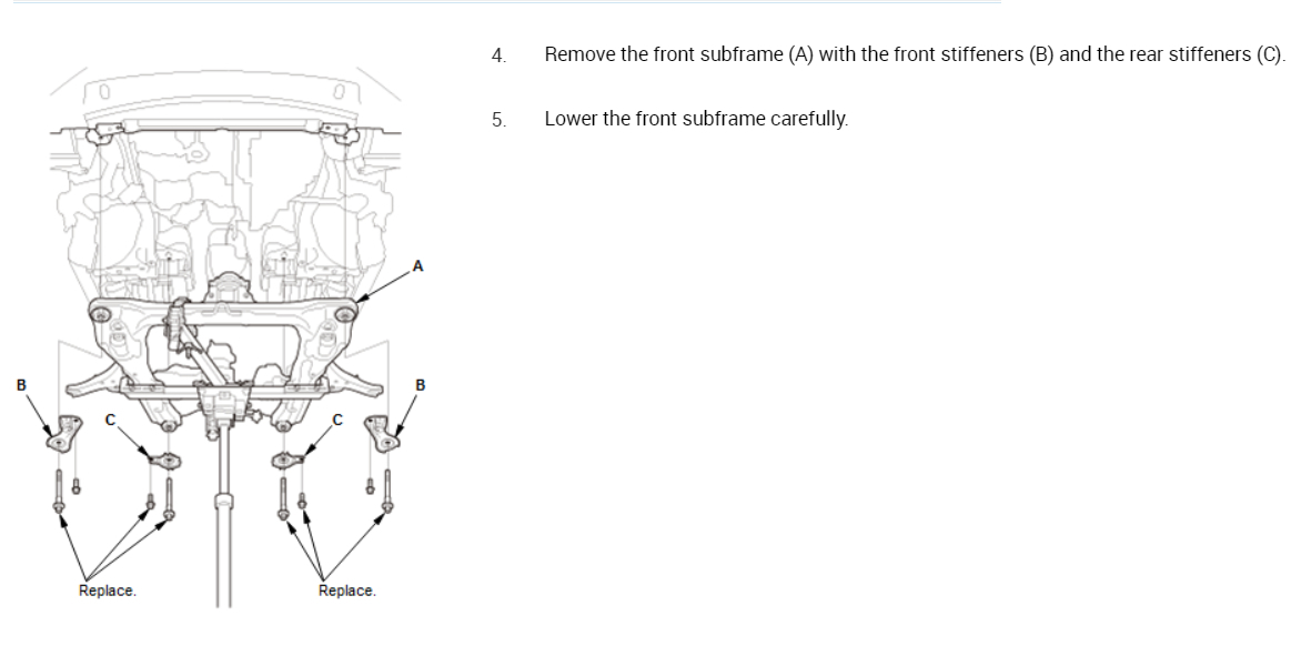

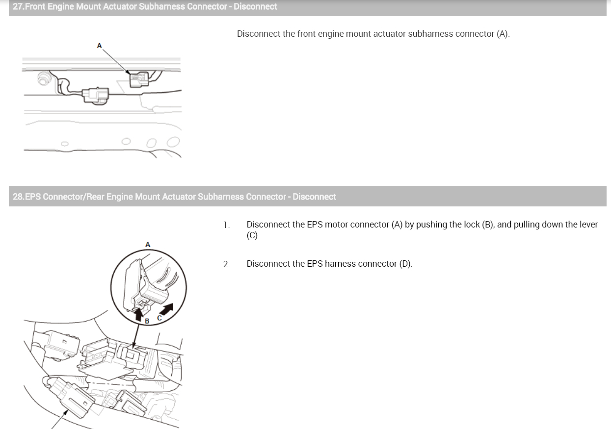

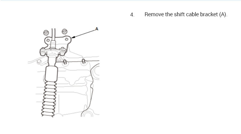

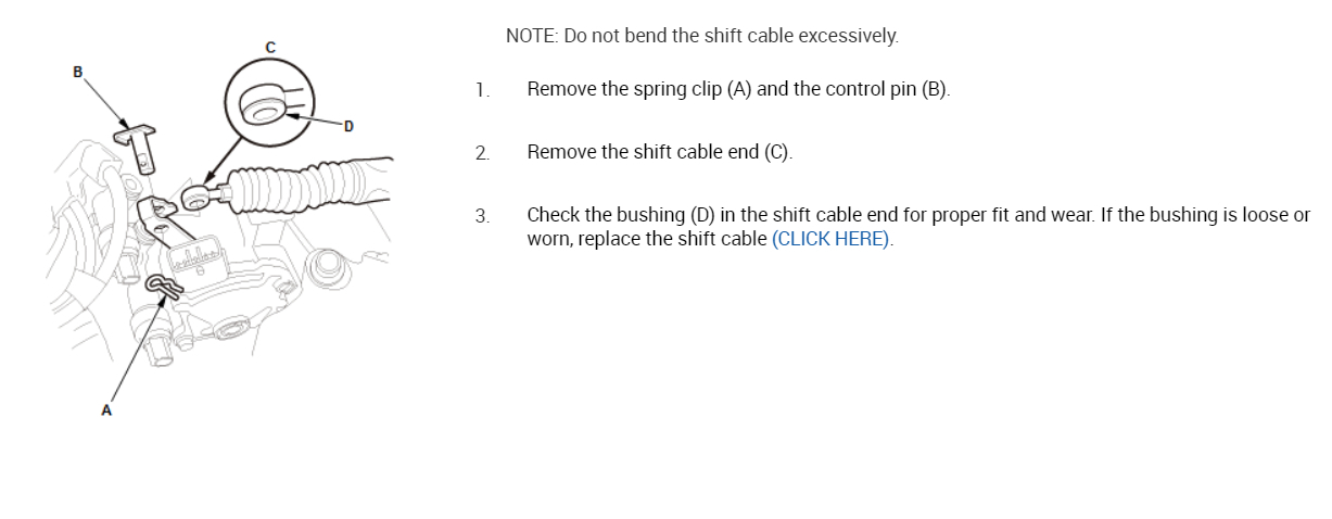

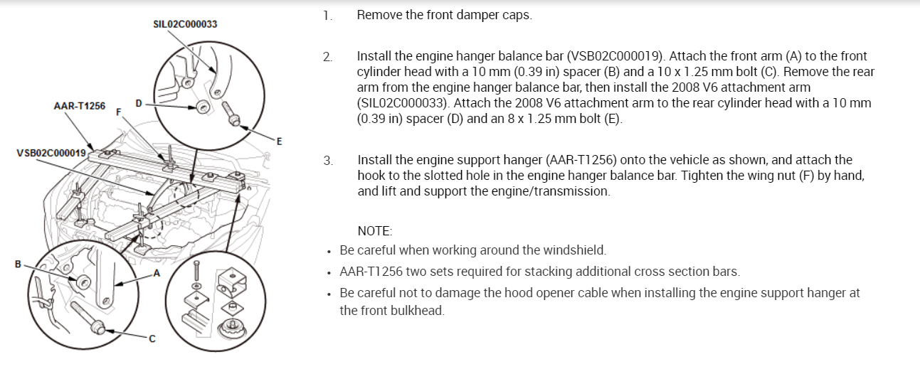

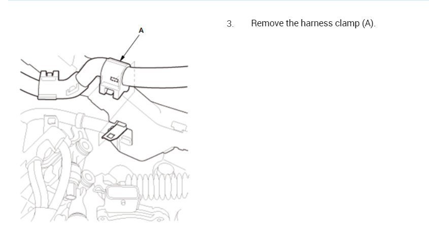

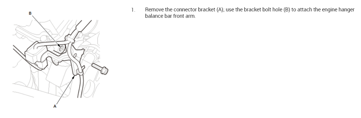

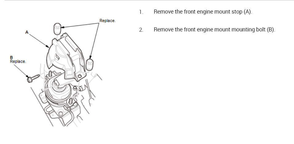

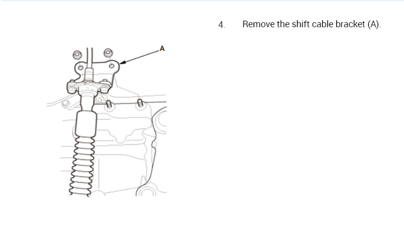

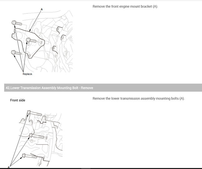

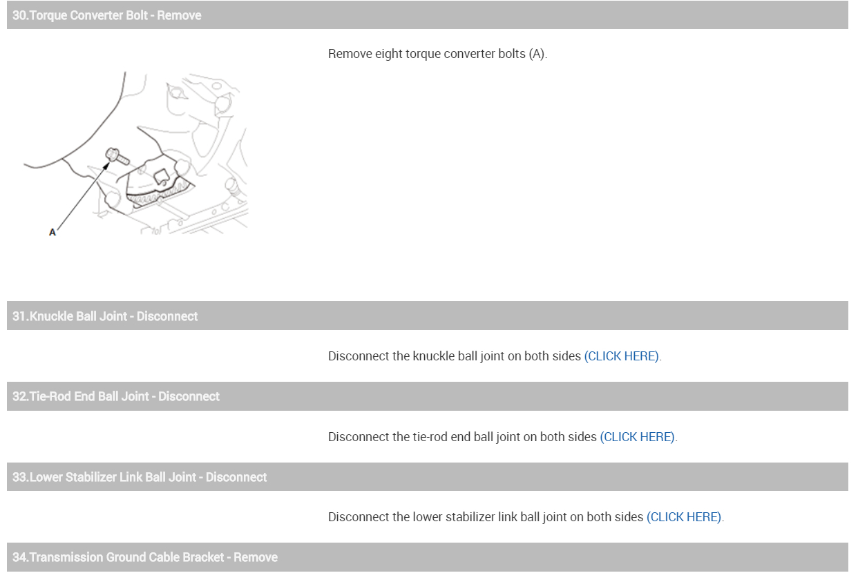

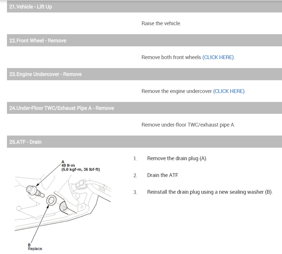

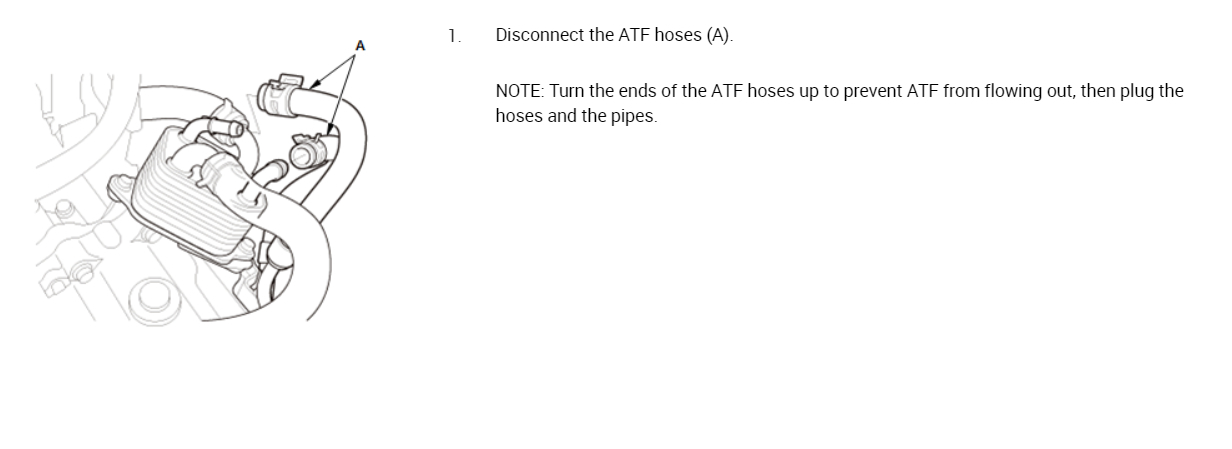

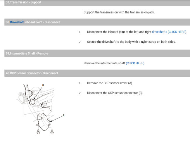

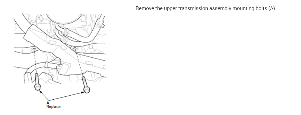

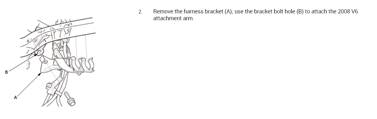

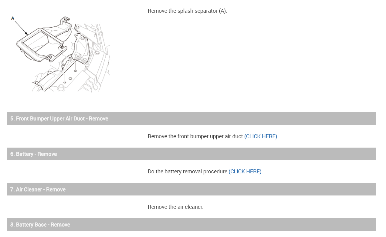

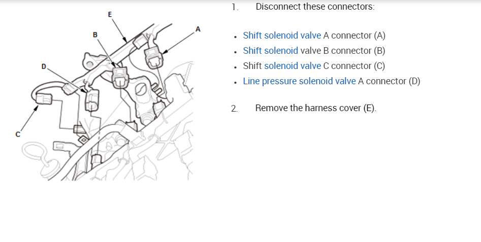

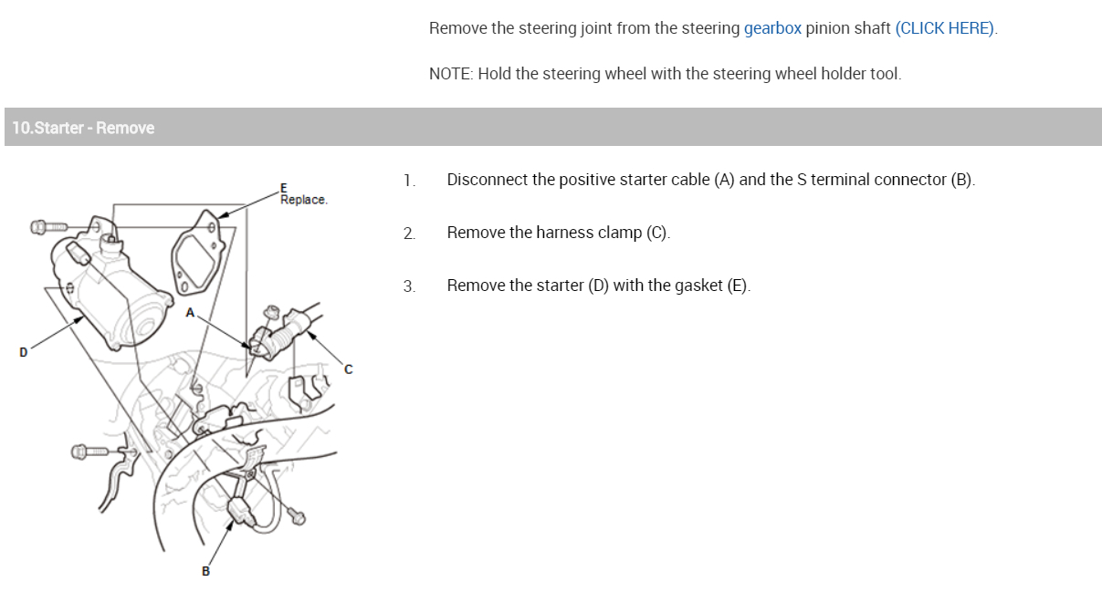

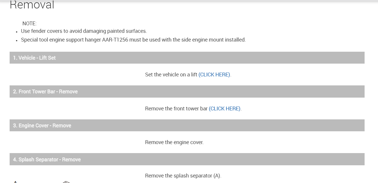

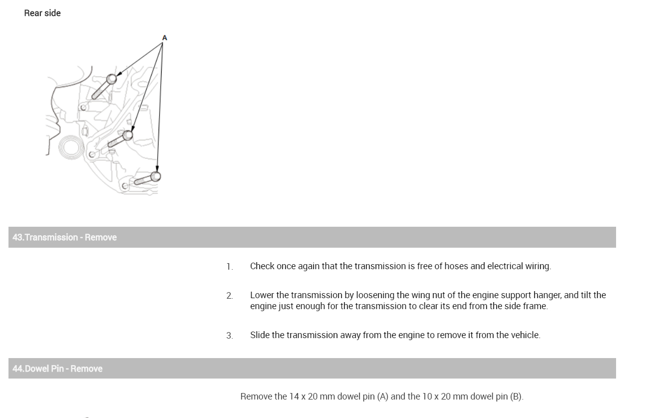

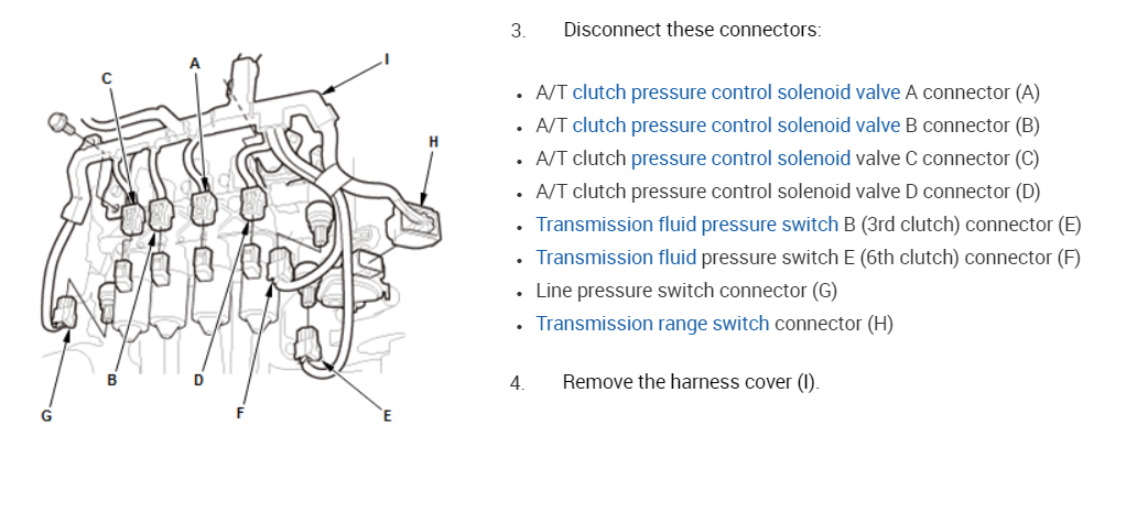

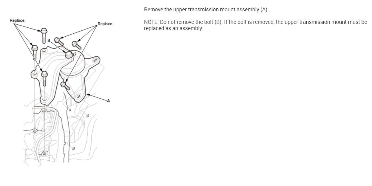

Here is how you can replace the transmission in the diagrams below. Check out the diagrams (Below). Please let us know what happens.

Do I have to take the sub frame all the way down or out? Do the radiator have to come out? Both axle or one , how much time do it take to do the job?
Jul 7, 2020 at 7:41 AM (Merged)
  • 110,241 POSTS
If you are pulling the engine and transmission together, I would do it through the top. Yes, both axles need pulled, and I would recommend removing the radiator.
Flat rate time on removing and replacing a transmission is around 8 hours.

Do you think pulling it out the top is faster than from the bottom? Will I have to take less stuff a lose if I do the engine and trans together?
  • 110,241 POSTS
Both ways is a lot of work... I hate trying to drop them through the bottom. I always feel it is more work and you end up working from under the vehicle more.
