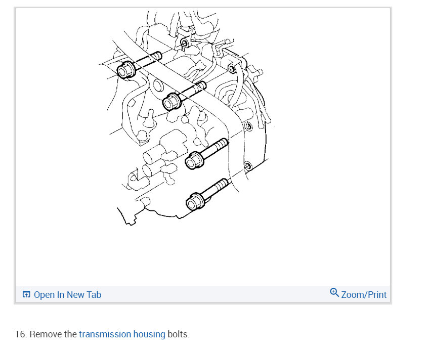

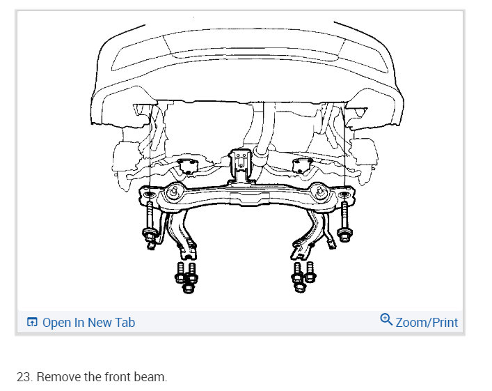

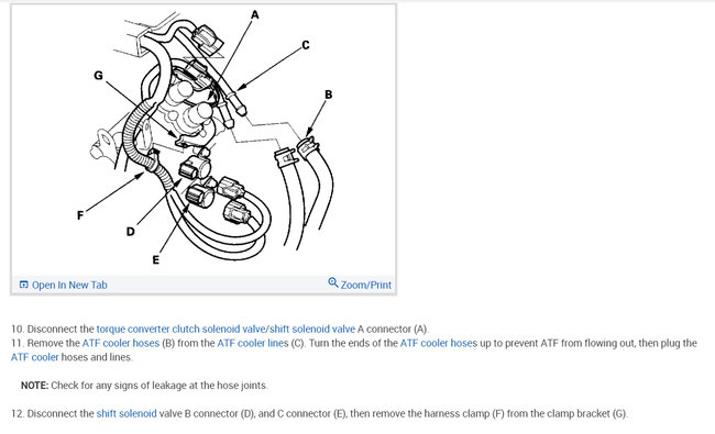

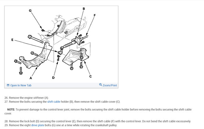

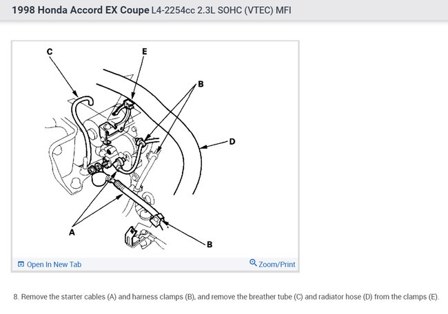

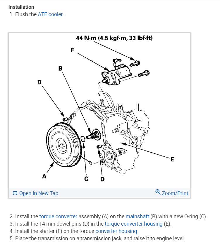

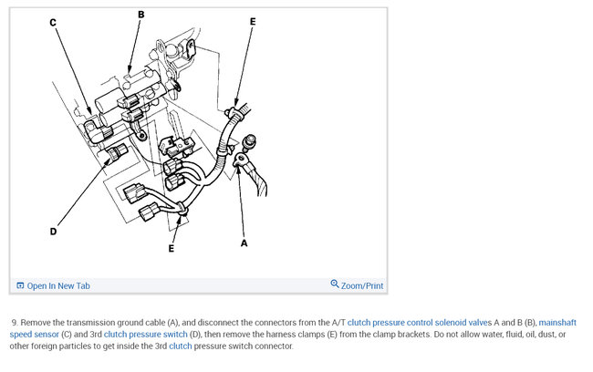

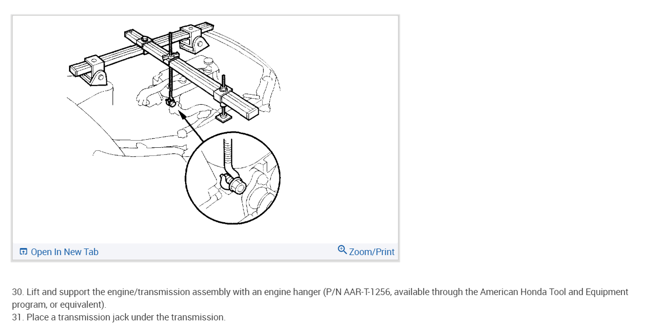

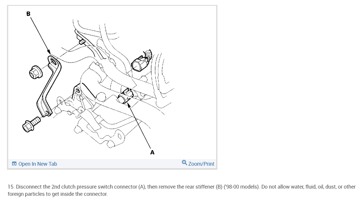

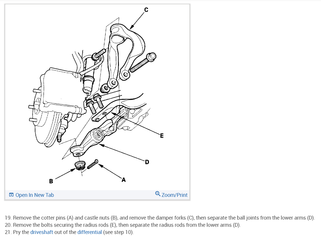

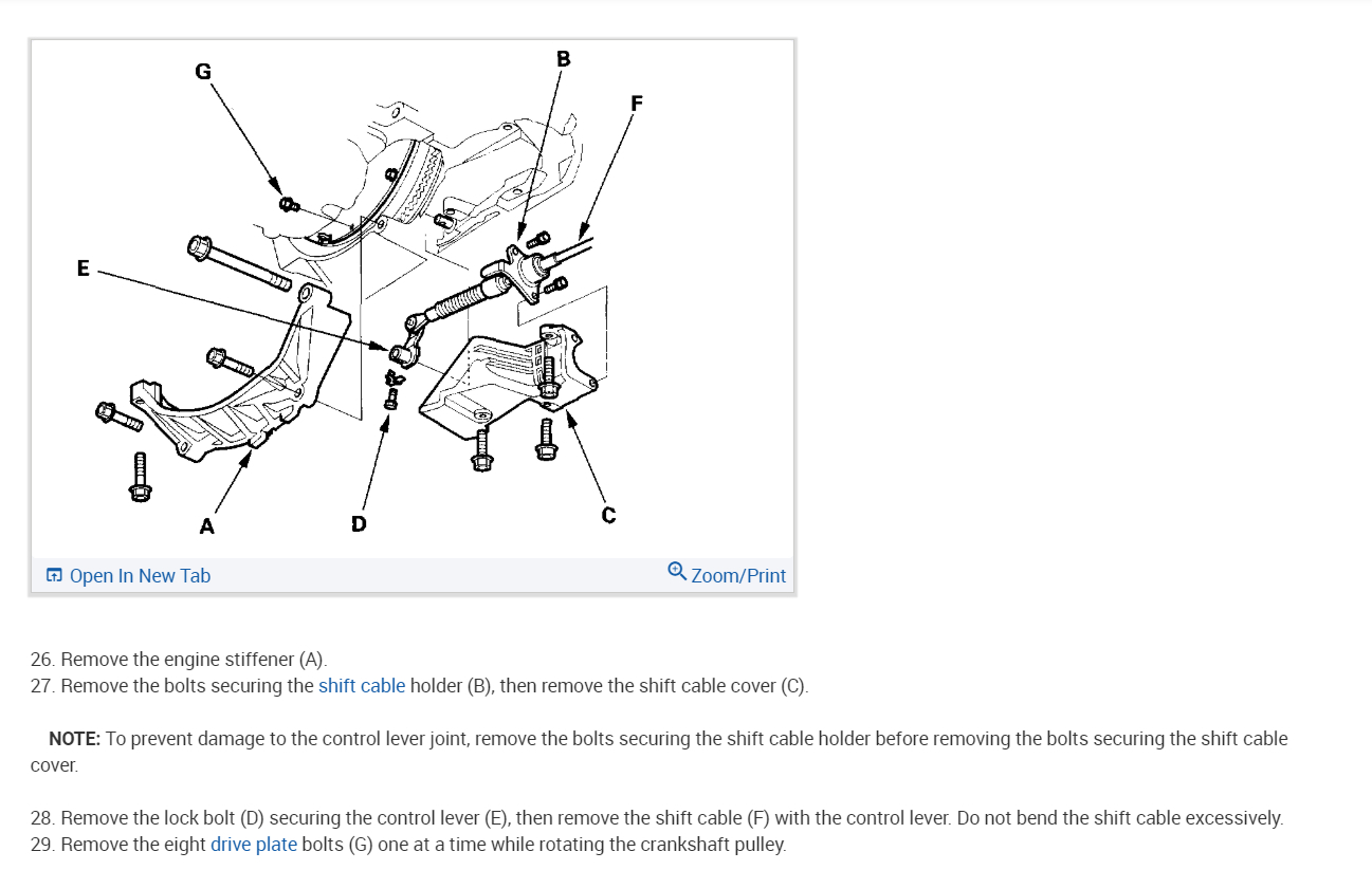

I need to change out the shift sensor but I cant find it can you help me please its driving me nuts! its suppose to be on the trans! but its m.i.a! I think I need to replace the transmission?
Apr 17, 2010 at 6:54 AM
KHLOW2008
  • 41,812 POSTS

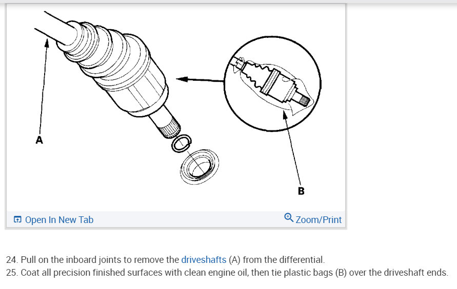

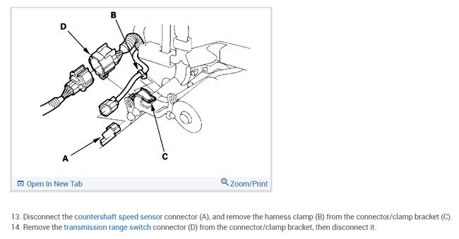

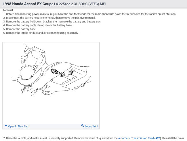

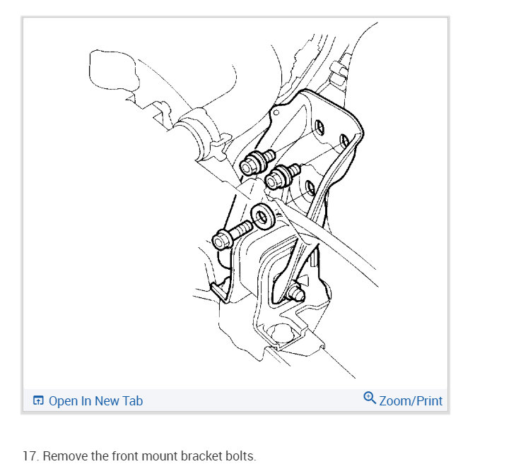

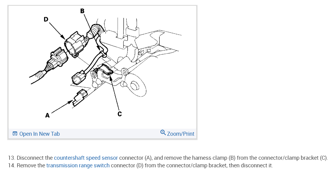

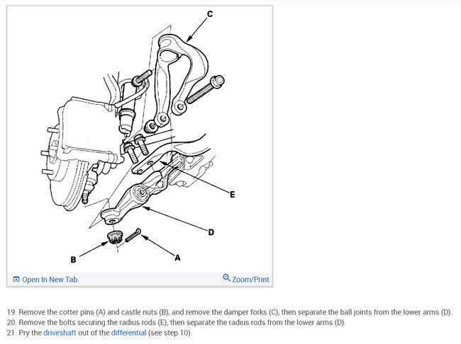

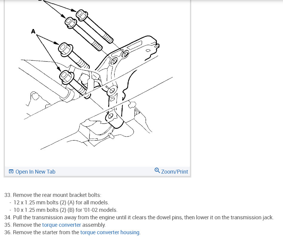

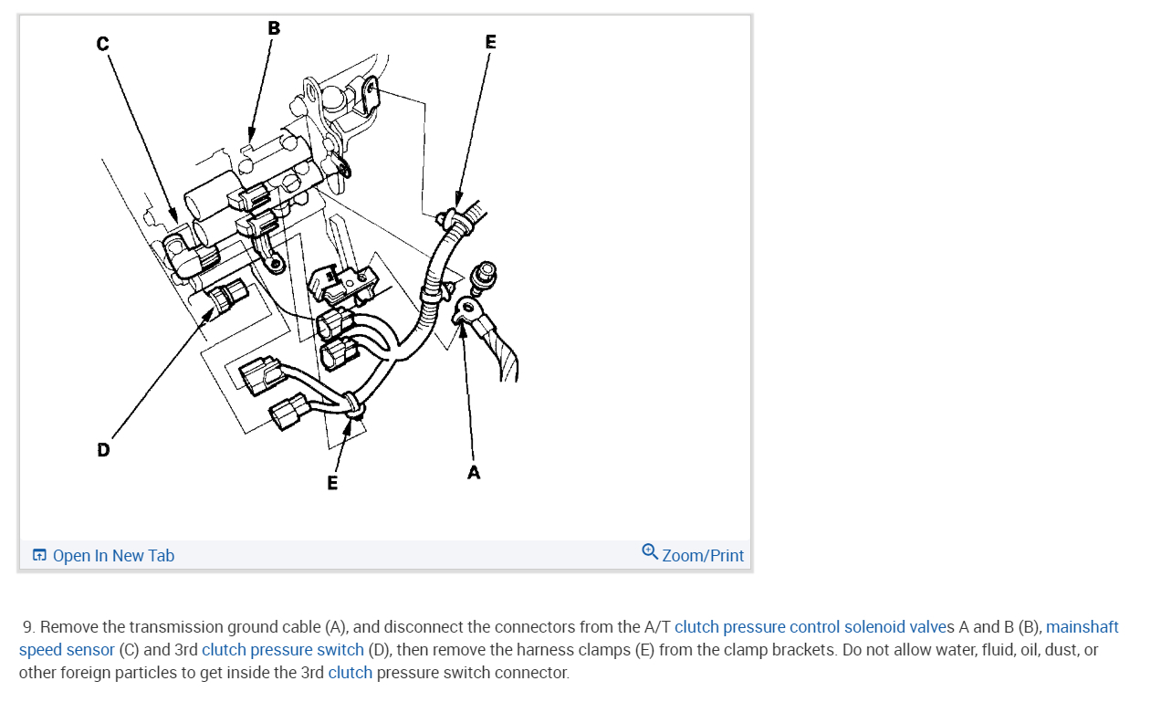

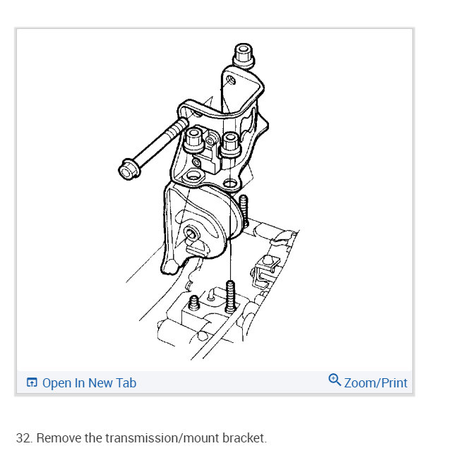

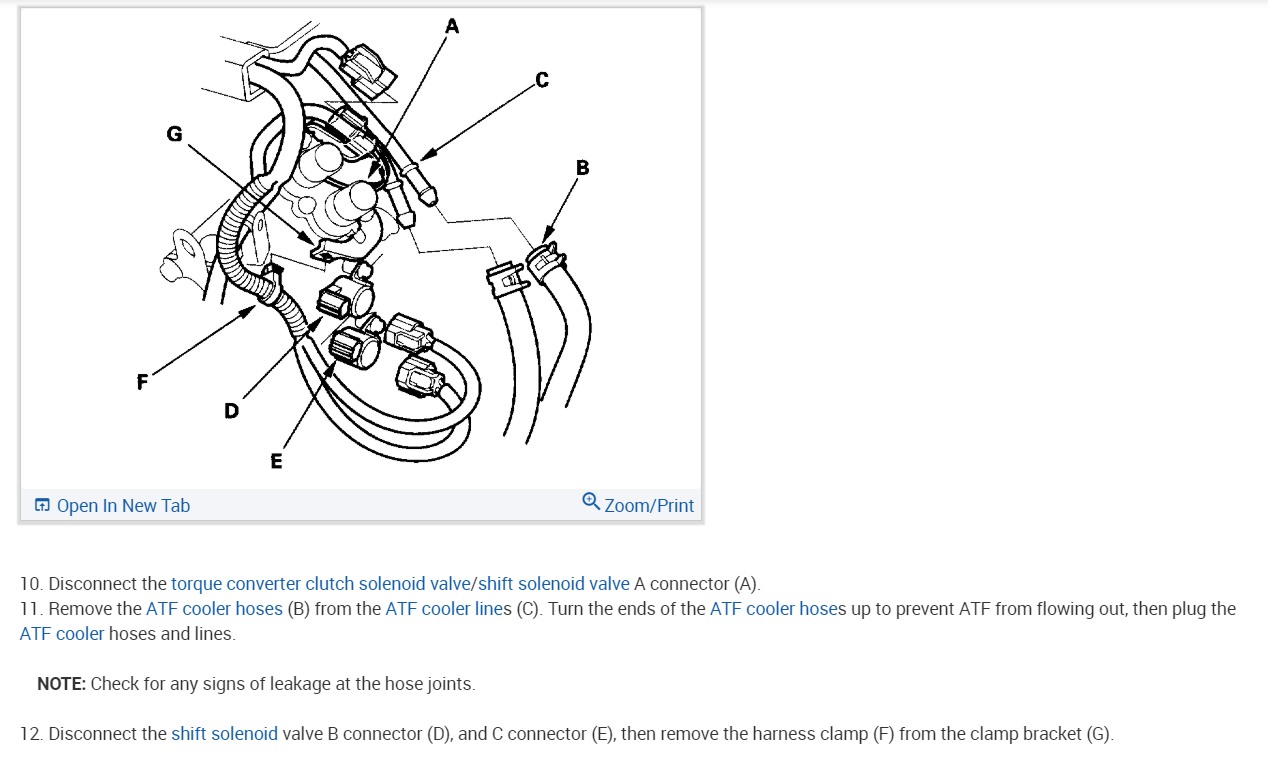

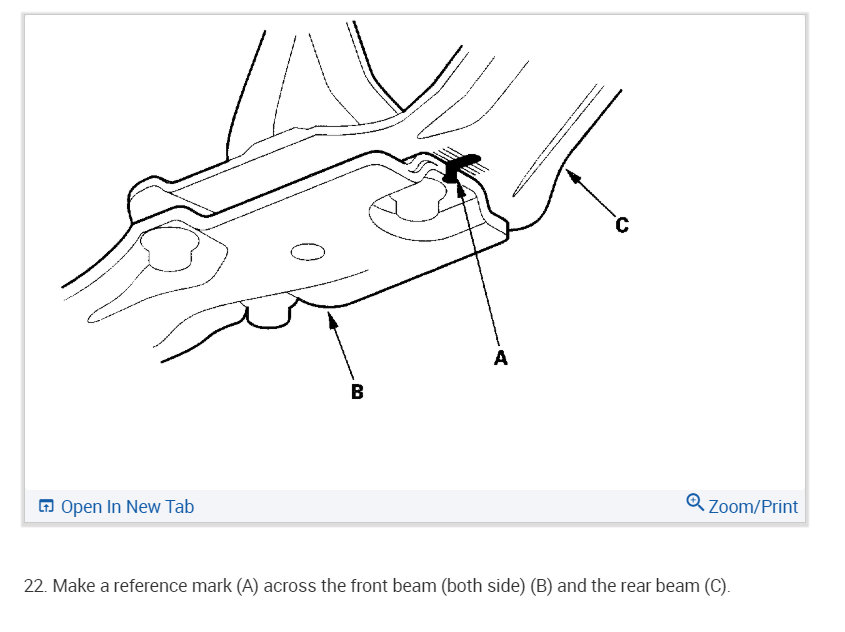

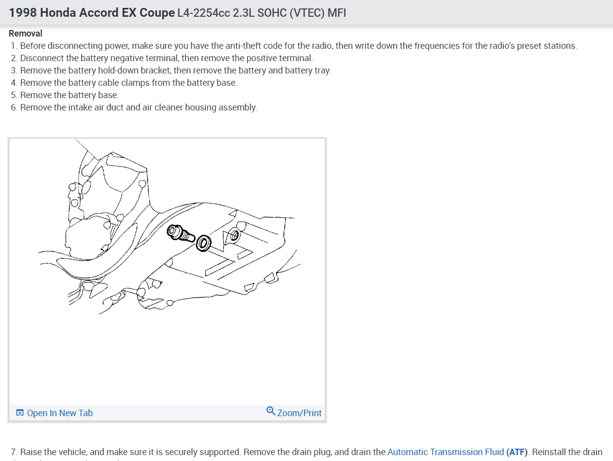

Hi val_mar33,

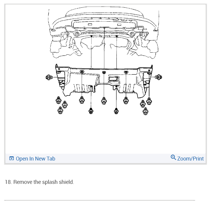

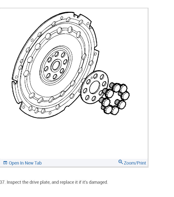

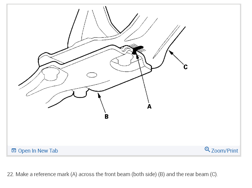

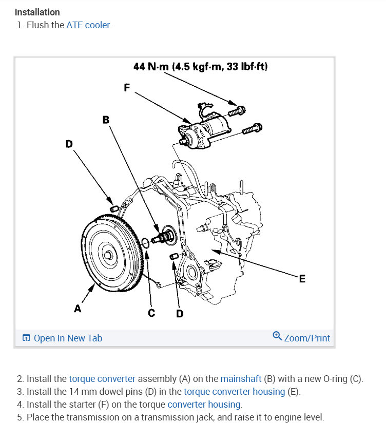

It does sounds like the transmission could need replacement here are the instructions in the diagrams below. Check out the diagrams (Below). Please let us know what happens.

SATURNTECH9
  • 30,869 POSTS
Was that the same problem with the old transmission? Also have you checked for trouble codes in the transmission yet? This sounds like a revolution sensor problem
Jul 7, 2020 at 7:55 AM (Merged)
RUDY2000
No, when the previous transmission comes to a stop, the transmission jerks very hard and goes to neutral and it had was tripping whan it had enough ATF and this is why I replaced it with another transmission.
SATURNTECH9
  • 30,869 POSTS
Alright have you checked for codes in the computer yet?
RUDY2000
I will when I get home, I was reading on other sites the shaft speeds sensor can cause this problem?
SATURNTECH9
  • 30,869 POSTS
These are the same sensor. Here is a video of the job being done.
https://youtu.be/f3bETtCIdxM
RUDY2000
Yep that did the trick once I replaced the sensor the transmission started shifting again.
Thanks for your help this site rocks!

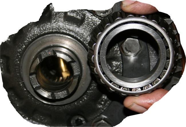

i disassembled the transmission i found metal shaving where the outer bearing race lives ( transmission housing) . i could remove one of the two bearing by hand i know these bearing should be pressed in . what is the issue here i could not figure out .

Not sure what issue you're referring to. That bushing is pressed in but to my knowledge, there's no bearing that's pressed in. If you remove the small bolt in the differential that lets the large round pin slide out, that will allow the two axle gears to fall out or be lifted out. That large pin also has two similar gears on it. Those will fall out too. None of those four gears ride on bearings. The outer two do turn with the cv joints, but in relation to the housing they sit in, they only turn a little, and very slowly, when the two front wheels are going at different speeds, (turning a corner).

this is the picture of the bearing that i talked about
Jul 7, 2020 at 7:57 AM (Merged)
CARADIODOC
  • 34,414 POSTS
I don't see anything obvious there, but it's hard to tell from a picture.

i know they press in those bearing on the differential house, but mine i can put it in and take it off by hand its not tight on the differential anymore . what could causes that?
